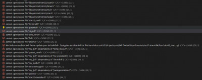

I was wondering which toolchain is needed to compile the code for the inverter?
Perhaps elaborate on it and make this a sticky.
Then we are a small step closer to participating :)

Yeah, i found it but to me it doesn't make sense. But i deff can code, so perhaps there is way to lower the bar. When i got my environment setup i will post it here. If i succeed that is...

OK I got code block setup but you have projects inside projects so i miss a bunch of dependencies.
Isn't there a project snapshot incl. all dependencies?

That fails saying first no git (ok i know wy you leave that out, but i started vanilla) then it says its not within a GIT directory...
I compiled the "libopencm3" but then i get a big bunch of cpu folders/ wich part needs to be copied to the project?
(i assume this since make errors out with a reference to stm32/usart.h but in the stm32 folder in the library there are sub folders...)
For the rest almost there then :)

No other steps, make get-deps thats it. Yes some tools must be missing, it's so obvious to me that I can't explain it ;)

ok i figured out i should use GIT... this works way easier. So i was too old school there :).
Now your commands work (obviously).
For Linux:
  • create a VM with Ubuntu (for example)
  • sudo apt-get install (ide of choice, git, gcc-arm-none-eabi)
  • create a directory for GIT clone (mkdir .....)
(omit the version tag if you want master/develop)
  • make get-deps
  • make
