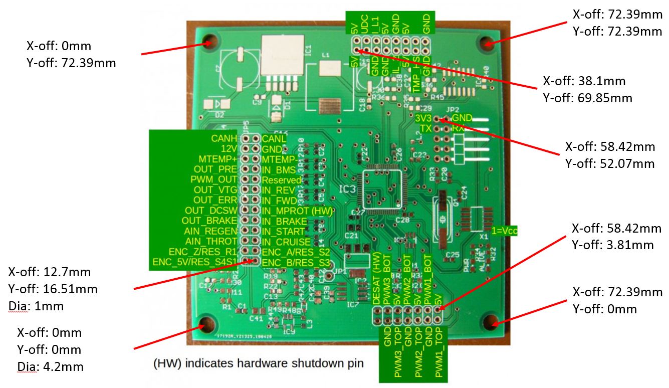

While waiting for my V3 mainboard to arrive, I've made the layout of the adapter board.
I am hesitant to order the boards before double checking the correctness of my fixing hole and connector locations.
I do not have Eagle so I used a Gerber viewer on the V3 mainboard to check the coordinates of the holes and pin#1 of the various connectors.
I assume this info is also very helpful for others, but as mentioned, (@johu) these measurements need double checking.

Re: Nissan Leaf Gen3 inverter
Your origin doesn't seem right, the bottom left hole center is at position 3.81/3.81. Other than that it looks correct.
I just placed my origin at the center of the bottom left screw hole for clarity. But are my holes and connectors (pin #1) in the correct locations relative to each other?

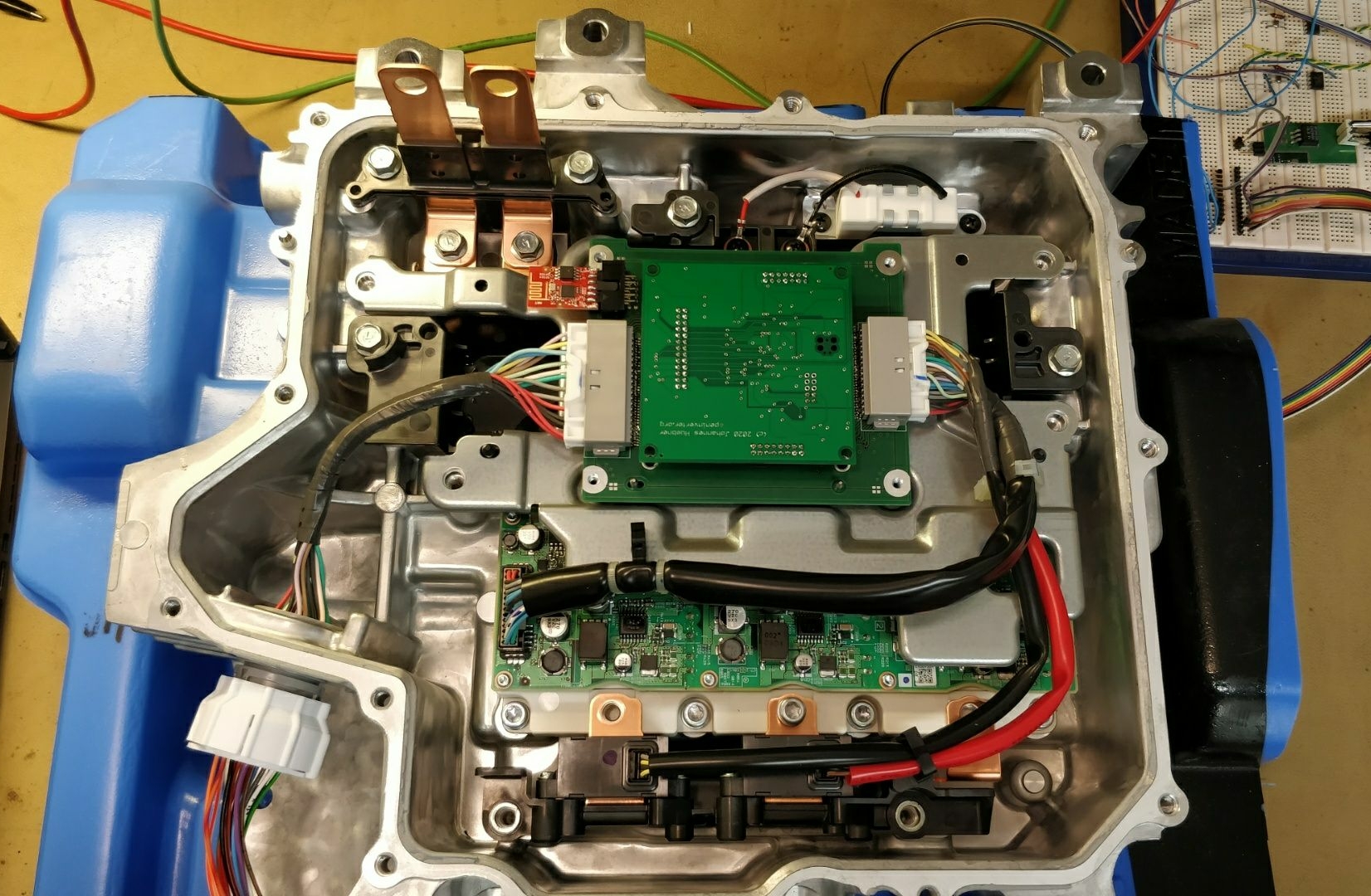

Adapter board is all assembled along with the V3 mainboard.
The nice thing is that no harvesting of connectors from the original Nissan board is needed. Also, the main communication connector of the inverter is actually the same as the Leaf ZE0 22-pin battery connector which I had a friend of mine 3D print for me.
I'll report back about my testing results as I get to it.
-fits em57
Sweet!
-Infieon FS800R07A2E3_B31 igbt
650v 800amp.... holy crap!
Who’s going to push to 300kw!?!?
nice work with flipping the johu brain to fit into this little monster inverter!
Now on the hunt for a gen 3 inverter. Looks like 2018 onward. might have a lead.
Keep us updated
Sweet!
Keep us updated
By the way, has somebody reverse engineered the Leaf Gen2 inverter processor card to the extend, that the KL15 (ignition switch signal) and the resolver circuitry can be pinpointed from the PCB?
This would be very helpful for me to better understand the inner workings of the OEM implementation.
Pictures of the OEM board with the mentioned functionality highlighted with a red circle or something would be great.
