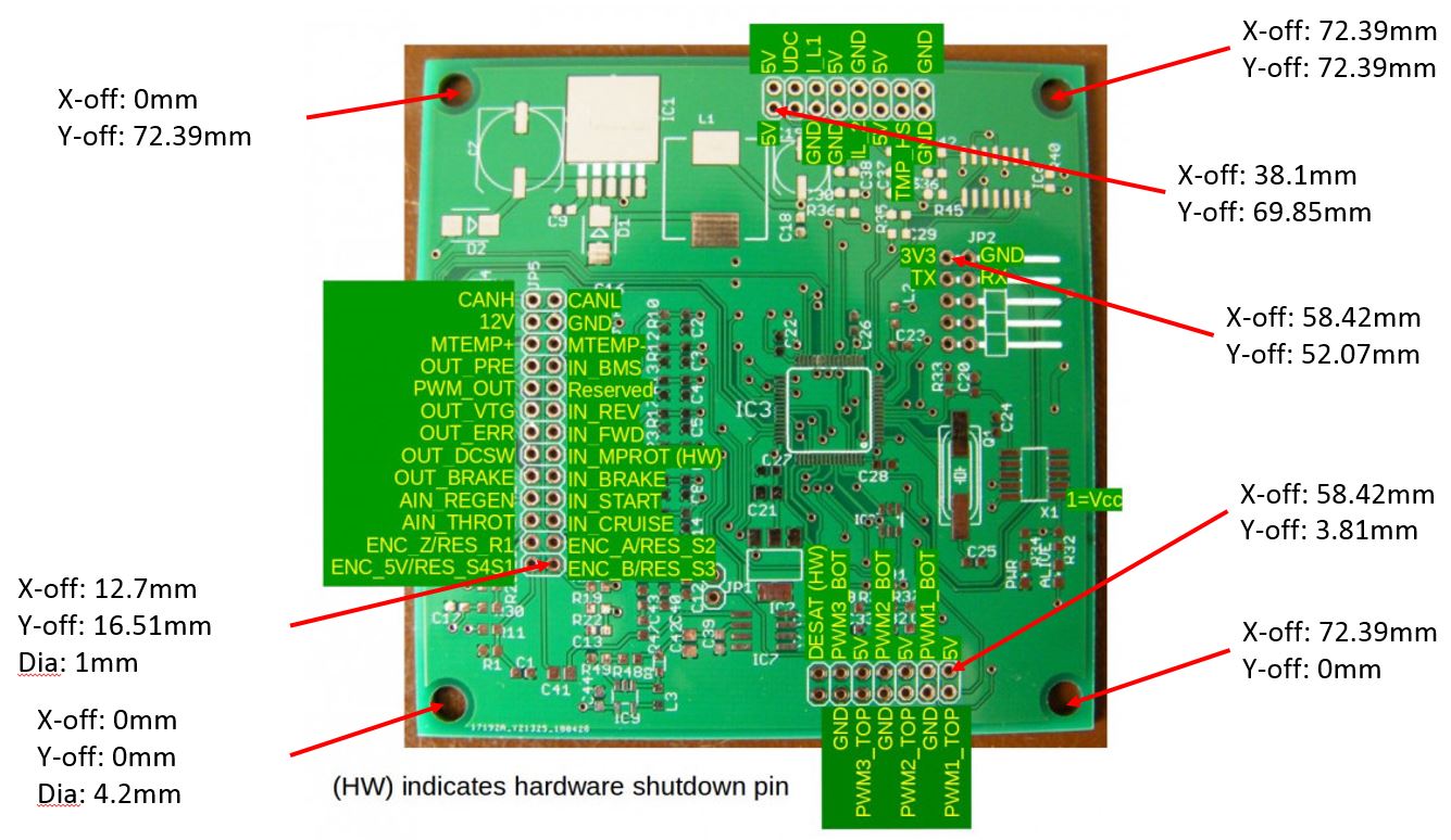

While waiting for my V3 mainboard to arrive, I've made the layout of the adapter board.
I am hesitant to order the boards before double checking the correctness of my fixing hole and connector locations.
I do not have Eagle so I used a Gerber viewer on the V3 mainboard to check the coordinates of the holes and pin#1 of the various connectors.
I assume this info is also very helpful for others, but as mentioned, (@johu) these measurements need double checking.

Your origin doesn't seem right, the bottom left hole center is at position 3.81/3.81. Other than that it looks correct.

I just placed my origin at the center of the bottom left screw hole for clarity. But are my holes and connectors (pin #1) in the correct locations relative to each other?

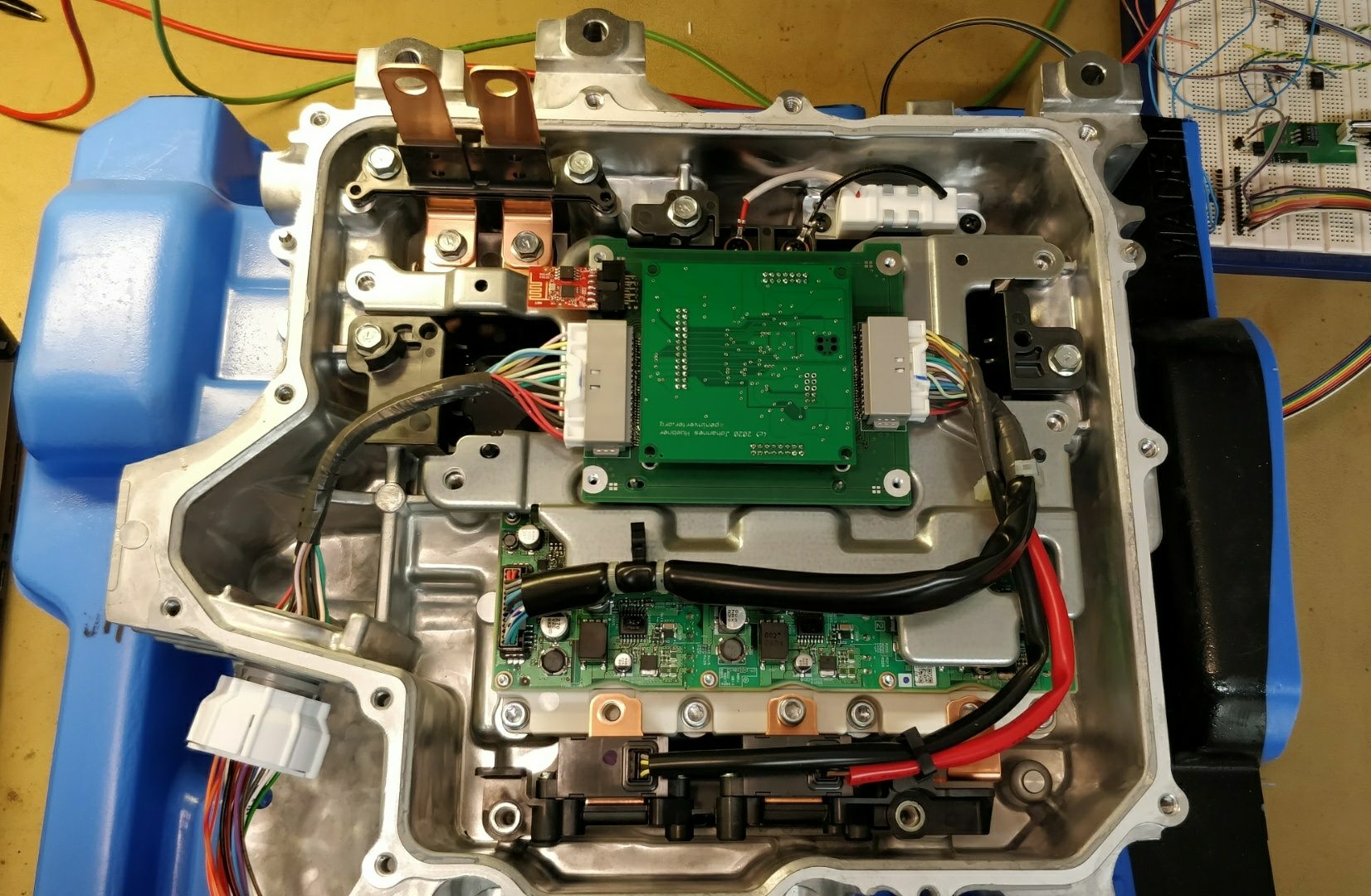

Adapter board is all assembled along with the V3 mainboard.
The nice thing is that no harvesting of connectors from the original Nissan board is needed. Also, the main communication connector of the inverter is actually the same as the Leaf ZE0 22-pin battery connector which I had a friend of mine 3D print for me.

-fits em57
Sweet!
-Infieon FS800R07A2E3_B31 igbt
650v 800amp.... holy crap!
Who’s going to push to 300kw!?!?
nice work with flipping the johu brain to fit into this little monster inverter!
Now on the hunt for a gen 3 inverter. Looks like 2018 onward. might have a lead.
Keep us updated

Wow, that is excellent. Had I made this one of the headers would probably be mirrored or twisted Looking forward to your results!

Re: Nissan Leaf Gen3 inverter
I tried with different values for deadtime upto 255 and also tested with 17.6kHz, 8.8Khz and 4.4Khz. I also verified with a scope that my dead time was 14us with 255.
Everytime the same end result. Motor spins momentarily and I get
Warn - hicurofs1
Warn - hicurofs2
Derate - current limit
Stop - overcurrent
Could this be some kind of ann EMC problem?
Warn - hicurofs1
Warn - hicurofs2
Stop - overcurrent
I disconnected the motor once more and double checked my adapter board PWM channel connections.
I had 44V on the DC-link and I went through each drive signal (CH1N, CH1, CH2N, CH2, DCH3N, CH3) by pulling down the 74LVC06A outputs one by one and verifying that the corresponding phase output was switched accordingly to the correct direction.
According to the measurements, all connection are correct in that department.
I am getting very confused here...
So, I have some good new and some bad news.
I decided to continue with the sine FW and hooked up a small industrial induction motor to the inverter and sure enough, the motor started spinning.
At this point I only had 44VDC applied.
This is where it all started to go sideways...
I was so thrilled about the result, that I immediately moved onto testing with full pack voltage.
The motor started spinning, but to my disappointment, all of a sudden something snapped in the inverter and DESAT was asserted.
After debugging I noticed that phase2 output was sitting at positive rail! Apparently the IGBT bridge is toast.
After all of this, I understand, that I should have measured/logged the phase currents and other signals while I had the low voltage applied.
I let my enthusiasm got the best of me and was not working systematically. I should definitely know better.
Anyway, I have another Inverter which I need to pop open next and continue. Hopefully I do not blow it up, or this will have come a very expensive experiment.
By the way, has somebody reverse engineered the Leaf Gen2 inverter processor card to the extend, that the KL15 (ignition switch signal) and the resolver circuitry can be pinpointed from the PCB?
This would be very helpful for me to better understand the inner workings of the OEM implementation.
Pictures of the OEM board with the mentioned functionality highlighted with a red circle or something would be great.
