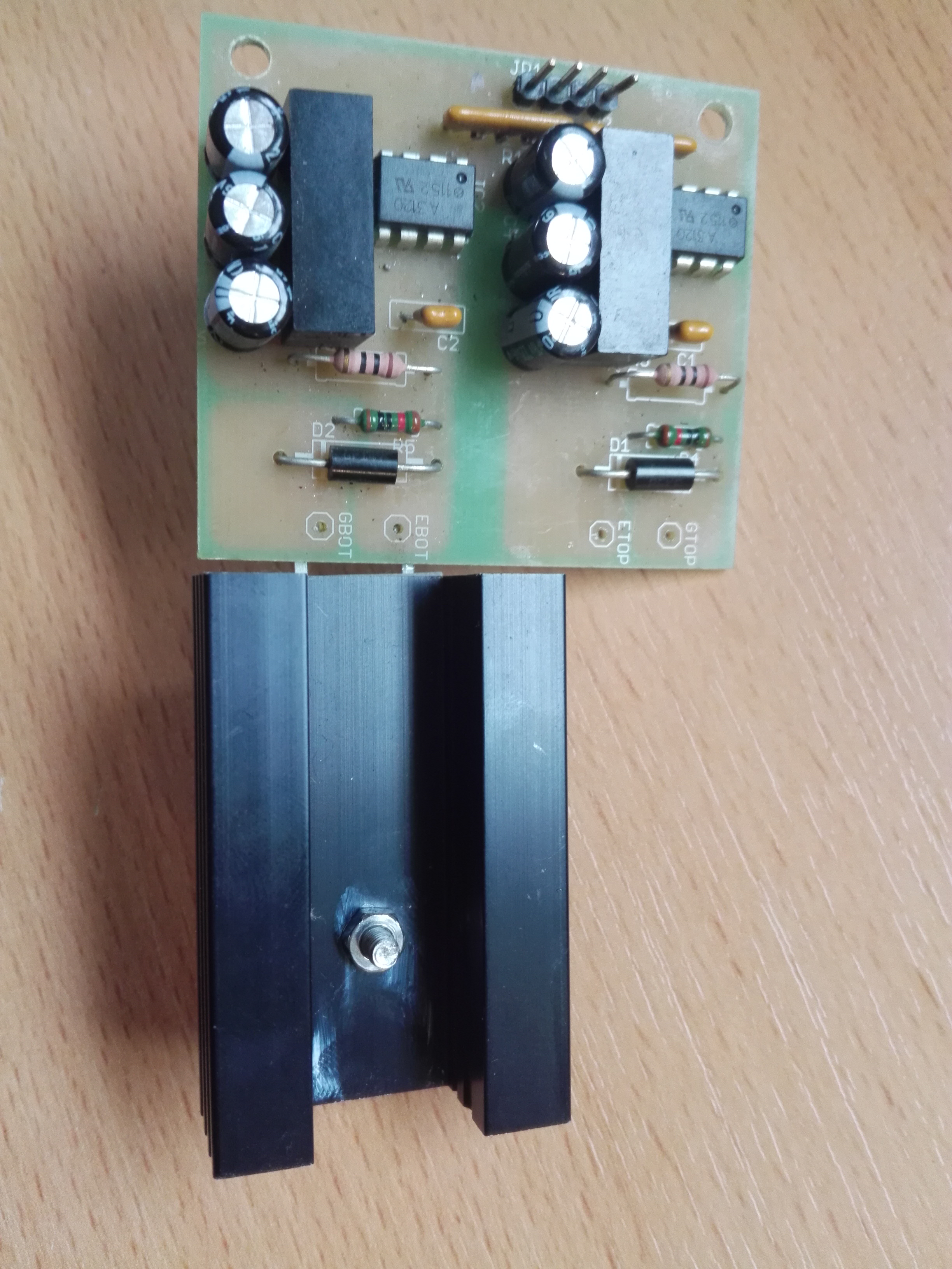

This here is really good and cheap option. You just need to put it in an enclosuse with some isolation (electrical and heat).
viewtopic.php?f=9&t=335#p3783
However i really dont trust those tube AC heaters. There is sand/quarc inside and special wire that heats up under current. However there is a good chance that wire will conduct 360Vdc to casing and you would have a partial short through coolant. It is enough to throw protection in EVSEs. Ask me how i know :twisted:.

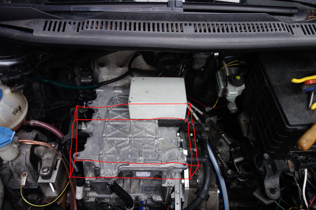

Got the heater yesterday. It can simply be opened by removing 4 bolts. I cut the wire to the AC motor and put it back together. The heating element looks like a square mushroom surrounded by water, maybe like 5x8cm
Been thanked: 1913 times
Re: Water Heater
Tested the heater today. I basically placed right before the input of the cabin heater. So it's inverter -> motor -> pump -> heater -> cabin -> inverter. To my dismay everything got warm except the cabin. It doesn't seem like the radiator extracts a whole lot of heat from the water even with the fan turned half way up. Is that normal?
So I think I will try the PTC route next. Apparently the Diesel version of Touran has a slot in PTC element (part number 5Q0963235A)

Just went outside and measured, it is about as wide as the inverter and about as high as my white junction box, so it would fit nicely. Will see how far I get with the 750W or rather 500W (left over after lights, fan and misc). Then will let you know

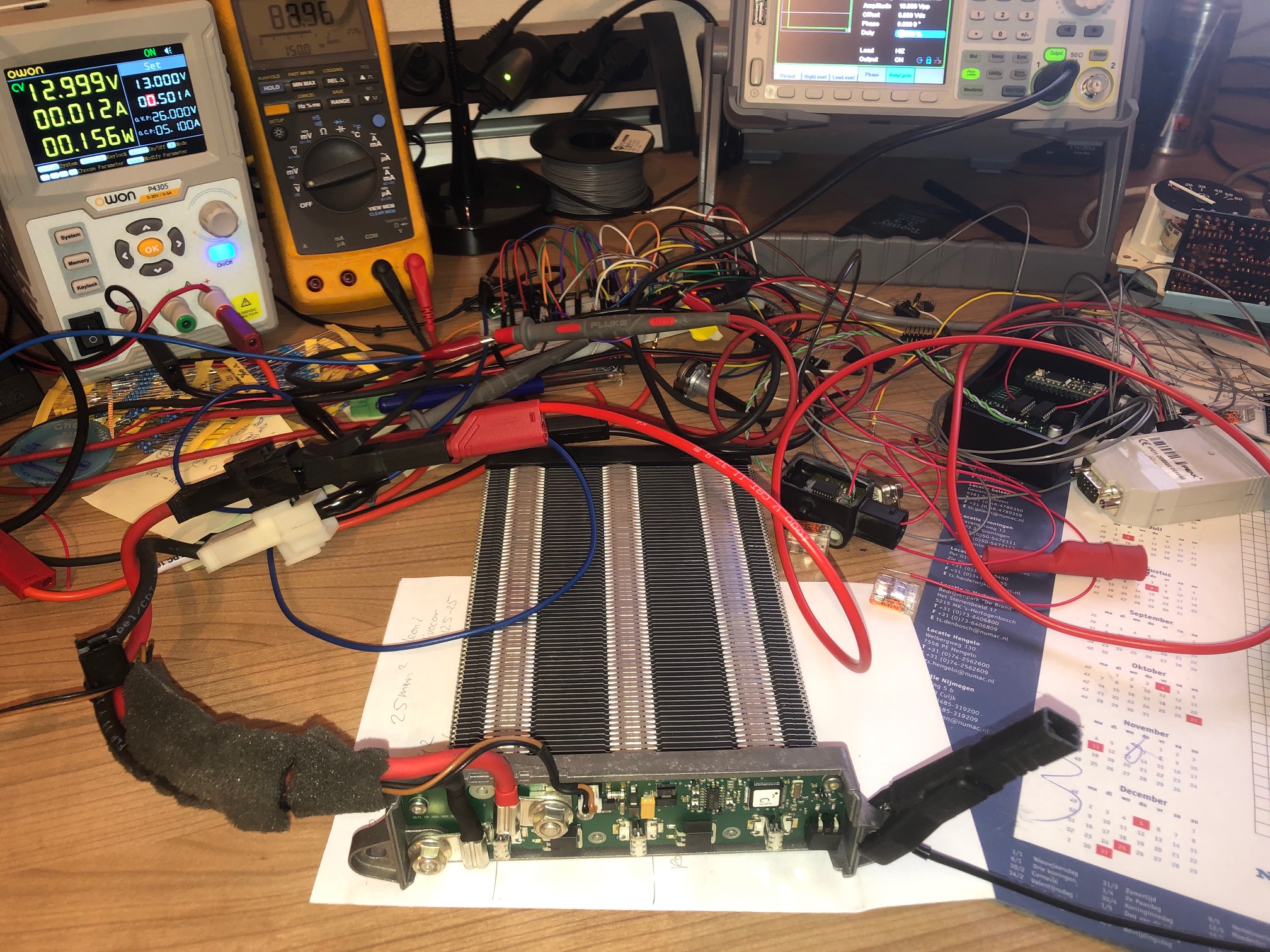

I have the Volvo PTC here now, what sort of PWM does it need? Amplitude, frequency?
EDIT: Arber, I really think you have a point with the thermostat. I heated the water for 30 minutes yesterday and left the fan running at medium speed with air recirculation. Everything was hot but the inside of the car wasn't. Maybe water is bypassed rather than blocked.

Argh! So Mr. Supersmart here had removed a climate control servo some months back because it was noisy. I thought it was just for A/C but in reality it controlled air flow via heater matrix or not! By default it is set to NOT flow via the matrix. So put servo back in and now I get warm air from the vents. So will give the water heater a second chance.
Will put a small PWM circuit in the white junction box and hook it up to a Schuko socket, so I can either plug the heater into that or the wall.
