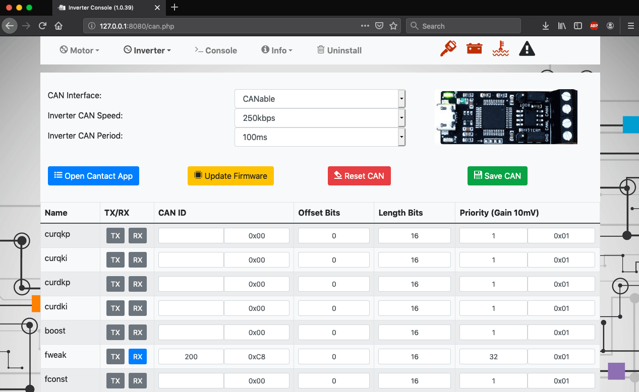

Hello,
I can not cope with the little information of the wiki.
How can I send CAN signals? The table in the web interface, unfortunately, I do not quite understand. Is there a description of what is meant by "Plot" "l" "r" "Map to CAN" and so on? How do I get the engine temperature for example on ID 0x123 on CAN output?
I thank you for the help.

The L (left) and R (right) litle boxes are for live plotting, to use it, you clik the box (for example rpm and L) and scroll down to plotting and click start plot, it will show the rpm live with the scale on the left.
To send can messages you have to specify the ID (in decimal) for example 0X123 would be ID 291 then what position is you data and how long and finaly the gain ie multiplier. Then click on can TX and save parameters. That should do it.

i have my problems with "Position" and "Bits". What exactly i should write in the boxes?
Bits = 8 , Position = ?

A CAN message can have up to 8 data bytes i.e. 64 data bits
0 1 ... 62 63
The positions field specifies were in those 64 bits your data is put. So if your specify 16 as position and 8 as length:
x x x x x x x x x x x x x x x x y o u r d a t a x x x x x x x x x x x x x x x x x x x x x x x x x x x x x x x x
0 1 ... 62 63

But a "2" in Theorie length and Position field means what? Two Byte, Two bit?
thats the thing that was unclear.
- Been thanked: 1913 times
Re: Help with CAN
two bits
Re: Help with CAN
And the "Position"? They couldnt mean bit 2, when Thema Information is one Byte long.
Re: Help with CAN
Yes it's bits. Why don't you just experiment and see what happens. Nothing can break.

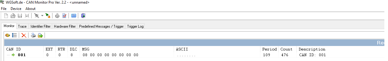

I tried. But i couldnt get any Signal from the can sniffer. With the can in my smart roadster, i could read out the Massages.
Im new with can Systems and the Controllerboard /Webinterface.

Have you setup the can ? ie speed to be the same on both devices ? Is your bus terminated ?
You should have 60 ohm between CAN H and CAN L.

Right, "canspeed" defaults to 250kbit/s. Does that correlate with your sniffer?
Point is: even if you don't get the bit banging right you should still see *a* message
Re: Help with CAN
yea can speed at 250k, Bus terminatet with 120ohm.
I would try another can sniffer next week, the actual one is not the Best (25€ cam Bus analyzer)

i buy a "CanUSB" Dongle and now i see CAN-Signals
I try to send the "Version" Value "4.17.R" to the CAN. I find the CAN-Package (001), but in there is only this I Write in the WebInterface at "Version" row :
-CanID : 001
-Position : 1
-Bits : 16
-Gain : 1
-Map to Can TX
Sorry, im a totaly Noob with this, i could only programm assambler
PS. how i could send CAN-Commands to the Controller? e.g. to chance the recuperation strength
