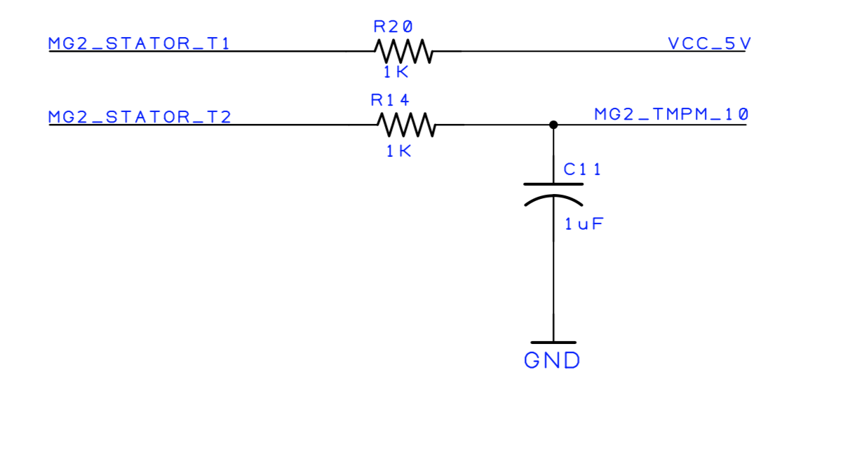

How are you working out the ADC values? I'm looking at the motor one now as it's simpler, maybe. The resistance values in the service manual match that of a 50k NTC thermistor datasheet. https://www.te.com/commerce/DocumentDel ... F4050DPHFS
The voltage divider has a capacitor and that is above my understanding.
Example of 20 degrees, resistance is 62.5k, so (62.5k + 1k + 1k) for R1 but I don't know how to calculate the value for R2 to plug in to Vo= Vs * R2 / (R1 + R2)

The graph I posted above should be the toyota motor temperature sensor temperature vs resistance.
You then need to reconfigure the circuit board so that you get the same wiring as depicted in the spreadsheet under the "Toyota 47k" tab.
The temperature sensor (NTC) should be connected between MG2_STATOR_T1 and GND i.e. in parallel with the 2k2 resistor.
Then just select the toyota motor sensor in the web interface and you should be good.
If you want to do it in another way you need to calculate the expected voltage for any given temperature and then convert that to the corresponding ADC value.
For the connections as above the voltage is 5V*(2200*NTC-resistance/(2200+NTC-resistance))/((2200*NTC-resistance/(2200+NTC-resistance))+1200) and then the ADC value is (voltage from above)/3,3*4096.

Awesome, thanks, I think I should be able to do all this externally to the inverter so I don't have to take it out again. Will add this info to the wiki page once I've got my head around it.
