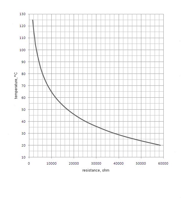

I have updated temp_sensors.ods with the Toyota motor sensor thermistor 47k NTC, beta 3900K. To use this sensor you will need to modify the components on your board.

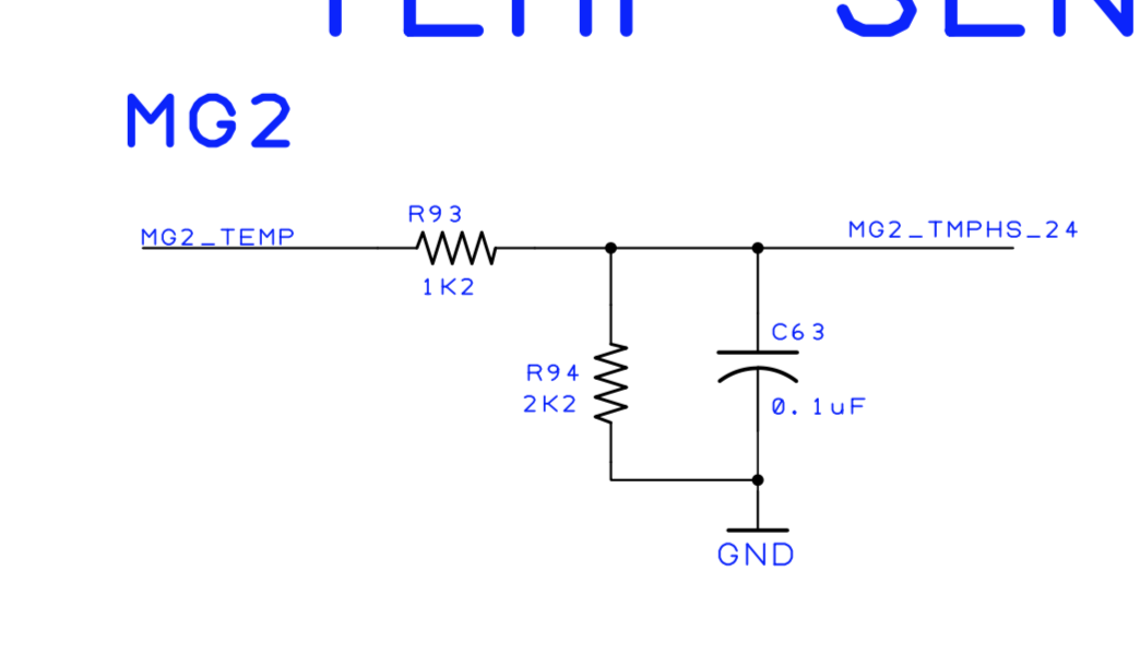

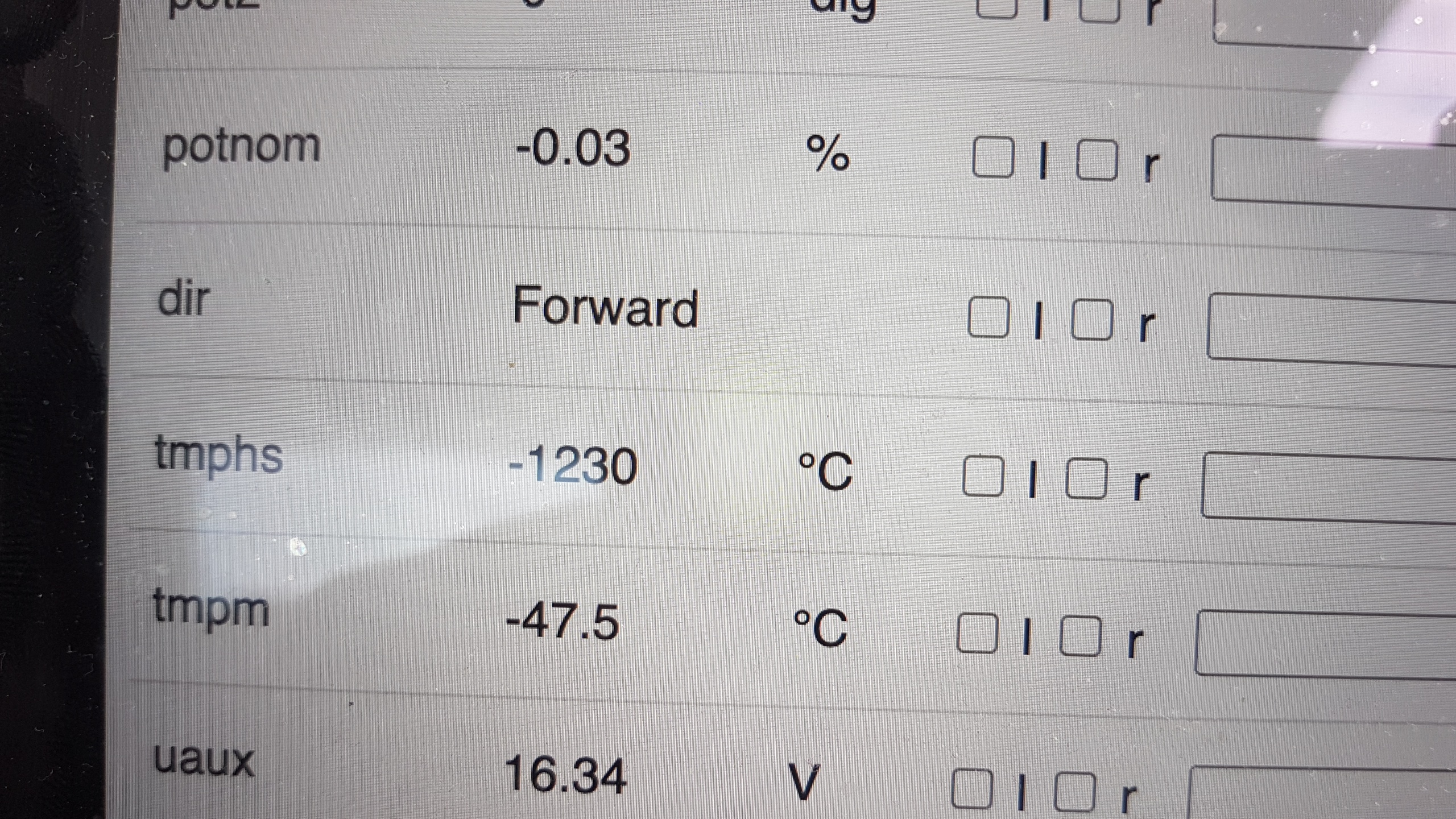

Does the prius gen 3 inverter have a 47k NTC thermistor on MG2?
I've pull one out of a dead inverter and dunked it in a mug of water, and done some extrapolation and come up with these values:
T R
0 56884
10 51815
20 46745
30 41676
40 36606
50 31537
60 26467
70 21398
80 16328
90 11259
100 6189
I've put them in to the spreadsheet and calculated the ADC values, probably wrong

It's wildly out using EVBMW gen3 board.

Looks like a 47kohm termistor, or close anyway. The resistance specified (47k) is usually at 25 degree celsius.
How have you connected the sensor and what resistors are on your PCB? R1 should be 1,2kohm and R2 2,2kohm and Th is the sensor. On early toyota boards you will need to do some patching to get this to work.

Yes and no. Isn't that for the inverter temperature sensor? MG2_TEMP seem to come from the 50-pin connector to the gate driver board.
To what pin(s) do you connect your MG2 sensor?
Or do I misunderstand and you want to measure the MG2 side of the inverter? I thought you were after the MG2 stator temperature?
That would make sens as the temperatures you have sampled does not exactly match up to what I expected from the motor sensor, as seen below. I'll have a look in the spreedsheet and get back.

I'm trying to add the MG2 heatsink sensor to the firmware.

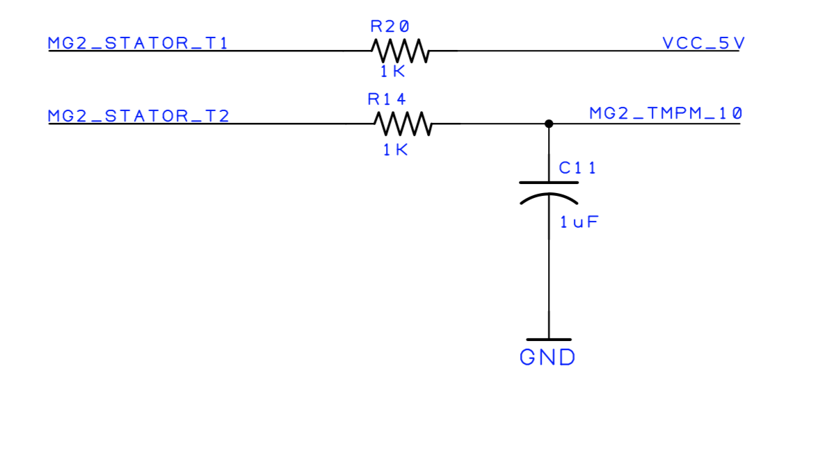

I checked my Yaris inverter and I got 4,4V at MG2_temp, resulting in 2,85V at MG2_tmphs_24. Don't know if that helps.
If you want to find out the correct values to add to firmware, the complete circuit is needed. The NTC and all resistors connected to it on the IGBT-driver board.

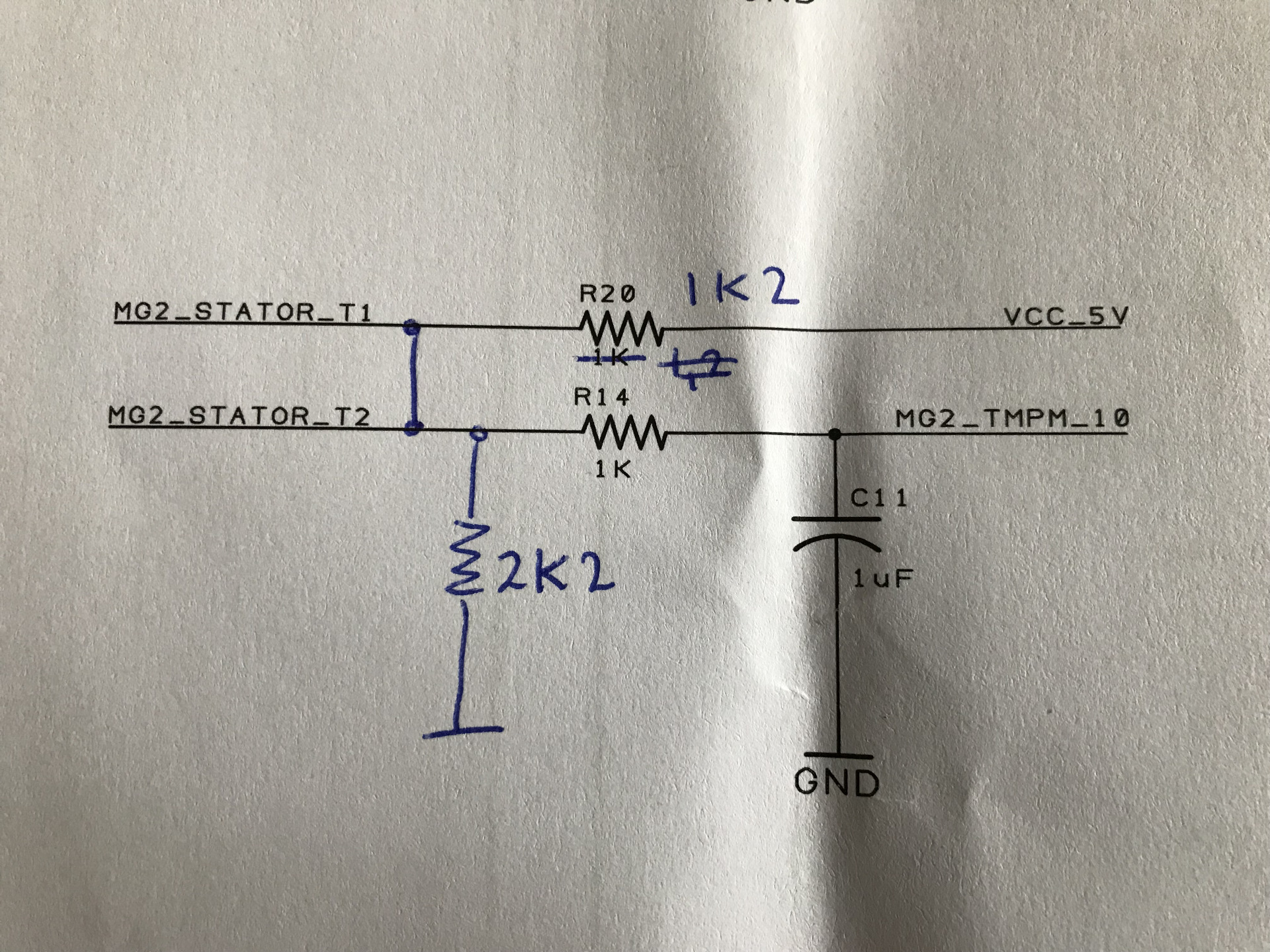

How are you working out the ADC values? I'm looking at the motor one now as it's simpler, maybe. The resistance values in the service manual match that of a 50k NTC thermistor datasheet. https://www.te.com/commerce/DocumentDel ... F4050DPHFS
The voltage divider has a capacitor and that is above my understanding.
Example of 20 degrees, resistance is 62.5k, so (62.5k + 1k + 1k) for R1 but I don't know how to calculate the value for R2 to plug in to Vo= Vs * R2 / (R1 + R2)

The graph I posted above should be the toyota motor temperature sensor temperature vs resistance.
You then need to reconfigure the circuit board so that you get the same wiring as depicted in the spreadsheet under the "Toyota 47k" tab. The temperature sensor (NTC) should be connected between MG2_STATOR_T1 and GND i.e. in parallel with the 2k2 resistor.
Then just select the toyota motor sensor in the web interface and you should be good.
If you want to do it in another way you need to calculate the expected voltage for any given temperature and then convert that to the corresponding ADC value.
For the connections as above the voltage is 5V*(2200*NTC-resistance/(2200+NTC-resistance))/((2200*NTC-resistance/(2200+NTC-resistance))+1200) and then the ADC value is (voltage from above)/3,3*4096.

Awesome, thanks, I think I should be able to do all this externally to the inverter so I don't have to take it out again. Will add this info to the wiki page once I've got my head around it.
