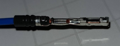

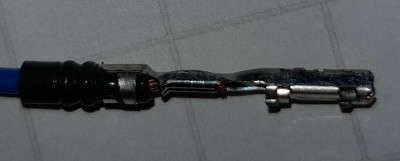

So, I have pulled a pin and took pictures.
To take the pins out you need to unlock them by mouving the white plastic part (as shown in the first image). Easily done with a small flat head screw driver.
https://imgur.com/a/Pq73LHv
I will also send an email to TE, who know maybe they'll tell me what pins to buy.

So i contacted TE via their online chat, and their answer was basically no :
https://imgur.com/a/J9cgAPu

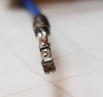

In the mean time i took appart the main motor loom from the leaf and just for fun took apart the other connectors, and suprise ! The pins are almost the same as CN001.
I've put these pins in CN001 and it worked ! They lock up and every thing.
Here are some pictures of the pins i took out :
https://imgur.com/a/qfaqpYP
Also i've noticed that on the main wiring loom they used the same type of connectors not, i think they might be the same pins inside, i'll look tomorrow.

Nice job! I reckon some of the pins on the TE web site will fit as well then should you run out of connectors to strip
Re: Leaf connector CN001
Also these pins are available directly from Toyota. We sell them to anyone. You just need the part number and how many you need ..

No, i found cables with the same type of connector. you have to take out the locking white plastic part https://imgur.com/a/Pq73LHv on the first image. Pull gently on the wire and it should come out.
The connectors i took the pins out between 6 and 10 wires attached. it was the same locking mecanism as on the CN001.
