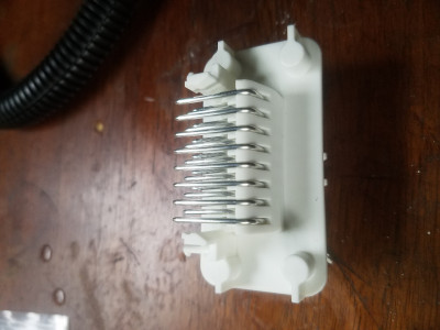

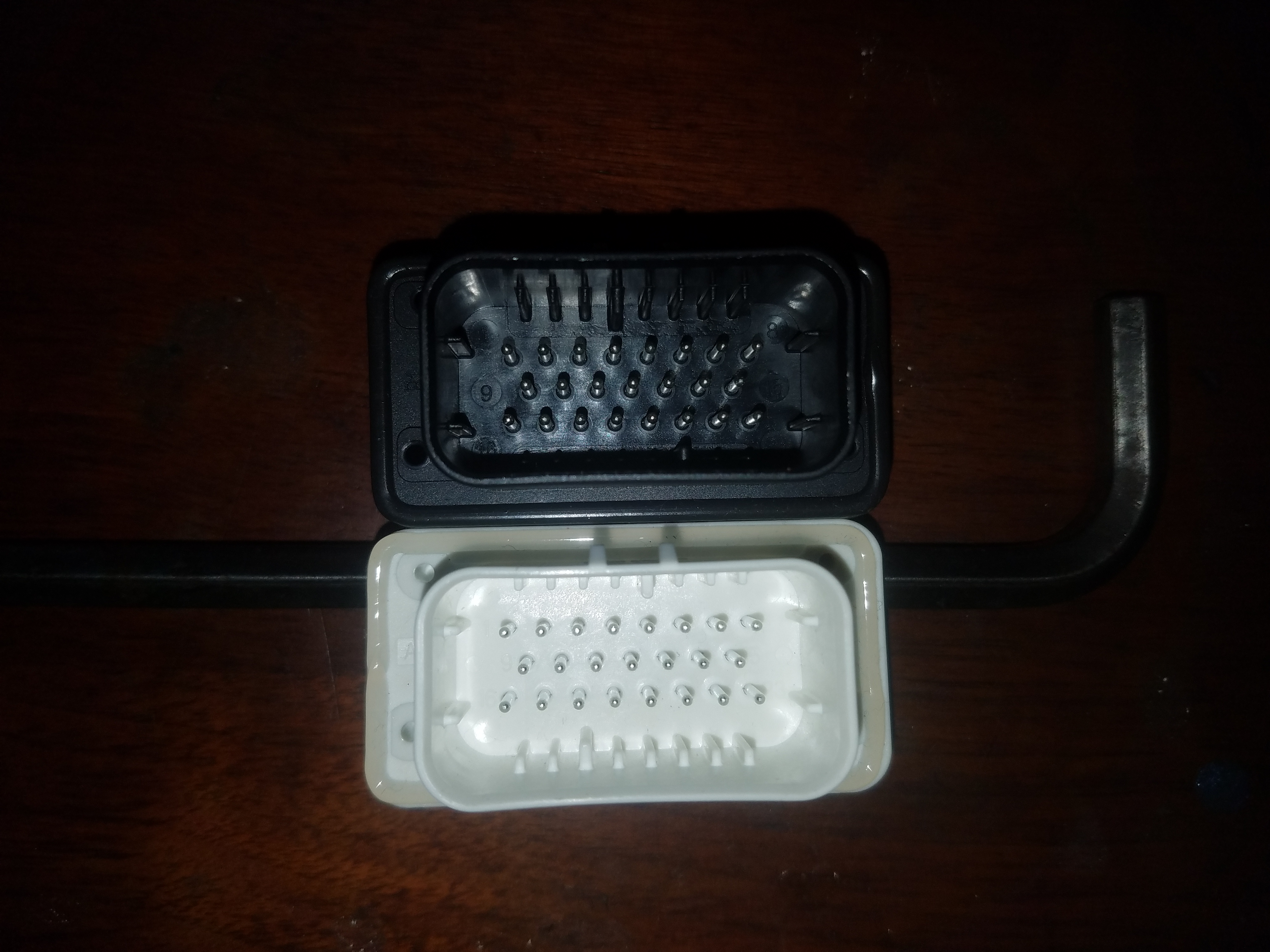

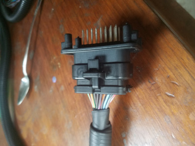

Ok got a couple of the the female connectors. One is a 90 degree TE Connectivity, however none of the plugs I bought fit it. The other is not a 90 but the harness and Male plug slide together perfect and connect perfect. So maybe I can build a largish box to attach to the side of the motor to fit all this stuff inside or modify my 90 degree to fit? It's just a bit different but I think maybe I could modify with a dremel perhaps. I will post some pics.

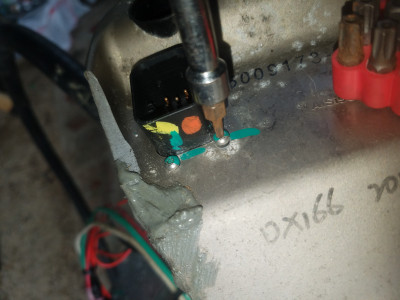

The 90 degree header is set up a little different. the large plastic alignment prong is off a little bit to the left. Tried getting good pics under my led work light. Gonna try to set up better lighting.

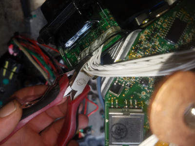

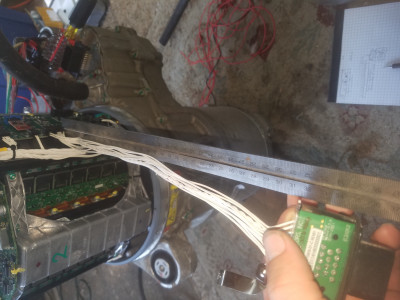

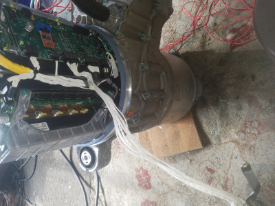

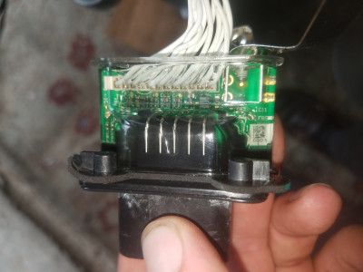

Ok opened up the case again to get a better Idea of what I am dealing with.
leman2112
Posts: 173
Joined: Sat Dec 21, 2019 10:30 am
Location: United States
Has thanked: 29 times
Re: Mercedes-Benz B Electric - motor support
Post by leman2112 »
The wiring loom all passes through some type of mercedes connector board. Should I just cut the wires off one by one, extend them to be twice as long and then solder them to the pins of my new ampseal connector that fits my harness?

I didn't actually cut all those wires yet. Haha
Posts: 2962
Has thanked: 329 times
Been thanked: 847 times
You are missing wires on the control board side. As I mentioned before in this thread. You need to source the crimps to add more wires into the board connector.

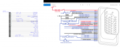

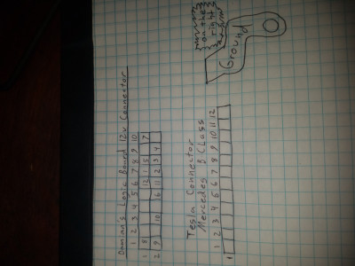

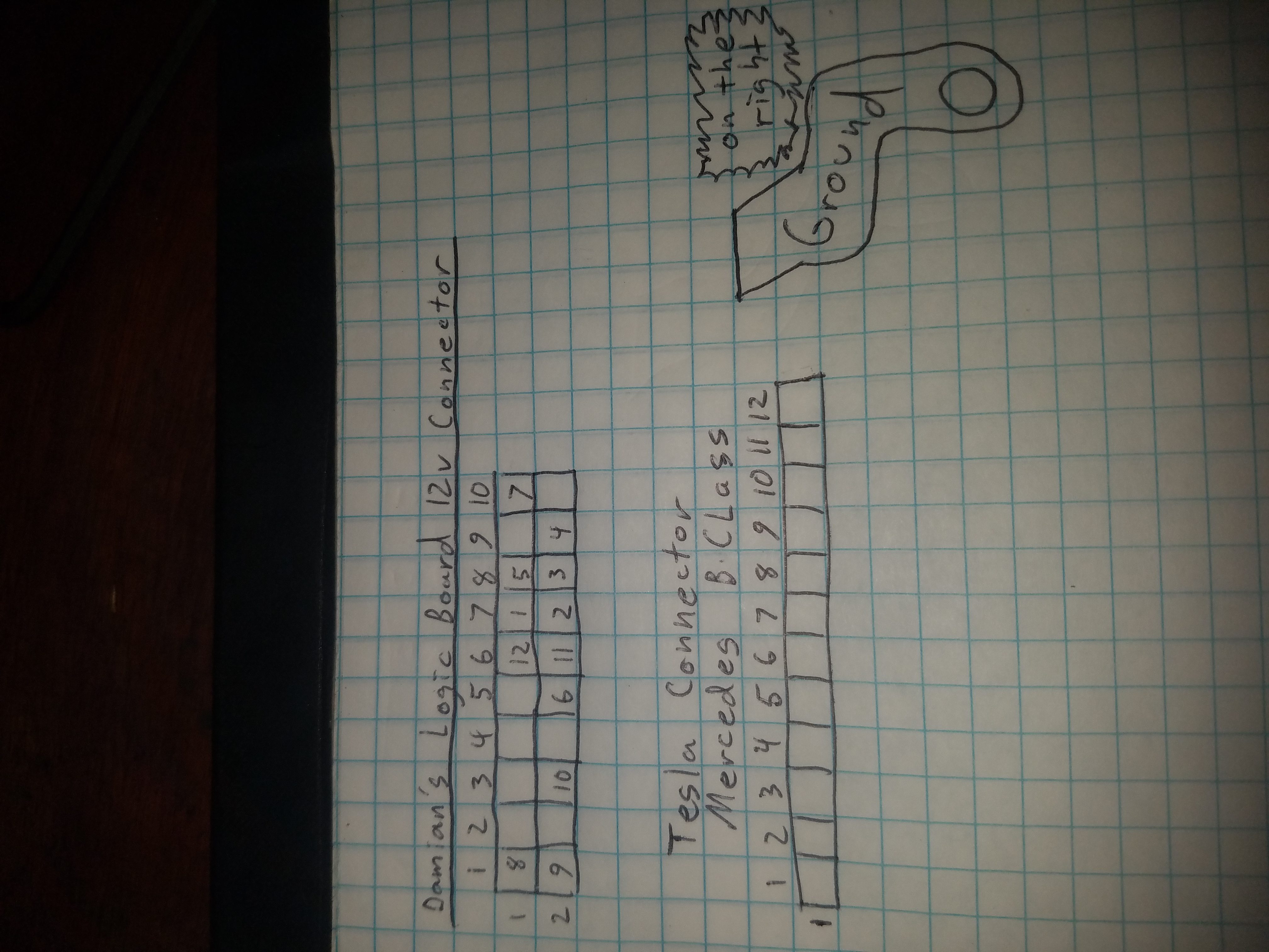

Generated a wiring pinout.
This is actually the connector from the mercedes. I need to find the 12 volt pinout from a tesla large drive unit because that is what I am trying to get to work.

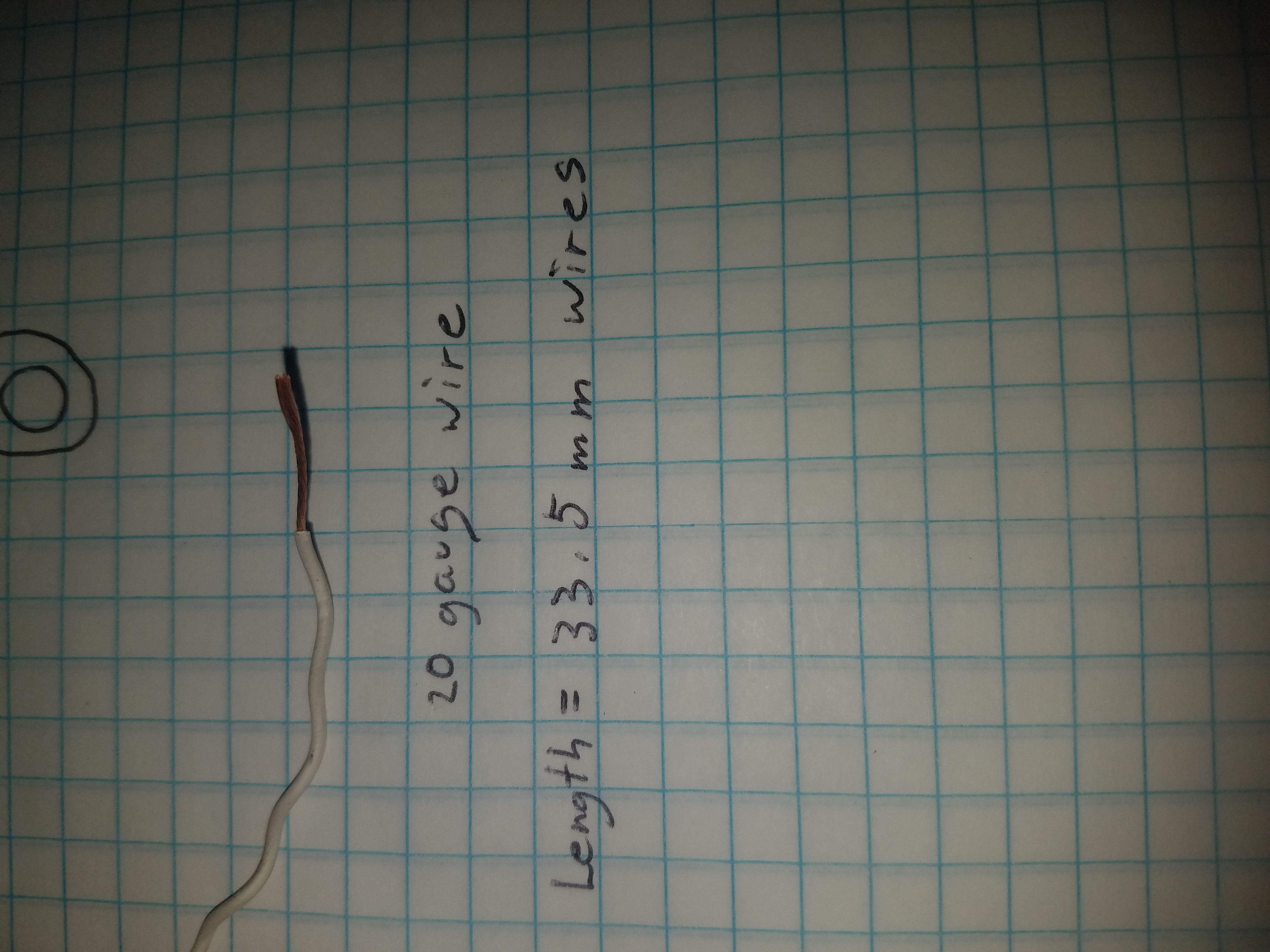

Post by leman2112 »
Now I am starting to understand. This connector needs more wires and female pins added so that I can have all the wires I need. Anyone have an idea what size I am looking for? I know the wire gauge is 20. Maybe someone knows who makes this connector or where there is a part number on the connector?
You cannot swap the "Tesla" version of connector in there, it will hit the internals as I said before.
Connector for the logic boards is: JST 24CPT-B-2A
Pins are: scpt-a021gf-0.5
