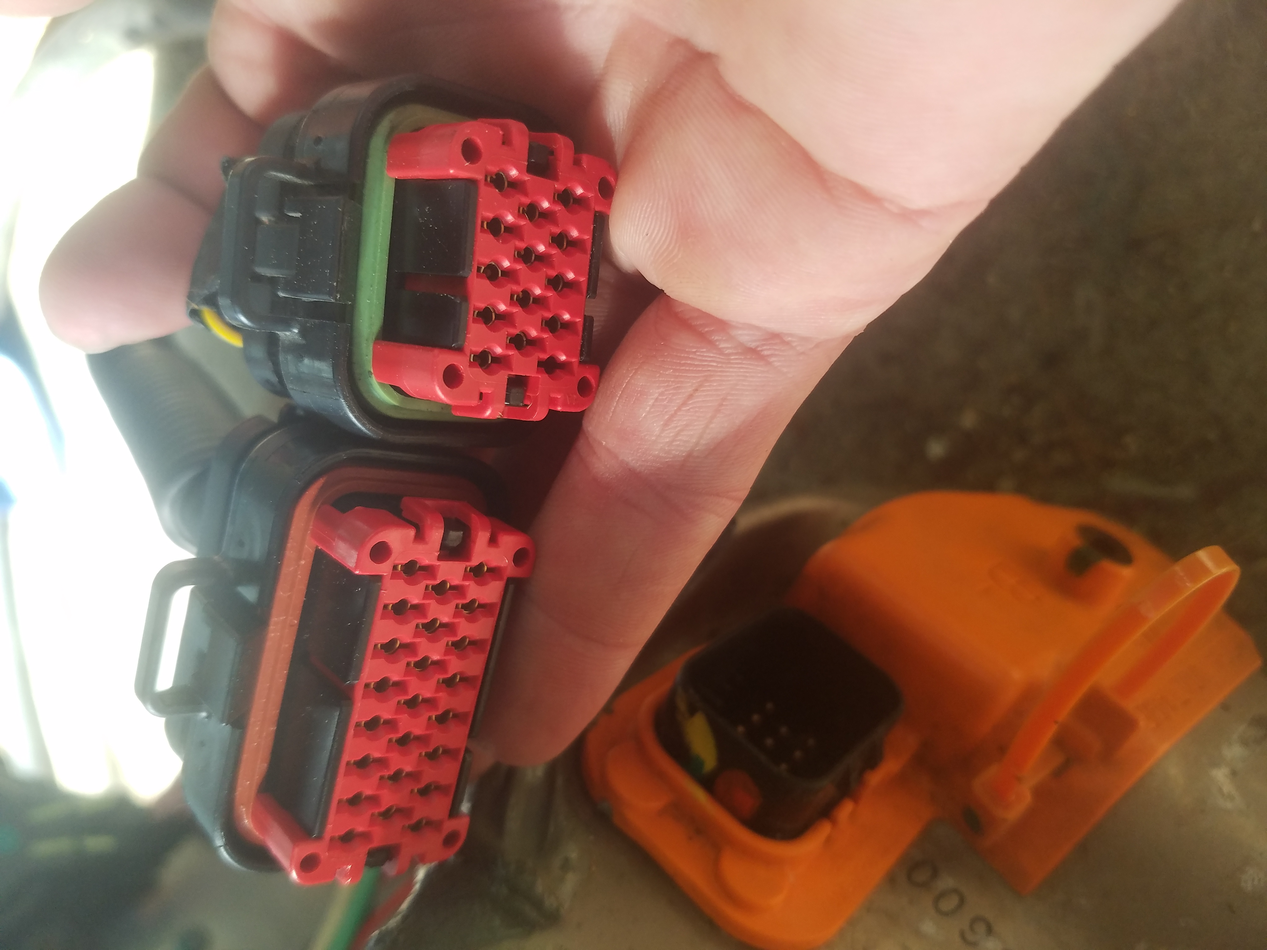

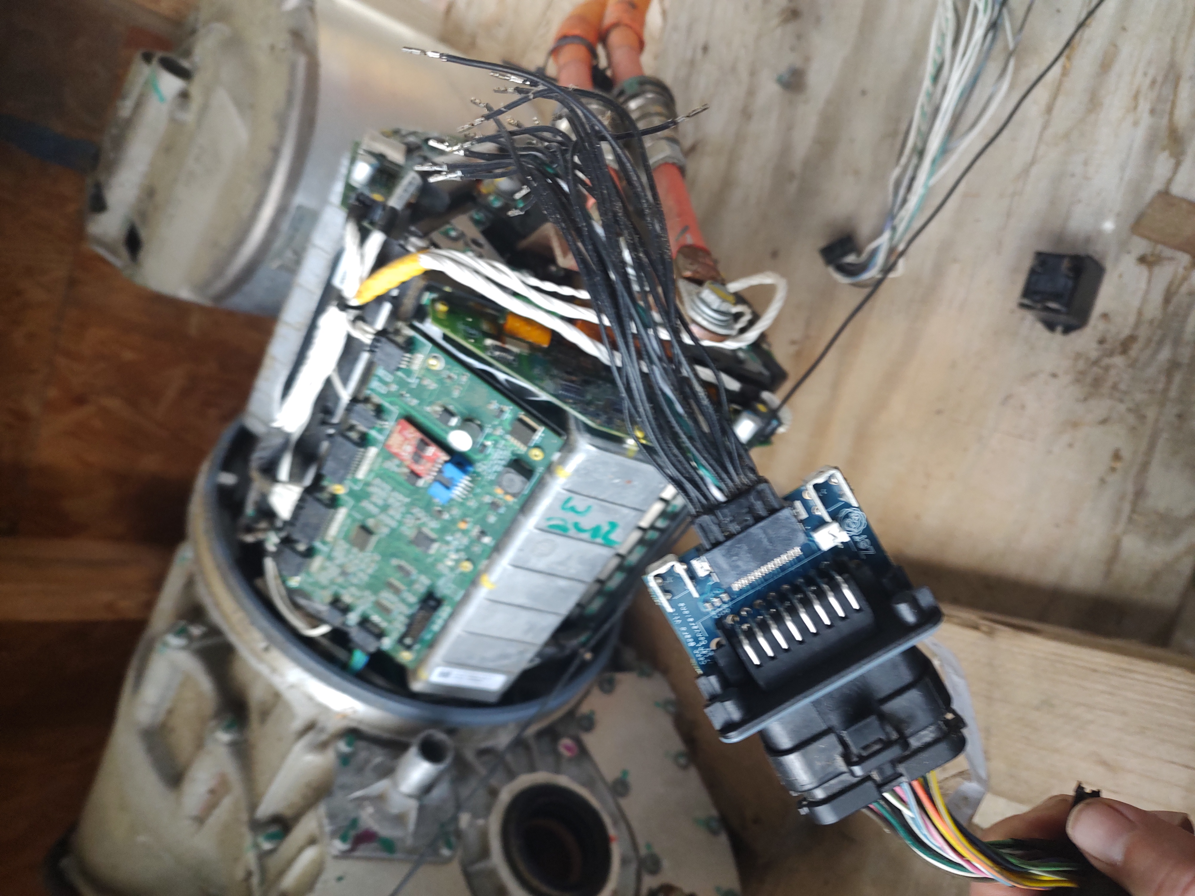

ok I think this is my 12 volt connector ya guys are talking about on my Mercedes B class large drive unit?
The picture is a 14 pin Mercedes B class inverter connector.

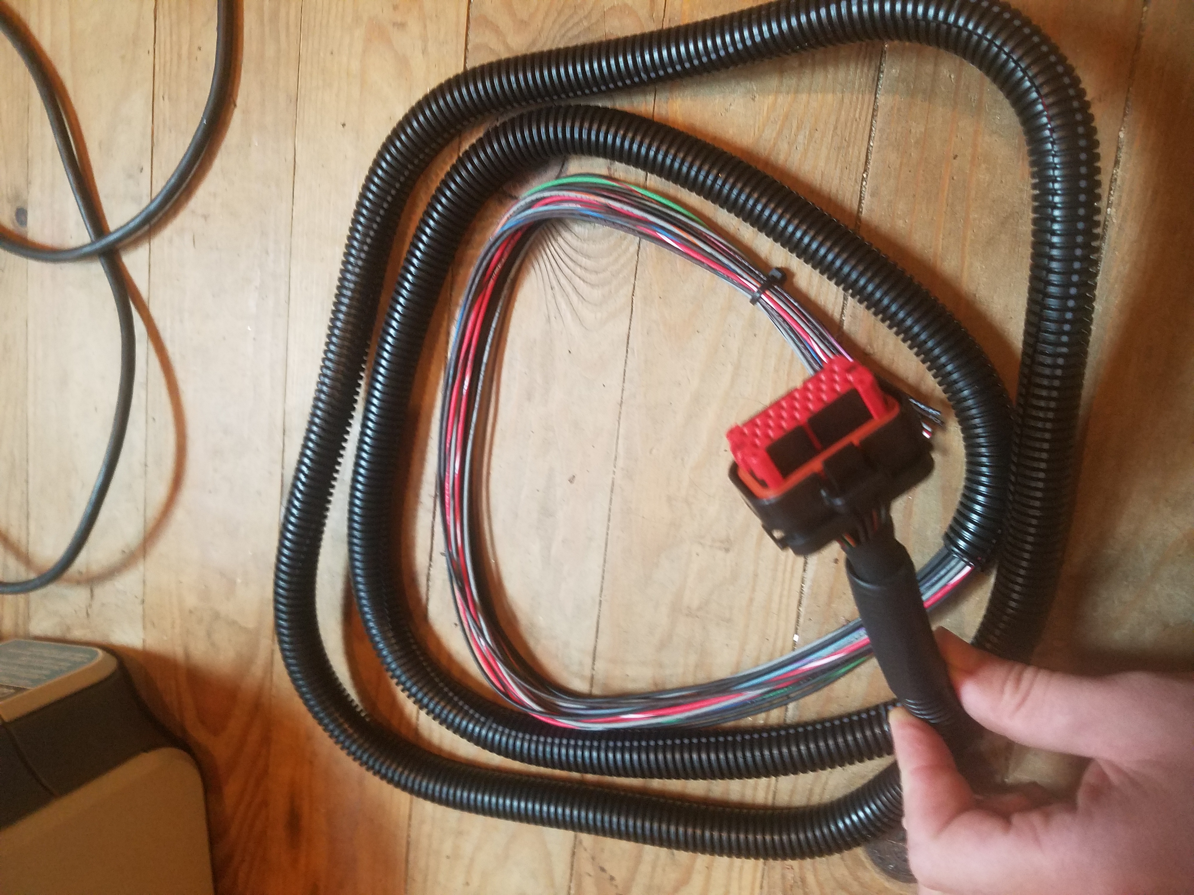

I bought a male? 23 pin amp seal ms3 connector and 8 ft harness like the one that connects to the Tesla large drive unit. Now I guess that I need a female end and to figure out how to wire it in there right? should be really awesome!!! haha

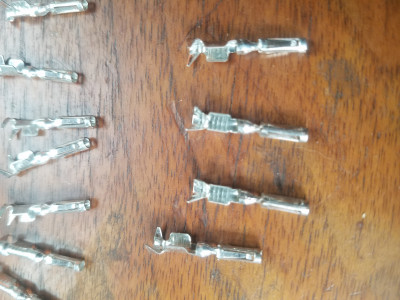

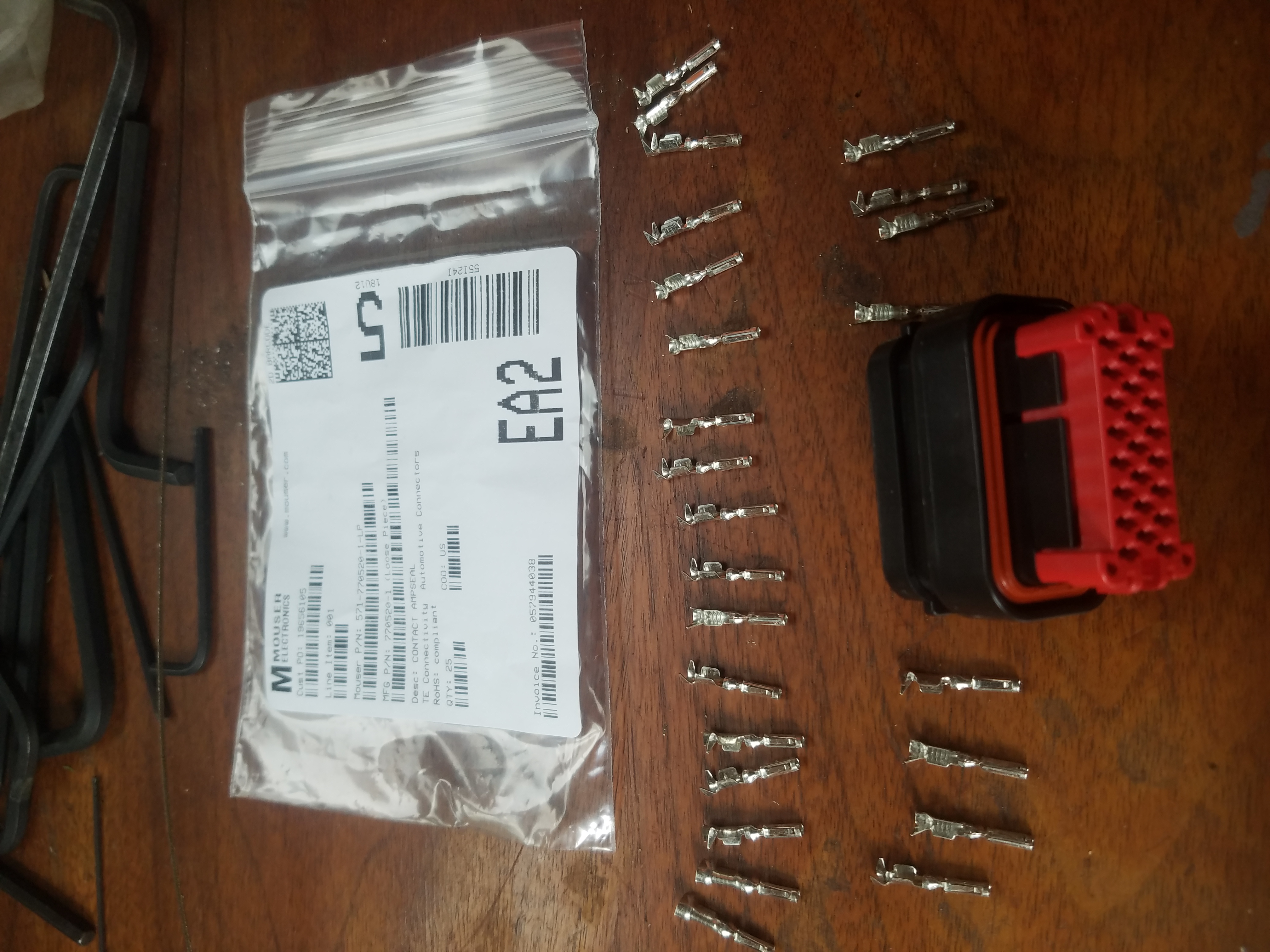

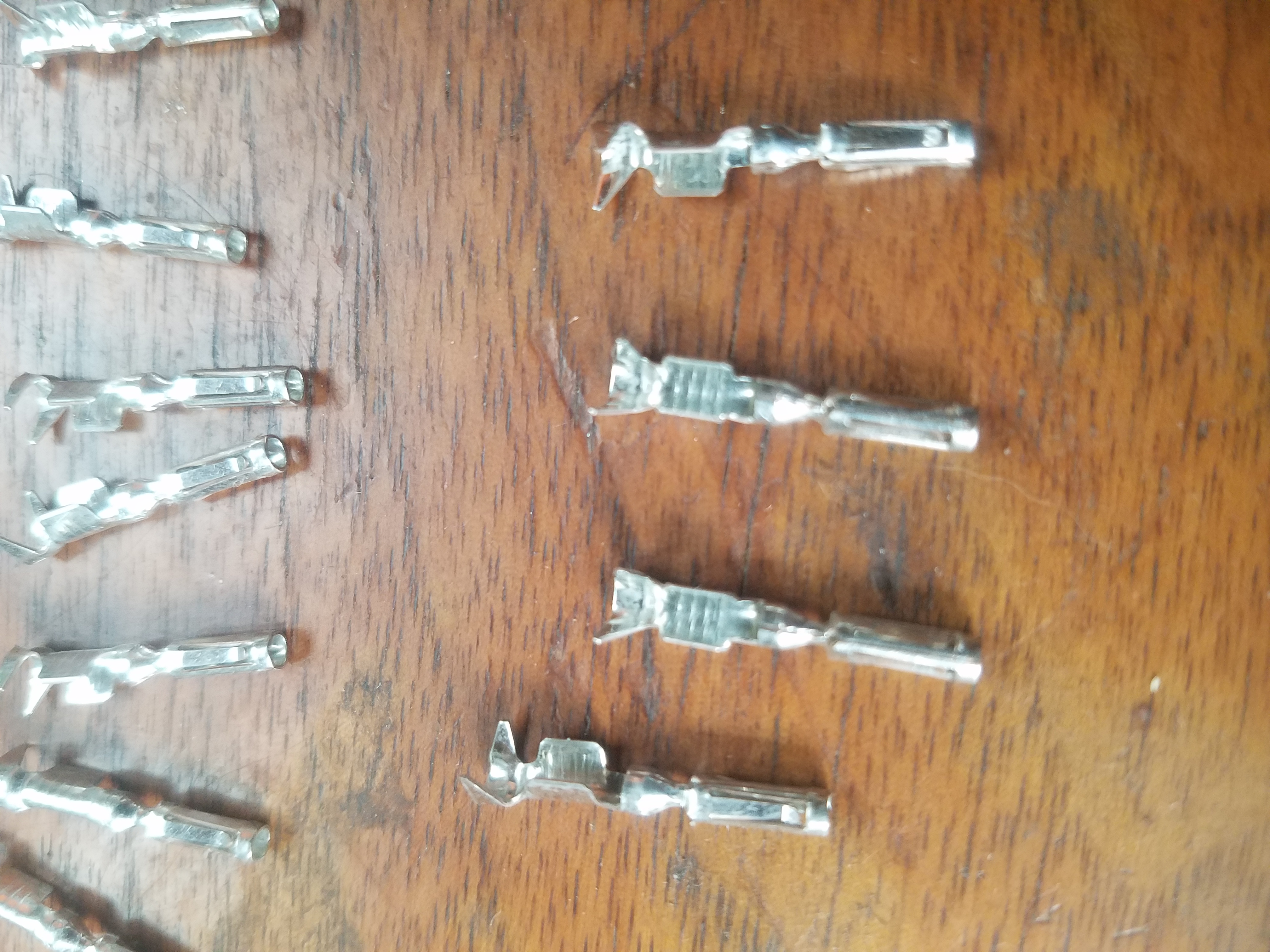

I didn't see this thread before... If you just need the connector those are Ampseal-23 connectors, very easily available within US.
https://www.mouser.com/ProductDetail/TE ... 4a0A%3D%3D
You need pins too https://www.mouser.com/ProductDetail/TE ... O0BA%3D%3D
-Isaac

Oh nice just oredered these parts! Thanks a ton Isaac!
(The pins are here but they are for the Male connector which I already have)

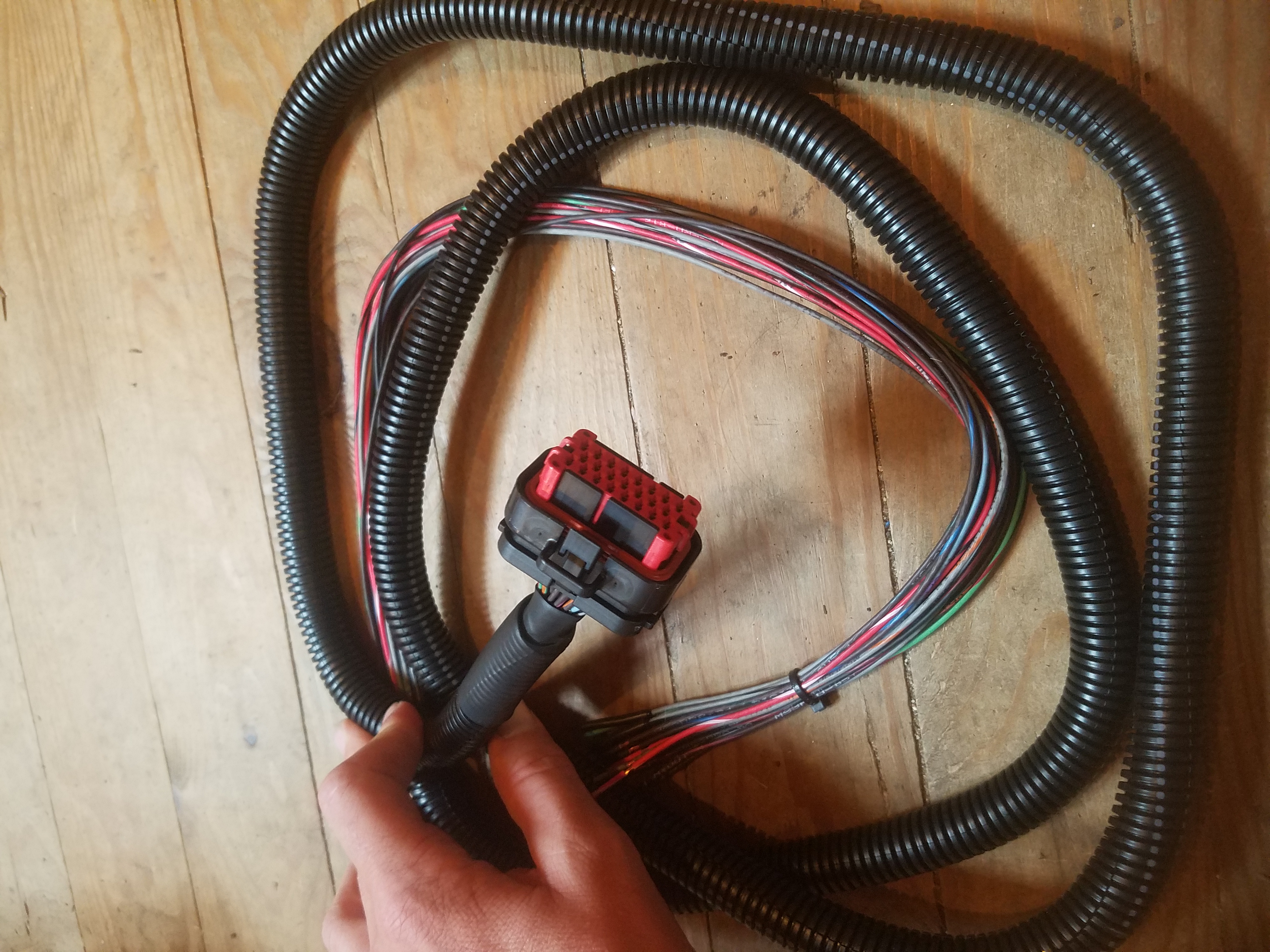

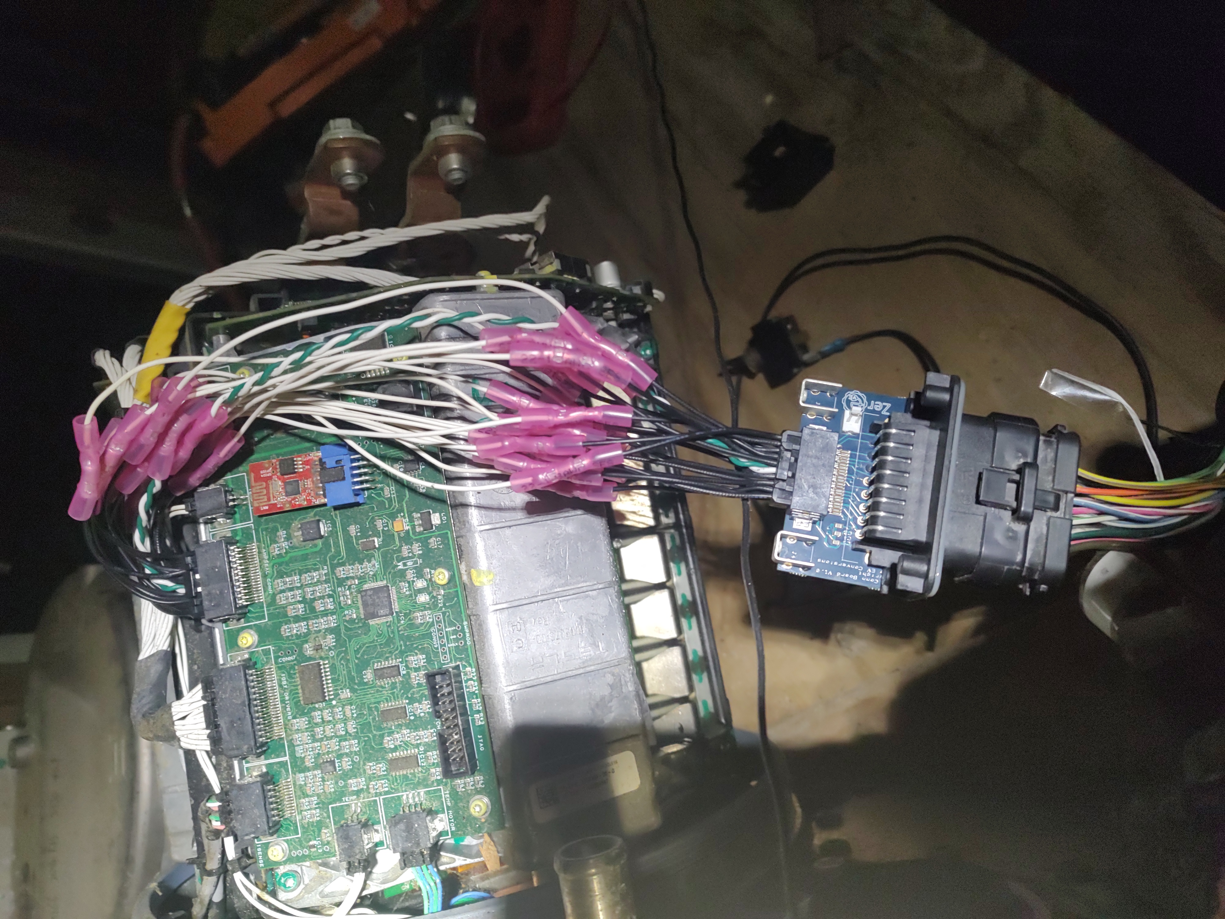

You do realise, that also the internal wiring is of a reduced pin count. Also to note due to the different clocking you cannot use the replacement or existing Tesla LDU connector boards in a Merc unit.
So what you could do but this loom for the board connector: https://zero-ev.co.uk/product/tesla-lar ... ment-loom/
Then cut off one end and extend it and solder it to a AmpSeal 23 pin 90 degree header.

Yes I have the connector and wiring loom. Here is a photo. Now I need the other side and pins.

Post by leman2112 »

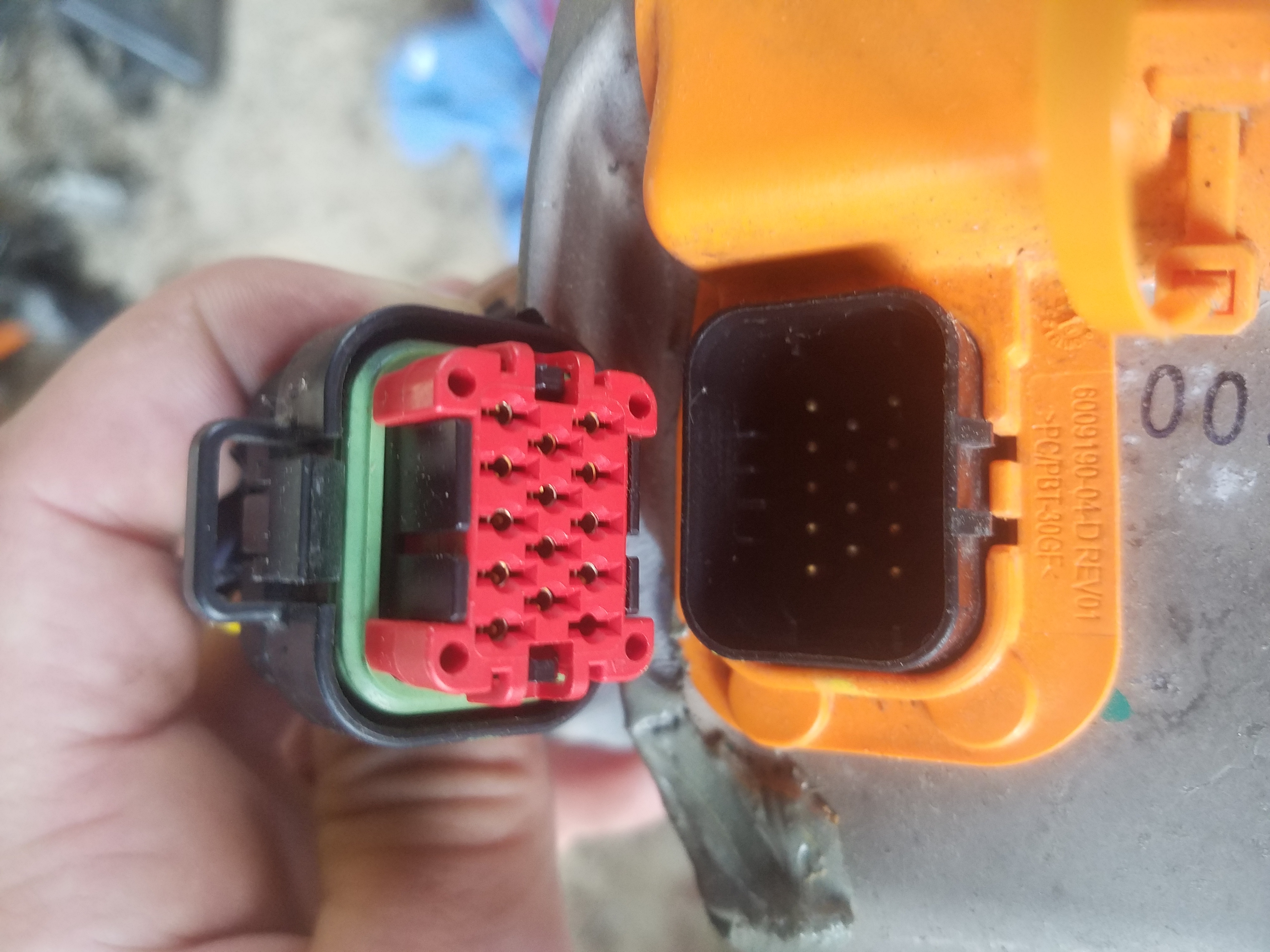

Ok got the parts that Isaac recommended and it looks like I need to find the opposite side of the connector. The part that this plugs into. All the help on this forum has been really cool, thanks guys!

These connectors are "Ampseal" brand name -- usually with the name it isn't too hard to find what you need :)
https://www.mouser.com/ProductDetail/TE ... WvWw%3D%3D
This is the other side of the red connectors.
It''s got pins built in so you just solder straight to those -- a breakout might be a good idea so you don't bend pins.
What harness do you mean? Is it this one? https://zero-ev.co.uk/product/tesla-lar ... ment-loom/

Isaac96 wrote: Sat Aug 22, 2020 4:48 pm It''s got pins built in so you just solder straight to those -- a breakout might be a good idea so you don't bend pins.
Get the one that is a 90 degree header, you ware going to need as much space as possible, due to the clocking of the Mercedes casing compared to the Tesla one the connector is positioned even tighter then normal.

I just bought the harness John Volk used on his white bmw E30 converitable that he recommends on his YouTube channel. 23 pin amp seal connector 8 foot wiring harness/loom. It was on diyautotune.com.

You still aint getting it are you, you require the internal connection from the logic board to the 90 degree header. Plus then you need to generate a pinout, from the logic board to the 90 degree header.
Once you get the 90degree header and modify the casing for it to fit, check the casing still fits on the inverter without the header smashing into something.
