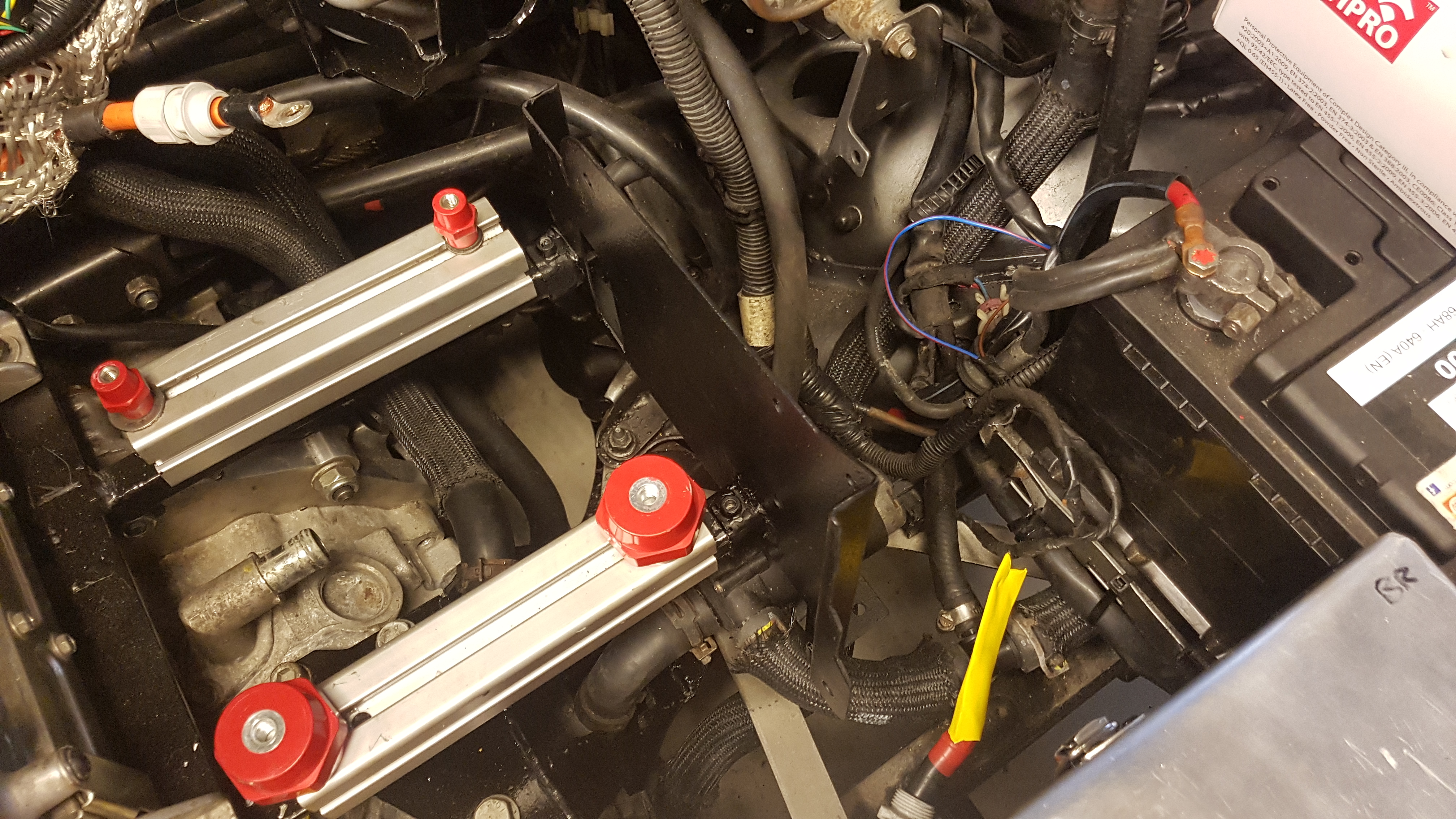

As I talked about before, the DC/DC I am using is the TDK 9M68 14B227 unit from the AZD Transit conversions. I gathered a lot of the info from various locations including from lars rengersen who fitted one to his Amazon. Thanks Lars.
Here it is in a nutshell. 100A water cooled (I did read somewhere that it was 80A if air cooled, tbc).
The control pins.
Pin 1 is to disable. Pulling the enable pin to ground, turns off the power supply. Good direction from Lars here was to enable Pin 1 only after precharge is complete as you want the precharge energy to go do the inverter capacitors and nothing else. I actually tried this out inadvertently earlier and sure enough, the main connector wont close if the DC/DC is operating.
Pin 3 controls the output voltage. Not connected it is 14.5v. Pulled to ground is 13.8v.
Pin 6 is a fault pin.... I have no idea what this is for...
The connector can be found on Alibaba - 90980-11658 10 hole Transmission solenoid valve plug for TOYOTA
http://www.kinkong-connector.com/produc ... ID898.html
I have a few on the way so, if anyone needs one, let me know.
Back to the fitting of the unit, after a lot of placing it here and there, I decided on mounting it to the HVJB frame box section. I fabb'd up a mounting plate from some old electrical box and welded on 2 x box section next size up as they sleeved perfectly together and makes it easy to unbolt and remove if needs be. Welded on some bolts to allow for good securing points.
After some adjustments, its a nice fit. As a consequence of its location however, I had to raise the HVJB by 100mm to ensure the + HV cable would not be blocked by the DC/DC HV input.
All fitted and wired up and the coolant system amended - it now goes from Inverter to DC/DC to motor. Not sure if this is good/bad but, we'll keep an eye on the temps as we go. I dont expect anything to get relly that hot as I have the loop going via the heater matrix also. Really happy with the finished result.

I have one of those dcdc in the E65. When the main contactor closes I use a relay to enable.

Is that a legal demand or just a "good" procedure? Because i certainly didnt wire it that way.
I have 20A HV fuse (original) and DCDC is wired directly before contactor. Also i trigger DCDC enable pin before i perform precharge. This allows me to have a steady 12V supply for all the fans and appliances when inverter actually comes under precharge. This means 12Vdc is stable enough to supply enough power to keep precharge relay and eventually DC contactor engaged.
When i would be required to do any maintenance on HV i allways pull the HV disconnect!
I havent had a DCDC problem yet... on both cars.

I have an 80A HV aux fuse after the contactor. You can see it here on the left of the main HV fuse.
What I don't get is, I had a temporary setup kind of like you have, enabling the DCDC first but found the precharge session never completed and main closing, hence, I thought the DCDC was just taking all the juice and the time set in the firmware was elapsing between precharge and main so Main was never triggered. How are you triggering the enable for the DCDC before precharge? Is it built into the code?

I have also connected my DCDC before contactors. The 12v enable happens with the ignition on.
I previously had issues connecting after the contactors. It kept blowing 20amp HV fuses on start up. Presume this was down to a voltage spike when capacitors were charging.
