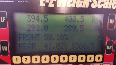

In more postive news, I got to weight the car . Not bad considering. 58/42 weight distribution and corner weights are within 5kg of each other. A little nose heavy but good for a FWD car I guess correct me if I am wrong. Overall weight is down about 20kg, that includes 10kg dummy ballast in the boot for charger and other bits.

That's very good news... any idea what the original ICE car weighed?Cookie6000 wrote: ↑Sat Aug 15, 2020 10:26 am In more postive news, I got to weight the car . Not bad considering. 58/42 weight distribution and corner weights are within 5kg of each other. A little nose heavy but good for a FWD car I guess correct me if I am wrong. Overall weight is down about 20kg, that includes 10kg dummy ballast in the boot for charger and other bits.

Gross weight is 1870kg on the VIN plate but the kerb weight is anything between 1260kg to 1380kg depending where you search. Either way, it's just below or close to the same weight as it was before.

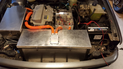

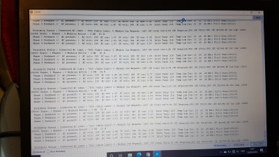

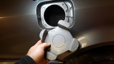

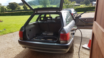

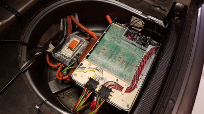

Bit more of an update since the full pack fitting and roll.
We need to get this car charging so have fitted the Model S/X Gen 2 10kW charger and Damiens V4 brain board. Swapping and setting up the new V4 board was straight forward. I have the AC set to 3 Amps to start as I get things up and running. Going with single phase from a 32A breaker so not convinced the stock 2mm wires from the Leaf type 1 port will be up to much more as it gets cranked up . Will swap them out once testing is over. As another temp solution till I get some more cash, the DC and AC 2mm HV interconnecting between the Gen 2 charger, hence the glorious mix of red and earth 2mm wires, all hooked up to the extememly handy Tesla HVJB to connect everything up. I found my solar PV DC cable crimper the perfect fit for the 171825-0100 connectors to fit the molex 44441-2006 housing. 12v added via a supply from the ABS unit in the boot plus the proximity and control and the HVJB, charger and anything else that felt the need is well grounded to the chassis. And yes... eagle eyes may have noticed that I did see fit to loacte the precious Gen 2 on a block of solid mahogany. Quite an insulator... To get me hooked up, I found a great stock clearance deal from myenergi on ebay for a Type 1 EVSE. Found some 6sq T&E on the local 'sell you anything' Adverts.ie so hope to have that tomorrow to get that connected up. Next up make a decent job of the charge port. I found the original weather seal from the old tank filler which had the same diameter as the rubber neck on the charge port. Perfect I stepped back into my Cardboard Aided Design shoes and made myself a template to secure the socket to that would take the force of many, many, many (presumption much...) many, many chargings. Took all day, fitting, refitting, tweaking as I'm all about the detail but, happy with the result. Next up, the too long forgotten DC/DC. I had been trying to get the old Leaf DC converter working but just didn't spend the time in getting a PWM signal knocked up for it. I was talking to kevin about it and he suggested the water cooled TDK DC/DC unit fitted to the Ford Transit Connect by Azure Dynamics and other hybrids in the ford range. Lars then graciously sent me on the control pinout on how to get it running. Pretty robust and simple unit really and I'll go into more detail on it in the next update when I get it fitted.

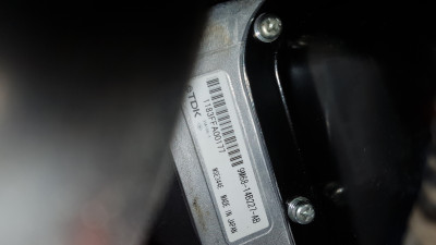

Thanks for the encouraging feedback all! Much appreciated. Much the work is based upon many who have gone before

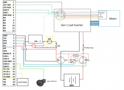

As I talked about before, the DC/DC I am using is the TDK 9M68 14B227 unit from the AZD Transit conversions. I gathered a lot of the info from various locations including from lars rengersen who fitted one to his Amazon. Thanks Lars. Here it is in a nutshell. 100A water cooled (I did read somewhere that it was 80A if air cooled, tbc).
The control pins.
Pin 1 is to disable. Pulling the enable pin to ground, turns off the power supply. Good direction from Lars here was to enable Pin 1 only after precharge is complete as you want the precharge energy to go do the inverter capacitors and nothing else. I actually tried this out inadvertently earlier and sure enough, the main connector wont close if the DC/DC is operating.
Pin 3 controls the output voltage. Not connected it is 14.5v. Pulled to ground is 13.8v.
Pin 6 is a fault pin.... I have no idea what this is for...
The connector can be found on Alibaba - 90980-11658 10 hole Transmission solenoid valve plug for TOYOTA
http://www.kinkong-connector.com/produc ... ID898.html
I have a few on the way so, if anyone needs one, let me know. Back to the fitting of the unit, after a lot of placing it here and there, I decided on mounting it to the HVJB frame box section. I fabb'd up a mounting plate from some old electrical box and welded on 2 x box section next size up as they sleeved perfectly together and makes it easy to unbolt and remove if needs be. Welded on some bolts to allow for good securing points. After some adjustments, its a nice fit. As a consequence of its location however, I had to raise the HVJB by 100mm to ensure the + HV cable would not be blocked by the DC/DC HV input. All fitted and wired up and the coolant system amended - it now goes from Inverter to DC/DC to motor. Not sure if this is good/bad but, we'll keep an eye on the temps as we go. I dont expect anything to get relly that hot as I have the loop going via the heater matrix also. Really happy with the finished result.
Stupid question time... It's about control of Pin 1 enable. How would you do it? I'm using Damien's Leaf VCU in the configuration below bearing in mind that precharge remains on after the main contactor closes. I tried tieing Pin 1 to the ground of precharge and obviously, nothing happened. I feel I might be about to facepalm when someone comes back with an obvious answer... I'm just tired

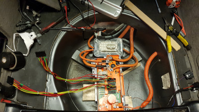

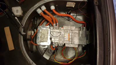

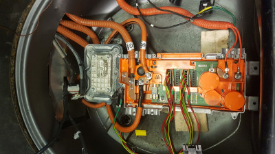

Had a few days off on two wheeled adventure but back to it this week and getting charging under way.
The trip away kind of cleared the head a bit as I was sure I had not wired the charge part of the HV system correctly and sure enough, when I laid eyes on it again, realised I needed to complete the negative side of the charge loop from most Positive to most Negative. Seeing as I have an unorthodox design with split pack in series and the charger in the boot, I needed to run a new Neg HV run from front to rear. Not ideal but gets me charging albeit in a manual fashion. I haver the Gen 2 charger on a perm live switch in the boot. I flick the switch and then plug in the J1772 soon after and away we go.I need to get to a point where it is controlled when Ign is off and Out1 on the Tesla charger triggers the DC contactor and coolant flow in a different charge loop setup. for now, this is how it looks with a note that I have yet to add the cooling. Any charging was only for a minute to prevent any overheating. On the day I first tried it, all worked really well with the added help of the sun being out helping the 3.8kW of PV I have on the roof of the workshop. As a result, even while I was charging, there was still 0.2kW in reserve going back to the grid... for free... bah! Still, free charging!! For now until I get the coolant loop added, I just had the AC current limit set to 5A. We'll ramp things up when we are sure I can keep the Gen 2 cool. Last thing to do now is patch up that gaping hole in the spare wheel well which I started last week, adding a few 25mm glands for the HV and securing the tesla HVJB and the charger so they don't go anywhere. Final question. I asked before but got no reply. It's about the DC/DC enable/disable. It needs to be disabled during inverter precharge and enabled when main contactor closes. When grounded, Pin 1 disables the power supply. When it's floating, its starts it. Advice on how best to trigger this ground/float in the startup sequence?

I have one of those dcdc in the E65. When the main contactor closes I use a relay to enable.

Is that a legal demand or just a "good" procedure? Because i certainly didnt wire it that way.Cookie6000 wrote: ↑Fri Sep 25, 2020 8:45 am Final question. I asked before but got no reply. It's about the DC/DC enable/disable. It needs to be disabled during inverter precharge and enabled when main contactor closes. When grounded, Pin 1 disables the power supply. When it's floating, its starts it. Advice on how best to trigger this ground/float in the startup sequence?
I have 20A HV fuse (original) and DCDC is wired directly before contactor. Also i trigger DCDC enable pin before i perform precharge. This allows me to have a steady 12V supply for all the fans and appliances when inverter actually comes under precharge. This means 12Vdc is stable enough to supply enough power to keep precharge relay and eventually DC contactor engaged.
When i would be required to do any maintenance on HV i allways pull the HV disconnect!
I havent had a DCDC problem yet... on both cars.

Thanks arber. No legal requirement. Just the way I had seen it before.arber333 wrote: ↑Fri Sep 25, 2020 11:43 am

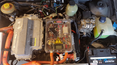

I have an 80A HV aux fuse after the contactor. You can see it here on the left of the main HV fuse. What I don't get is, I had a temporary setup kind of like you have, enabling the DCDC first but found the precharge session never completed and main closing, hence, I thought the DCDC was just taking all the juice and the time set in the firmware was elapsing between precharge and main so Main was never triggered. How are you triggering the enable for the DCDC before precharge? Is it built into the code?

Well yeah... i think i have like 50R precharge resistor in Volt inverter so current doesnt have any problems running there. But in any case i use 2s precharge preset in Pic12F which is on my Lebowski board and enables GND connection to DC relay.Cookie6000 wrote: ↑Fri Sep 25, 2020 2:07 pm What I don't get is, I had a temporary setup kind of like you have, enabling the DCDC first but found the precharge session never completed and main closing, hence, I thought the DCDC was just taking all the juice and the time set in the firmware was elapsing between precharge and main so Main was never triggered. How are you triggering the enable for the DCDC before precharge? Is it built into the code?

Re: The Audi 8e - Powered by Leaf
I have also connected my DCDC before contactors. The 12v enable happens with the ignition on.
I previously had issues connecting after the contactors. It kept blowing 20amp HV fuses on start up. Presume this was down to a voltage spike when capacitors were charging.
