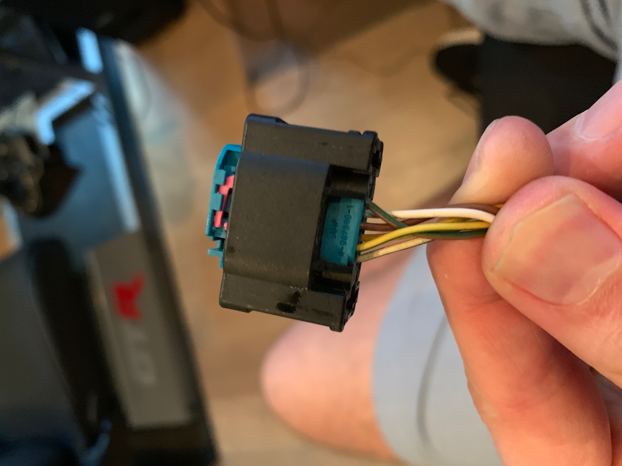

OK, lots of good progress tonight. Managed to get the harness in a good state so that I can continue testing. I also received my BMW pedal in the mail (specifically part # 3540 6762480-02). Only thing I'm struggling with now is to figure out the pin order for the connector there. It's a 6 pin connected harness and there's not much info on the web.
Damien, do you happen to know the pin order?

Hold the press! I think I just figured it out..
Pin 1 = Signal
Pin 2 = Ground
Pin 3 = +5v
Let me know if that sounds right, Damien. Using the chart plotting it seems to respond and I was able to determine a min and max POT.
