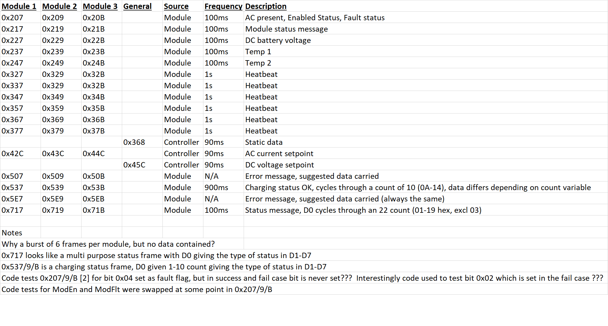

I have done some analysis of the CAN frames from the 1 module good charge and 2 modules failed charge, just to see how they might be different and how the frames from the software look like.
Analysis : Shows the frame IDs from the successful 1 module run, and the frame IDs from the failed 2 module run
Current : Some calculations looking at the current request data set to the modules (US and UK differ here in that current request is divided across 3 modules whether they are active or not - in the US code)
Mod1 successful log : Module 1 activated and charging successfully
Mod12 failed charge log : Modules 1 and 2 activated, but never get to charging successfully
I don't see anything obvious from the logs, but I think I've spotted the period during which the charger tries or prepares to start and then fails. I highlighted the start and end of a charge start period, and also highlighted with red text some messages that look a little odd.
There's no obvious "the module checked something and is not going to fail message". Interestingly some frames that are specific to the fail log are produced all through the test, even before the 'start charging' command is issued. This seems odd because how would the charger know that it is going to be requested to enable two modules? Some more detailed logging also capturing the logs on the controller serial might be in order to understand exactly what's happening when the two module startup is requested.
Jeff

Due to way too many hours spent on airplanes today (about 22hrs in total) I did lots of examining and reasoning about how the charger internal CAN traffic scheme might be set up. The scheme (built up from examining the logs and internals of the Gen2Tesla charger software from Damien and Tom DeBree) seems to make sense, but still lots of questions, especially on 0x717 and the 0x537/9/B as they look like they are using byte D0 to say what data they are reporting on. For 0x717 there are differences in the data between the successful and unsuccessful charging logs. A bit more digging might reveal what data the modules are reporting (when successfully charging).
I also can't think of any reason why there would be a burst of 6 frames (0x32? through 0x37?) for each of the 3 modules. Maybe the modules themselves have six of something internally and the 6 frames for each module is a report on their status? These codes report whether the charge is successful or not. So probably just a heatbeat signal (but 6 per module?)
I'm digging through the data to see if I can find anything that occurs or is concurrent with the charger failure to start charging with 2 modules enabled. There are some codes 0x507/9/B and 0x5E7/9/B that appear to occur when the charger is failing or resetting. Both frame sets look to be carrying data. The 0x5E? set reports the same data for all modules and the same data in every report. The 0x50? data also carries data, and the values there do change from report to report.
