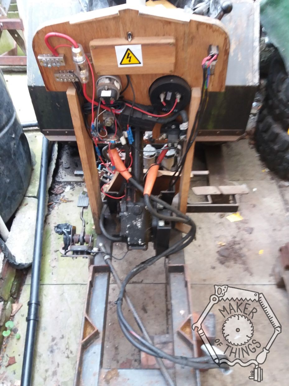

I dismantled my electric tractor to make space for the car conversion... :cry:
Almost got it all apart and put away but the rain started.
Full write up on my blog.
