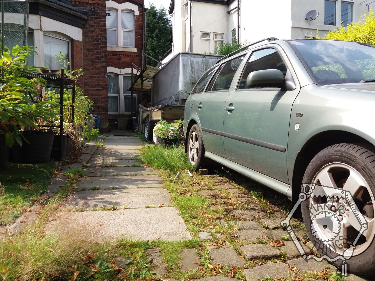

I need to reorganise the drive.
It is a narrow drive sloping down to the entrance gates and is a cobble surface, not an ideal surface for trolley jacks, axle stands, and engine cranes to operate on. So I will need to pull two trailers off the drive and put the Octavia in bonnet first to the top end under the car port.
But before that I also need to extend the paving slabbed area at the top end to at least as far as the end of the car port.
I do have some slabs ready so I just need to move other project stuff out the way and get on with putting slabs down in preparation for the move around. The front of the car will only be part way under so as long as it is enough to get the crane in safely then that should be ok.
Current mileage is 241027 miles.

Just a quick one.
I have started the driveway tidy and loaded up a pair of Citroen 2CV axles, complete with driveshafts and suspension, and a caravan axle. these might be saleable. I also stripped down a big range cooker and an electric hospital bed, both of which will be a good source of steel stock that might come in useful for the conversion. Saves buying it in new for brackets and folded boxes.
There is a load more stuff to sort out and then I can pull the trailers out and move the Skoda up the drive where it will be easier and safer to start the conversion.
Also no point having an immobile car blocking the drive for getting the trailers out.
I know some of this will be tedious and boring pre conversion stuff, so I will keep these posts brief, with more detail in my blog for the strange people who are really interested in the background slog.

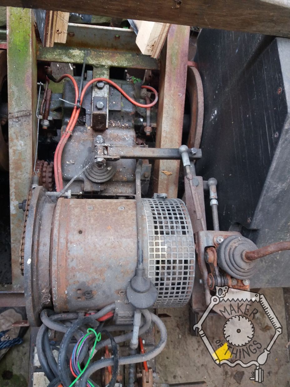

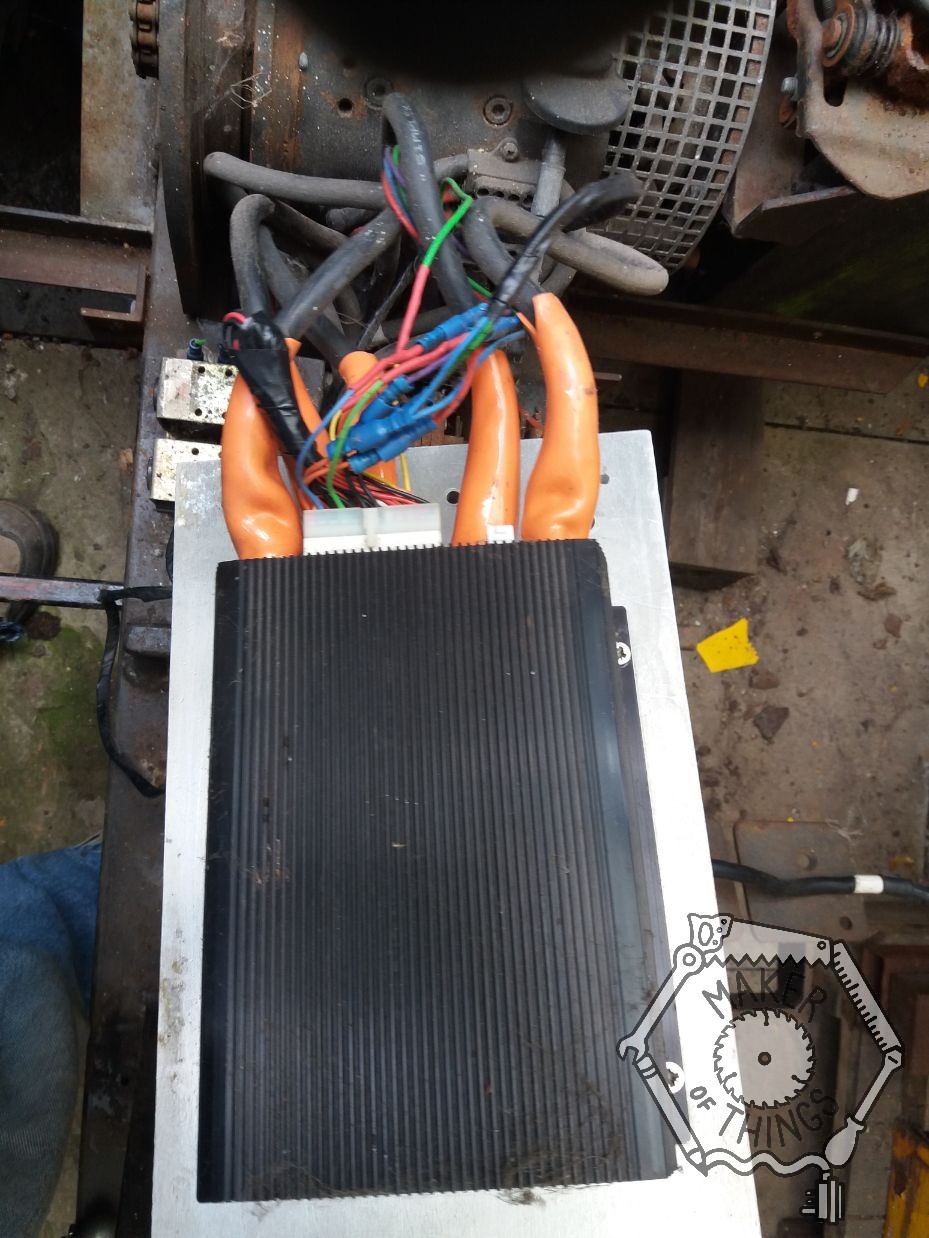

I dismantled my electric tractor to make space for the car conversion... :cry:
Almost got it all apart and put away but the rain started.
Full write up on my blog.
