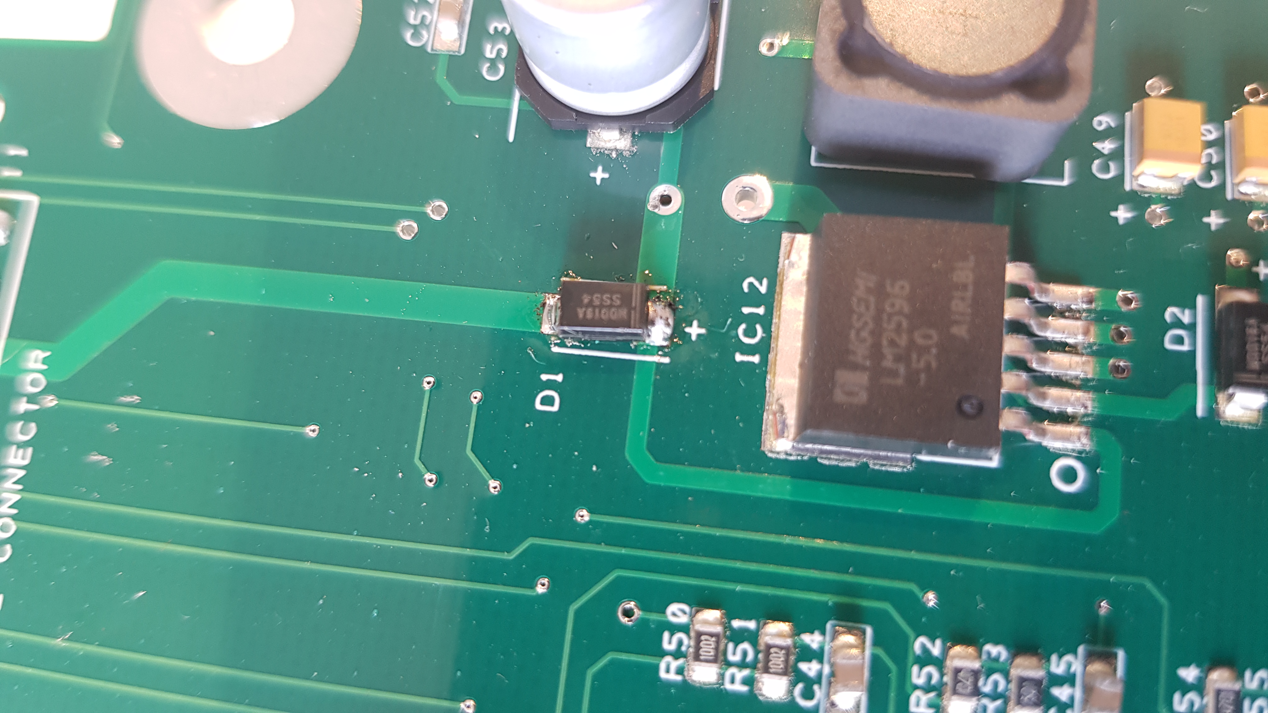

Hi all,
I think i found a small error on the V6 board.
The diode D1 needs to be backward ( ie the cathode of the diode needs to be on the side where the + is marked)
Picture of a warking board atatched
The other way arround doesn't work ( diode is blocking the 12V comming from Conn6)
- Been thanked: 1913 times
Re: SDU Logic board V6
Yes true, I found out the same when testing the boards. All boards I ship have the diode corrected.

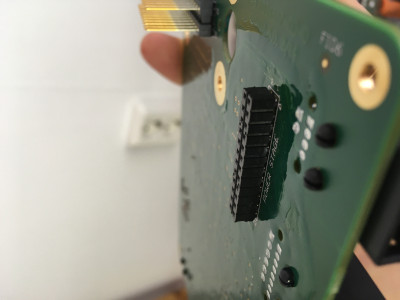

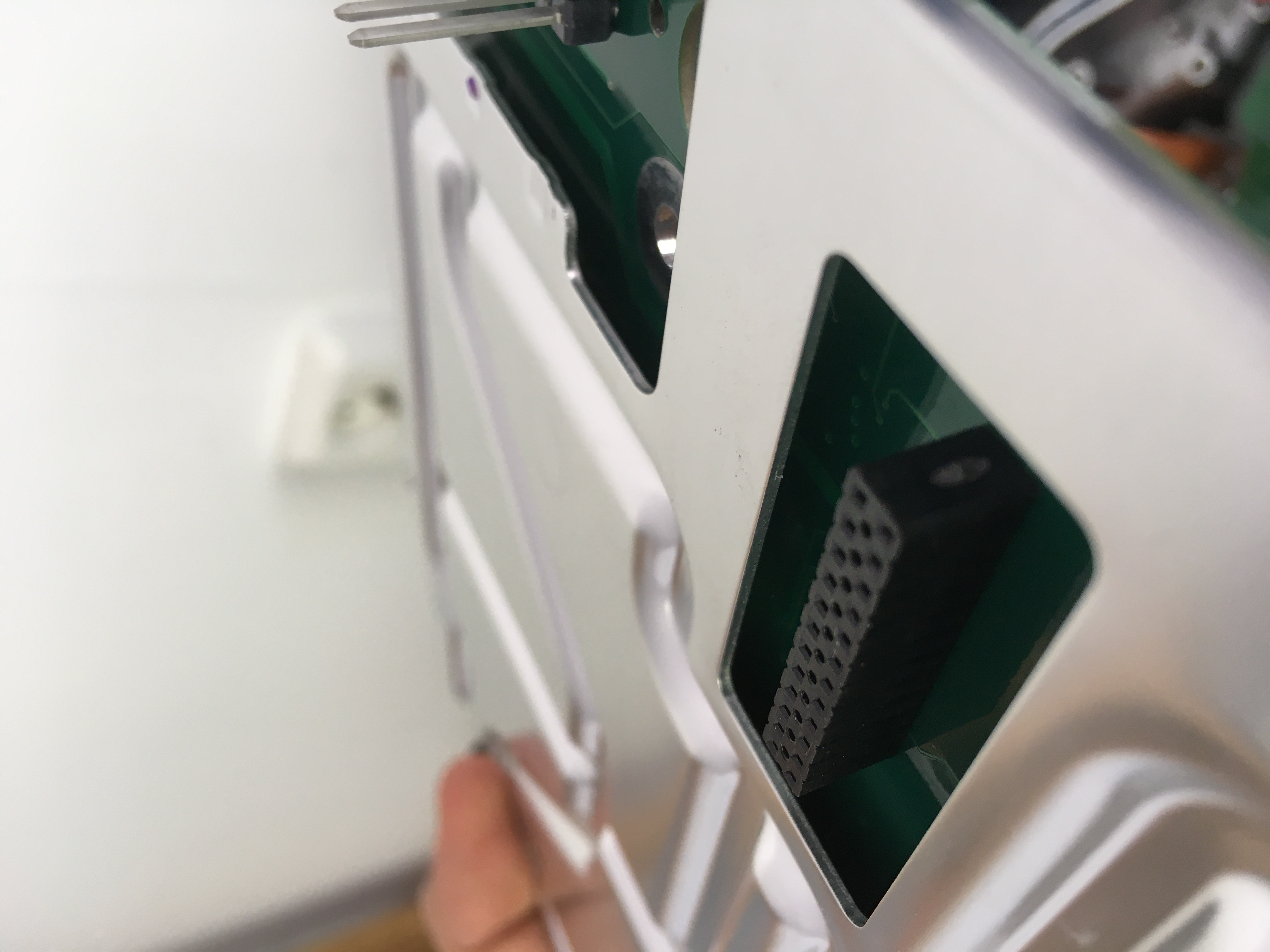

The ”powestage” connector in the open source logic board is a couple of mm thicker than the one in the original teslaboars. It makes it difficult to fit.
Alfa Romeo 147 with Tesla FDU and Kia soul pack
oh not good, must have sourced the wrong part. Sorry about the trouble, will fix it asap
If by thicker you mean longer then that's not a big problem. This problem was previously highlighted in the support thread. This is the actual connector tesla use : https://www.mouser.co.uk/ProductDetail/200-CES11201LD
