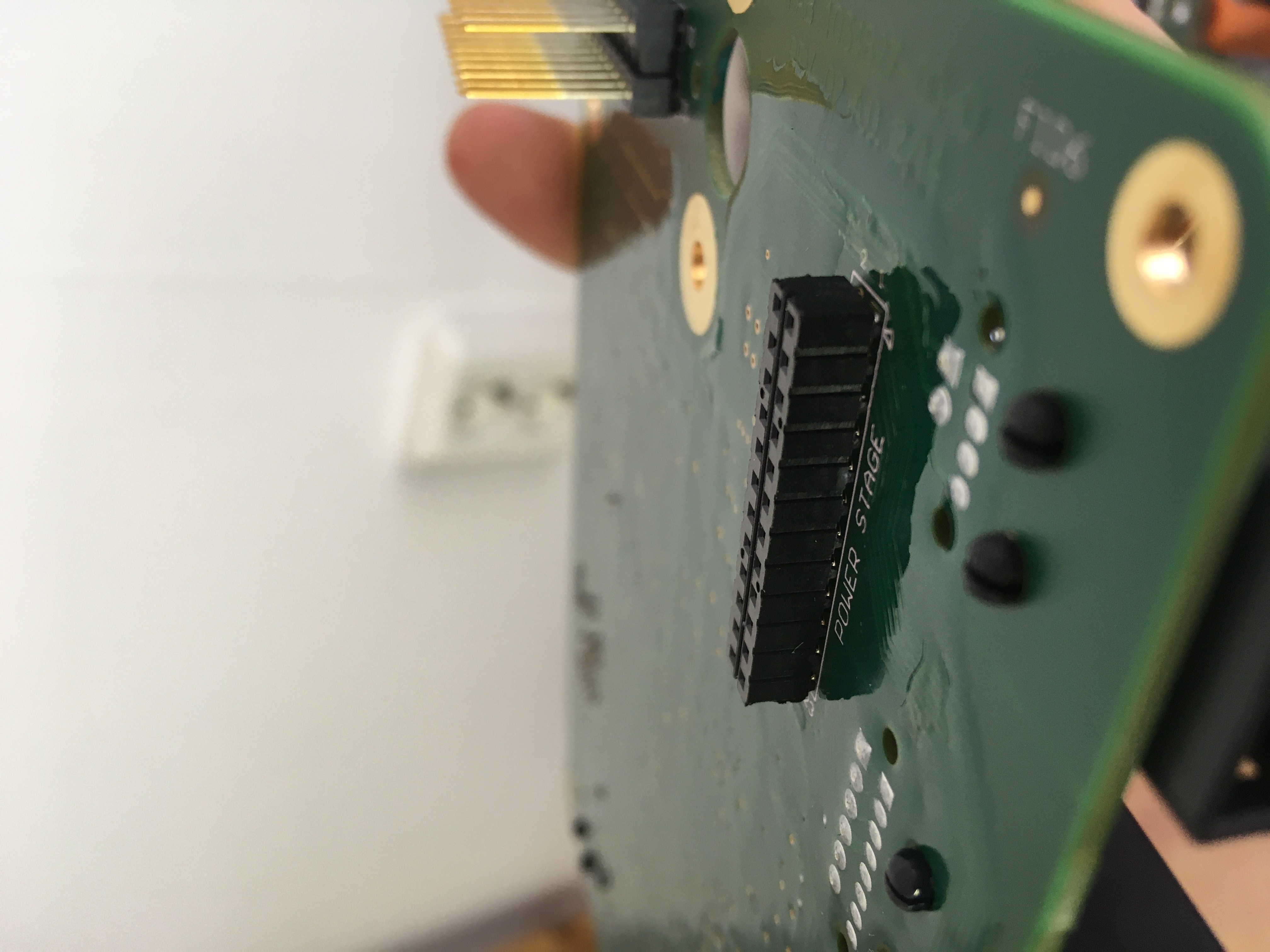

The ”powestage” connector in the open source logic board is a couple of mm thicker than the one in the original teslaboars. It makes it difficult to fit.
Alfa Romeo 147 with Tesla FDU and Kia soul pack
- Posts: 5911
- Has thanked: 180 times
- Been thanked: 1109 times
Re: SDU Logic board V6
oh not good, must have sourced the wrong part. Sorry about the trouble, will fix it asap
- Posts: 3563
- Been thanked: 88 times
If by thicker you mean longer then that's not a big problem. This problem was previously highlighted in the support thread. This is the actual connector tesla use : https://www.mouser.co.uk/ProductDetail/200-CES11201LD
