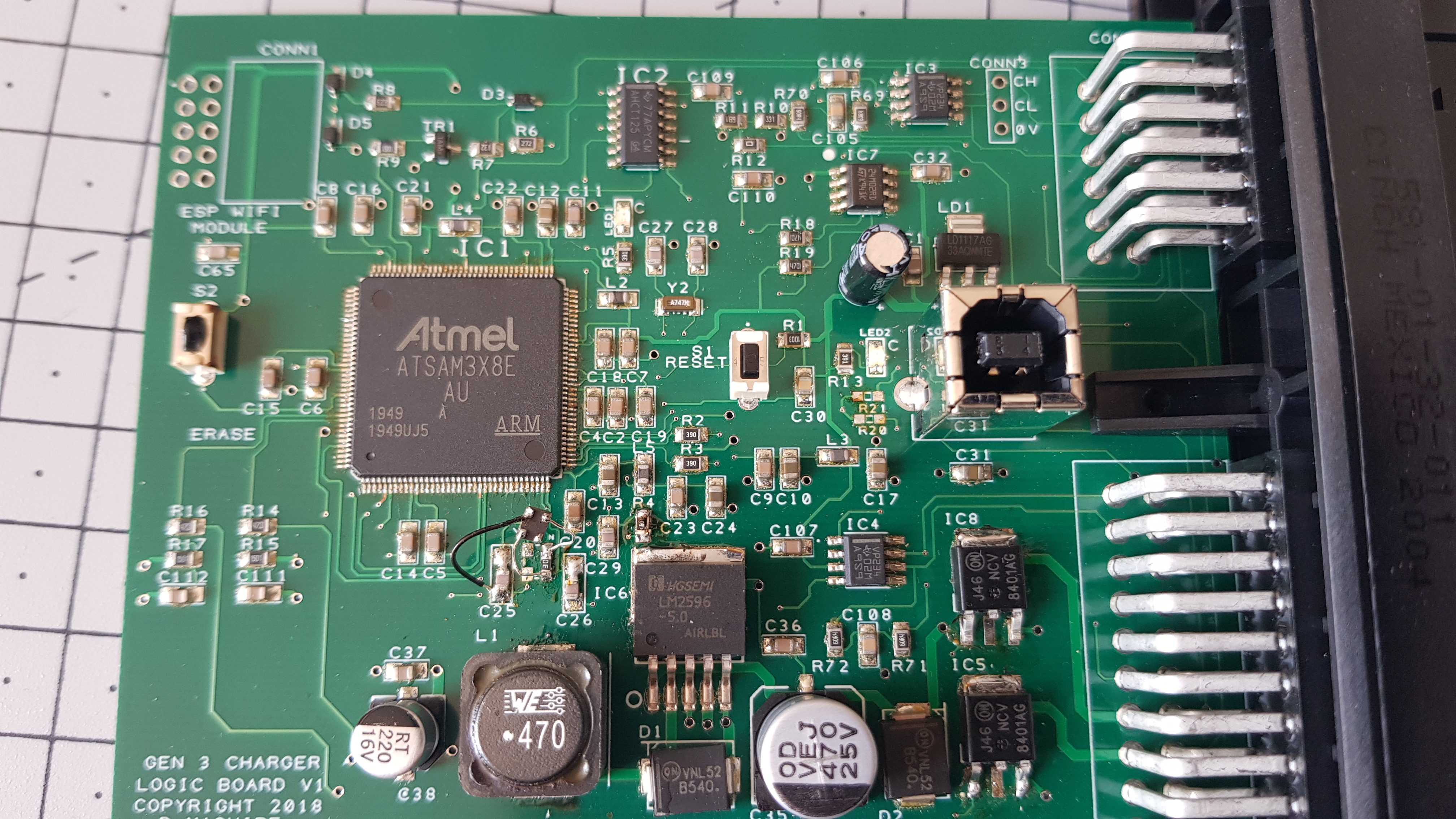

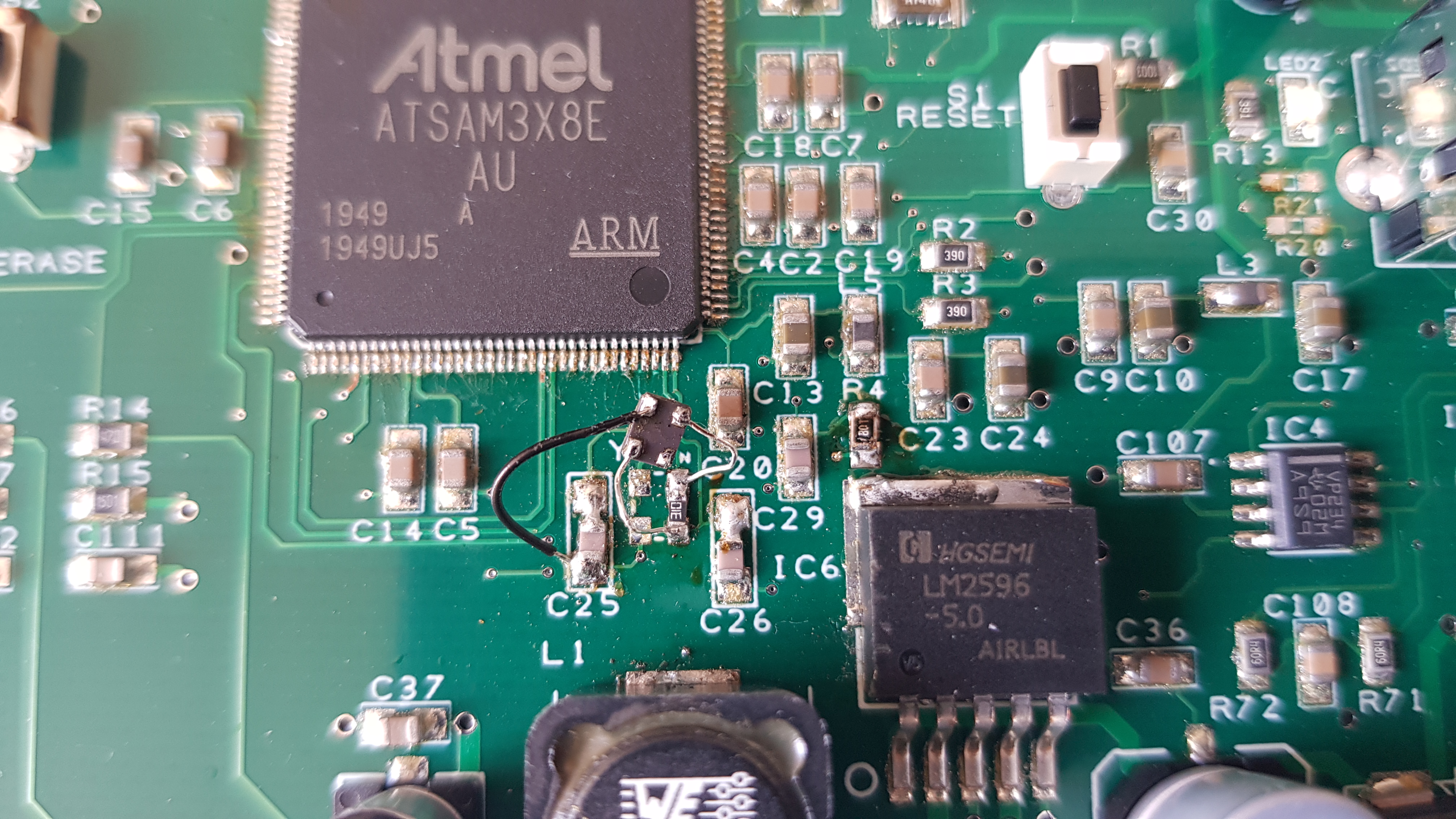

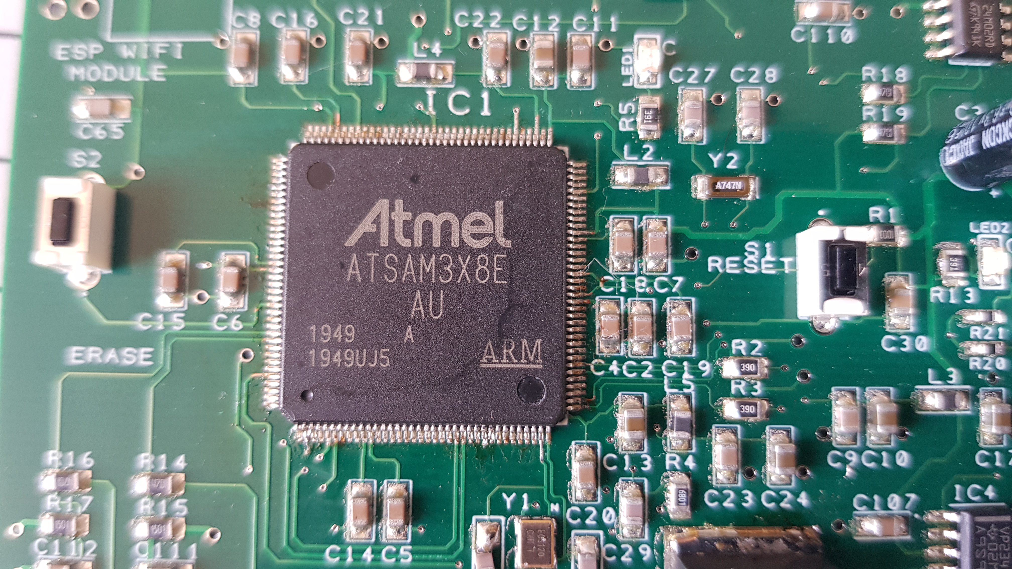

Tom and Ryan,
A note that I've mentioned earlier but since I think we're looking for the peculiar rock to turn over, I'll mention it again. I think this is a stretch but I'll just have to risk looking like I don't know what I'm doing (most of this is all very new to me)
My board does not currently have the c30 capacitor which sits next to the boards reset switch. The board mfg. company told me they kept oxidizing on them when they attempted to install so after asking around on the forum it sounded like it was an optional component that was only called for in "harsh" environments which I'm guessing means either stray voltage noisey or radio signal noisey. My battery cables are not shielded if that has an impact in this discussion.
Bottom line, I'm ordering several different brands of this capacitor and will get it put in place. I'm guessing (but will research) that shielding gas like what is used in a mig welder may prevent oxidation. So I'm considering removing my mig wire and running the gas over the c30 location when i solder it.

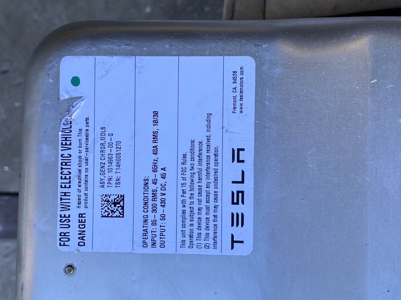

Ryan, can you share the part numbers or a photo of the label of each? I’ve shot messages to a couple Tesla design engineer friends to provide the logic in the part number scheme, here is what they say. Base 7+2 is the part number and major revision which should define backward compatibility at the whole charger level, and the -A is minor configuration change as I’m told. This doesn’t cover software though, so that possibility still exists as a variable.
-00 seems to be single phase North America, -05 seems to be a non-backward compatible single phase North American, -04 seems to be 3-phase, -03 seems to be a gen 1 retrofit single phase?
This would imply that any of the part numbers with major revision -05 may not be compatible with the single phase software as written.

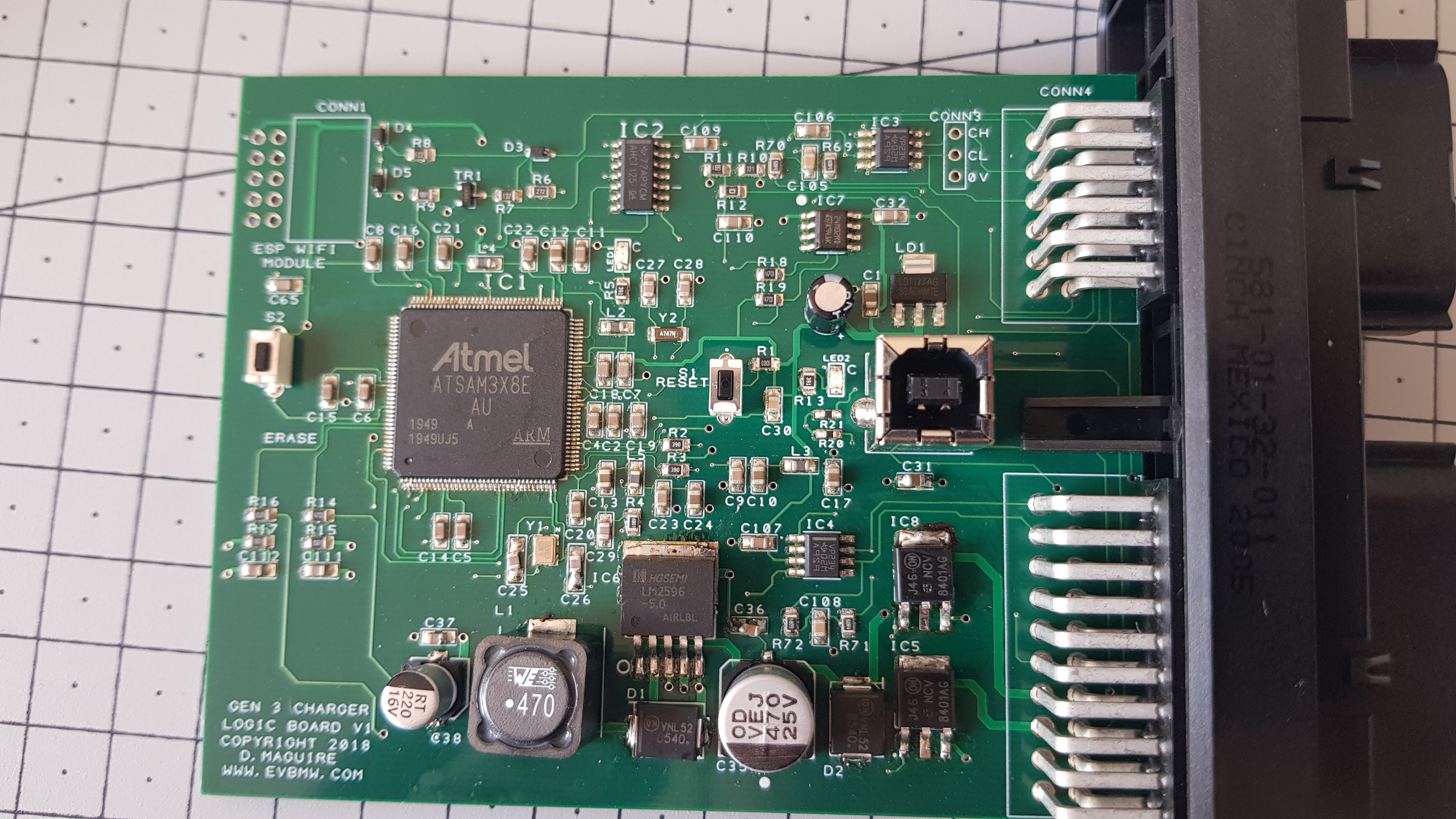

Hey Tom, thanks a lot for putting a bunch of effort into helping the two of us out!
Alright so we've actually built up a decent collection of 5 chargers now. Here's the list:
1014963-05-B - Not working. DC scaling is off (3rd module acts differently from 1 and 2)
1014963-00-E - Not working. DC scaling is off
1014963-05-B - Not working. DC scaling is off. Accidentally burned out one of the modules with a wiring error
1014963-00-L - Used to work. No scaling issues. Burned out during the same wiring error as above
1014963-00-E - Working. No scaling issues
What's strange to me is that I've got two chargers which have identical part numbers but behave differently. The non-working 'E' charger is the one that I've been trying to get to work most recently and the one that the following CAN captures were taken on.

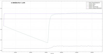

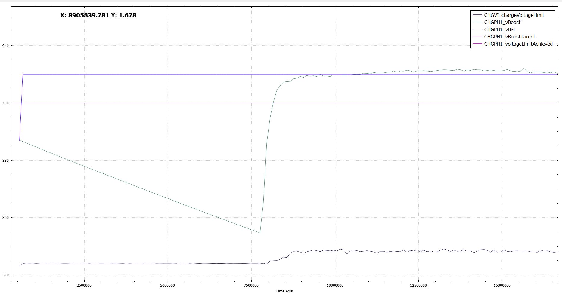

That said, I did manage to get a CAN capture from our working unit and a non-working unit. I'm using 240V North American input. The same V2 logic board was used in both instances, installed into different charger units and only module 1 enabled. The ONLY change to the software I made when swapping it was to adjust the DC scaling factor. The captures are for about 22 seconds starting from turning the 12V supply ON.
The visual and audible feedback I get (LEDs, clicks, faint electrical hum etc.) is identical for both chargers as far as I can tell. My current loop only measures 1 digit past the decimal, but I measure ~6A output from the working charger, and 0 from the non-working one. When I enable all 3 modules on the non-working unit I may be getting a small charge of ~0.1A out, but very difficult to be sure given the resolution of my loop.

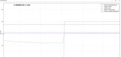

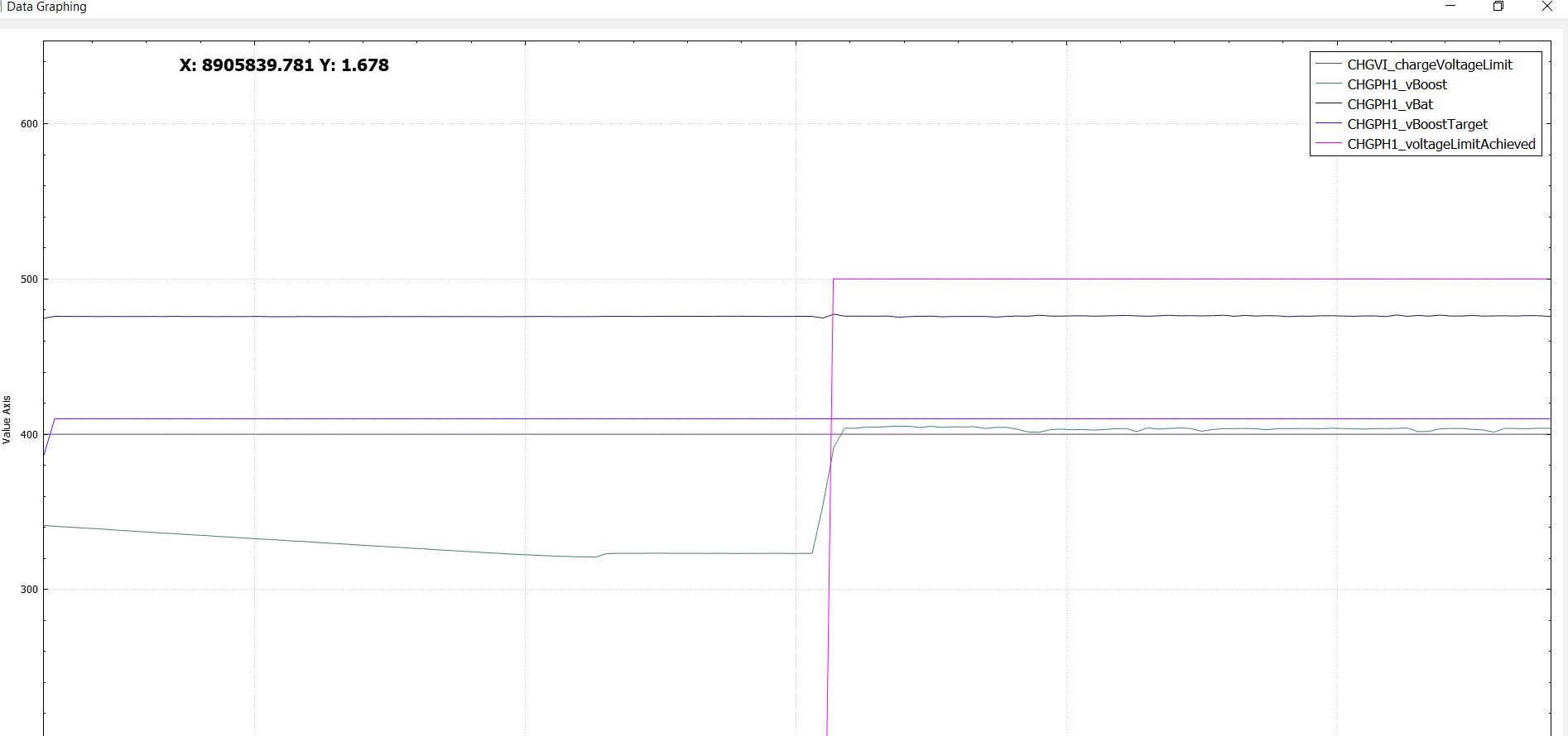

Ryan, thanks for all this info. The best way to actually prove what is going on would be to drop one of the "none" working chargers with its original board into a Tesla and get diagnostics read out and or charger internal canbus captures.
The capture of the working one behaves as expected.
This one again raises the voltage limit reached.
Looking at other can info the wierd bit is the charger does not flag this as an error however it does turn off its pwm.

New problem with the GEN 3 boards, widows won't detect any of my boards, LED2 commes on, an nothing. i checked for shorts and couldn't find any.
I think there is a problem on the board : crystal Y1 doesn't have the right pinout. according to the datasheet of the crystal
https://www.mouser.fr/ProductDetail/ECS ... VBD9xsqXLj
The oscilating pins are on a diagonal, but on the board they are next to each other ( i checked on a bare board and in desing spark).
So i soldered a crystal with tiny wires to the right place, but i still have nothing showing up in windows.
Anyone got a tip for me ?
Paul

PoloLbricolo wrote: Mon Jun 22, 2020 7:52 am Anyone got a tip for me ?
Can you take a good quality picture of your board?
Also, you'd want to check for continuity between the usb port and the pin of the ATSAM, to test if you did a good a good job soldering.
Me personally, I made one V4 board that wouldn't work or connect (or if it did connect, it would sporadically disconnect, etc.) and it was because I fudged one of the pins of the ATSAM, so I just started completely over and hot aired the whole thing.

Thatguyoverthere wrote: Tue Jun 23, 2020 1:52 am to test if you did a good a good job soldering.
It should, i've done it with solder paste and reflow oven, also none of my 5 boards are working (all are powering up nicely, the led 2 comes on and power consuption seems normal)
attached pictures of 2 boards
1 of the boards i tried to wire the 12mhz quartz as the datasheet implies (no luck)
hacked board close up
hacked board
hacked board
other board is straight out of the oven
normal board close up

Update : the boards are detected but only when the reset switch is held down, also windows does not want to see it as arduino due
PoloLbricolo
Posts: 104
Joined: Wed Apr 10, 2019 2:32 pm
Location: France
Been thanked: 11 times
Post by PoloLbricolo »
Okay, i got 4 out of 5 working, the problem was Y1 doesn't have the correct footprint, i soldered the crystal up in the air and it worked.
For some unknown reason i still have one card not working...

I have one V4 board and have tried two different gen 2 chargers on it and haven't been having the best of luck.
One of them (1014963-05-B) had the voltage offset issue but it will get the EVSE to kick on, makes a little noise, but has yet to push power to the battery.
The other charger unit (1014963-00-L) running the same board, doesn't have the voltage offset issue, but for some reason it is not triggering the EVSE to kick on, and it goes into a EN = 0, FLT = 1 condition after a few seconds, might be because the incoming power never switches on.
I'm using a US Tesla UMC charger through a Tesla model S port. Sort of an unusual combo, It's a type 1 (US style) charger, but It appears to use strange resistances. With some tweaks to the window for the proximity signal I did have it sending power, at least on one of the chargers.
