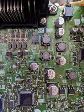

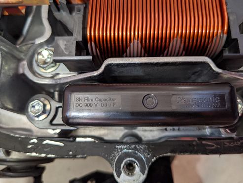

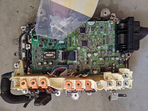

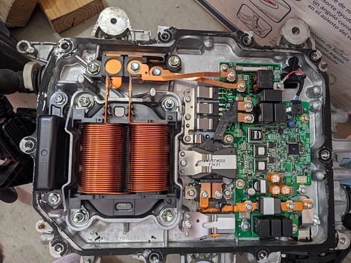

TheSilverBuick
Posts: 187
Re: Toyota Auris and Yaris Inverter Logic board
Post by TheSilverBuick »
TheSilverBuick wrote: Wed Jun 17, 2020 9:28 pm Hmm, learning something new. What I thought was a "gen3" inverter came from a Prius C, and has the G9200-52010 number on it.
Yup, if the part number was not enough, looks like the 2014 Prius C inverter is the same as the Yaris.
