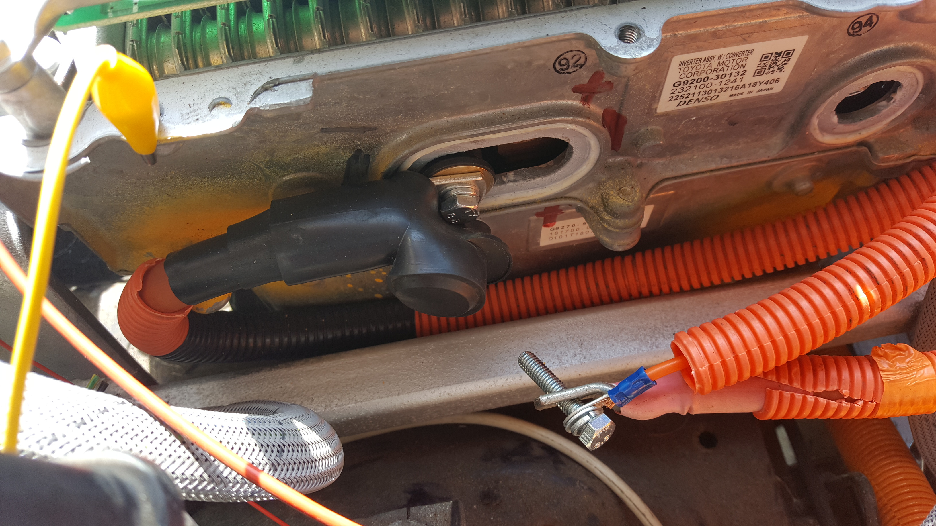

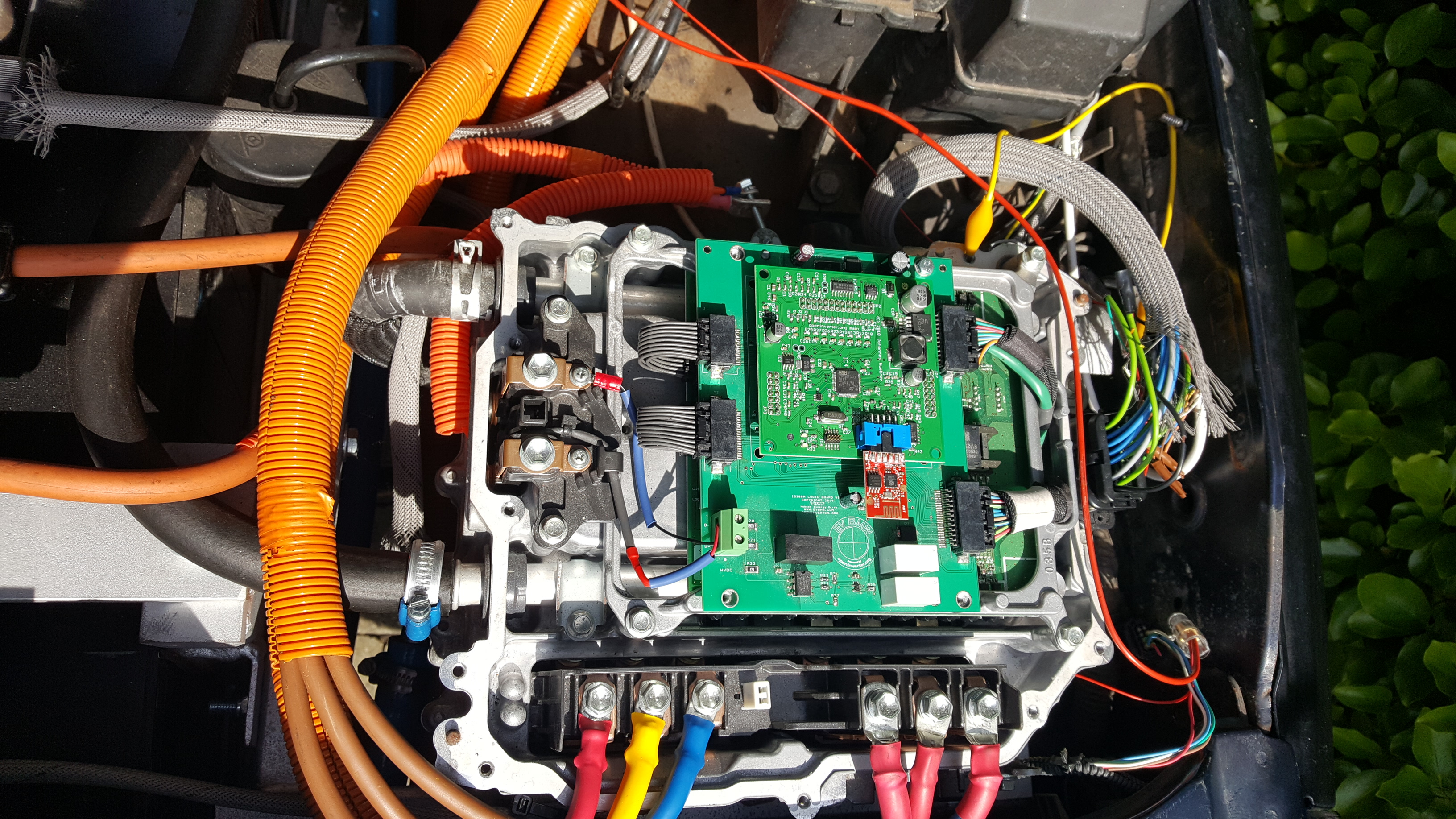

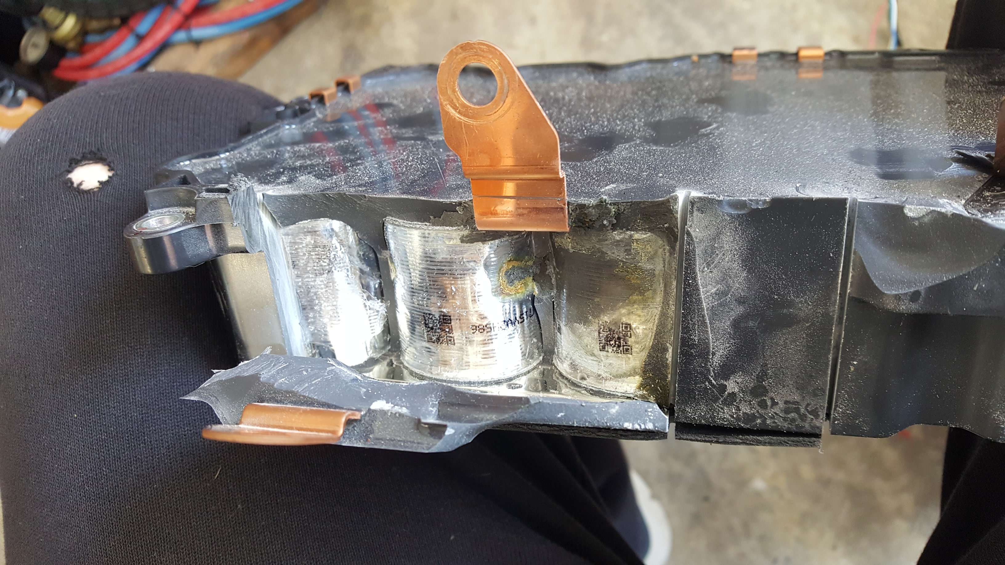

So when I posted some videos of the Prius inverter cap failure in the E39 I was surprised by some comments. The short version seemed to be that even though I had admitted to doing it wrong, I was still doing it wrong in my theory of the failure. So while waiting for the replacement inverter for the E39 I continued with experiments on the Range rover. The new encoder worked wonders and I could finally drive somewhat normally using just the rear motor on the MG2 power stage of the IS300H inverter. Drifting off to sleep on the previous night a thought popped into my head. Could I use one encoder and one Johannes brain to drive the two enova induction motors. Reasoning was they are the same pole count etc, same gearbox and same ratio to the road. Well it seems to work just fine:) I started building an obstacle course in my drive way and set about some rock crawling. Working great. Then I hear the pop. Jumped out and lifted the bonnet to see a thin whisp of smoke from the inverter. Cut the power, removed and dismantled the inverter to see....yep same failure mode!
Why? and why now? Well the Rover is only running 240vdc hv so the caps had more headroom them in the E39 at 360v. And why now because two motors running on the two power stages for twice the inductive pleasure when moron features here....you guessed it! had the HV connected to the WRONG TERMINALS...............

PS: would you be able to get an oscilloscope trace of the spikes on the DC bus when "doing it wrong"? Just for the LOLs, of course.

Not just a oscilloscope trace but a Before and After trace to show the difference of attaching the power to the right place despite the unintuitivly short connecting bus bars. It would be very educational.

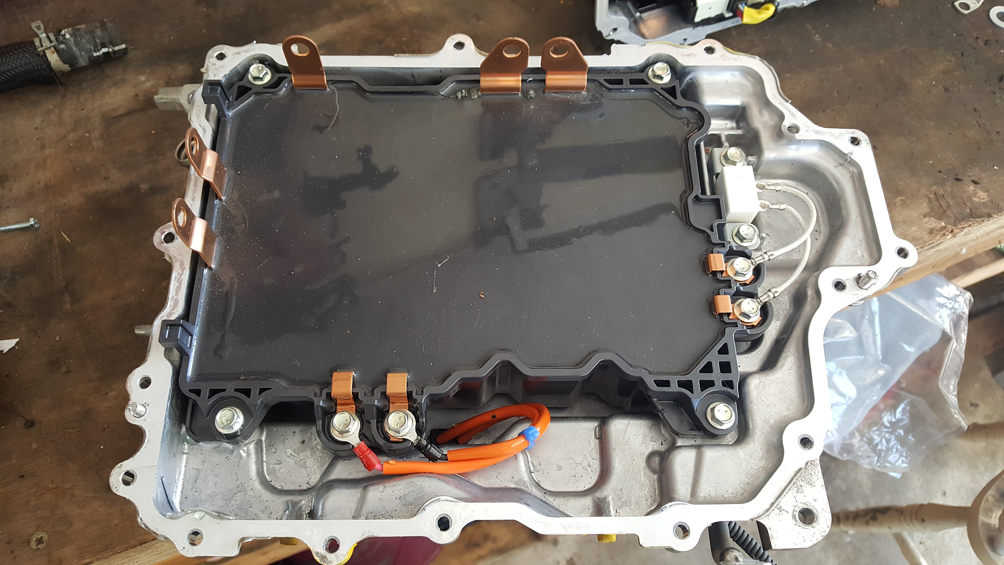

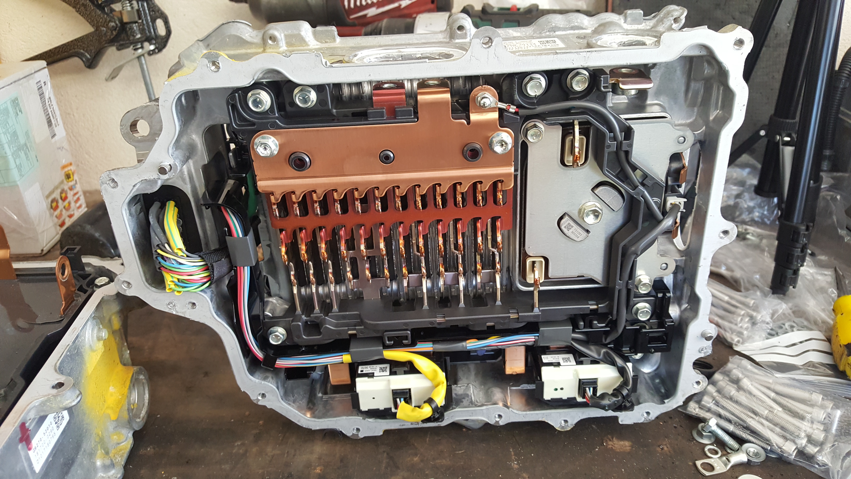

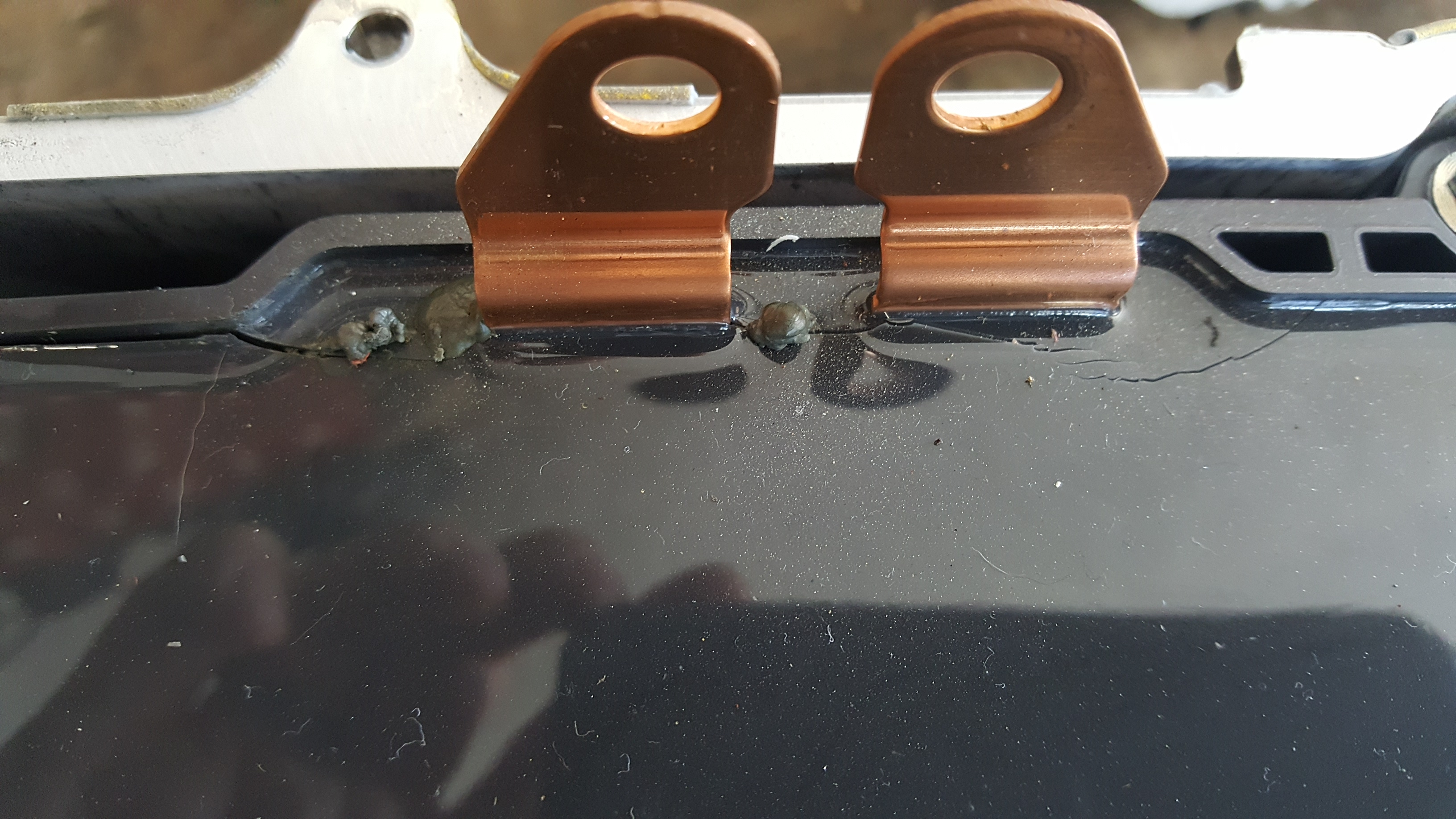

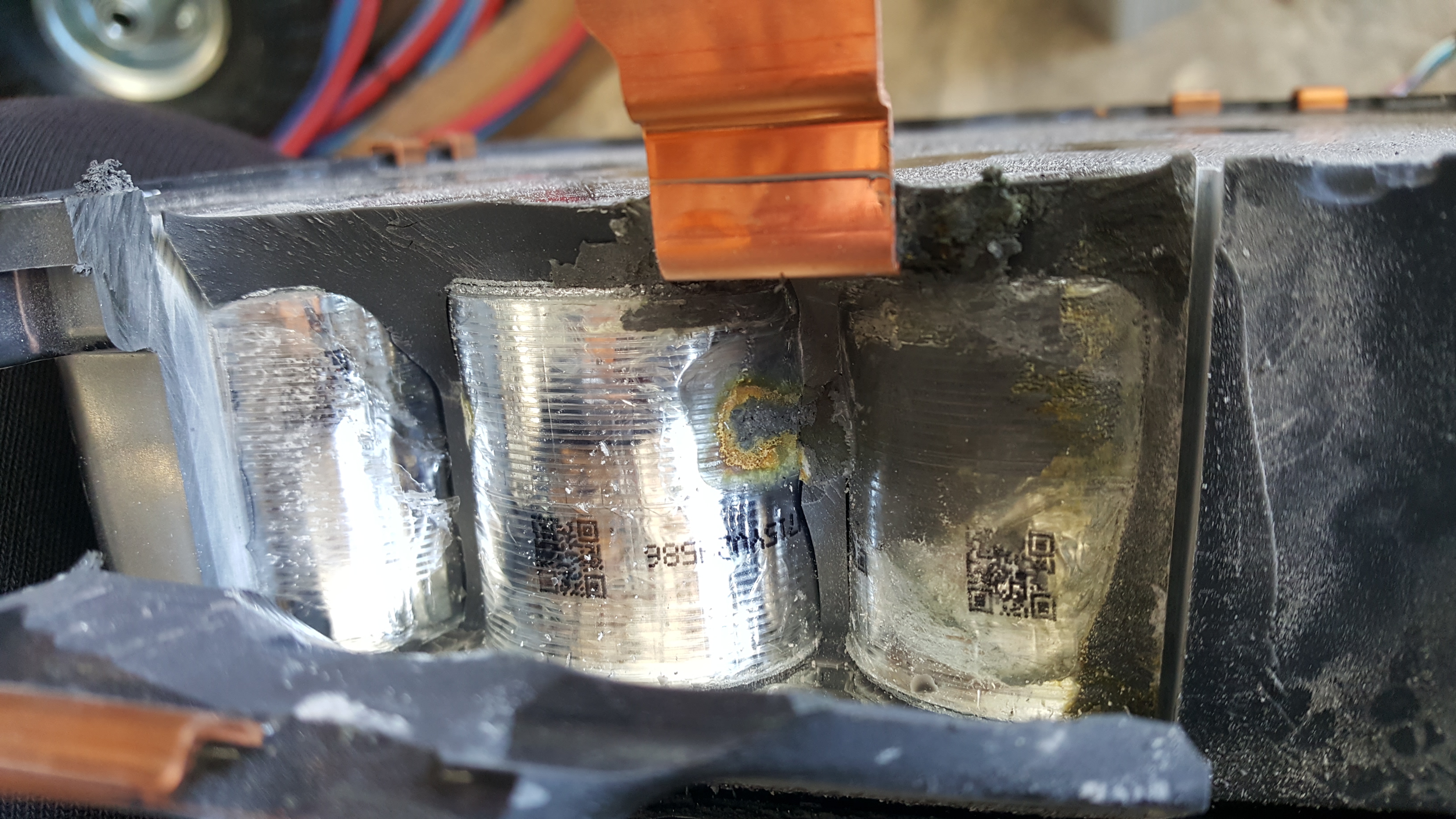

Decided to do a little autopsy on the cap. Found two failure points. Now, the is300h inverter does not have any snubbers annnnd it seems to feed the main HV from roughly the same points I was using.

On the one hand I'm glad this happened to you and not me, but on the other, even though we learn MOSTLY from our mistakes, I hope it has not caused too much damage...It's not dead but "wounded"...
But Damien, you're doing it WRONG

Thanks for the autopsy.
There's a saying that goes along the lines of... If you're not breaking something you're not trying hard enough.

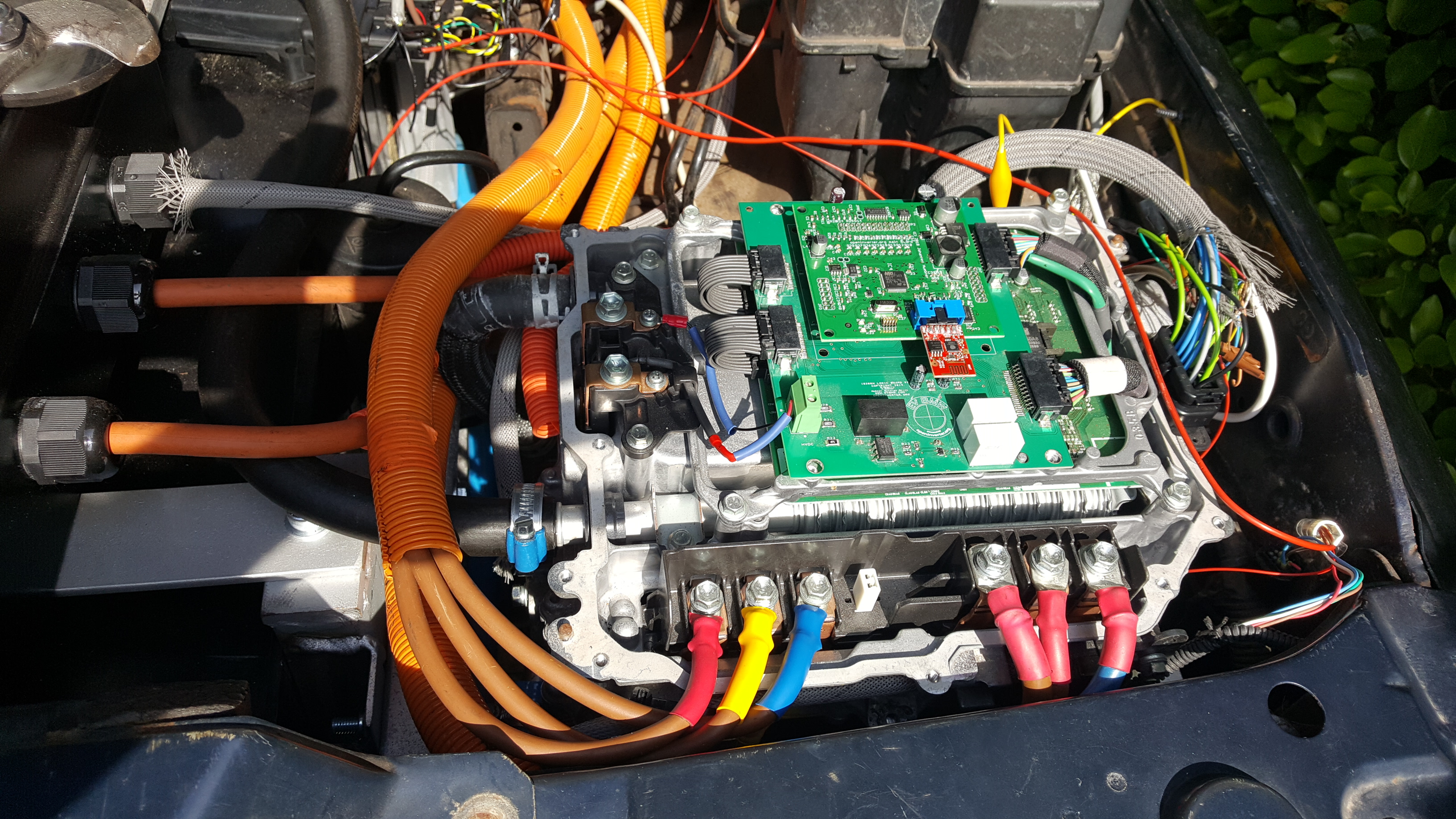

So the facts are: (are they?)
1) There are voltage spikes, and
2) the battery is connected to the same location the boost converter output goes to, and
3) the inverter was very unlikely to be broken when you started testing.
So what can this even mean?:
1) The caps are incorrectly rated, or
2) The power stage is run incorrectly, maybe there has to be a specific deadtime that the power stage doesn't enforce or maybe they have to be run somehow synchronously compared to each other so that one motor always snubs the inductance spikes caused by switching the other motor (a motor is an inductor though? doesn't make sense), or
3) you can't feed power to these things directly using long wires from a battery, because maybe any wires or batteries have too much inductance compared to the buck/boost converter coil (I'm sure that's not the case... an inductor has more inductance than cables? right? maybe the main cap is tuned for _more_ inductance than a cable has and it only then doesn't explode? is that even possible?), or
4) the boost converter has to be controlled somehow in order for this not to happen. (This seems very unlikely, it should be unable to affect this in any way positively no matter how you ran it, as towards the main cap it either looks like a coil or an open circuit)
Maybe there is a better explanation.

Found the culprit. celeron55 is very very close in one of his points above. Video later.
