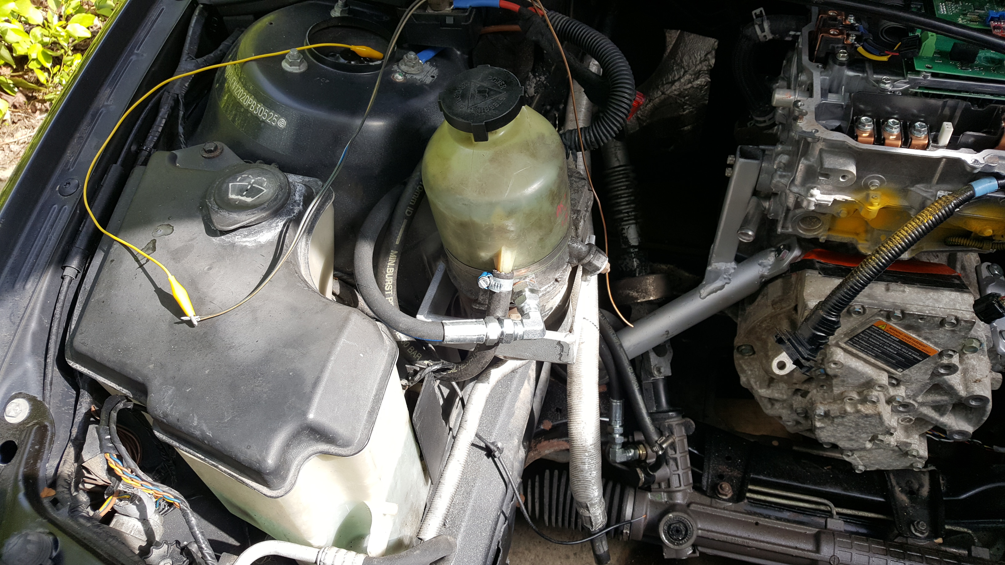

Motor mounts sanded and painted. Inverter mounts done. Power steering pump mounted and high pressure line in. All hail the Grey Goose

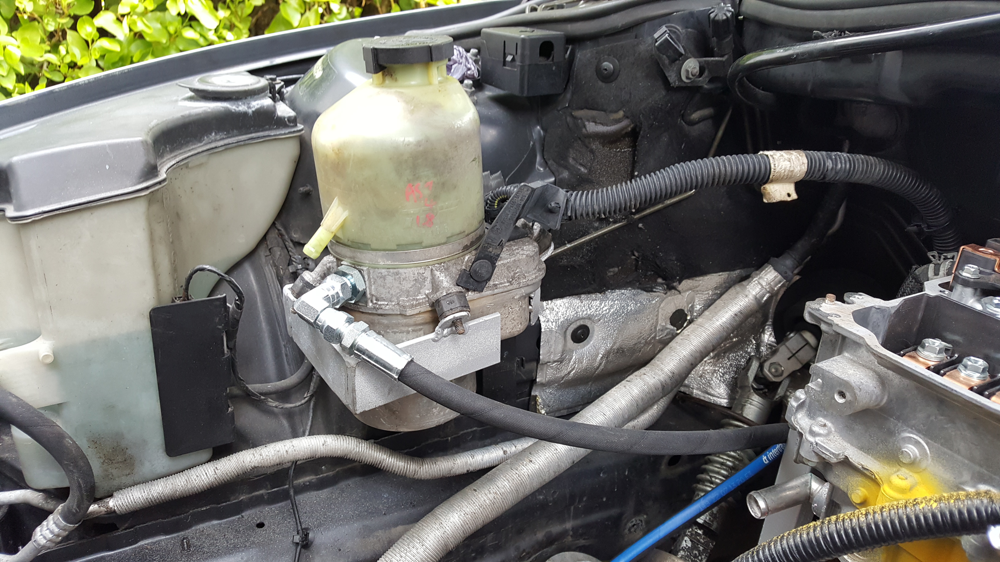

Power steering up and running and no leaks:)

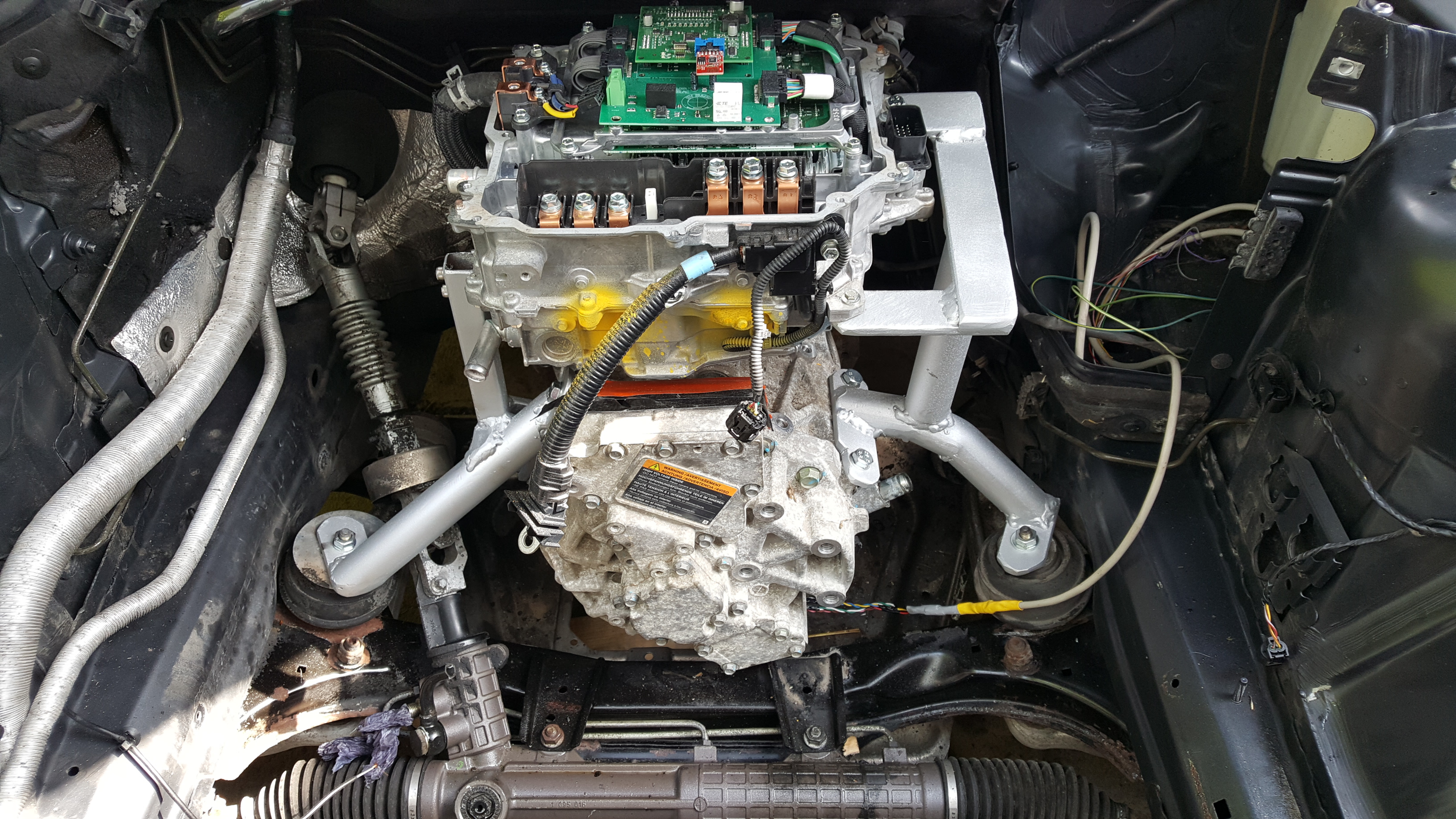

Made a little progress today on the Nismo touring:)
Leaf inverter mounted.

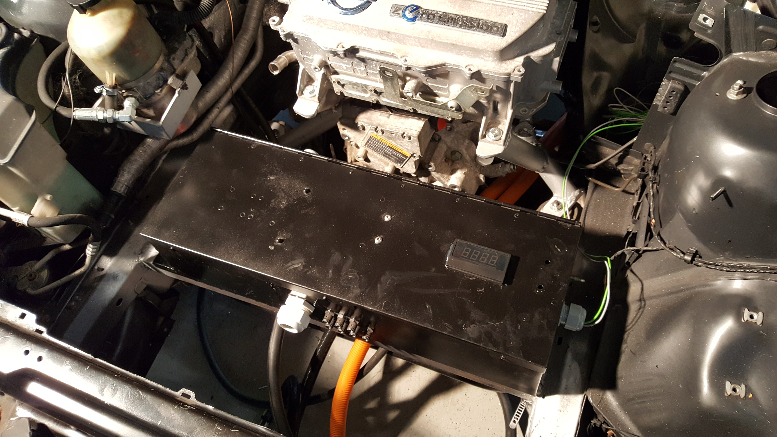

Getting the high voltage junction box together. Should have power to the inverter next week for testing.

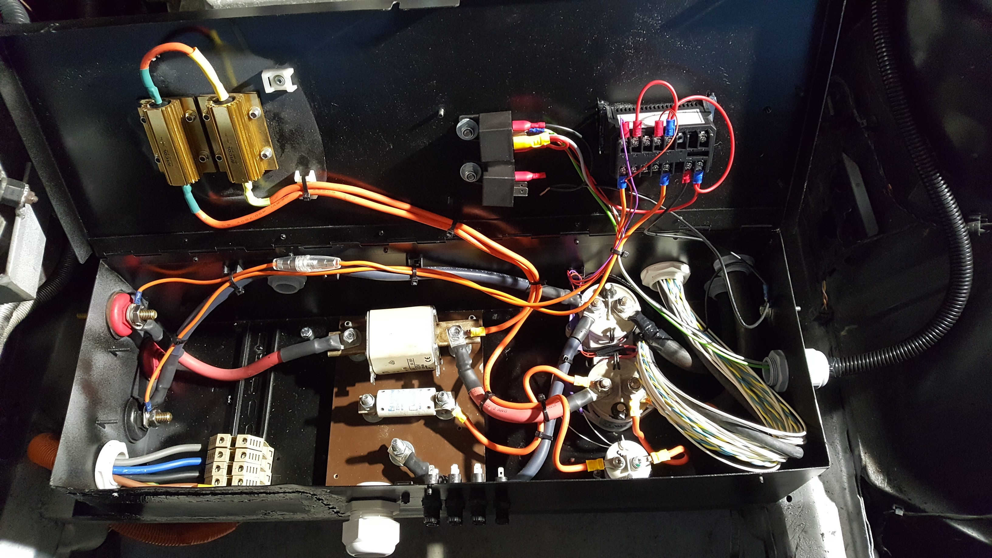

Some good progress today on the grey goose. Battery pack installation and high voltage junction box.

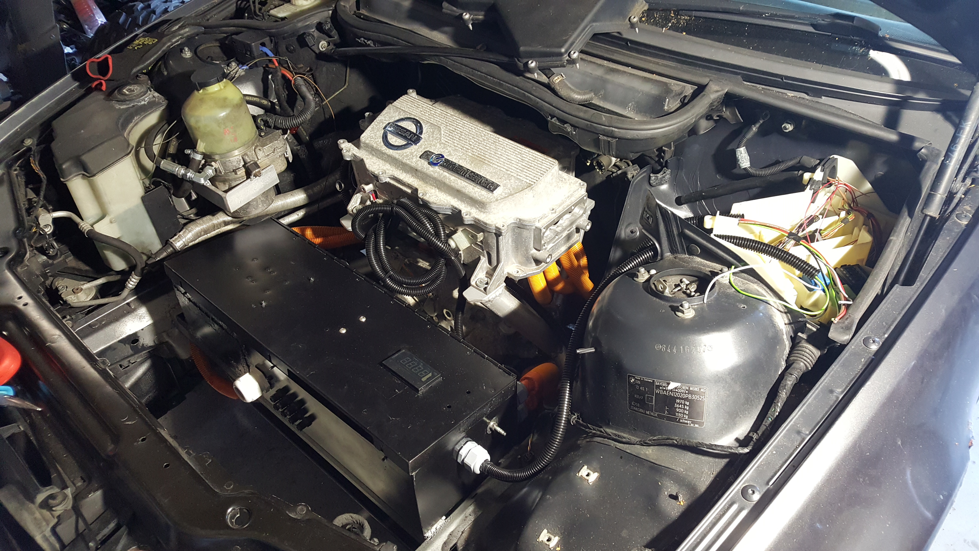

Some pictures from today. Getting close to power up:)
