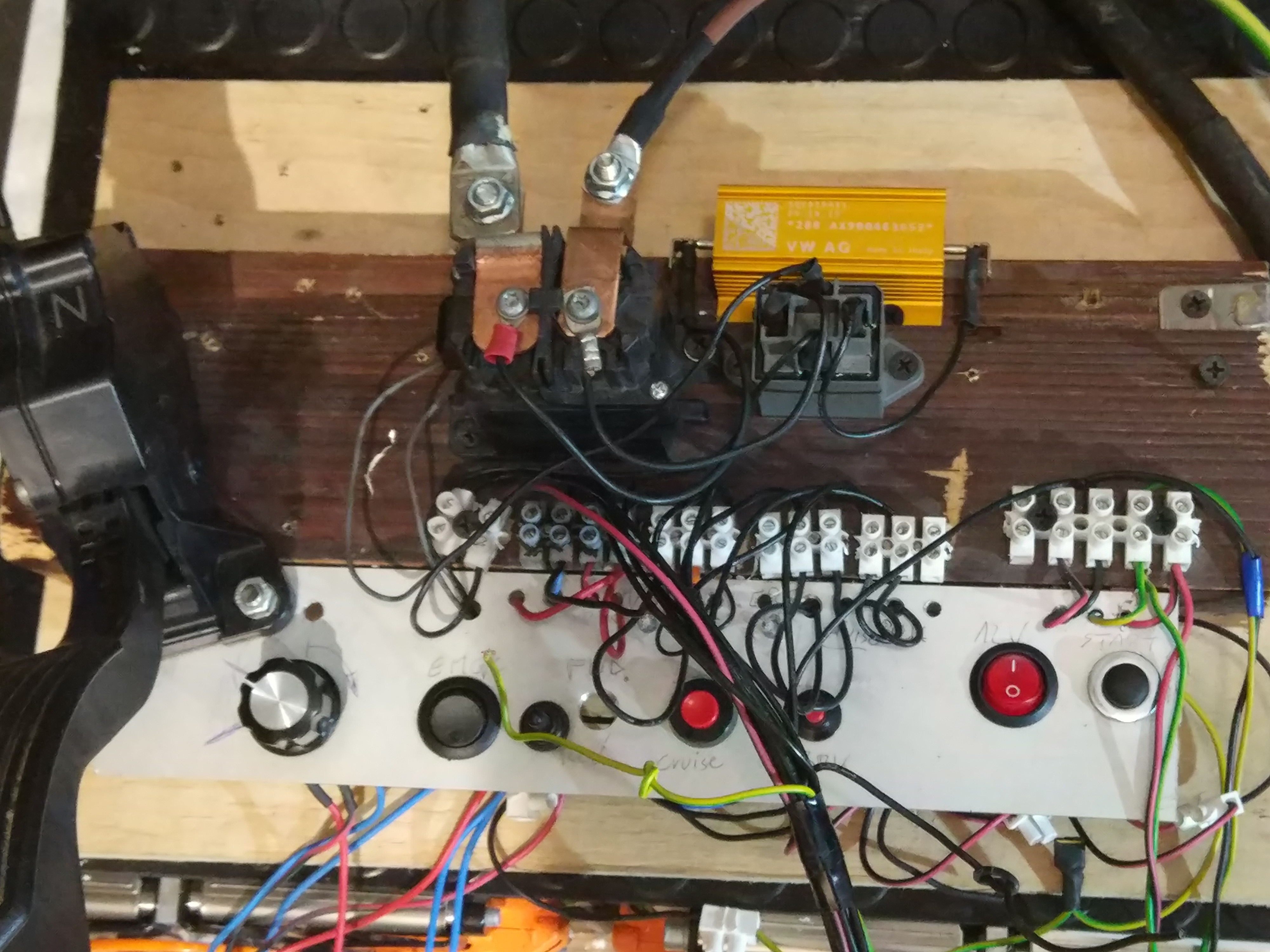

Re: Mainboard V3 FAQ
Hello again
Today, when I almost finished waterproof cover for underbody battery, delayed start of inverter I tried to start motor like always and... strange because it welded both main relays!
What I checked:
- if 12V is NOT applied to inverter, signal low (means GND) goes instantly to out_PRE and out_DCSW all of the time
- if 12V is applied to inverter, signal low (GND) goes to out_PRE and after 5 seconds opens if HV doesn't reach udcsw
Because of this probably at full current both relays close and weld contacts, because I had GND and 12V on coils
So, now is my question - what can be wrong? Is somewhere in software parameter what to do with outputs if inverter is off?
Oh, and I forgot to add: my v3 board is on Leaf interface board inside inverter, latest firmware with FOC installed.
What I checked:
Ok, I solved this with small relay which is controlled by inverter supply, so if 12V is present at inverter power input, I have also enabled 12V to Pre/UDCSW high side.
Second - like Johannes and Arber suggest, witch emergency button I cut only direction line, but contactorst stays on, it's more safe for power stage.
Thanks guys for support.
