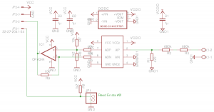

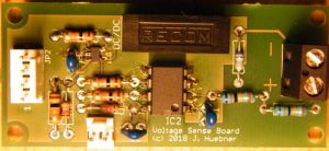

Voltage Sense Board
Voltage Sense Board Schematic

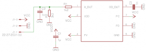

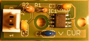

Current Sense Board
File:Current Sense Board Schematic

Voltage Sense Board
The voltage sense board uses an Si8920 analog isolator. It converts a voltage of 200mV on the primary (right side on schematic) into around 3V on the secondary side. Since the isolators output is differential we need an opamp circuit to make it single-ended.
The board also provides the connection for the heatsink temperature sensors.

The current sense board used a Melexis MLX91205 magnetic field sensor. It outputs 2.5V at 0 T and swings between 0.25V and 4.75V at +/-25mT. With a simple resistive divider that is scaled to the 3.3V range. The board is supposed to be mounted directly on the phase output cable or bus bar. The correlation between the phase current and the output swing varies with the distance between the conductor and the chip. With no further spacers the range is about 800A on cable. A busbar needs an additional isolation layer.
Make sure to place the two sense board far apart from each other and any other high current conductor to avoid cross talk.
