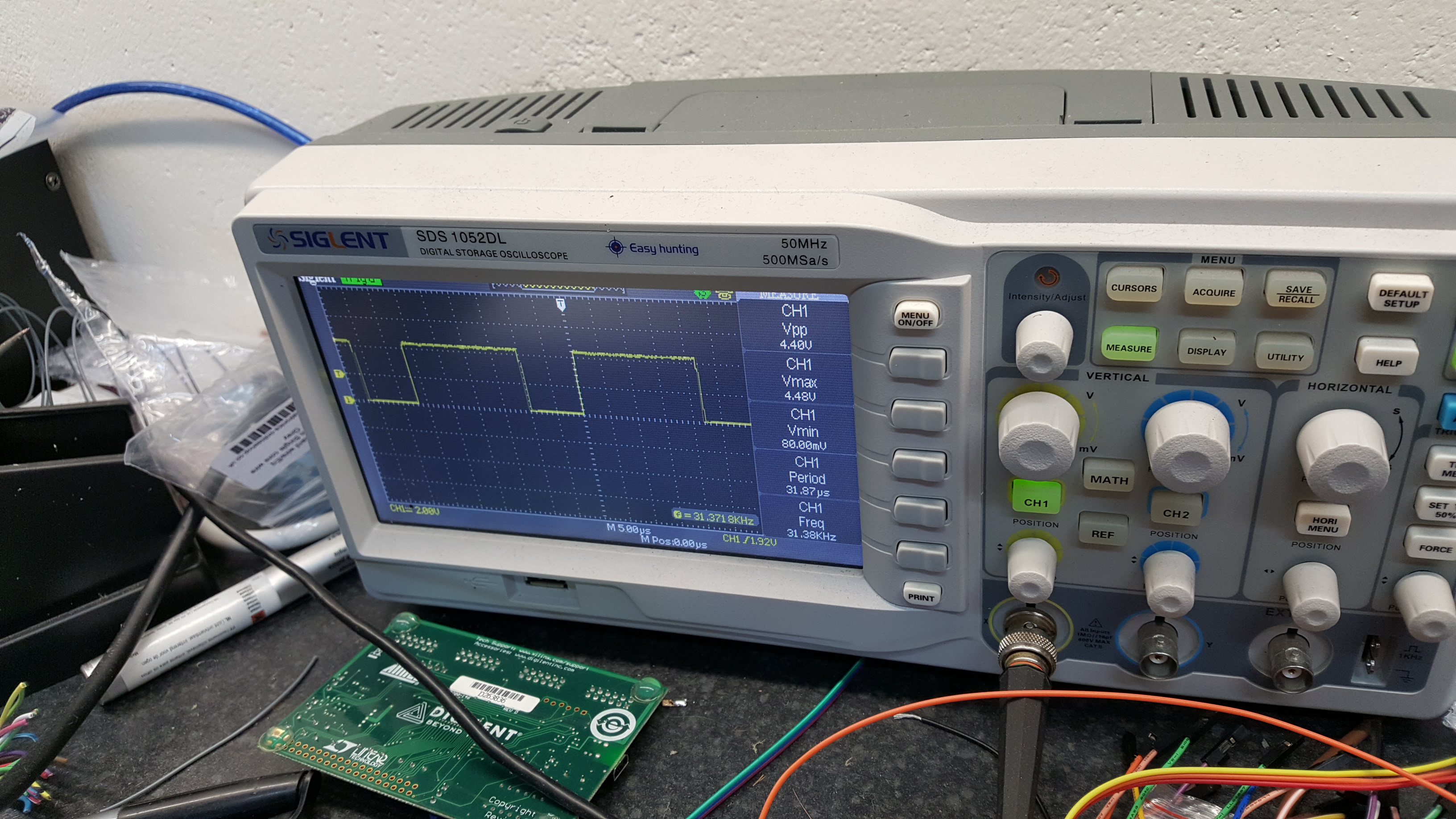

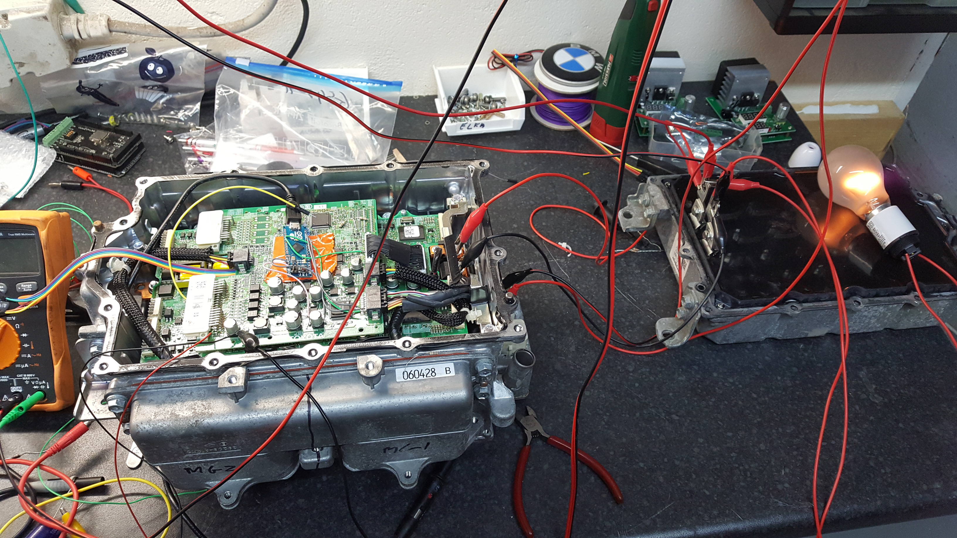

Closed loop control of the GS450h booster in both buck and boost mode using an atmega328. Just set the desired voltage over serial and it will buck or boost as required.

Jack Bauer wrote: Sat Apr 27, 2019 3:01 pm Closed loop control of the GS450h booster in both buck and boost mode using an atmega328. Just set the desired voltage over serial and it will buck or boost as required.
Now that is what i had in mind for charge pump. So in effect you can have a drive and a charger unit in one case. Superb work.
Now what we need is interface!

These Toyota inverters are a huge untapped resource. I just wish I had the skills and finance to make it happen quicker.
In the same vein it is of course impossible to kill the booster. No turning on both high and low , no running the pwm freq too high too low or too much or too little duty.

How much power have you put through it? Any idea of the achievable efficiencies?

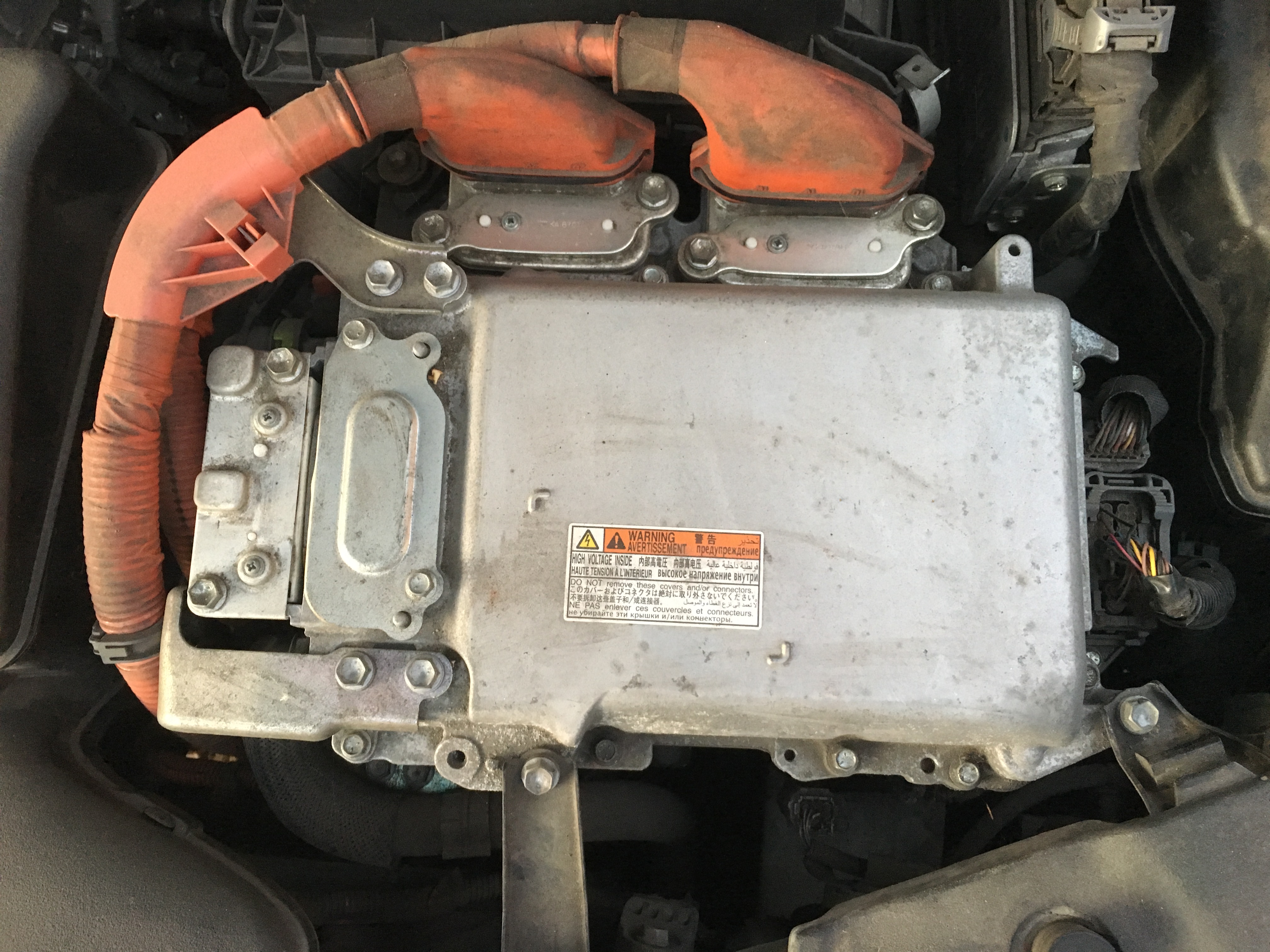

The Toyota Camry Hybrid AVV50R aluminum die-cast frame holding the top PCB is stamped with 035A not 035B as per is300h inverter. But i can't see any differences at all between the two.
Posts: 3831
Has thanked: 75 times
Been thanked: 696 times
Re: Lexus Inverter Hacking
It does look like the 3 phase output connections are a little different but I also can't see any differences.

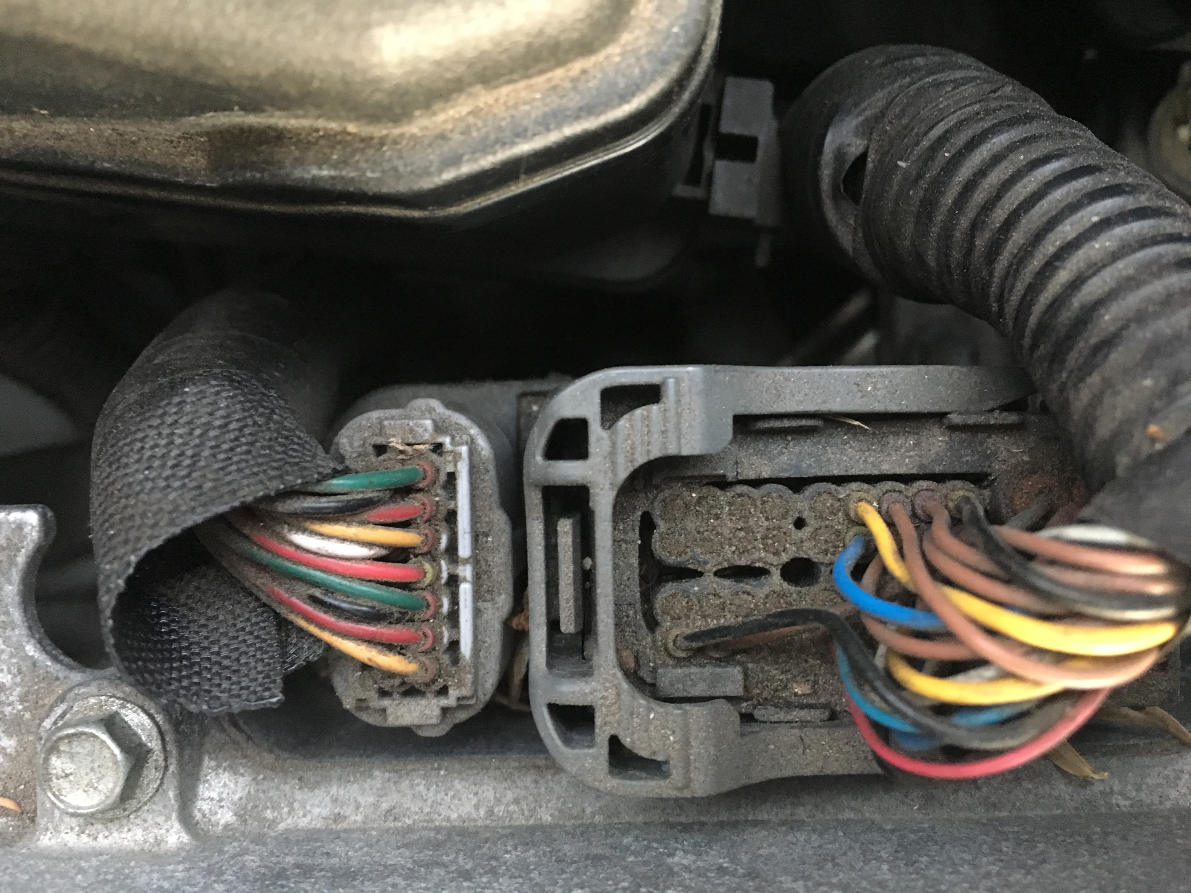

Here are pics of the AVV50R inverter still in the car:
At some stage in the future, i will try to get the voltages wrt time, of each of the wires connected to the DC/DC converter below the inverter...

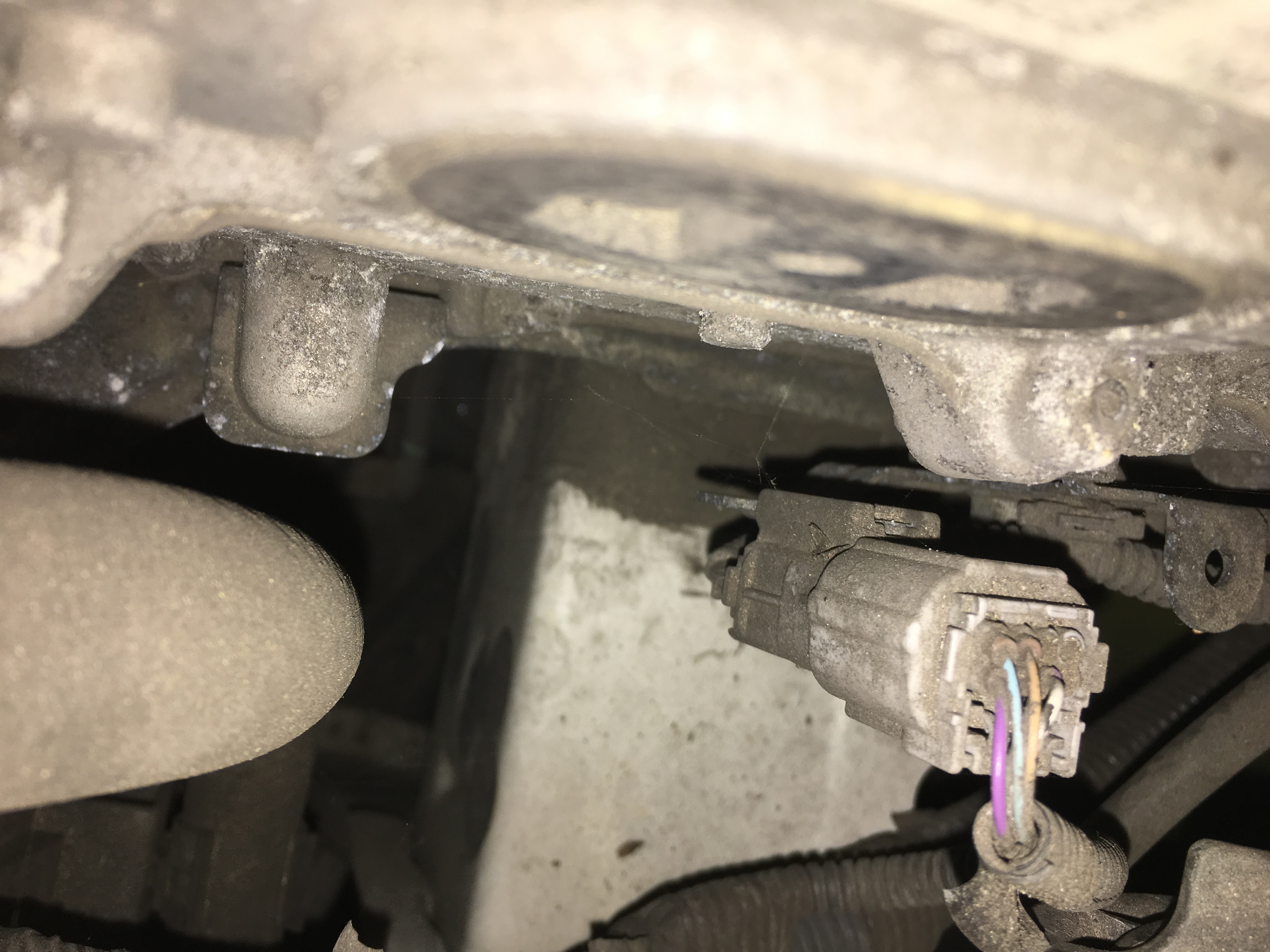

photo of DC/DC converter connector...

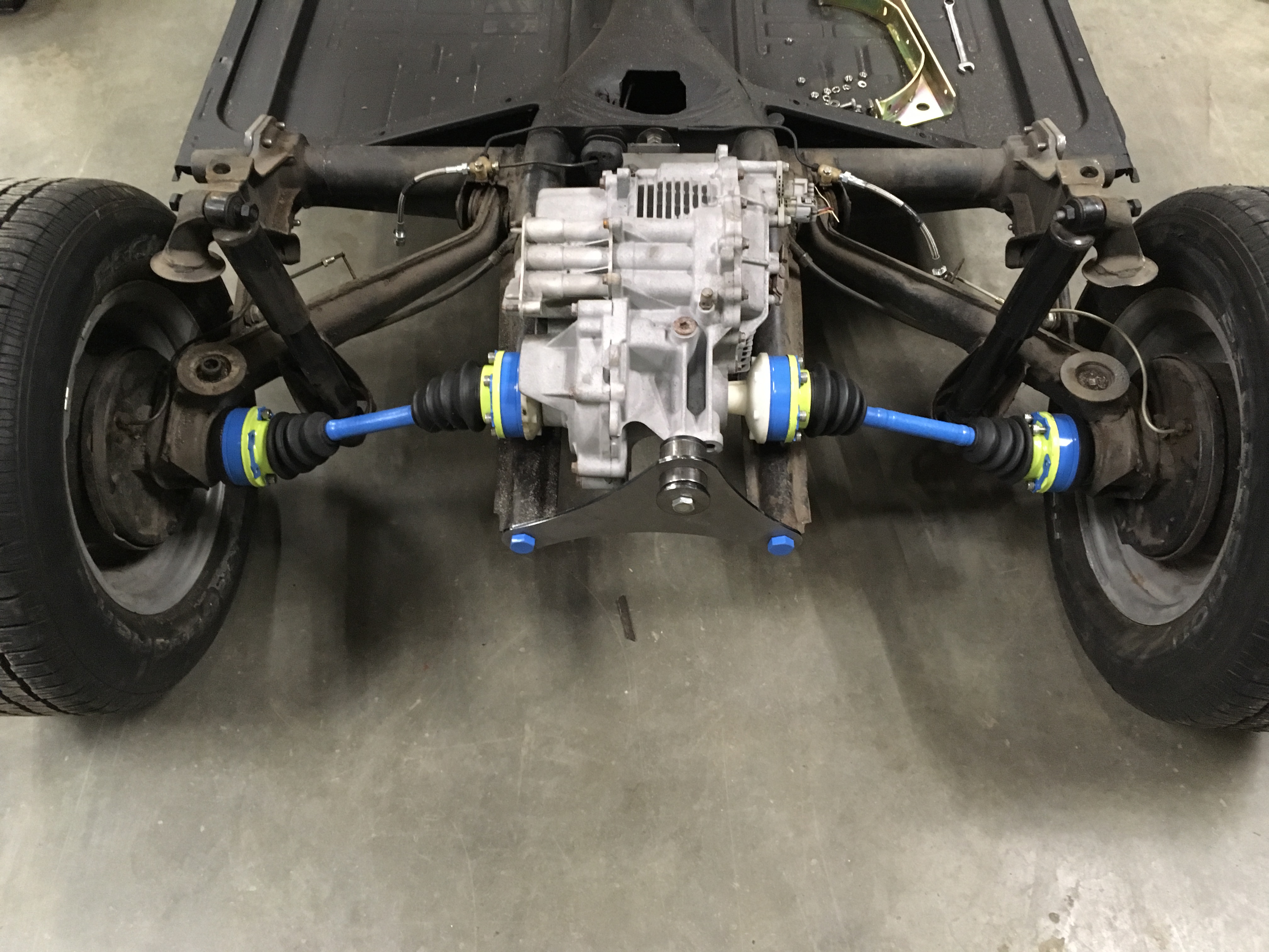

Is the Lexus MG3 the type found in the rear axle of the RX?
Does it have approx 50kw output? Is there a maximum RPM which would limit top speed prematurely?
I'm interested in the idea of putting 2 of these into a 4wd car, particularly an Audi Quattro A4 or A5. Together they may provide acceptable performance.

Yes that is exactly it. I believe it was found in the Toyota hylander hybrid aswell. It is 50kw so when compared with the original 46hp vw motor it should in my mind be quite acceptable of a transplant.
To my knowledge I am not sure of a maximum electrical rpm but would assume that it is always
Spinning in its originally designed purpose it should be okay in this little volkswagen! I thought I read somewhere of 18000rpm max rating but could be horribly incorrect as it has been difficult to get much info out of Lexus...
Biggest question for me is can we utilize the boost converter in some ‘aftermarket’ fashion.
Maybe jack bauer can chime in with some ideas. I don’t know how to tag him so he sees the post though..

519 Kustomz wrote: Sat Jun 01, 2019 1:34 amI want to run the Lexus mg3 for context. I have it all mounted and ready to go in a 74 Volkswagen thing and would love to get it spinning!!
Fabulous :) Can you start a project page (here) please?

Very cool. I’ll assemble some pics and attempt a build thread.
I would love to hear how Jack (Damien) is making on with this. I’m going to get one from my local scrappers to start messing with aswell. Curious if he has cloned and is sending it can signals or what??

519 Kustomz wrote: Sat Jun 01, 2019 12:39 pm To my knowledge I am not sure of a maximum electrical rpm but would assume that it is always
Yes. Must always be spinning since the rear wheels are always turning when the car is moving. But there may be a clutch in there to disconnect at higher road speeds. The motor only intended to provide traction when required.

EDIT: the unit is called the Q211 or referred to as "MGR" Motor Generator Rear. It has no such clutch and is always spinning when the vehicle is moving. Approx 6:1 reduction ratio through a fairly lightweight open differential. It doesn't seem possible to get too much more out of this setup as the internal gearing components would need to be beefed up. So limited in use to light weight vehicles or maybe in dual motor 4wd setup in more medium weight vehicles.
Might be worth pointing out that this unit is air cooled and relies on fairly modest cooling fins on the casing. And therefore may overheat with constant use. However, there is a lubricant drain plug and separate fill plug so shouldn't be difficult to route the lubricant through a pump and heat exchanger then back into the case again.

Right, it is the mgr. I did read that and missed it. I have opened this little unit right up and had a look inside. I love it’s complete simplicity. Your correct it it may not be a power house of a drive but I’m going more for a ‘stock’ power replacement. Ecomodder stuff I suppose. I have already planned on the possibility of a recirculating oil cooler if need be. The boost converter is what I’m excited / curious about. How to jamb the full 650v into this thing...

Its worth noting that Toyota only use the boost converter when the motor needs to run above the speed possible with the base battery voltage.
I think the MGR with a little 12v oil pump and cooler would make an excellent low cost drive unit.
