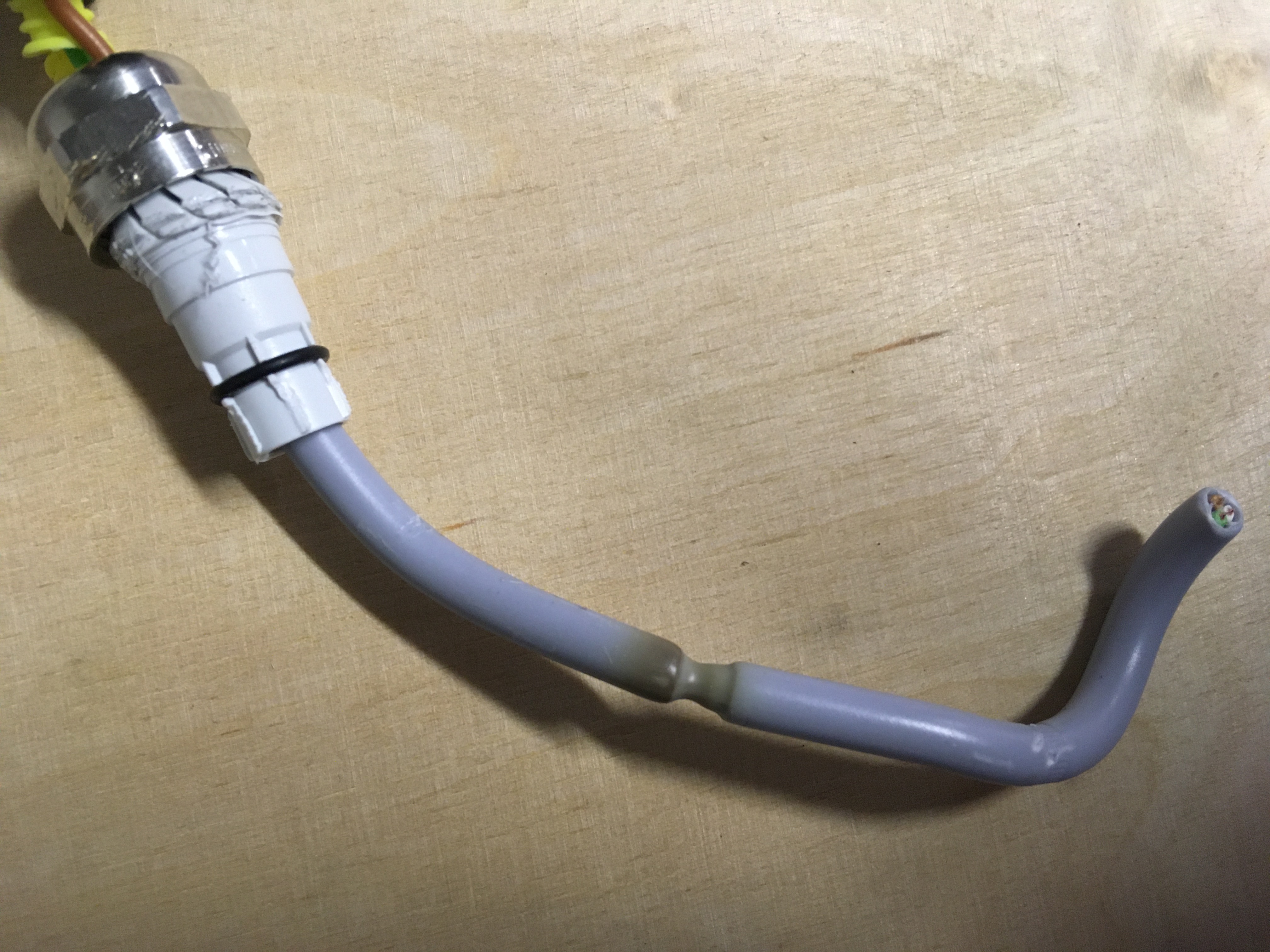

Hello again,
I had a little stress last weeks, because before visit of inspector to look at my conversion I had to prepare all of the documentation, schematics and then wait until he will look at this.
And..., when I tried to charge battery to be prepared for some tests - I had no charging at all :)
From Orion BMS signal was ok - charge but then somewhere was missed. Unfortunatelly CAN#1 was used to communicate with PC and second CAN from BMW was connected to Eltek charger and DCDC so not all traffic was wisible thru #1 to #2. After 2 days of investigation and when I clicks a little to charger with wrench :) I saw one traffic line with sniffer so next step was to kill or replace charger ;)
And probably someone in Eltek had too much force in hands - look at CANbus cable. Second thing - connector from this cable is really delicate and not for 100% grips to board. Better was use hot glue to be sure.

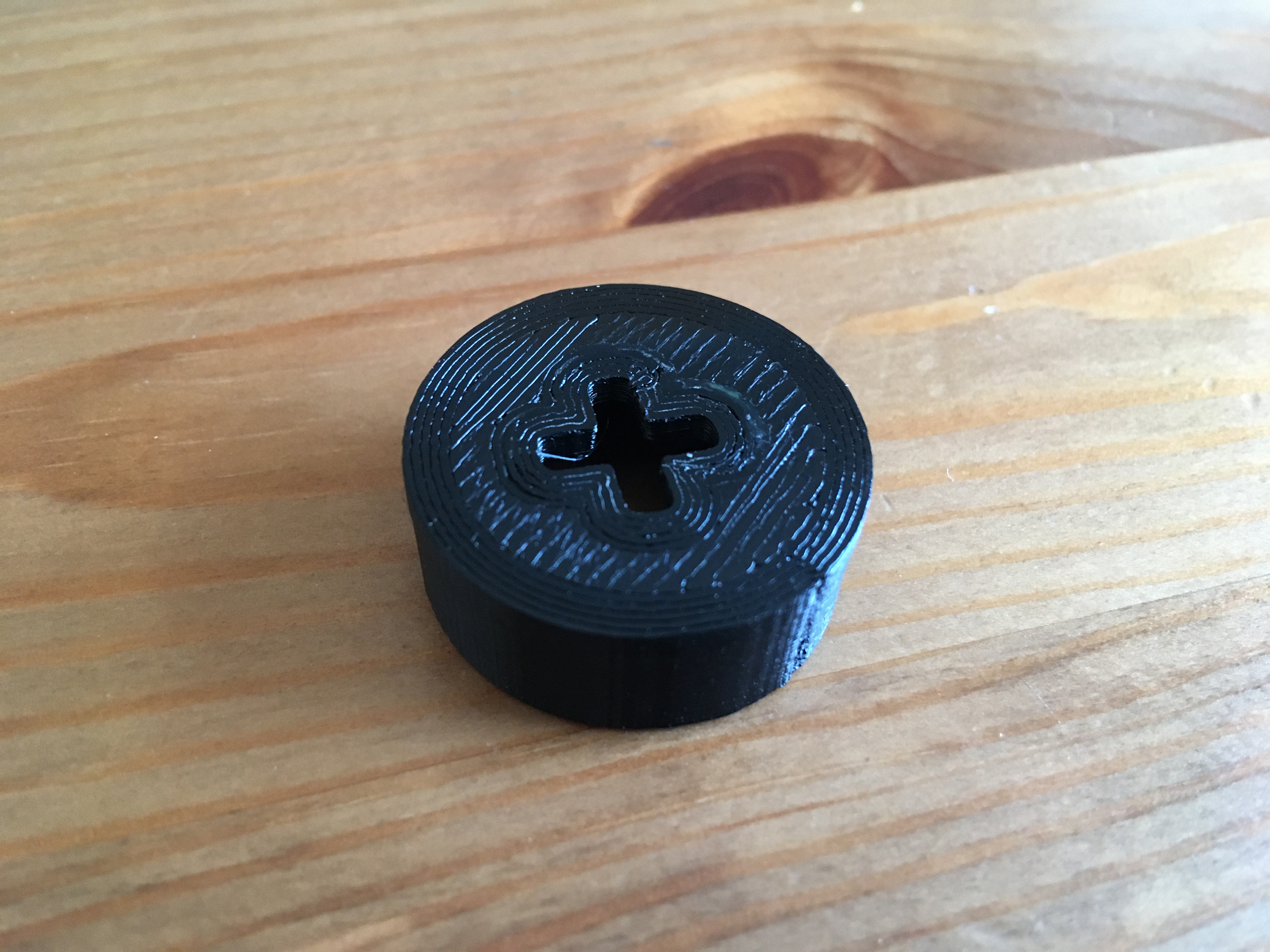

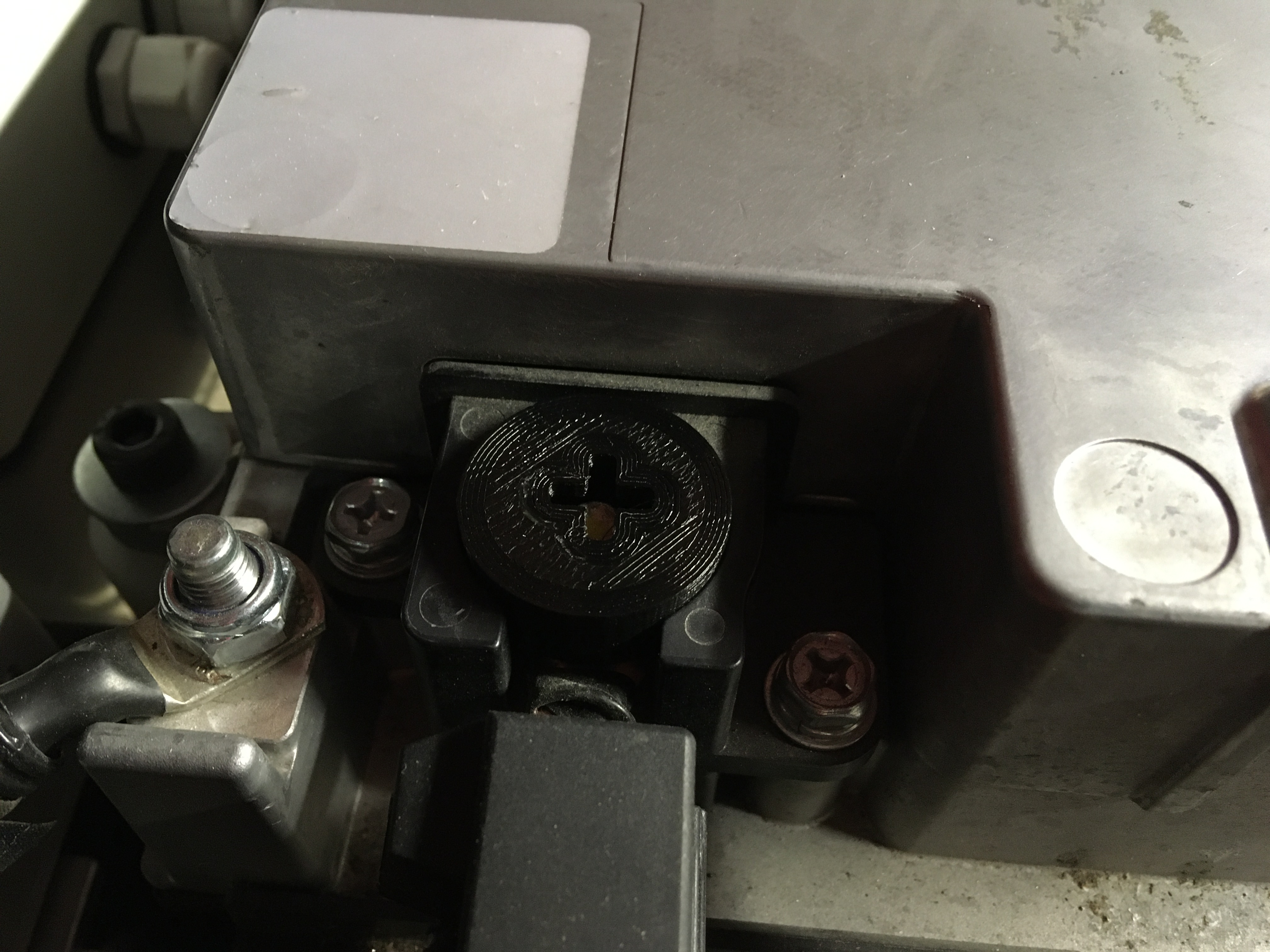

For small un-stress job I did small cover on 3D printer for (+). I never know if some small element will stress me again and touch (-)
