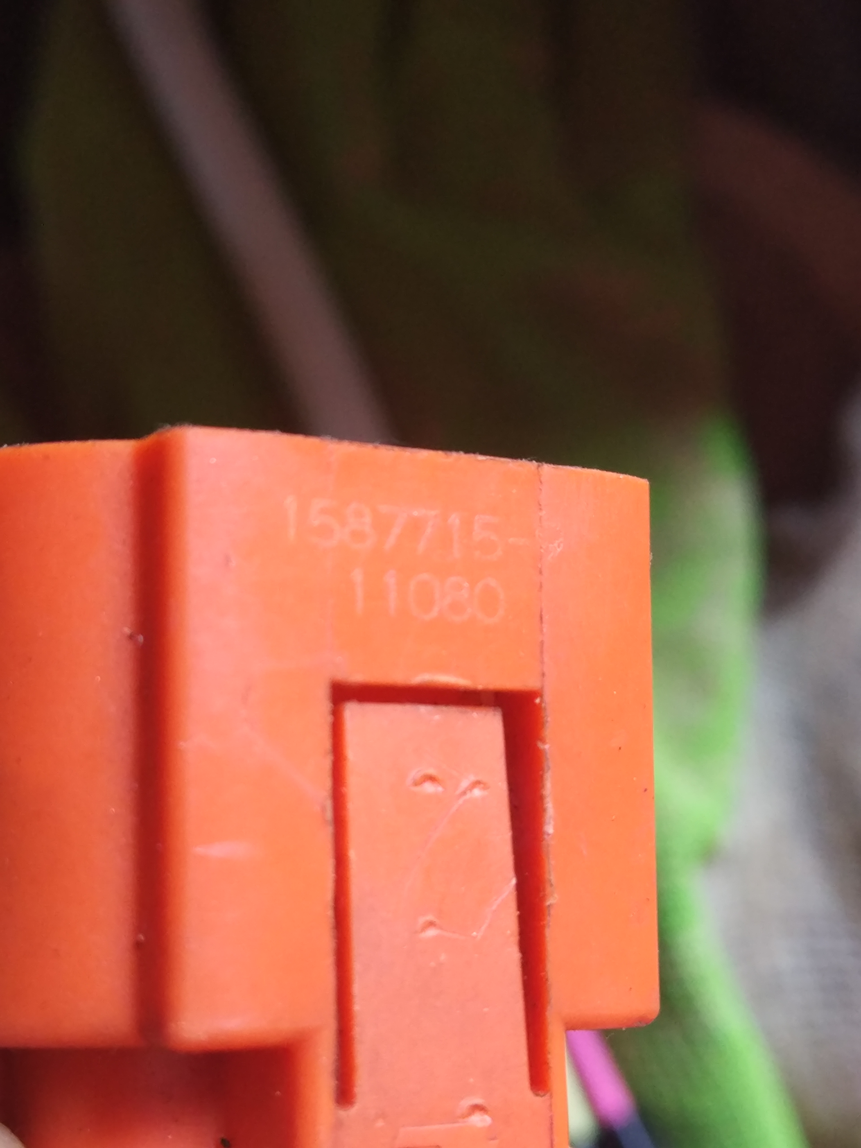

1587715-9 is a TE connector;
https://www.te.com/usa-en/product-1587715-9.html
1587727-1 is a TE connector;
https://www.te.com/usa-en/search.html?q=1587727

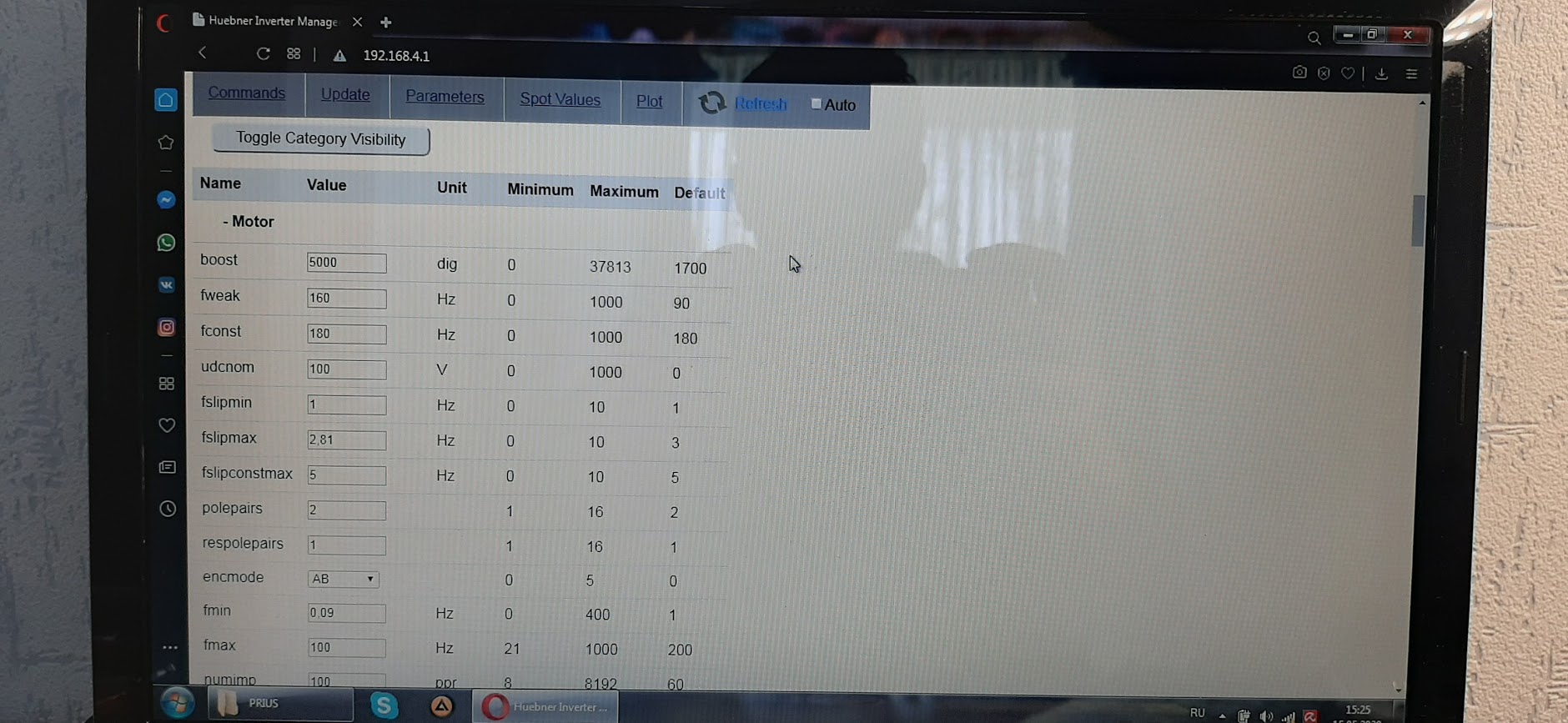

It's been a while, but contactors made it to my door. And I have got some free time to play with gen2 board.
I provided power to the board and bluepill shows solid green led and blinks with red led. That is OK. Update. Loaded stm32_loader, then loaded stm32_sine. Everything is OK.

I'll duplicate my current problem in this thread:
Trying to programm blue pill on a gen2 board with attached contactors, I've bumped into a problem. Every time I connect 12V to a board, precharge contactor cycles "on/off" three times and one time "on" in one second. I believe it cycles every time controller faces an error. There are three errors show up: And if I connect "start" to 12V, precharge contactor turns off as intended, but main does not turns on.
Am I the only one to face such a problem? Have I done something wrong?
Is latest software compatible with gen2 board pinout?

UPD: so control board was tripping because of economizer in contactor... however same three errors are still there.

The software expects the current sensors to read somewhere close to zero at startup. That's both your offset errors.konstantin8818 wrote: ↑Sun May 17, 2020 7:39 am UPD: so control board was tripping because of economizer in contactor... however same three errors are still there.
