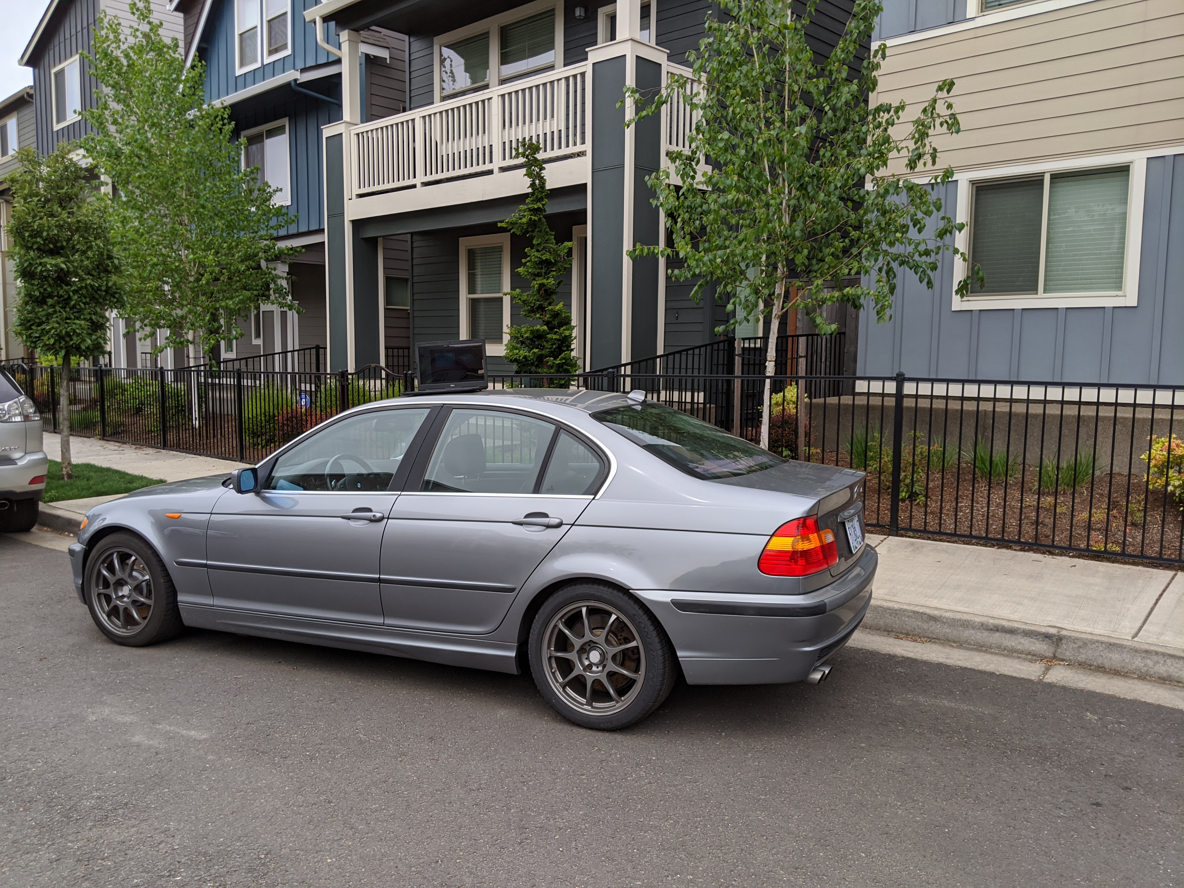

Previous posts were from the now M3 hybrid thread. There's not too much going on there either as I really need to get this done first. I've made good process on the M3 SMG gearbox control recently, but that's about it.
As for the 330, here's the current plan:
