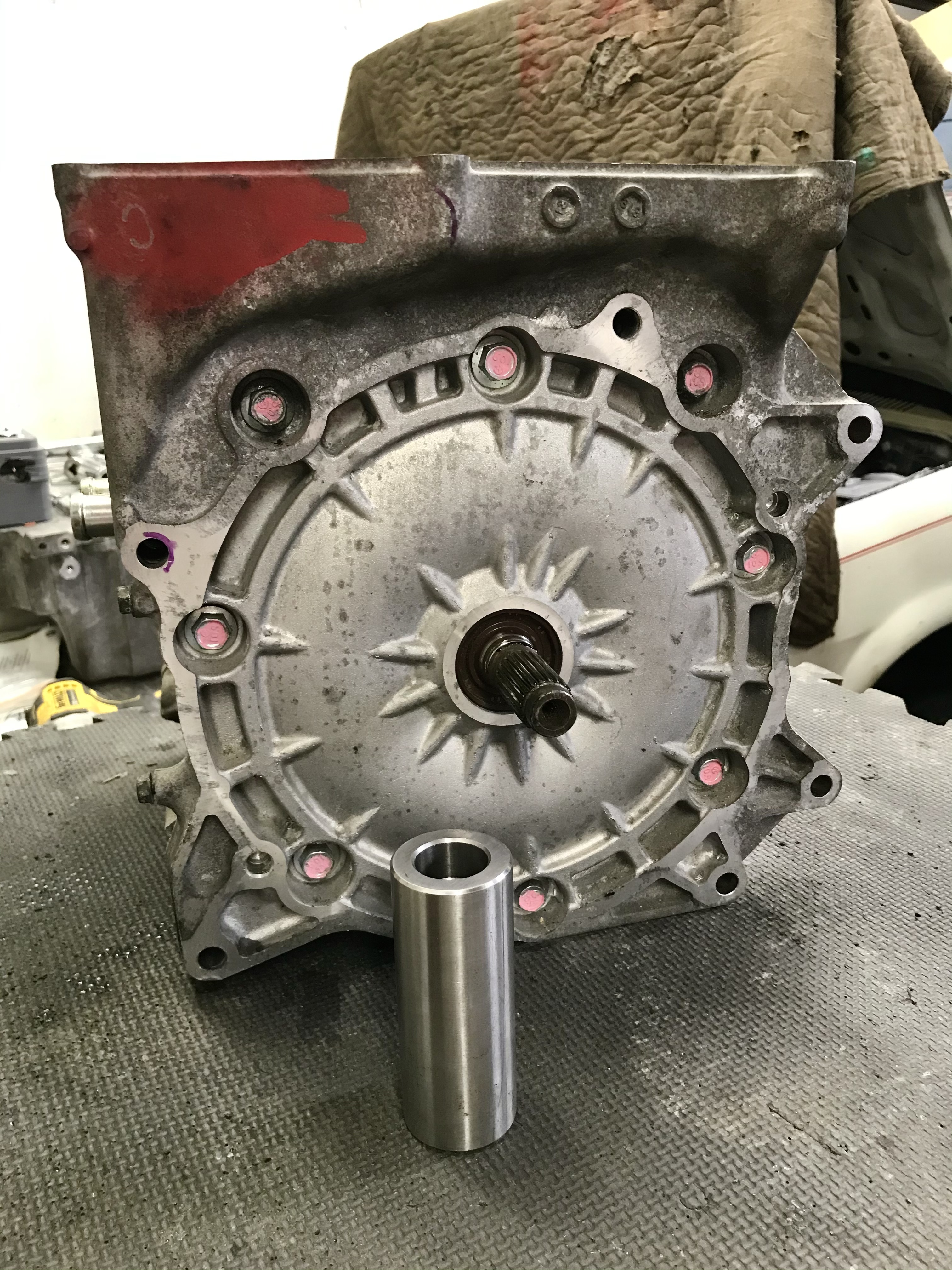

Leaf spline coupler
Buy and sell
Posts: 1080
Has thanked: 222 times
Been thanked: 413 times
Leaf spline coupler
gen1 (em67) and gen 2 leaf motor (EM57) shaft coupler
4149 chromoly steel
-designed to optionally mate with a 7208b angular contact bearing (removes any loads on the leaf motor shaft)
additional machining required
Adapter plate CAD :https://github.com/angusjo/leaf-splines ... ate.SLDPRT
When the bearing is utilized, mounting flywheels or drives shafts is possible.
260$ CAD + shipping
I hold no liability for any results occurred from the use of the coupler.

Whats the plan on cutting the splines? EDM or broached?
Posts: 1080
Re: Leaf spline coupler
slow67 wrote: Mon Feb 24, 2020 8:06 pm Whats the plan on cutting the splines? EDM or broached?
Broached currently, still looking at edm services.

That's probably ideal. Any common machine shop should be able to do any desired pattern, but EDM or broaches are few and far between. Im in for one for sure with no bolt pattern on it.
Mouse
Posts: 140
Location: Wales
Been thanked: 7 times
Post by Mouse »
How did you determine the profile of the splines?
I've got a Outlander rear motor here with a splined output and can't find anything that might fit the splined shaft.

The ghetto Leaf coupler is a Blue Print ADC43101 clutch disc or similar. It fits a bunch of japanese and korean vehicles and is cheap.
It's a loose match and probably different spline profile, but I've been running it for almost 30 000 km in my minivan so far just fine. There is enough meat in the splines. I assume the quite soft motor shaft will adjust to the very hard clutch profile over time.
If anything, at least it's taking a whole lot of time for anyone to be able to tell me "I told you so". 8)

Currently away, but couplers are on order.
Ill try to dig out the specs. Spent a good amount of time setting the coupler up to be fairly universal for most people’s needs
What I currently access to.
was ether a 3in or 2.75 di plate with centring marks that match the rotex gs38 bolt pattern.
couple will nest in an angler bearing, with renting clip. For those wishing to run a clutch or drive shaft.
