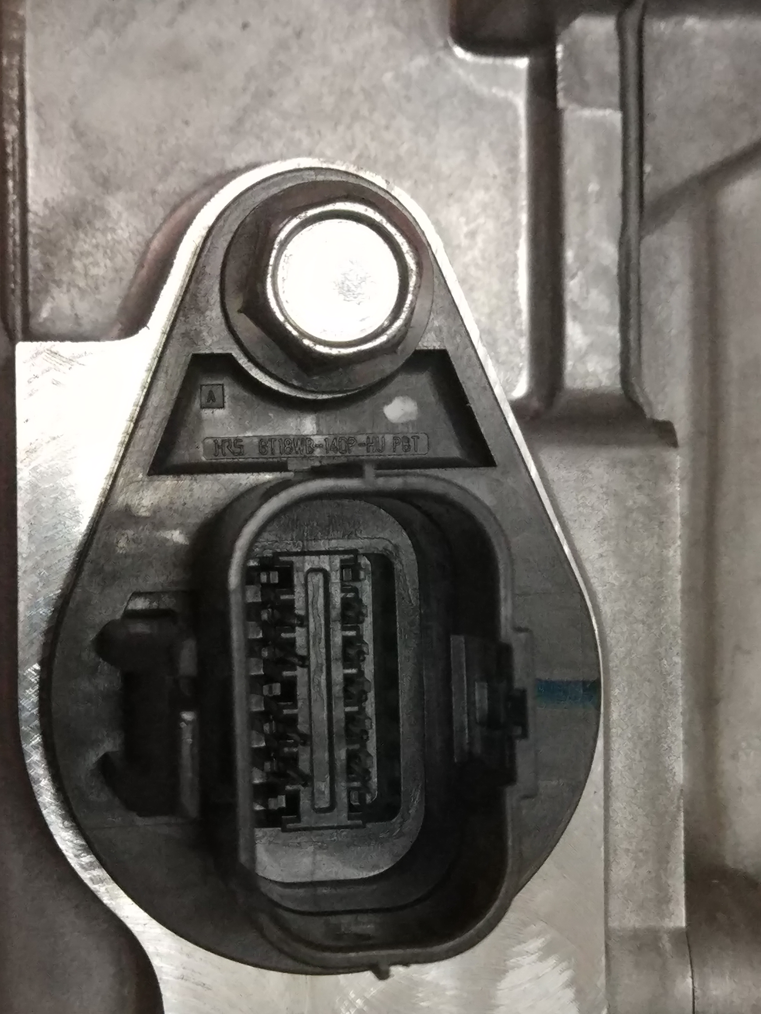

Hm... do you happen to know which plug to buy to connect to charger LV connector? I hope it is not unobtanium...
tnx
Re: Mitsubishi outlander charger and DC:DC
The lv connector is used on a couple of Japanese models, I'll try dig out the part number. If you zoom in on my picture you'll see I used lots of 2 way connectors pushed into the pins, they work fine. There's not too many wires.
I found what I believe to be to lv connector part number, the inverter connector is marked 12716.
The Toyota part number for the inverter side is 90980-12716.
The mating connector on the vehicle side, which we need to connect to the inverter is 90980-12326
I imagine a Toyota dealer can supply with pins.

Does anyone know which P/N connector for LV signals does rear inverter use? I have the motor resolver connector - RH side one. But i dont have the LH one. Wiring says D-211. Does anyone have parts catalog?
Here are some pics...

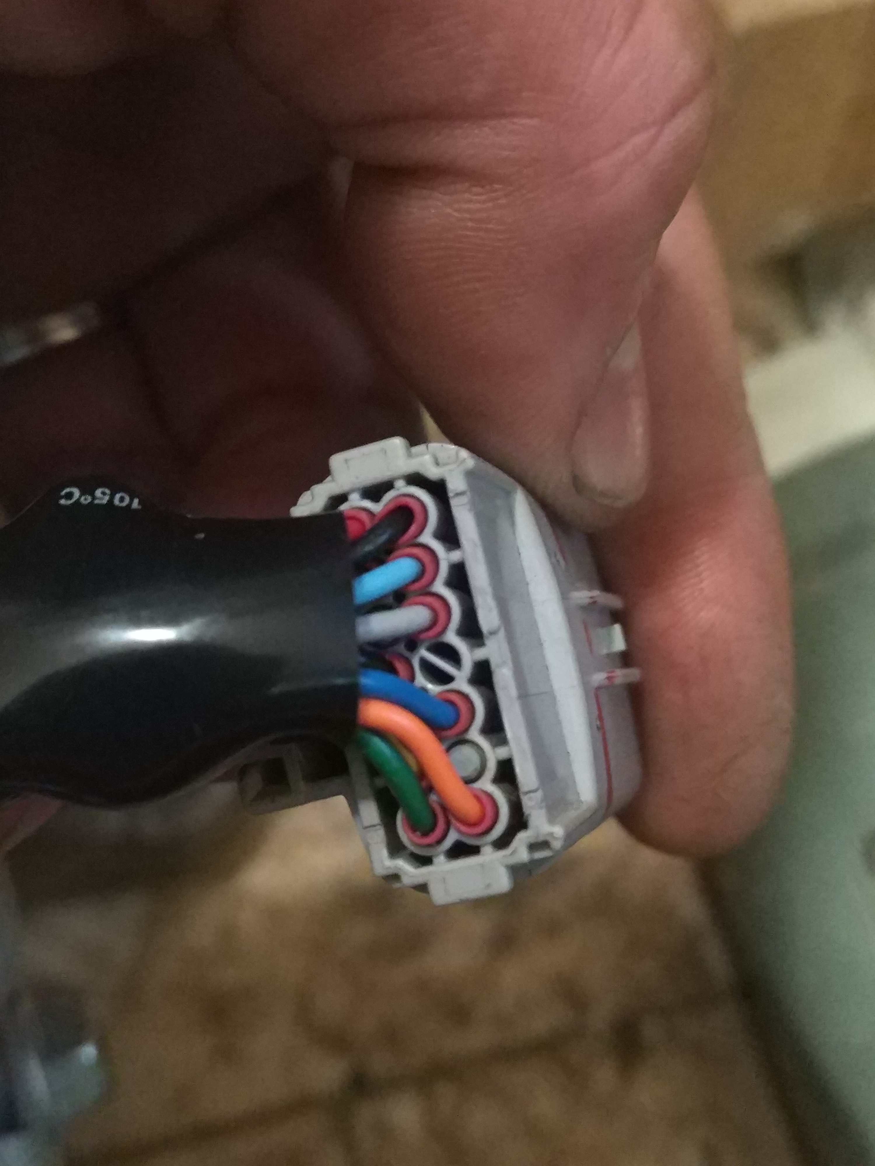

What colour are your DCDC command lines?
Pin 4 DC SW (enables the DC:DC converter, seems to just target 14V when this is high) -- GRAY
Pin 7 Sense line for DC to DC converter --- GREEN
Pin 10 GND --- BLACK
I managed to pry the unit open to determine which side connector is positive...pics. Also one pic of the N/L/PE connections.
I had no luck with DCDC starting.
When i connect pin 10 (GND) i get a little spark. But then if i connect enable and sense pins i get nothing.
Did i mess up my connection?
This is the connector on my charger side.
Your circuit is for the male one or the female on the side of the car?
Yes the DC:DC is pin 4, which i think it the grey wire.
Pin 7 & 8 connected to 12V VBAT (one powers the charger the other is the sense line for the DC:DC
Pin 10 is ground.
Once these connections are made you should see data on the CAN bus.
Then bringing pin 4 high the DC:DC will start.
I obviously also connect a heavy-duty ground to the case of the charger and the output of the DC:DC is the black cable which i bring to the battery 12V.
Pin 10 is ground.
