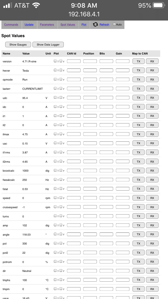

Ok I double checked all the parameters and switched my encoder to AB instead of single.
Also the ilgain I think is accurate, if I change it to -1 it reads a positive number when it should read 0 (before the start signal happens). Maybe the multiplier changed with new software/hardware versions?
With the encoder changed, the motor would spin at a snails pace and jog (whatever the word for clunk and not smoothly spin). Adding throttle made it spin very slightly faster. I switched back to single mode and now it runs like that in v4.76 and v4.71 all the time. It still will not close the main contactor in the newest test version or 4.56.
I also tried swapping my encoder wires and it has the same run ability no matter which way they are connected.
I even tried a different battery just in case.
Unless I have a dcnom value it won’t spin at all.
So now it runs even worse than before!

Which encoder wires were swapped?wigman wrote: ↑Thu Apr 16, 2020 5:42 pm Ok I double checked all the parameters and switched my encoder to AB instead of single.
Did you try uploading the full json file I linked?
Single encoder is the wrong setting for this motor. Theres no debate on that.

I swapped a and b. In the stock and swapped positions everything acted the same.
I loaded the parameter file and the motor won’t turn at all. (If I change the udcnom it will run very slow and very jerky)
I have the encode mode now in AB in every setting I try.
At 100v or so try setting ampmin to 0 and boost to 1000.
Set udcnom to 0. This is messing with boost and fslip too much at this level. At 100v, a 390 udcnom would result in a 1700 boost value becoming 6700 and fslip 5.6. The boost is well out of the range you want to see.
I set ocurlim to -2500 and il1 and il2 to -1. My contactor will flip without overcurrent but it doesn't change runability.
I changed udcnom to 0 and boost to 1000. The inverter will make a quiet whine when put in drive or reverse but the motor will not spin. This has been the case in all parameter settings where udcnom is 0. That's why the motor only spun when I loaded the E30 parameters.
Attached is the current parameters I have for testing.

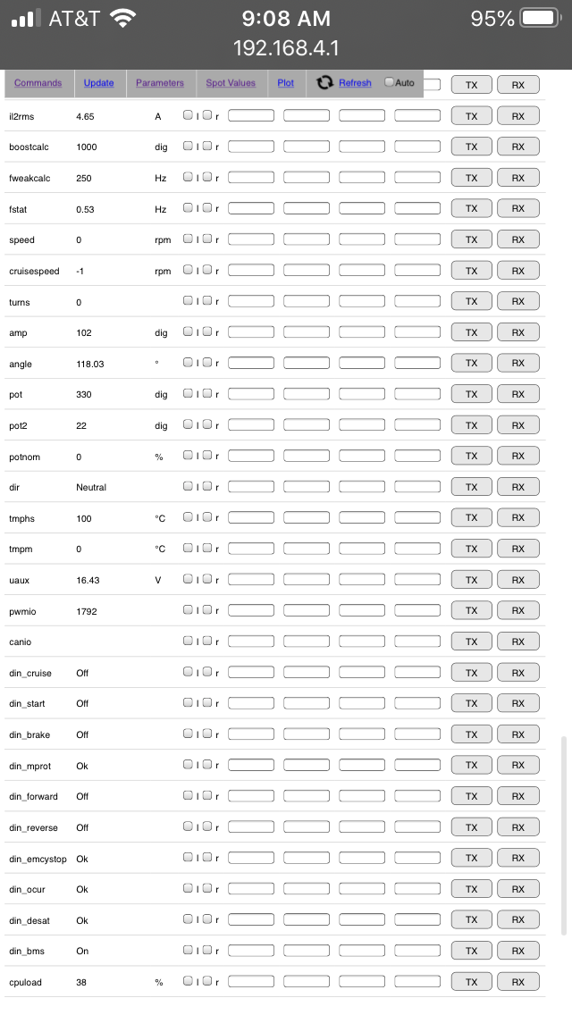

Also there are the spot values when the ignition is turned on and the start signal has been sent with the main contactor closed and in neutral.

Your heat sink is reading 100C, please stop overloading the drive unit and smashing changes in it without figuring out what is going on.
The inverter is limiting hard due to the temperature reading.
I would advise for extended testing to get coolant flowing. Your settings do not look miles off from what it takes to spin a motor.
If you follow other posts you will see there was a temp sensor errors with MUX. There was an open task created and Johannes posted revised versions that fix that problem. The actual heatsink temp is 23c. Besides that the other versions fix the issue, you can graph the temp on this version and see it toggle from 23 to 100 over and over again due to the programming error. Unfortunately the newest version won’t even close the main contactor so I’m using the version my board came with for testing.
That being said, the inverter is derated with this version, but it’s not even spinning like it was previously. If you read my previous posts, I actually got the motor to spin the correct way with the newest revised version once. 5 minutes later I turned it on again without changing any settings and the main contactor wouldn’t even close. I really don’t think this is a software or parameter issue.
