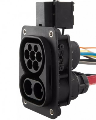

m.art.y wrote: Sat Nov 05, 2022 10:57 am Hi guys, just wanted to ask if anybody used a Duosida CCS socket with a LIM and got it working? I read through the thread and a lock seems to be a must. By lock is it meant the Type2 socket lock on the top as in the photo? If so it is rather high profile has anybody seen any smaller versions of the lock? 😊
Very easy to get working, all is on the wiki https://openinverter.org/wiki/BMW_I3_Fa ... LIM_Module
there are lower profile locks, like https://zero-ev.co.uk/shop/lockpincp-lo ... desc#attr=

Or go to a breaker of an ID3 / ID4 that's what i did.
It has the lock lateral...

For reference, this is what my BMW i3 inlet looks like:
I picked this up from a breaker in Latvia (I think) a few months ago for well under USD$100 including shipping, with about 4' of harness.
It's a Type 1, though. That matches my locale.

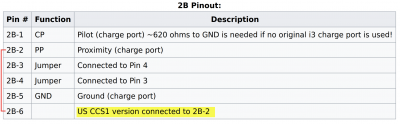

Hello everyone, help to solve the problem. I have a lim 2014 USA.(...646) The welding test passes normally. I see. 272,false,Rx,0,8,33,F3,01,11,FF,FF,FF,FF, Then I connect the connector of the charging station, the LED starts to glow yellow. 3B4,false,Rx,0,8,00,FF,31,F0,BC,FF,00,00. Everything seems to be going well. But only I start seeing this message: 3E9,false,Rx,0,8,08,52,11,00,00,00,00,00Everything stops and the LED starts flashing red. At first I thought I had a port blocking problem. I even wired a separate switch to manually enable the lock. Still nothing happens.

Post by muehlpower »
Eltis wrote: Tue Nov 08, 2022 3:29 amOk. Thank you.
Did you notice that the proxy has to be connected to pins 2 and 6 on USA models? BTW, US and EU LIMs are the same and can be recoded.

muehlpower wrote: Tue Nov 08, 2022 12:19 pm Did you notice that the proxy has to be connected to pins 2 and 6 on USA models? BTW, US and EU LIMs are the same and can be recoded.
I paid attention to it. I bought the lim together with wires and a conectors. Do I need to put an additional jumper between 2 and 6? Because now there is no connection.
As I said, on EU models, pin 6 remains open and proxi is connected to pin 2, on US models proxi is connected to both, pin 2 "and" 6.

Post by asavage »
Eltis wrote: Tue Nov 08, 2022 1:57 pm Do I need to put an additional jumper between 2 and 6? Because now there is no connection.
https://openinverter.org/wiki/BMW_I3_Fast_Charging_LIM_Module#Connectors_and_Pinouts
If your LIM was sourced from a US-coded vechicle, very probably you will need to jumper 2B-2 to 2B-6.

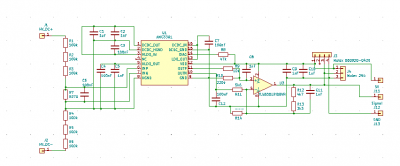

Hello. Is there an error in the voltage meter circuit? By connecting the polarity of the power supply TLV 6001 ?
Eltis wrote: Sun Nov 13, 2022 12:15 pmSensing.png
There are different types of TLV6001. With the "R" version, pin 5 = V-, pin 2 = V+. Without "R" it's the other way around. With the "U" version, the inputs and outputs are different.

Post by Eltis »
muehlpower wrote: Sun Nov 13, 2022 2:21 pm There are different types of TLV6001. With the "R" version, pin 5 = V-, pin 2 = V+. Without "R" it's the other way around. With the "U" version, the inputs and outputs are different.
Thank you.
is it possible to install id instead of rid? By changing the polarity of the power supply?

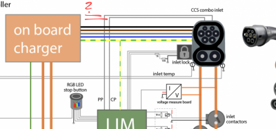

Zapatero wrote: Fri Nov 25, 2022 11:56 am If I use an onboard AC charger that wants the CP and PP contacts, too, can i just connect them parallel to the LIM?
It's already in there
It is not possible to have two car-side charge controllers connected to the pilot line simultaneously. It is recommended to control the charger by CAN bus. If your charger needs the pilot signal, you will have to emulate it or switch the pilot connection wiring over to the active charger during AC charging.

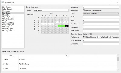

If I decide to switch CC and CP signal with a relay, what would be the indicator for the relay to know if it's open or closed. Which signal can i use to recognize if a Type2 or CCS plug is plugged in?
larsrengersen
Posts: 171
Has thanked: 16 times
Been thanked: 36 times
Post by larsrengersen »
Perhaps there are other ways too, but I'd look at CAN message 0x3B4 from the LIM and within that at the Pilot_Status.
As soon as that becomes 0x01 AC not Ready or 0x02 AC Ready you know the LIM has detected a PWM signal at the CP line that corresponds with AC charging.
