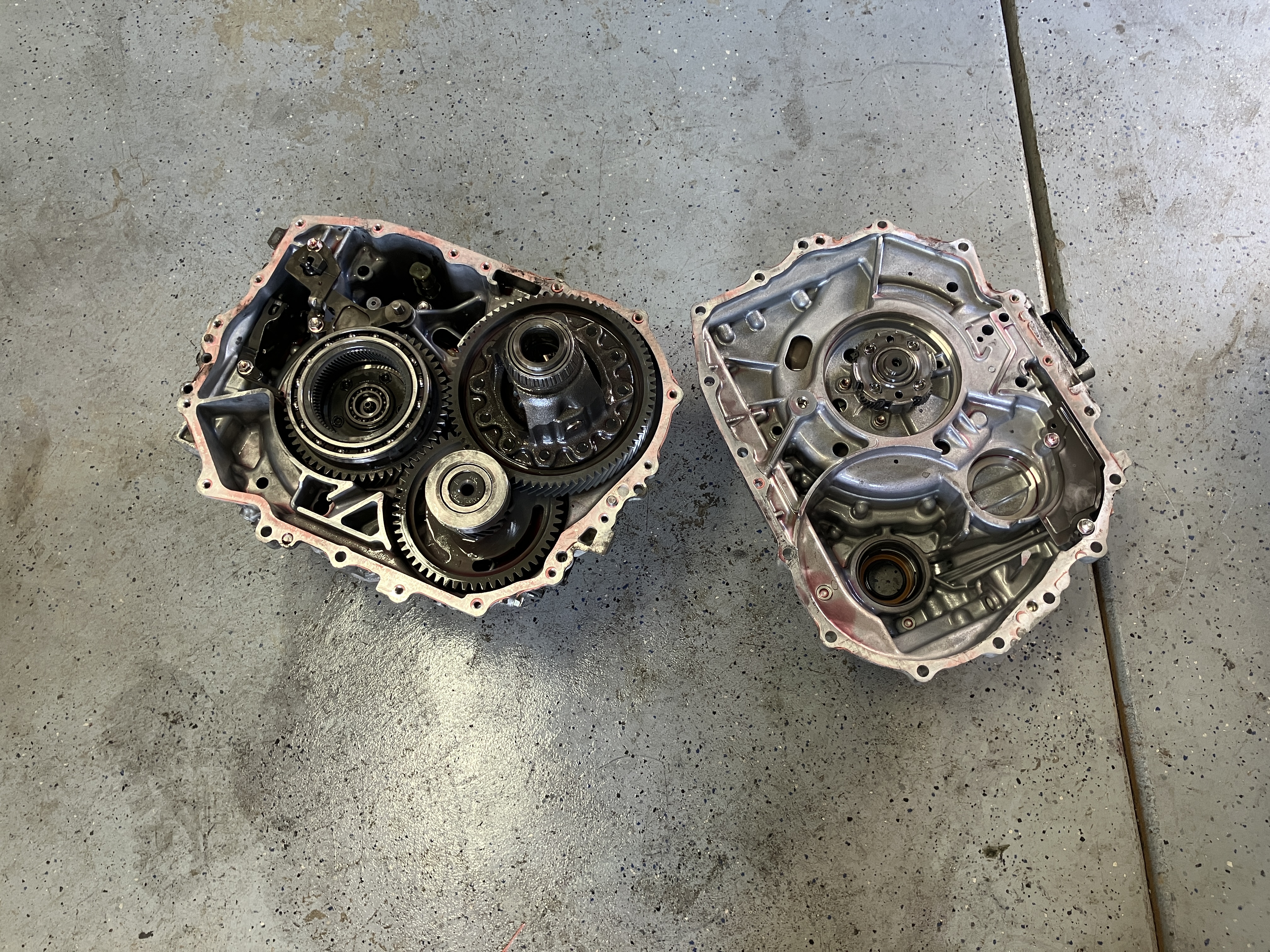

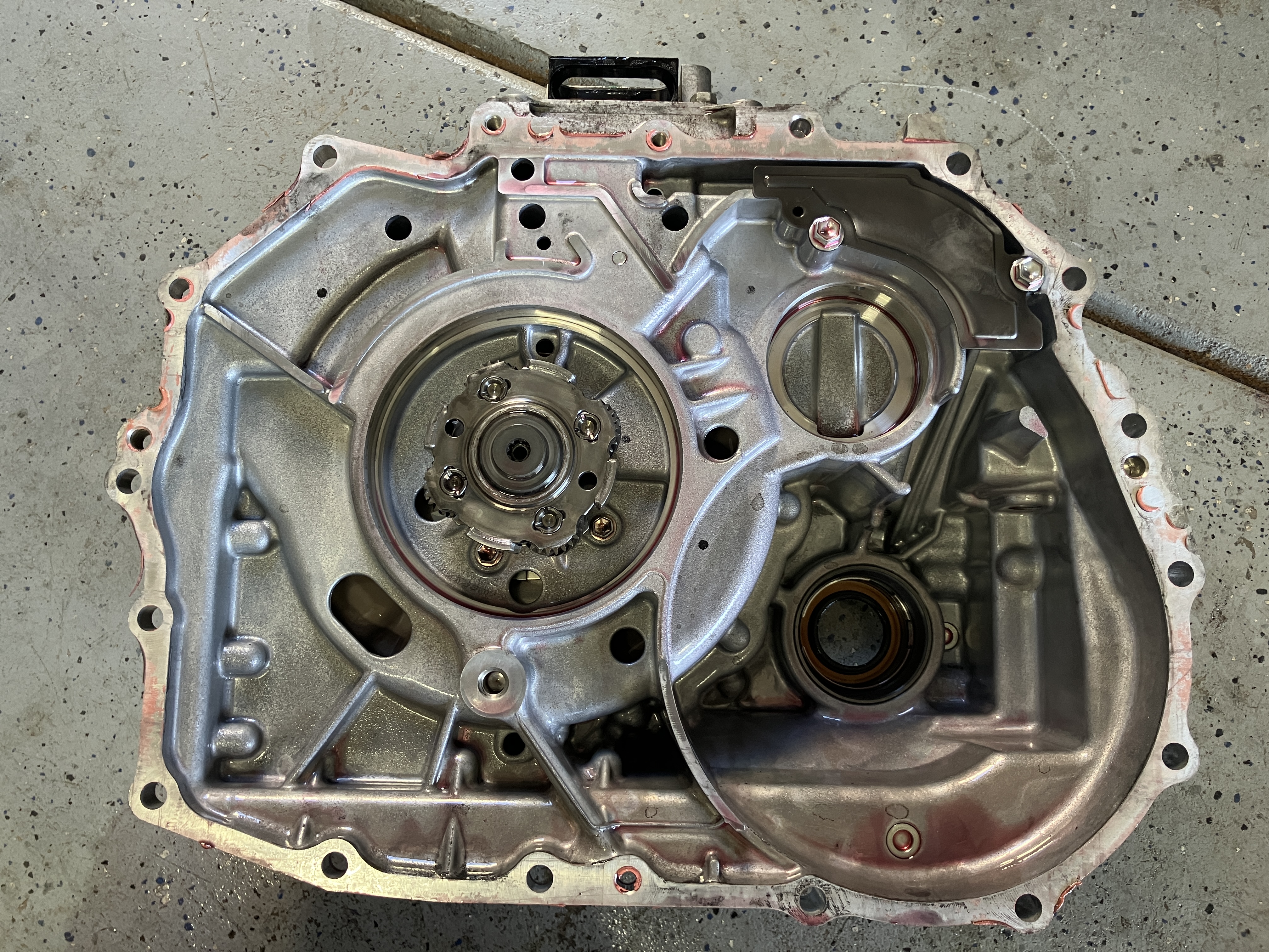

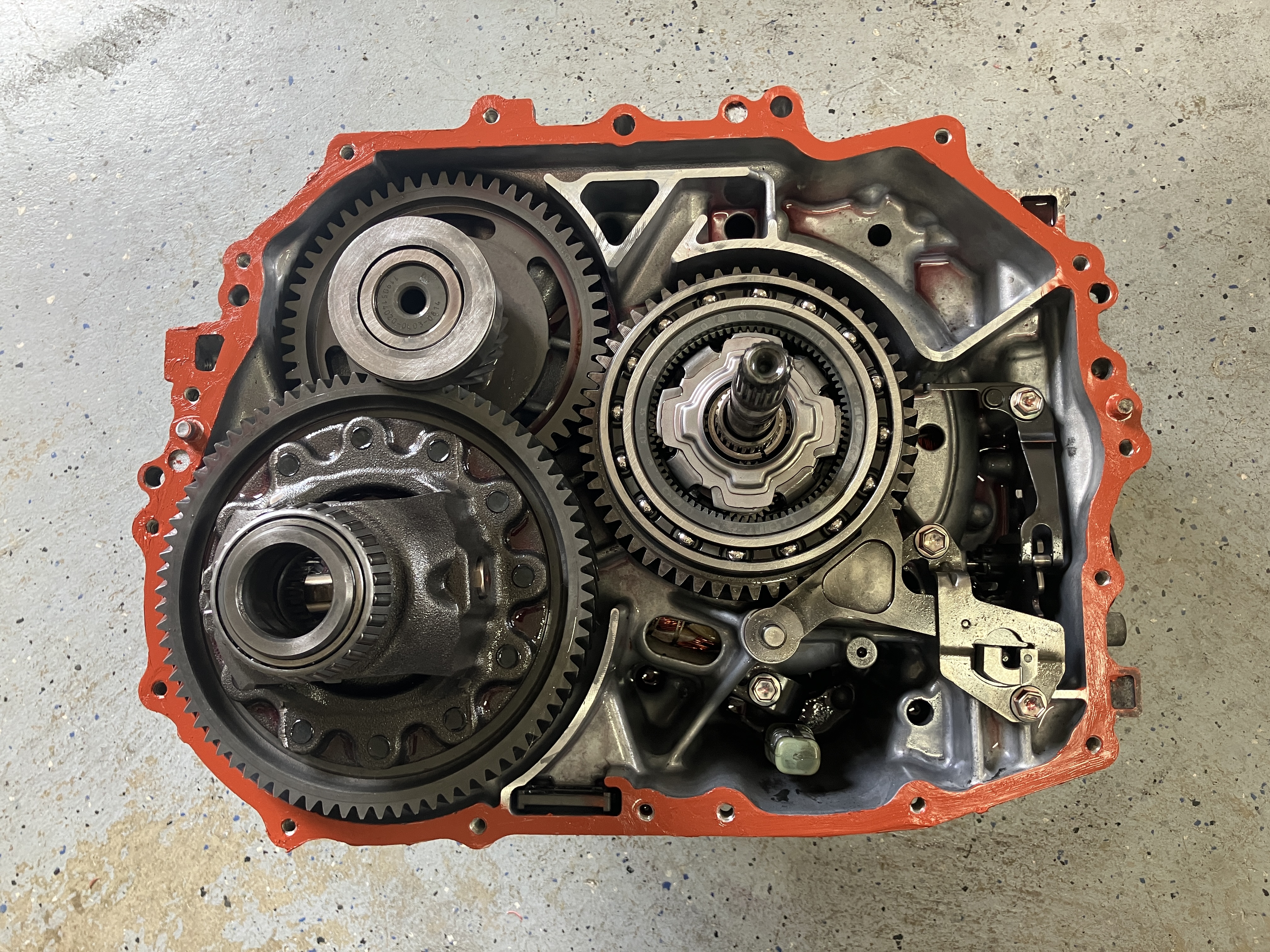

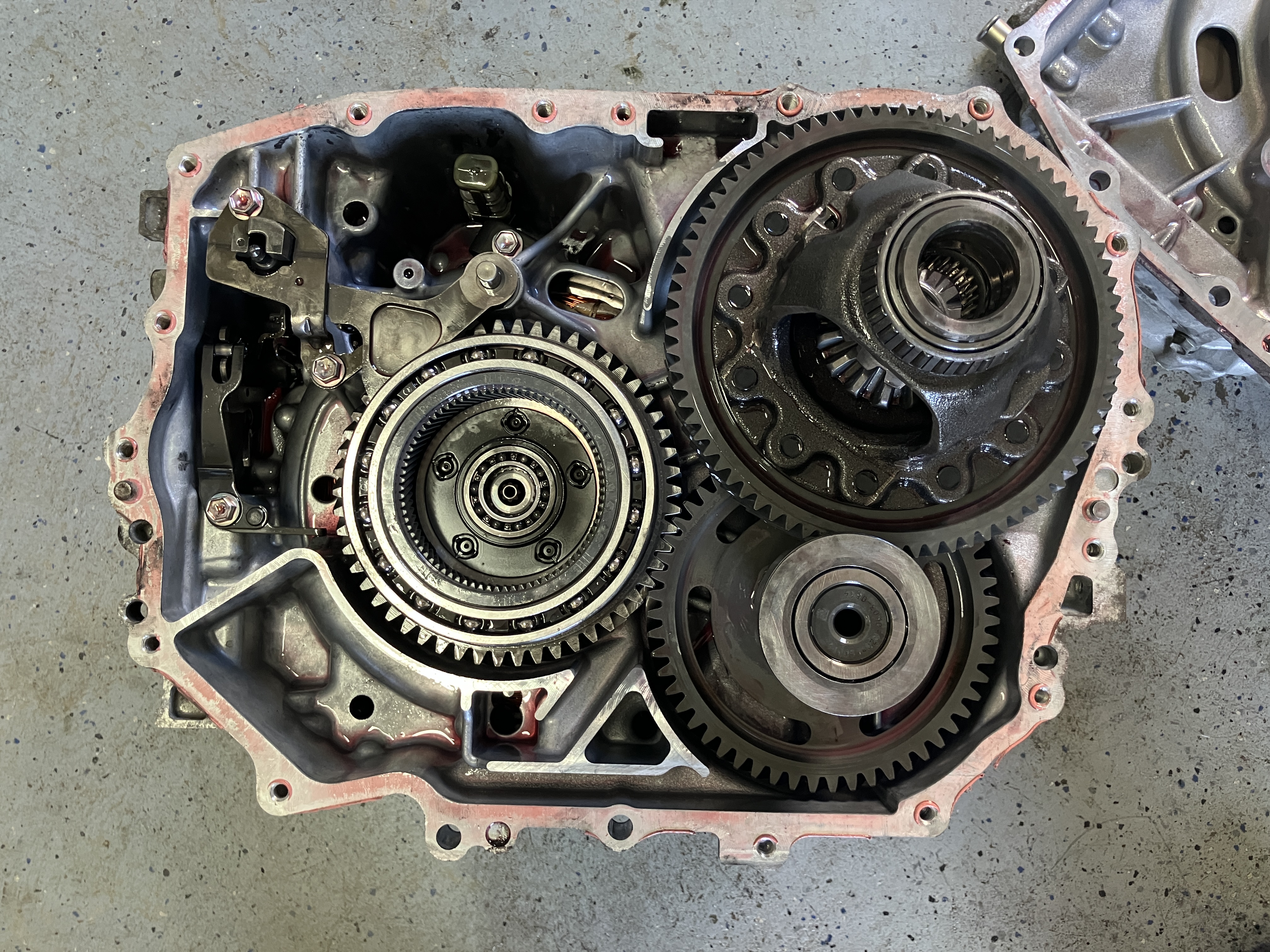

so I thought it was the Parking Pawl causing that click clock noise
Gregski
Posts: 3171
Has thanked: 635 times
Been thanked: 1611 times
Post by Gregski »

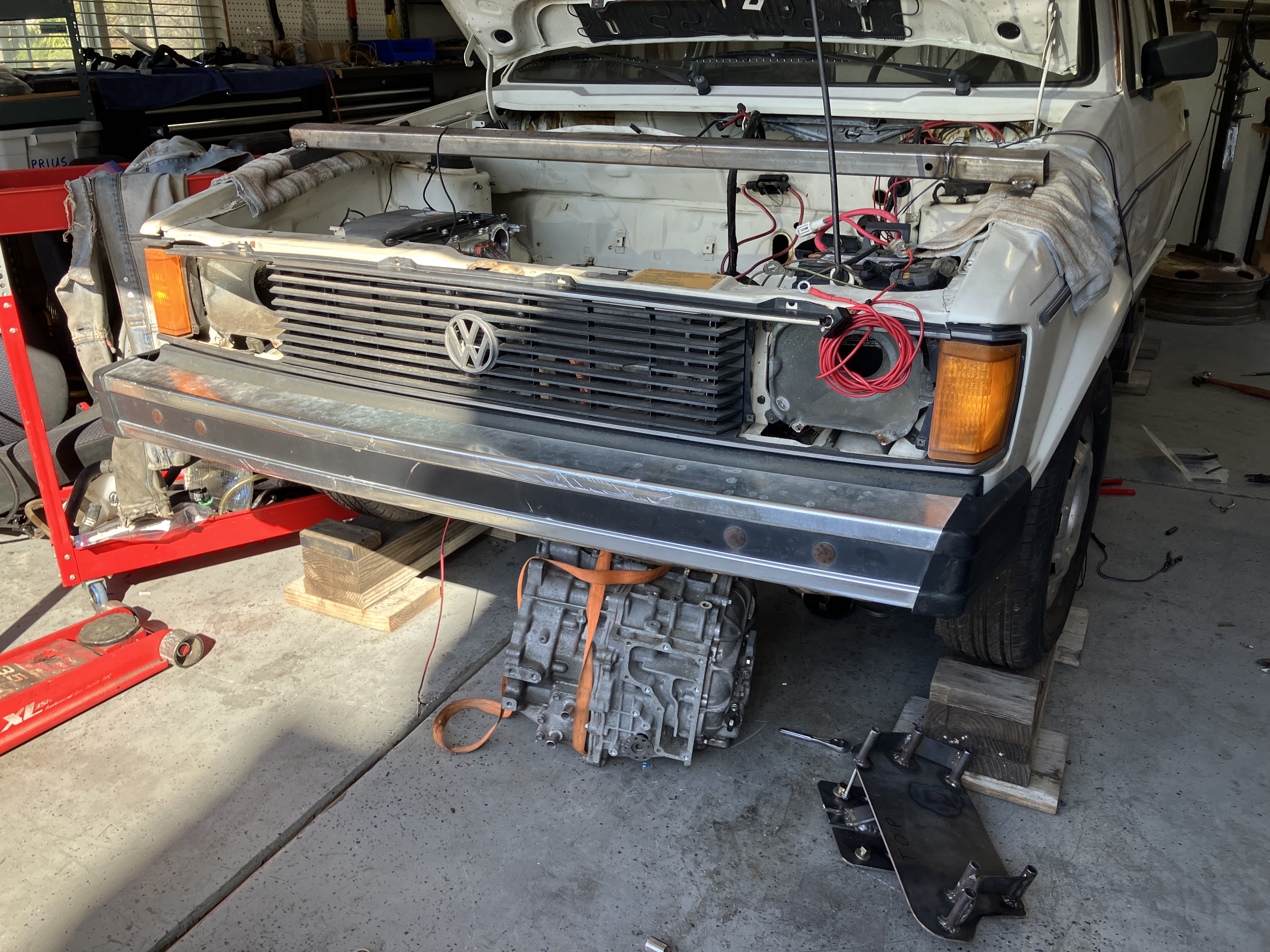

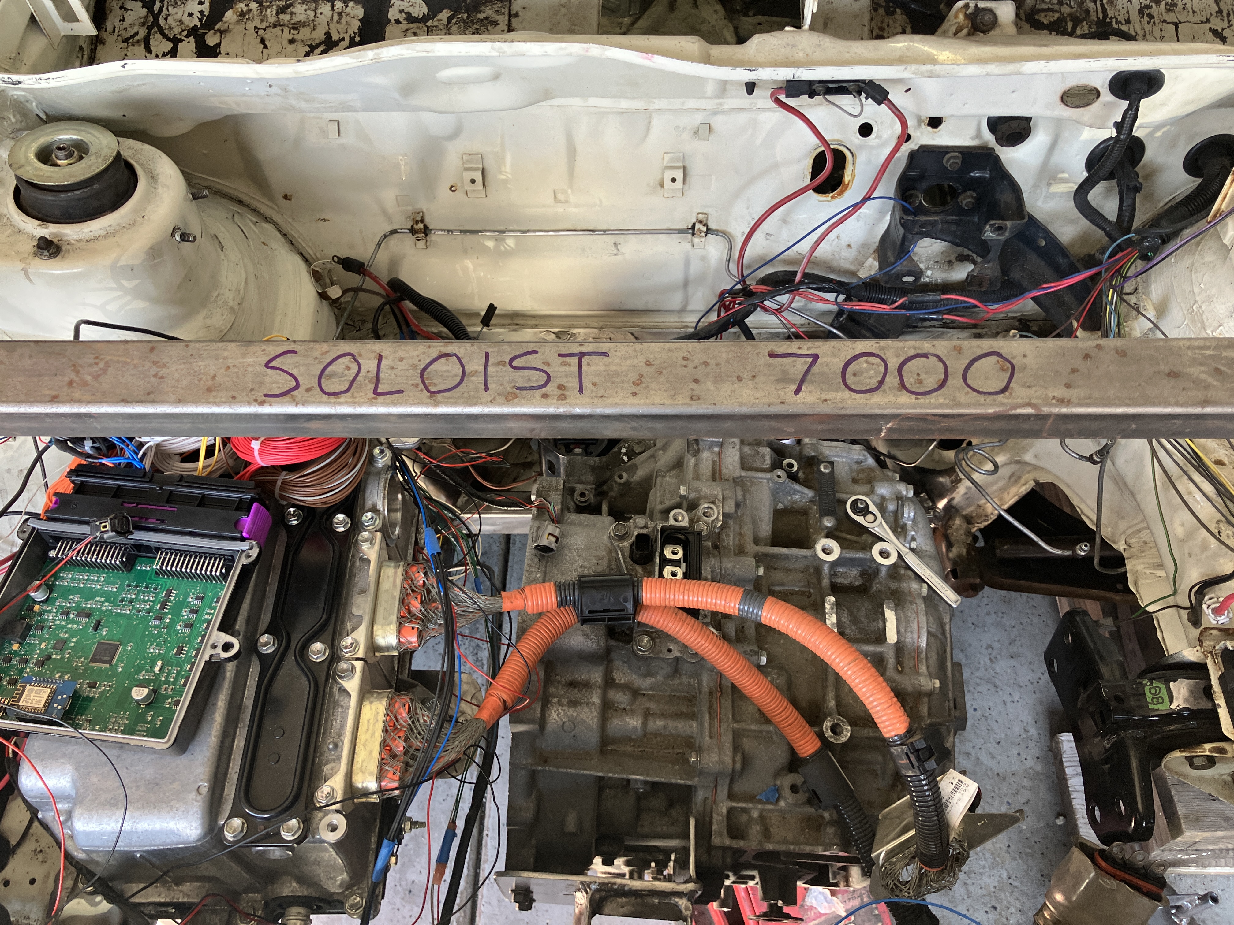

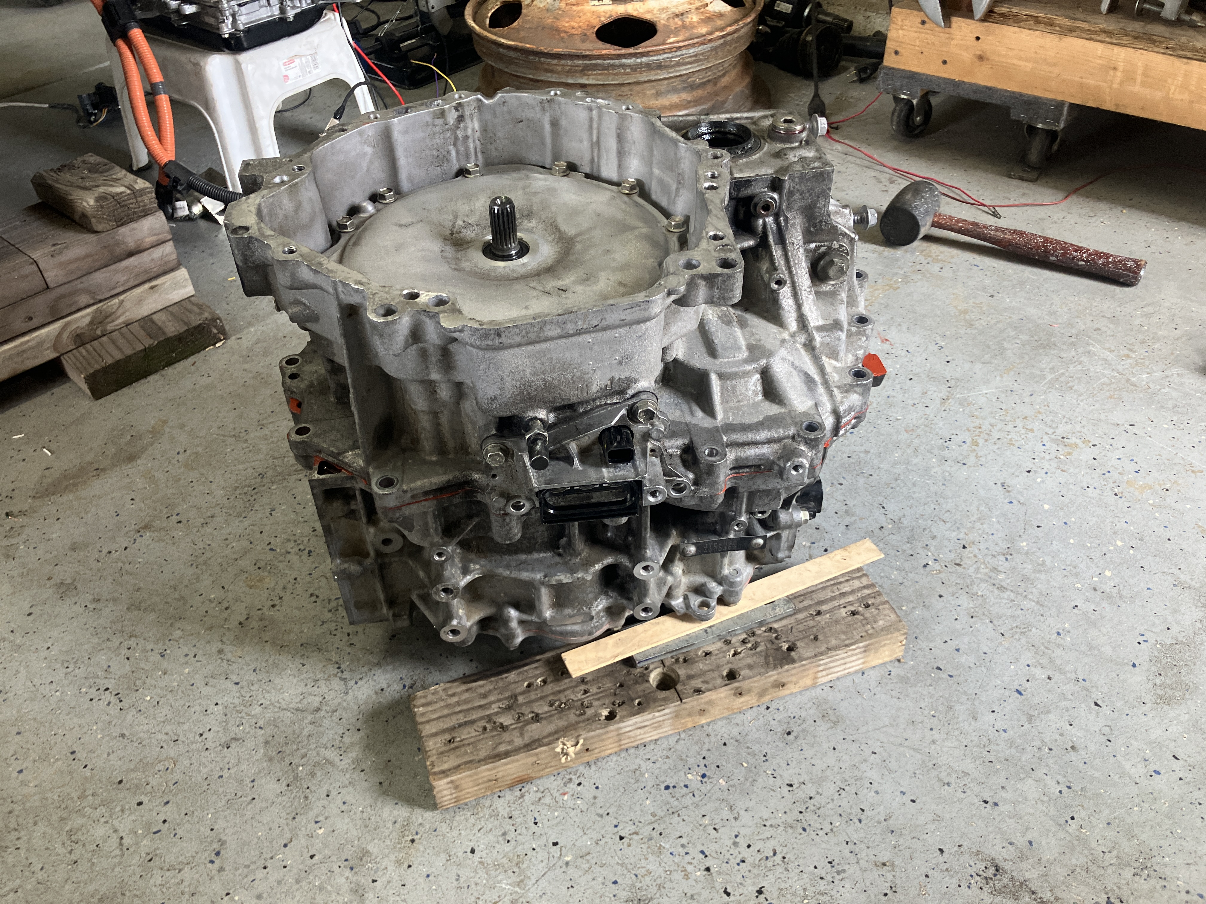

well it was one of them days

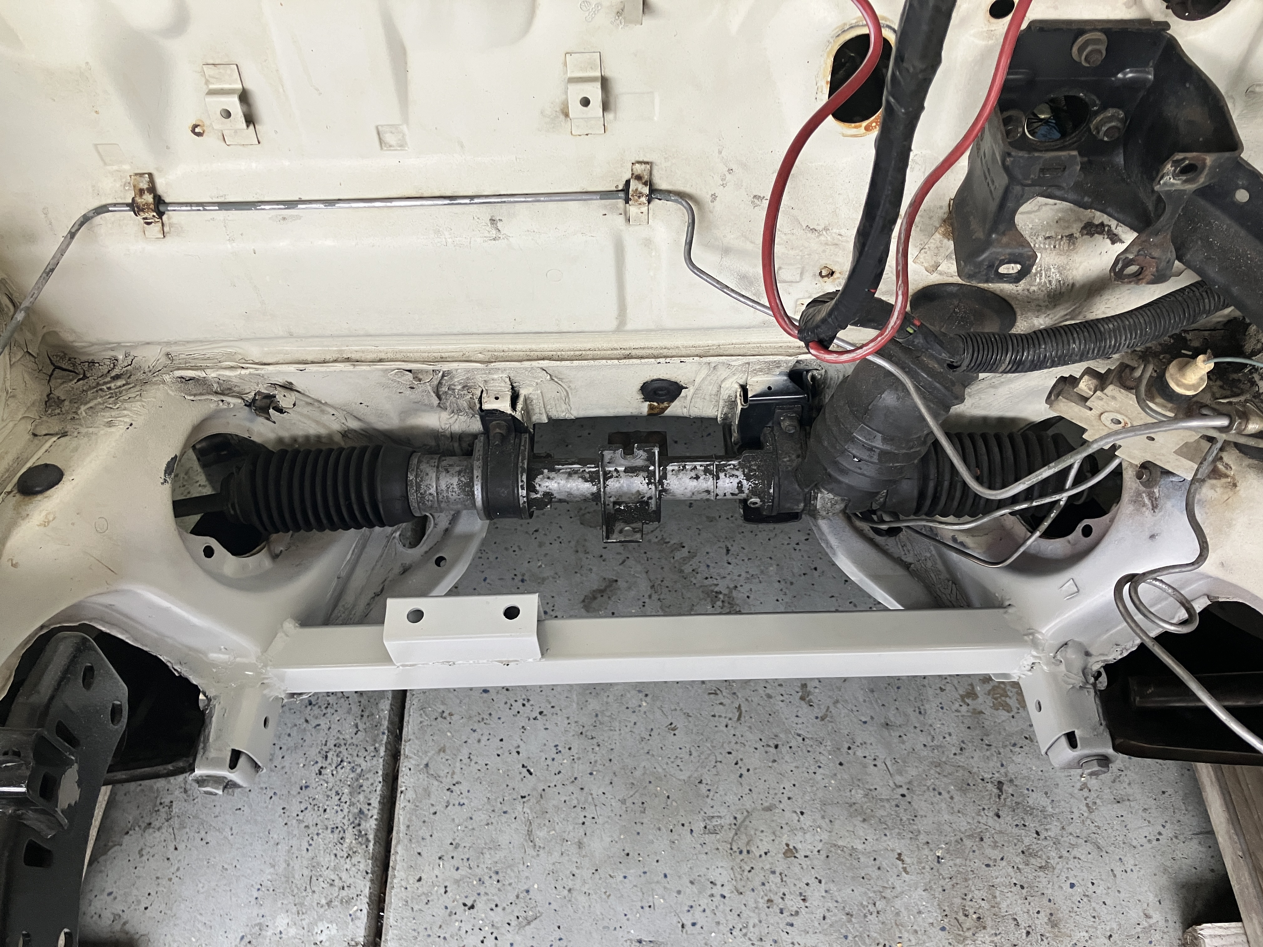

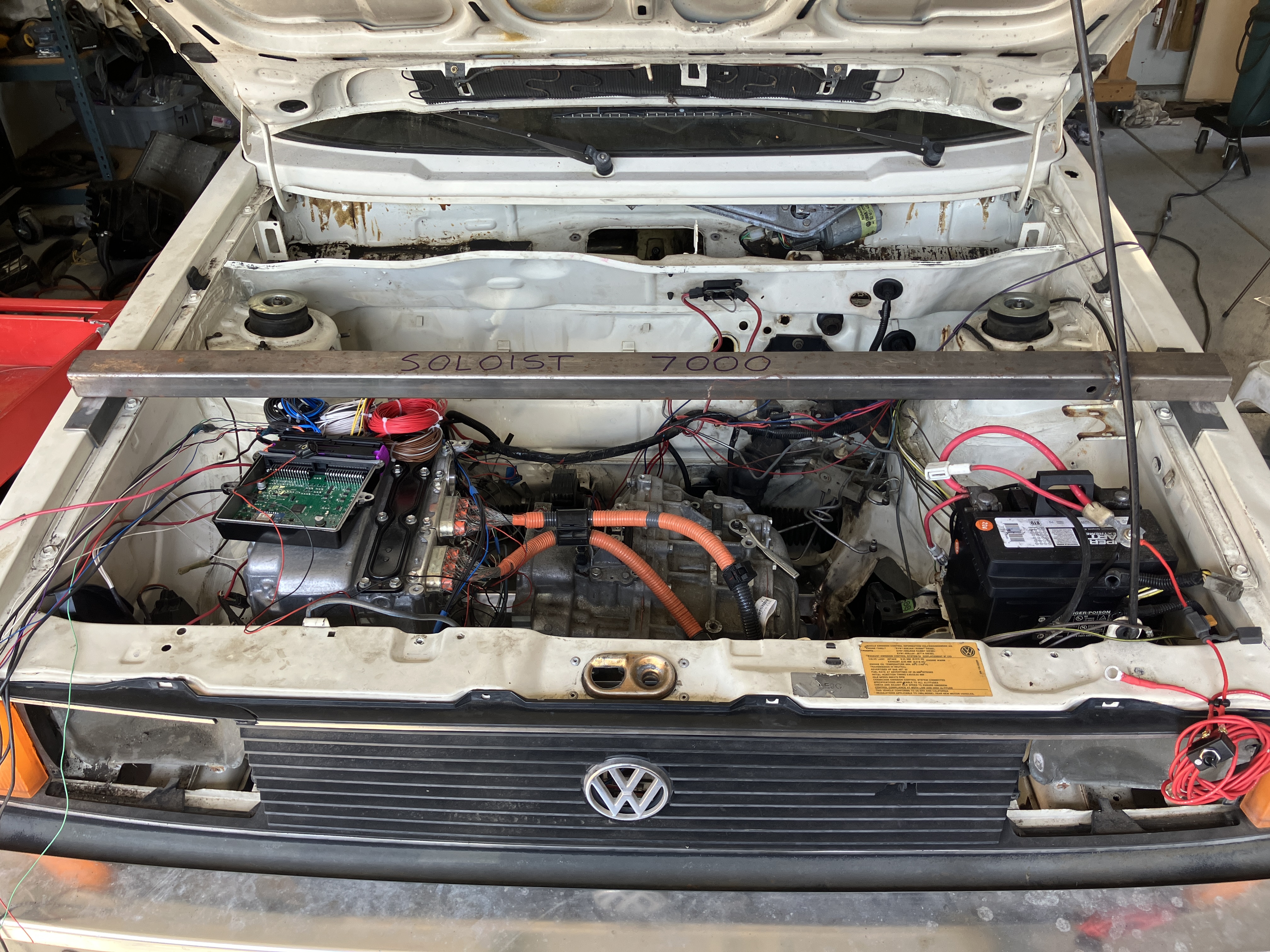

I decided to drop the transaxle, so naturally first I had to either grow a third arm, make some friends, or invent the Soloist 7000

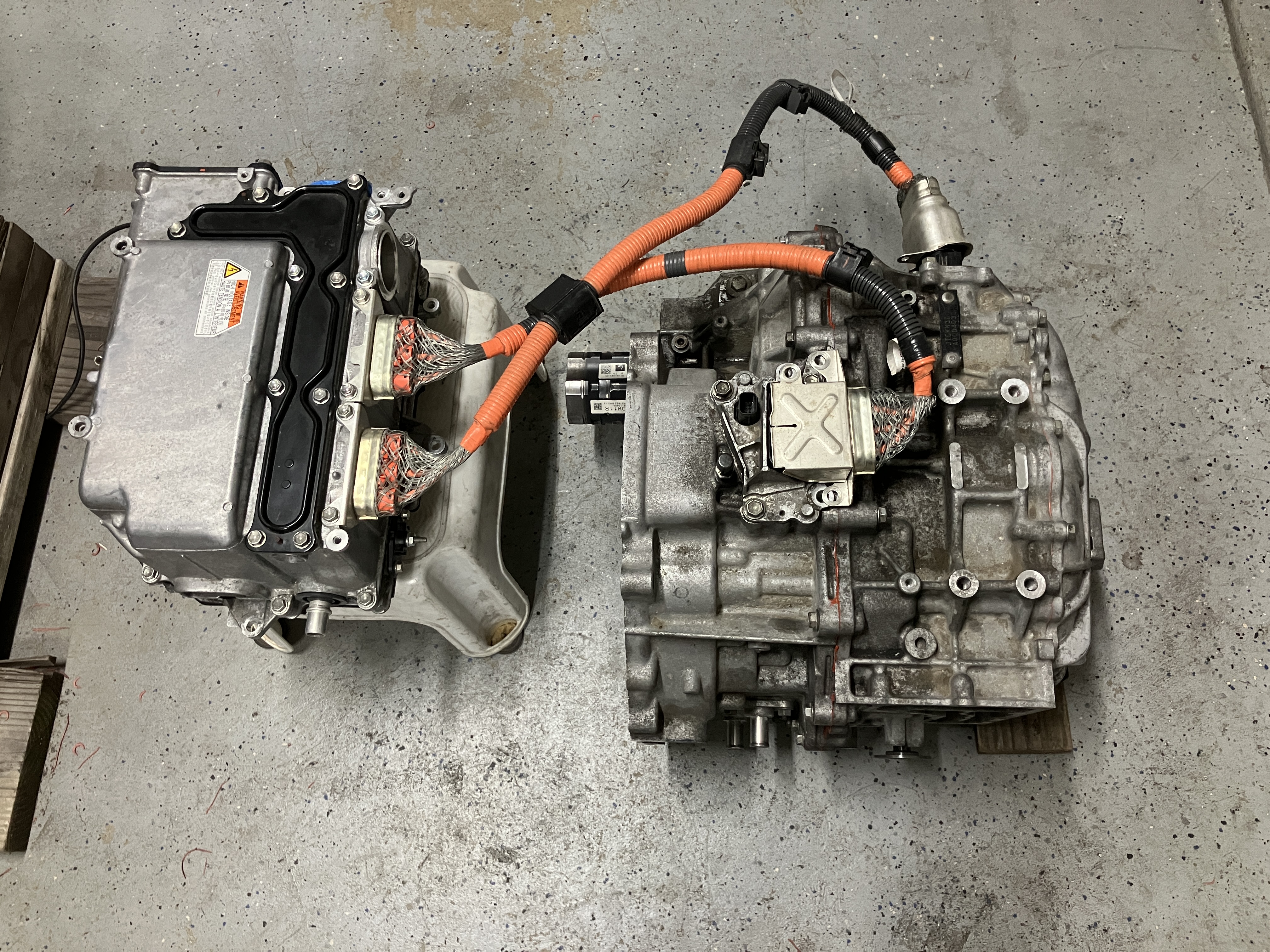

Happy to report the problem has been fixed, I will leave the technical explanation to the masters.
Toyota Prius Open Transaxle Motor Action

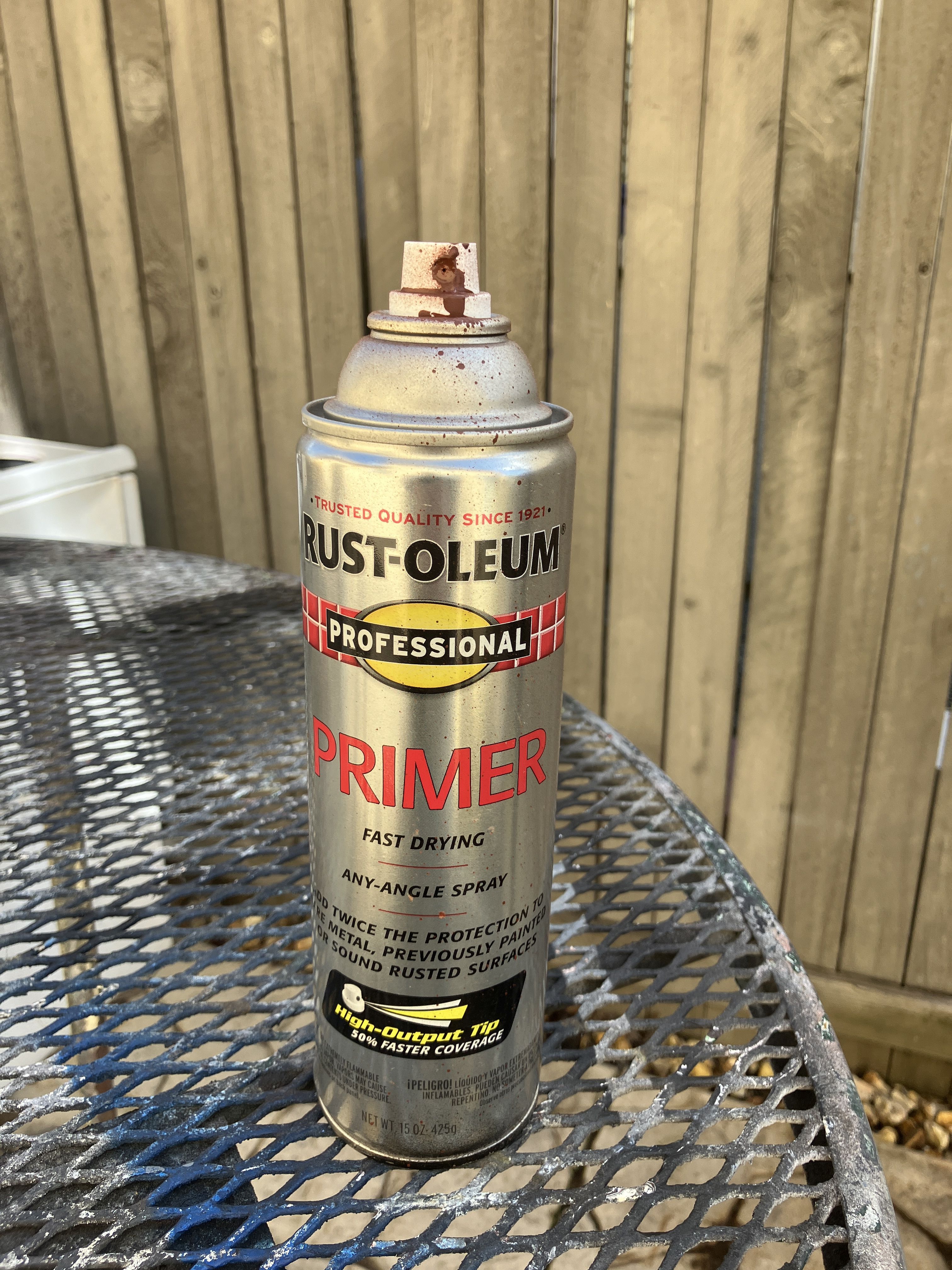

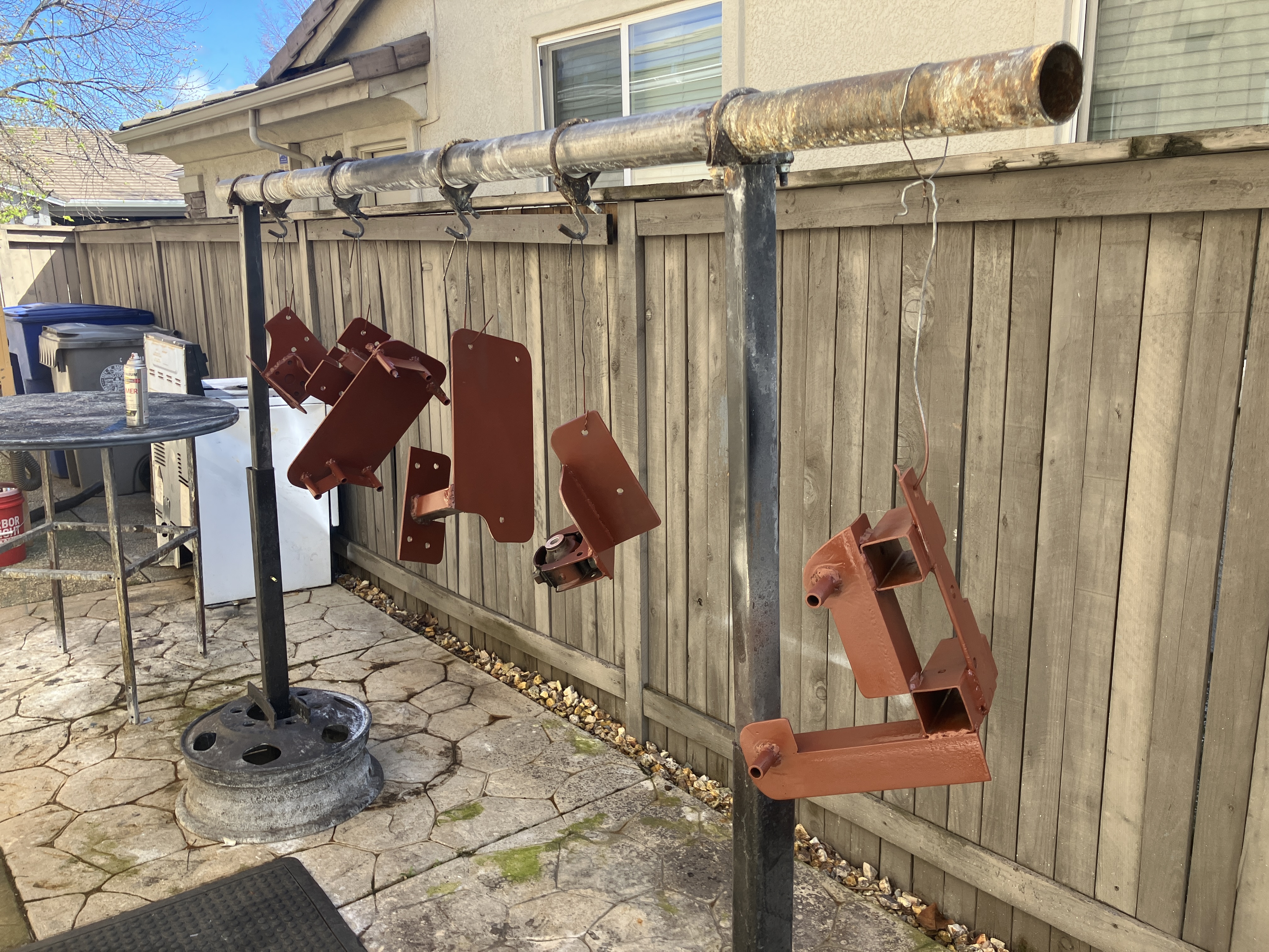

Post by Gregski »

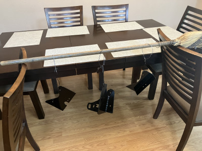

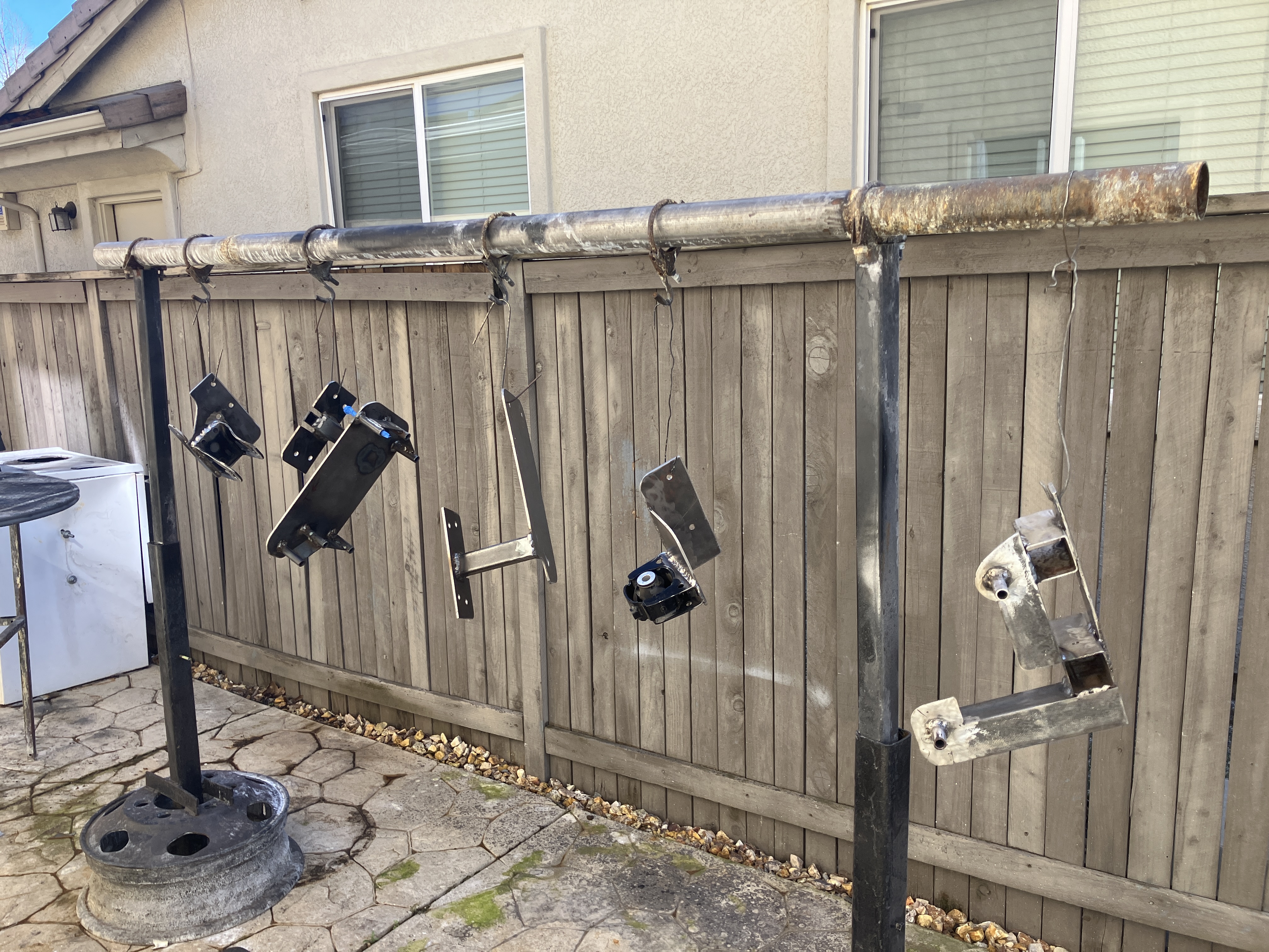

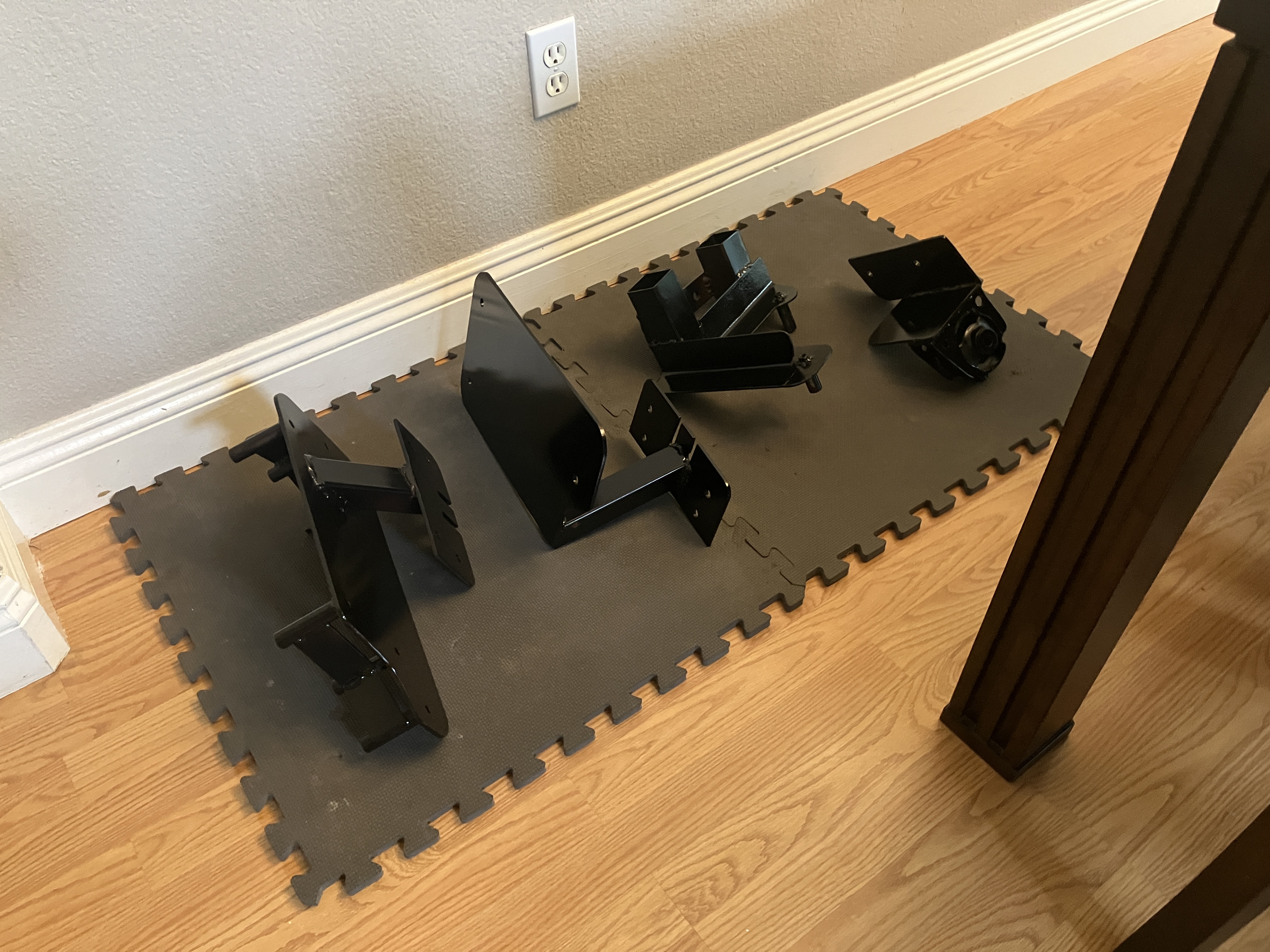

with the transaxle out I thought it was as good a time as any to make some things black (after making them red)
I luv this primer
I wanted to hang these up to cure in the garage, but the wife insisted I move them into the formal dining room, while she's on Girls Weekend Out !

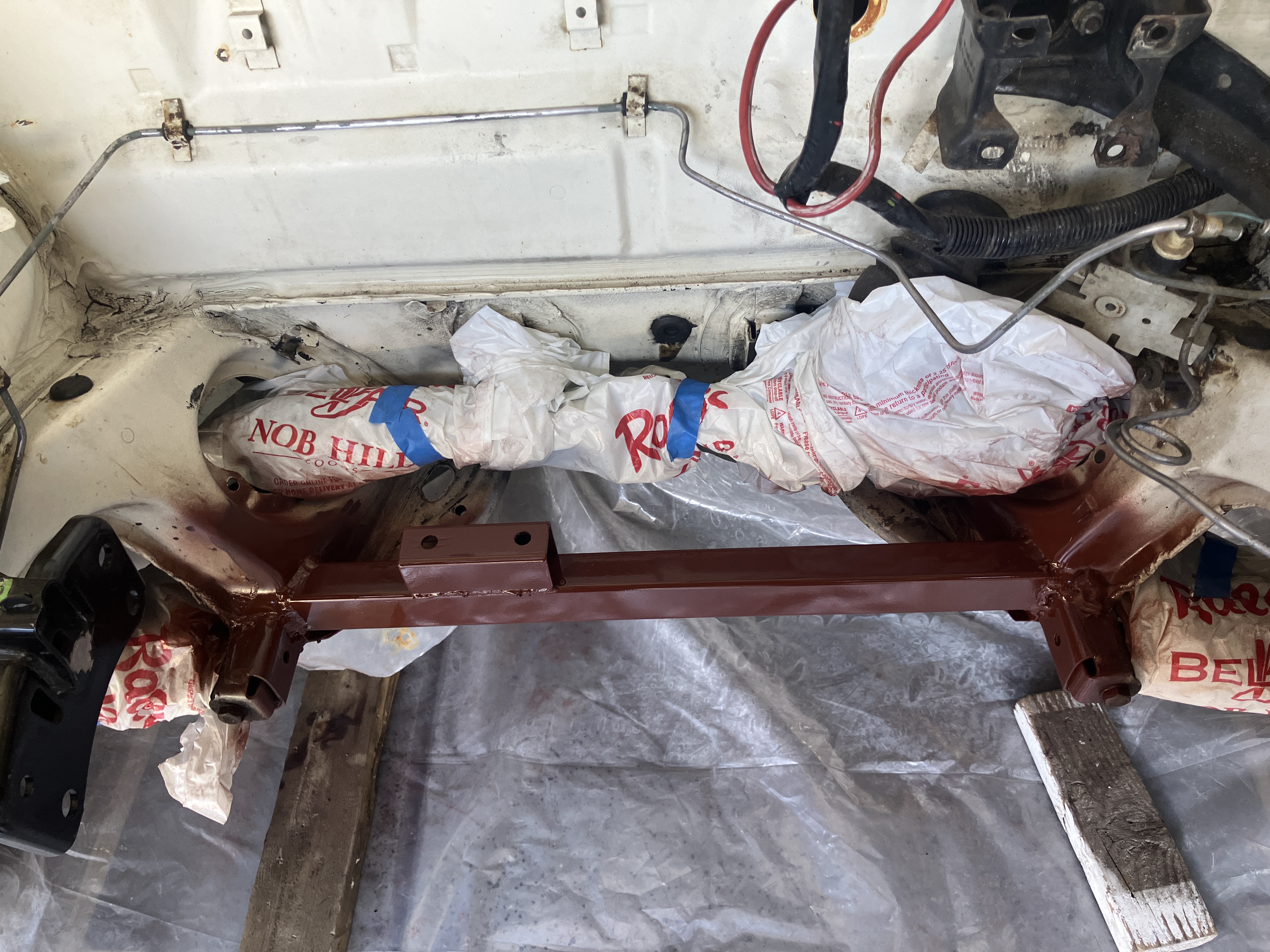

Post by Gregski »

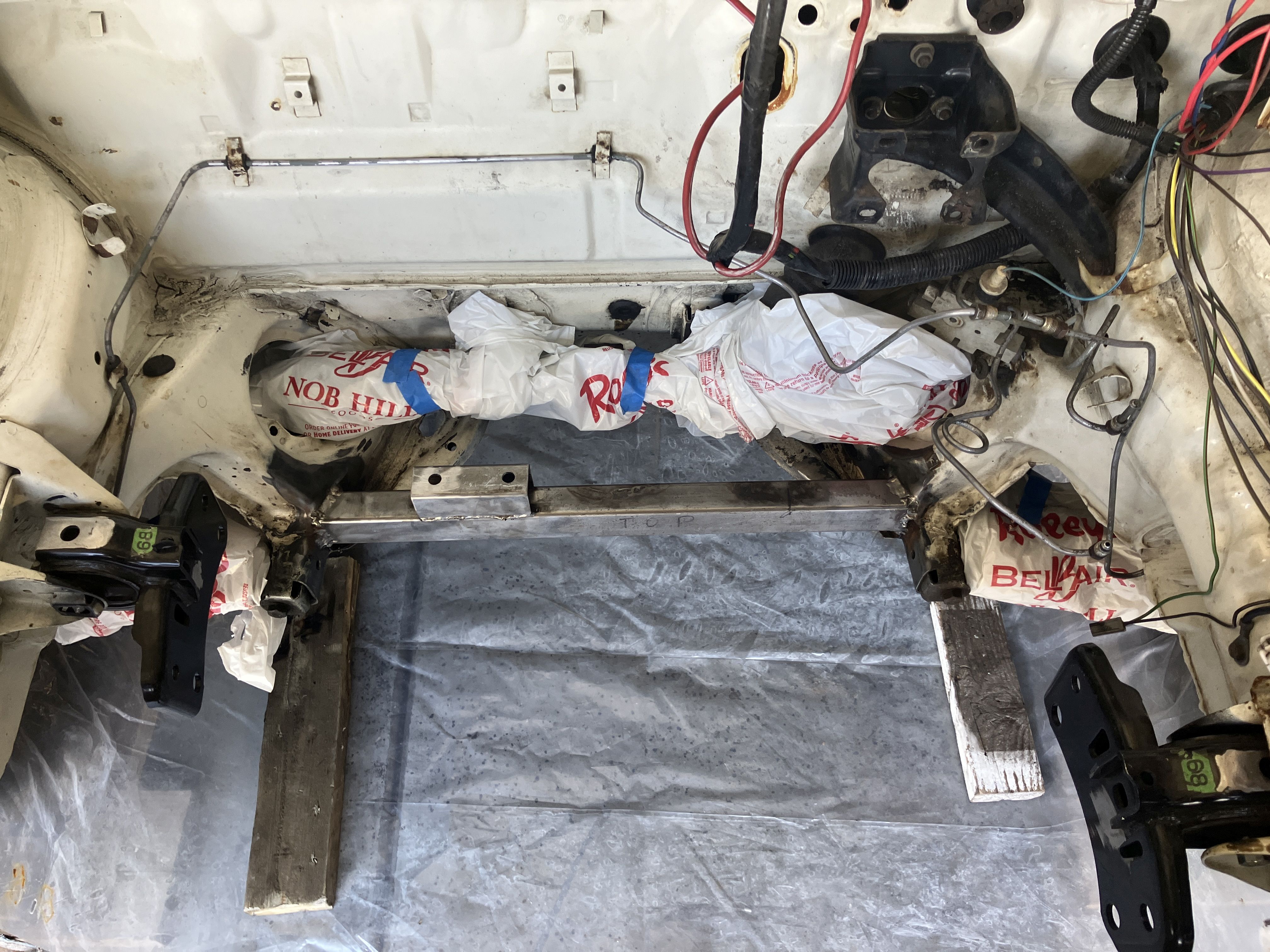

I also managed to get the Paint Booth inside the Rabbit
nailed the color match

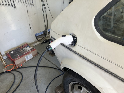

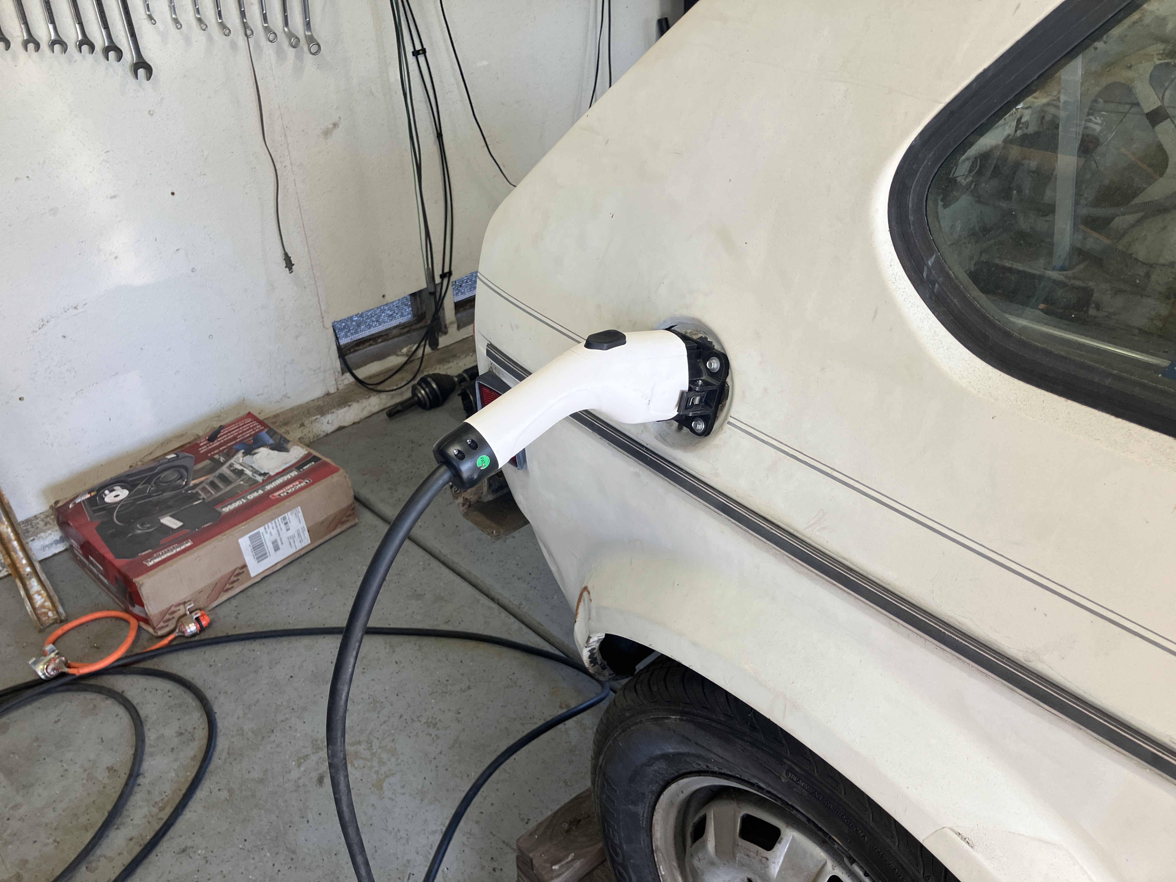

VW Rabbit DIY EV Charge Port
some day I'll own a car with a fuel filler door

Gregski wrote: Fri Mar 29, 2024 11:28 pmVW Rabbit DIY EV Charge Port
"Gentlemen, let me tell you a story. A story about a path of least resistance."
*proceeds to not tell a story at all*
Damnit Greg, that was a parable, not a story, and the parable was the non-telling of the story, by the story itself being so much the path of least resistance that you didn't even bother to tell the story at all! You just gave it a title and left it to drift in the river, like Jochebed to her baby Moses. And what are we your audience supposed to be? The naked Egyptian princess bathing in the river, to take your story right into the Pharaoh's household?
Well I never.

Charge port install in 3:50 single take - in sport climbing we'd call it onsight :)

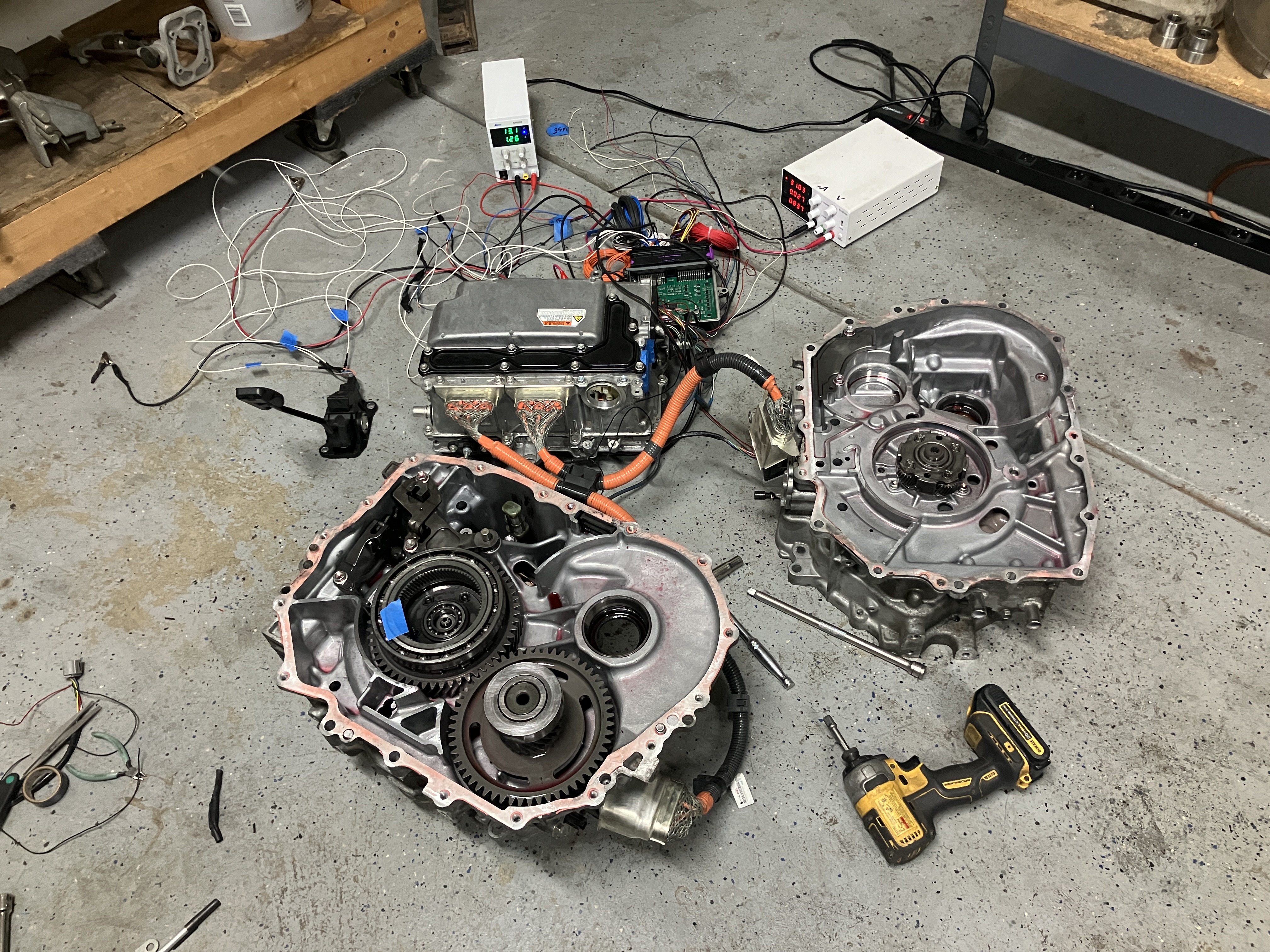

Post by Gregski »

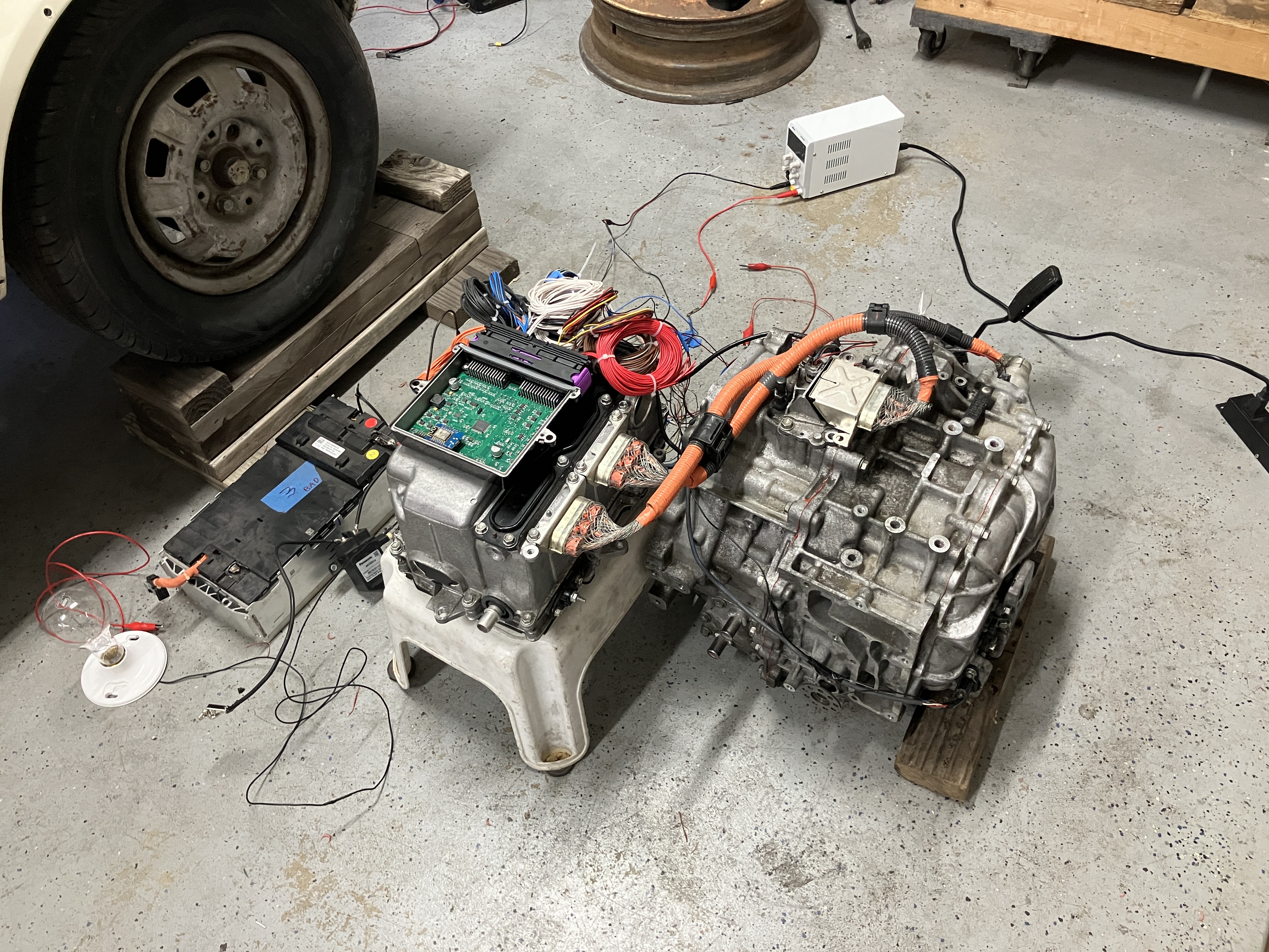

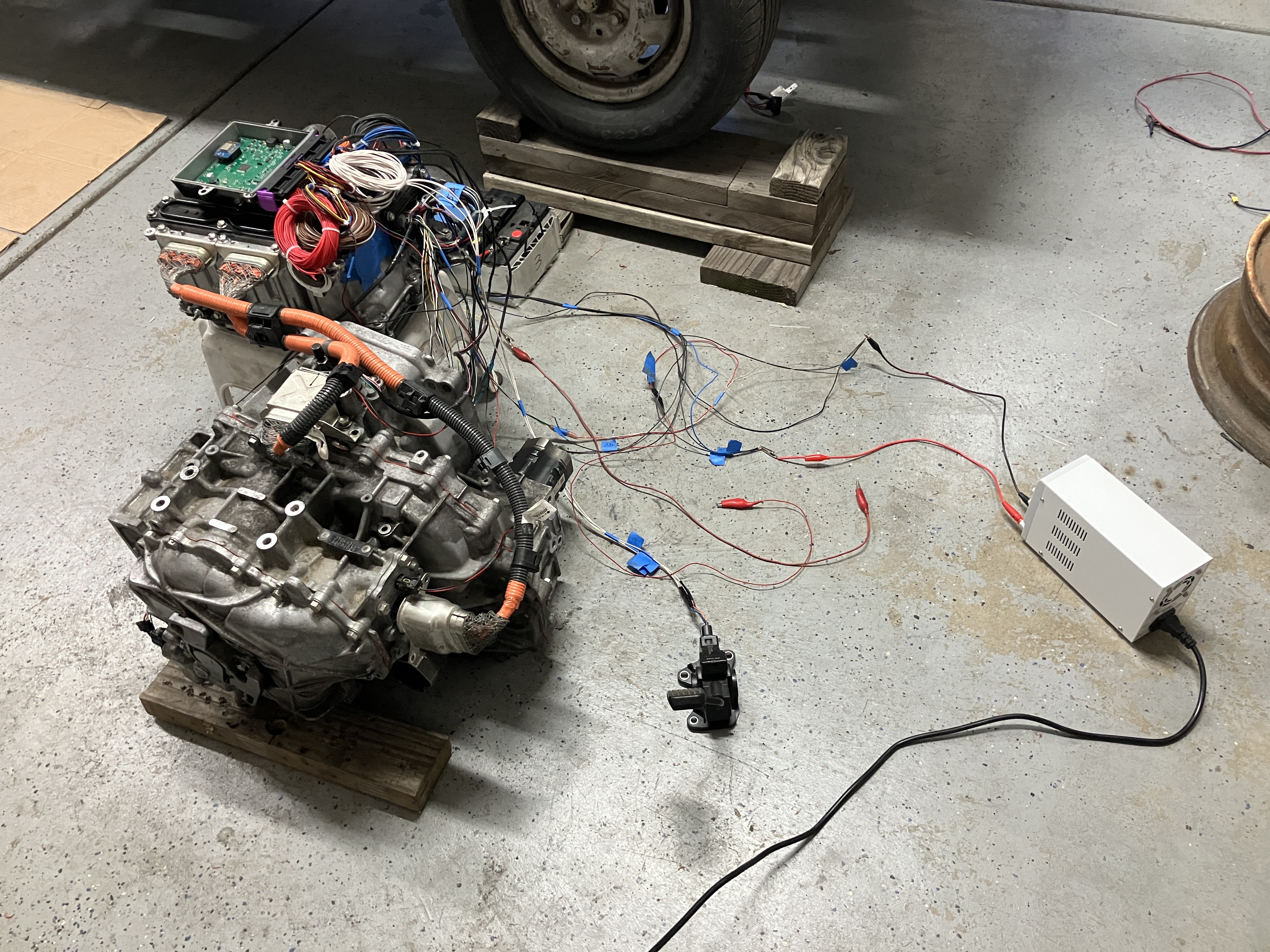

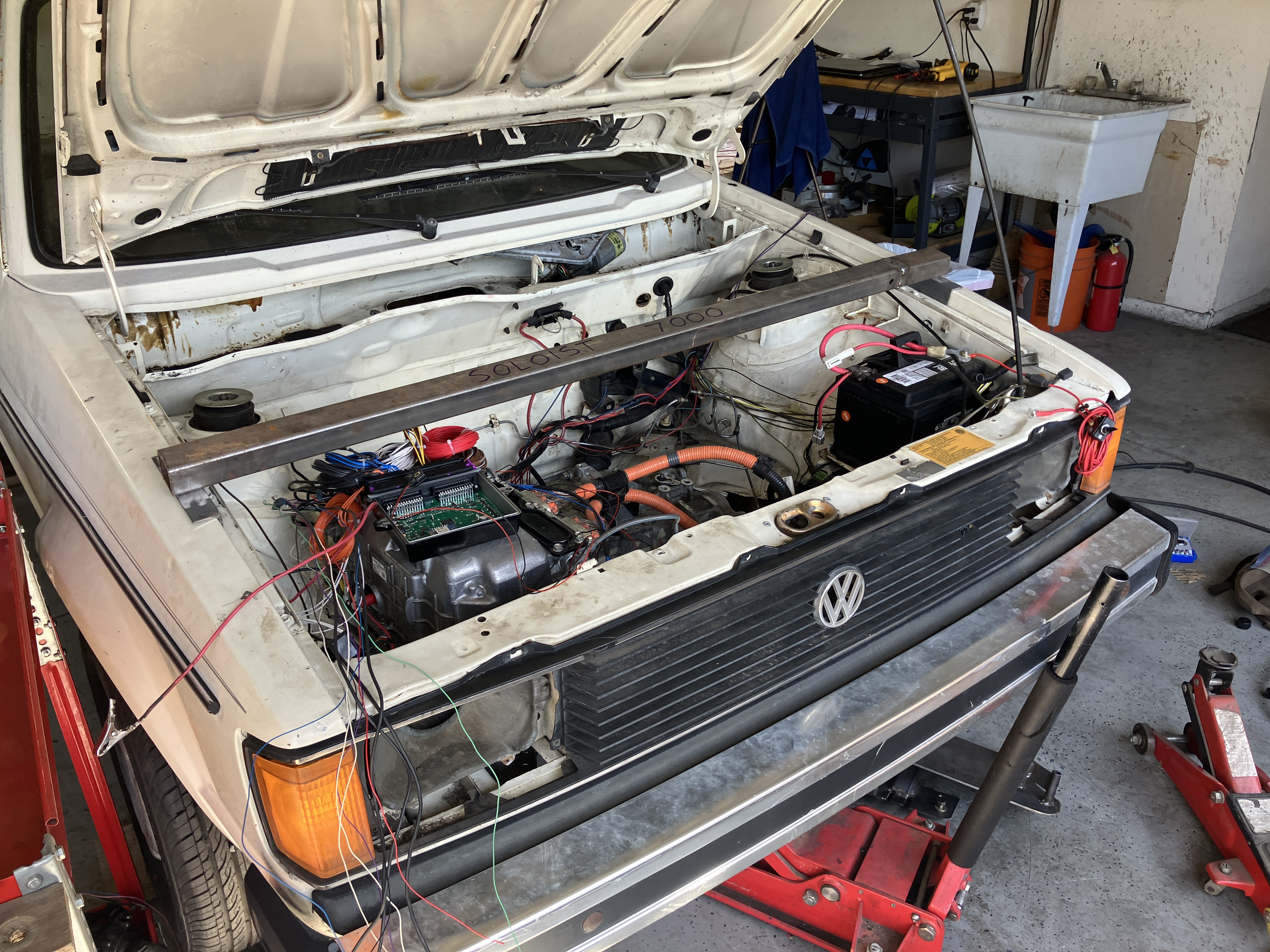

First motor spin... [again]
always, sometimes, bench test first
the battery module is from a 2018 BMW 530e (same as the 330e)
throttle pedal is from a 2010 Honda Fit (cause I thought maybe the Prius one was whack, but turns out it is fine)

Post by rstevens81 »
There is a mod in the works (not by me Damian and others) that's going to fix the issues, so rather than potentially adding a bug and have an accident and the bad publicity that might be causes it would be prudent to wait for the fix.
Gregski
Posts: 3171
Post by Gregski »
Woodfie wrote: Mon Apr 01, 2024 7:34 am Great work here, have just stumbled across your build..
For this spin up, think was a mention somewhere of changes made by forum folks.
Wondering if still using 2.05a code, or a mod to it?
Yes I am still using 2.05A with a change to a parameter called tmpmmax = 300
I posted this specific issue under the OEM Specific Topics where some of the developers have chimed in
Gen 3 Prius Transaxle P410 Makes Clunky Noise
