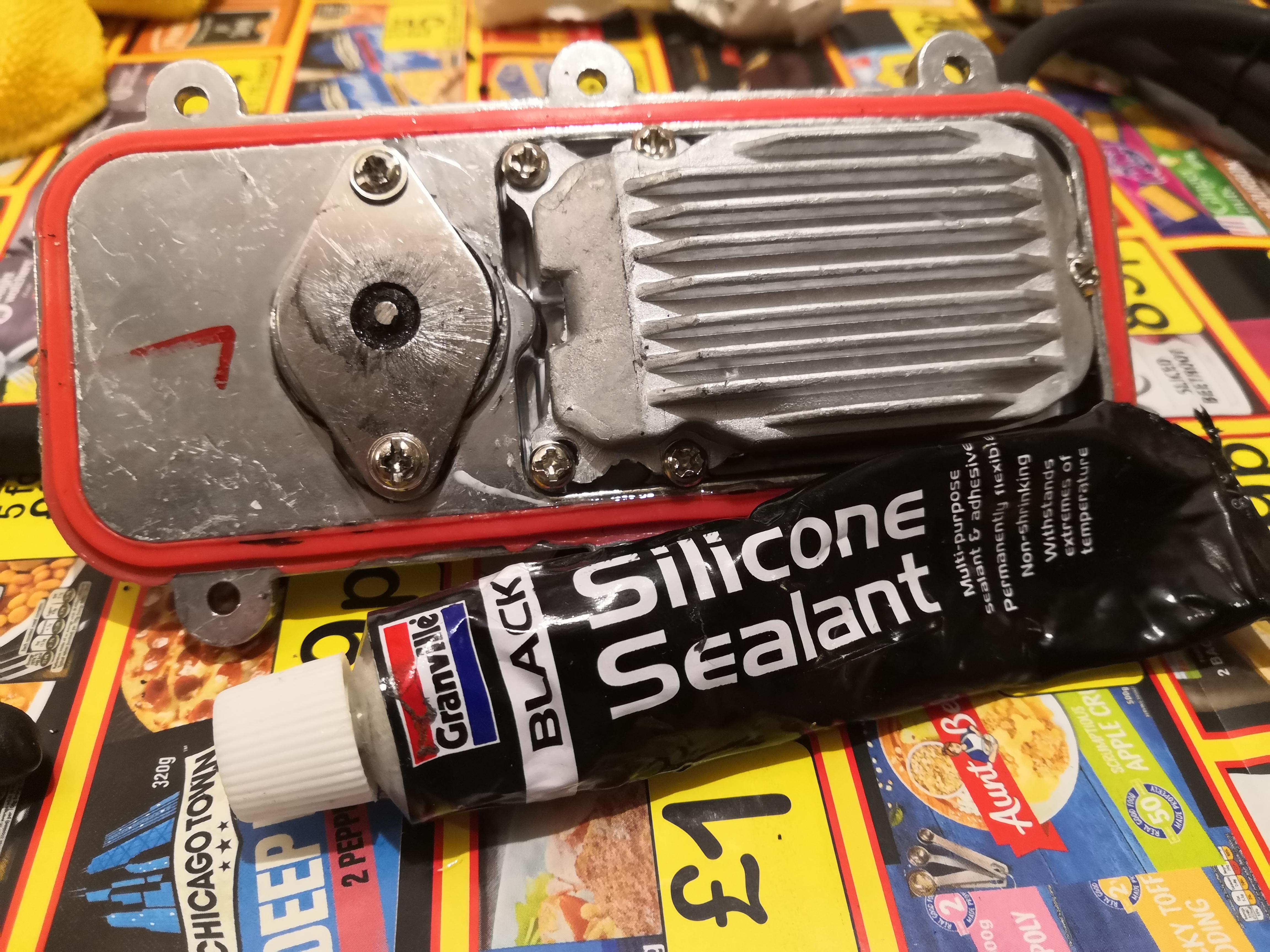

I have bought one of these and modified it to remove the pump - see photo. Planning to use it in a closed loop for my heater with an external DC pump and thermostat.
Not got further than modifying it though.
[Note, I didn't just cut the impeller off. I've also disconnected and removed the motor from the other side but couldn't find that photo.]

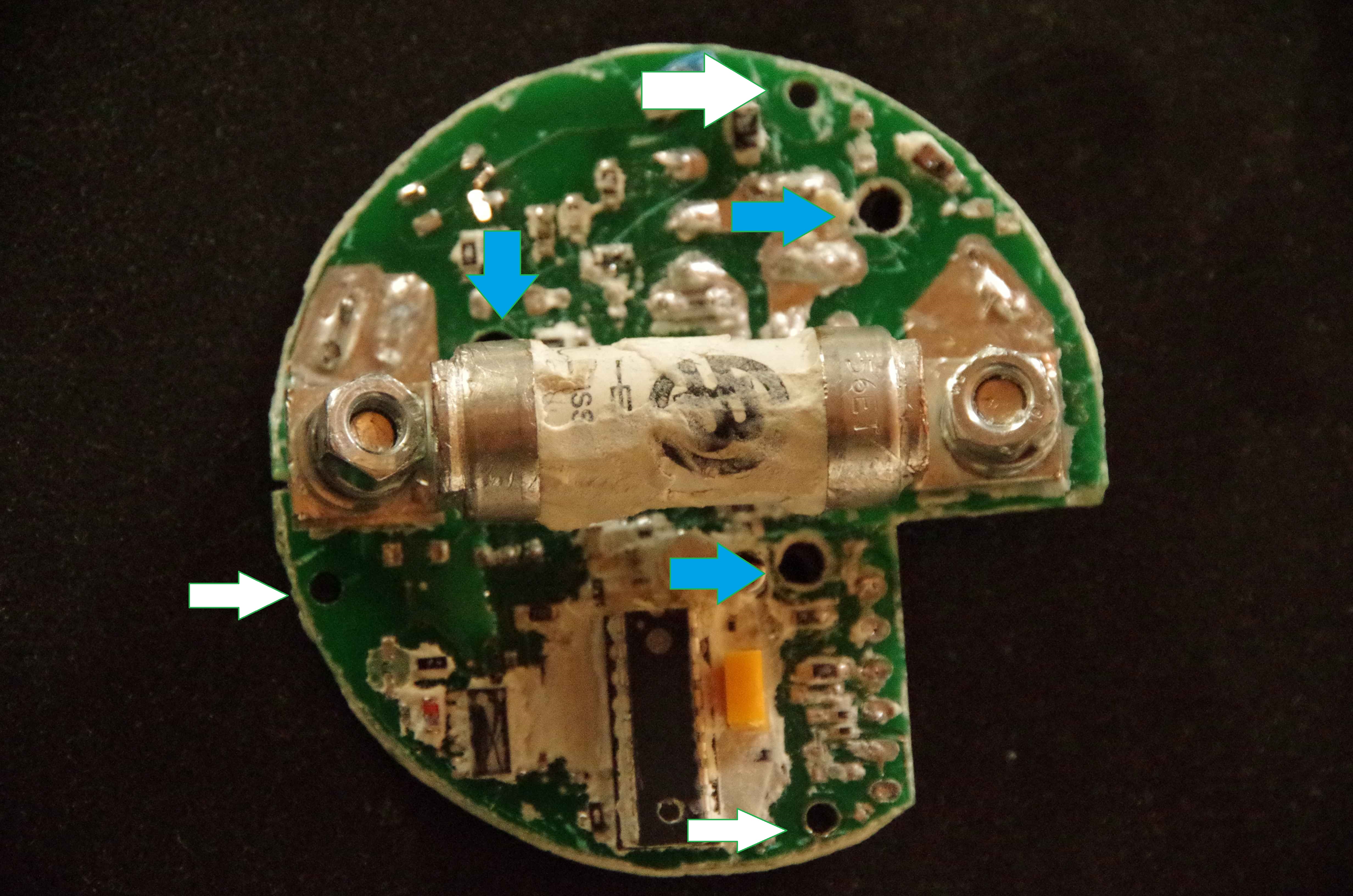

I've repaired the RM3 heater in my Think, removing the potting compound is no fun.
The original PWM control with a PIC is designed in such a way that the 55A fuse triggers when it is permanently on, as well as for safety in the event of excess temperature due to a short circuit in the heating to kill the fuse.
I continued to use the original temperature sensor (LM335) and switched the heating coil in series instead of original parallel. These are accessible from the top. An IGBT (IRG4PC50) with opto driver(HPCLJ312) as a switch, supplied via a series resistor, elcap and Z-diode. HV fuse with 16A. Temperature control with an OPV as a comparator and supply via 12V (heater on).
I also used the overtemperature protection again, but the switch is only accessible after removing the potting compound.
To my regret, i have not created a complete circuit diagram.

Martin1775 wrote: Thu Oct 29, 2020 8:52 pm I've repaired the RM3 heater in my Think, removing the potting compound is no fun.
What did you use to remove the potting ? Mechanical or chemical ?
I tried it with one heater on the mill trying to mill out the whole potting/pcb area but the 'stone' type big fuse was not very forgiveable to my metal milling cutter.... :-(

I used a knife to remove the compound. The first thing I did was uncover and removing the connectors, then the fastening screws.
There are three screws PH1 that hold the board (white arrows), three that fix the IGBT's under the board (blue arrows) and two screws for the thermal switch.
After exposing and removing the screws, I peeled off the compount around the circuit board and pulled it out with a lever. It is possible that the thermal switch and screws can only removed after removing the PCB. You get easier access when removing the fuse first, but in my case a screw turned with the nut so it was not possible.
There are some infos and solutions at https://www.fingers-welt.de/phpBB/viewt ... 14&t=11820 but i have implemented a less complex solution.

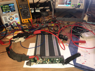

Got the heater yesterday. It can simply be opened by removing 4 bolts. I cut the wire to the AC motor and put it back together. The heating element looks like a square mushroom surrounded by water, maybe like 5x8cm
Posts: 6768
Has thanked: 383 times
Been thanked: 1589 times
Re: Water Heater
Tested the heater today. I basically placed right before the input of the cabin heater. So it's inverter -> motor -> pump -> heater -> cabin -> inverter. To my dismay everything got warm except the cabin. It doesn't seem like the radiator extracts a whole lot of heat from the water even with the fan turned half way up. Is that normal?
So I think I will try the PTC route next. Apparently the Diesel version of Touran has a slot in PTC element (part number 5Q0963235A)
https://www.ebay.de/itm/Elektrischer-Zu ... 3449719000
Only problem there: my DC/DC converter only sports 750W so I either need a larger one or derate the heater. I think it has CAN control anyway.
EDIT: I could also create a loop just for the cabin heater. So one more reservoir, one more pump. How does that sound?

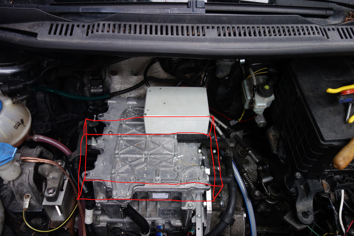

Posts: 6768
Re: Water Heater
Just went outside and measured, it is about as wide as the inverter and about as high as my white junction box, so it would fit nicely. Will see how far I get with the 750W or rather 500W (left over after lights, fan and misc). Then will let you know

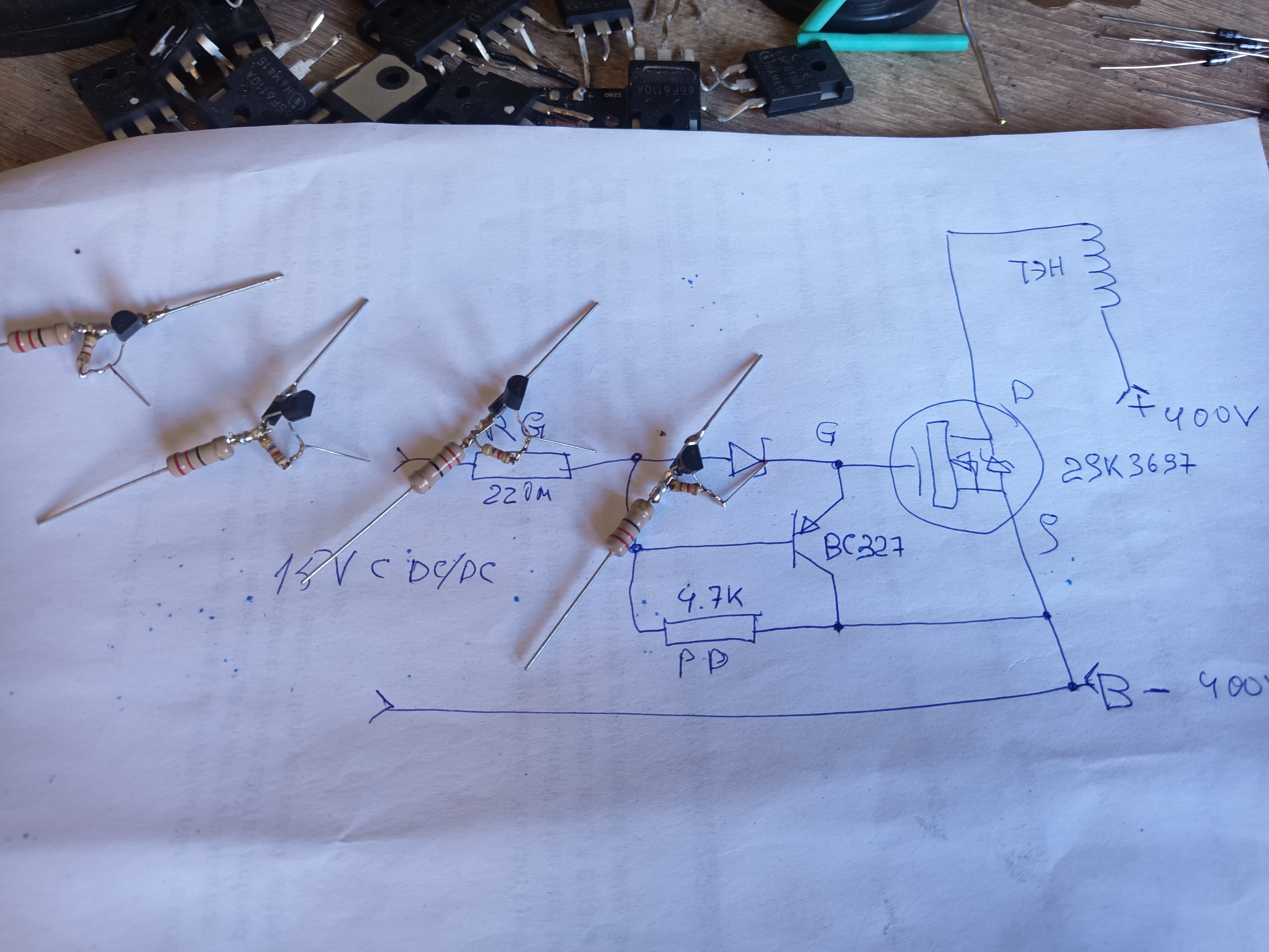

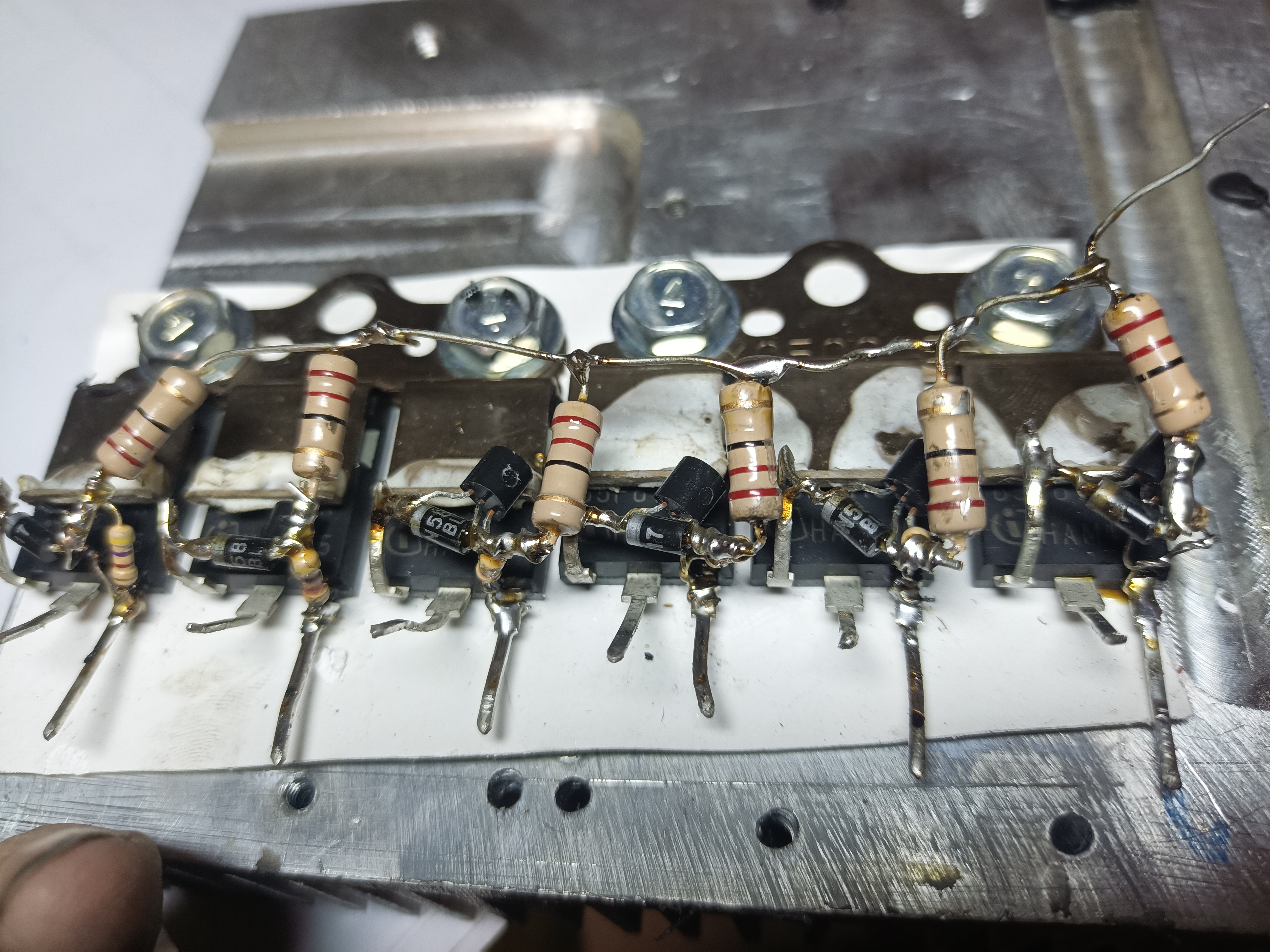

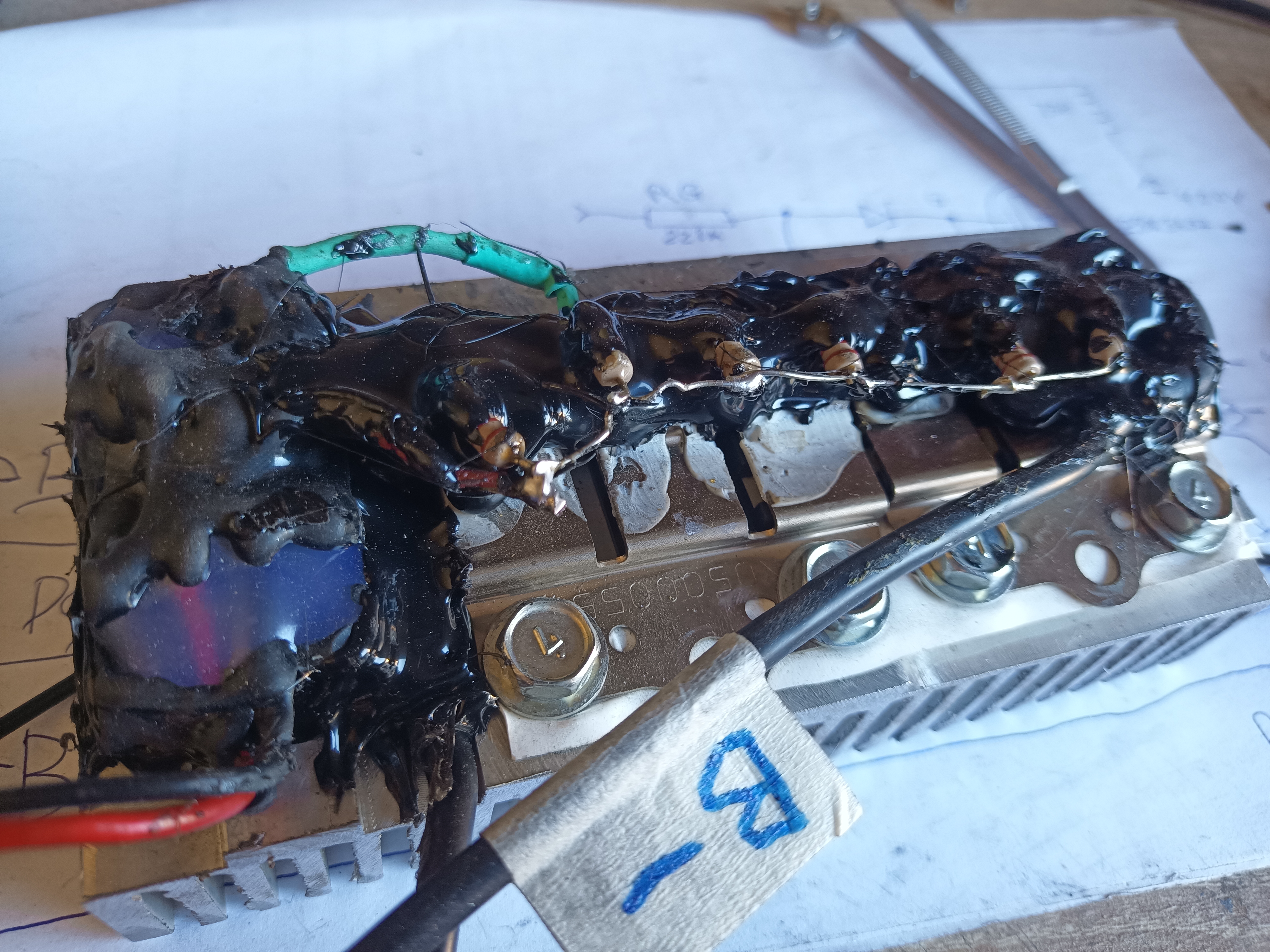

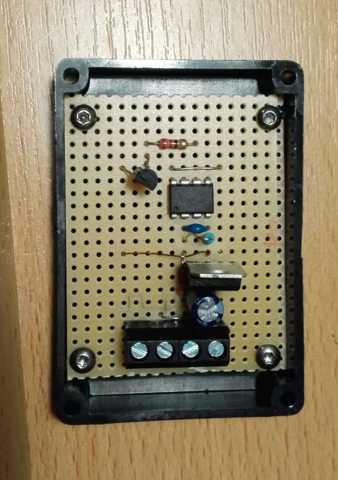

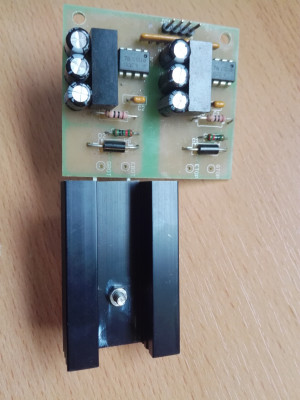

Argh! So Mr. Supersmart here had removed a climate control servo some months back because it was noisy. I thought it was just for A/C but in reality it controlled air flow via heater matrix or not! By default it is set to NOT flow via the matrix. So put servo back in and now I get warm air from the vents. So will give the water heater a second chance.
Will put a small PWM circuit in the white junction box and hook it up to a Schuko socket, so I can either plug the heater into that or the wall.
