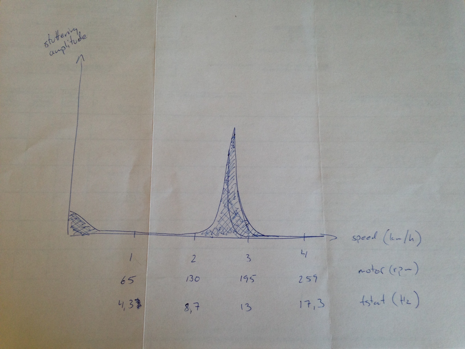

I'm experience low speed stuttering at 2-3km/h. I'm running SW 5.00 but experienced the same thing with SW 4.94.
It happens around 2-3km/h => 150rpm(130-195) motorspeed or 10Hz fstat.
At higher speeds it is very smooth. At lower speeds much smoother so there seem to be a short steep peak at close to 10Hz fstat which is very odd to me?

I tested with setting the brkrampstr to 50 and that helps in getting smoother stops but, to what I could note, no effect on acceleration.
A note as well, I get the same behavior in reverse as in forward. So not dependent on motor direction.
To be very clear, during a very slow acceleration,
0-2km/h there are some very small hesitations, barely noticable.
2-3km/h quite noticable shaking.
3->km/h smooth

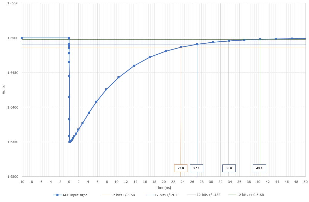

I found an interesting plot in that AN, voltage dip on a 1k/2nF filtered signal. Suggests the signal has fully recovered after 34 ns. We are running 9 MHz ADC clock, so that would be about 4 clock cycles. But I just programmed 1.5 clock cycles sampling time. Can check the influence of that. But even after 1.5 cycles the signal has recovered mostly. Back when I experimented with the resolver I couldn't see any influence of the sampling time.

Maybe I'm misunderstanding but 9MHz give a period time of 111ns and so 1,5 cycles for sampling would take 167ns.
Wouldn't this then result in the measurement is taken when the signal is fully recovered?
Been thanked: 1913 times
Re: FOC low speed stuttering
Oh, of course. Thats why it made no difference

I have now tested setting both curkifrqgain and fwkp to 0. I can't notice any difference between default value and 0. Tested a bit back and forth.
I'm attaching a graph of when I experience the stuttering.
The first just above 0km/h is barely noticable (no problem living with) and then a quite steep peak between 2-3km/h (anoying, specially during regen brakeing to full stop), above this nothing. More noticable with slight uphill load. The same thing applies doing regen, steep peak at 2-3km/h.
EDIT: Just beeing very specific with what I'm experiencing so that if others have similar or not at all similar behavior.

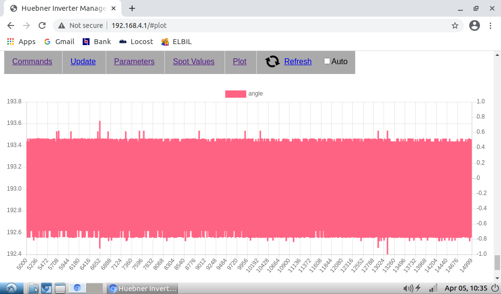

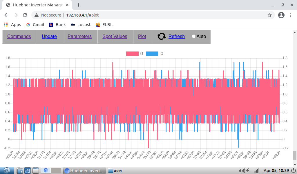

johu wrote: Sun Apr 04, 2021 4:30 pm Ok, too bad. I can post a screenshot of my angle and current plot to compare noise. It was like 3° jitter on angle and 7A on current.
Will try other filtering options next.
Is this what you are refering to with angle and current plots?
Both at standstill. No difference when in D, R or N. 10000 data points and burst length 1000.
Both currents are a bit offset but maybe within what you could expect?

Looks better than mine, will post later. And I don't have a bad stuttering problem, I really have to provoke it.
