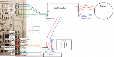

What are you doing with OUT3 exactly? Are you using it to power the inverter somehow?
Do you have a schematic showing how you've wired up the VCU, Inverter, Contactors, etc?

Here you go Kevin.
If you remember, I am using the Prius pack complete with precharge/main contactors and resistor. Gnd still goes to the 12v battery as it was during testing before moving to V1.5 of the firmware. The Pch and Main now go to OP 1 and 2 respectively.
I checked with James, and he also has his wired up his board pretty much similar and independently from mine, aside from him using Pin 1 instead of Pin 6 for his ground on the inverter vcu connector.
Edit: Previous image had CAN H and L flipped. Thanks JaniK for spotting;)

Thanks, I think I see the problem...
You are using OUT3 as if it's a switched 12V power supply for the inverter. However, OUT3 does *not* supply 12V it's a switched ground (see circuit below). My guess is you should power the inverter with 12V from your ignition switch and ignore OUT3.
Also note that unlike your drawing the inverter has three 12V pins according to this document;
http://productions.8dromeda.net/c55-lea ... tocol.html
You also have a similar issue with OUT1 and OUT2 driving your contactors. You should connect the contactors to 12V and the OUT1/OUT2 pins. The ground is switched by the NCV8401A devices;
https://www.onsemi.com/pub/Collateral/NCV8401-D.PDF
Let me know if this makes no sense
Edit: how are you controlling the negative contactor?

That's brilliant Kevin, thanks for that detail!
All makes sense. That was my thought that the OP pins might not be supplying 12v, especially as I drew the schematic out. Ignoring OP3 is something I tried earlier in fact as you suggested. I connected the switched Inv 12v to the IGN but obviously, nothing else happened. The next step so is to just get the contactors to 12v as well as OP1 and 2.
On the neg contactor, ignore my diagram
I left a bit out on the neg side.
Will switching the Inverter via the ignition and ignoring OP3 mean amending the code at all, removing it from the start sequence?

Appreciate the guidance here. Have a look at the latest rev and see if it makes sense. I think I have the inverter relay I added wrong. Should the gnd side I have in there actually be to 12v as do the contactors as the VCU controls switched ground?
Edit: CAN H and L flipped here in this image too, just so you know.

You are correct, the inverter power relay should be connected to the 12V not ground. One word of caution, I do not know whether this feature is used by Damien in the current software so this may not work.Cookie6000 wrote: ↑Thu Apr 30, 2020 11:44 am I think I have the inverter relay I added wrong. Should the gnd side I have in there actually be to 12v as do the contactors as the VCU controls switched ground?
We also need to check in the software whether the OP1 used to drive the precharge and negative contactors is active during operation or just precharge. Just try it and see what happens (I recommend you use a bulb or heater element current limiter for the HV when testing contactor operations).
In the future we need to add a kill switch and impact switch to your 12V circuit. We can address that once your system is working

Brilliant!
Success
All connected up as in the schematic except I have the inverter switched 12v powered via the ign instead of OP3 and relay. Flick the switch, double click of Precharge and Neg contactors. Approx 1-2 seconds later, main contactor closes. Press pedal, and away the motor spins.
The question you had about OP1 and negative contactor during operation looks to stay closed. It does raise the question of the precharge contactor though and if it releases again or remains closed or does it matter.
Not receiving any Pack Voltage, Current or Power, just RPM and the motor and inverter temps but that should all be sorted hopefully when I get the ISA shunt in. But that's for another day
