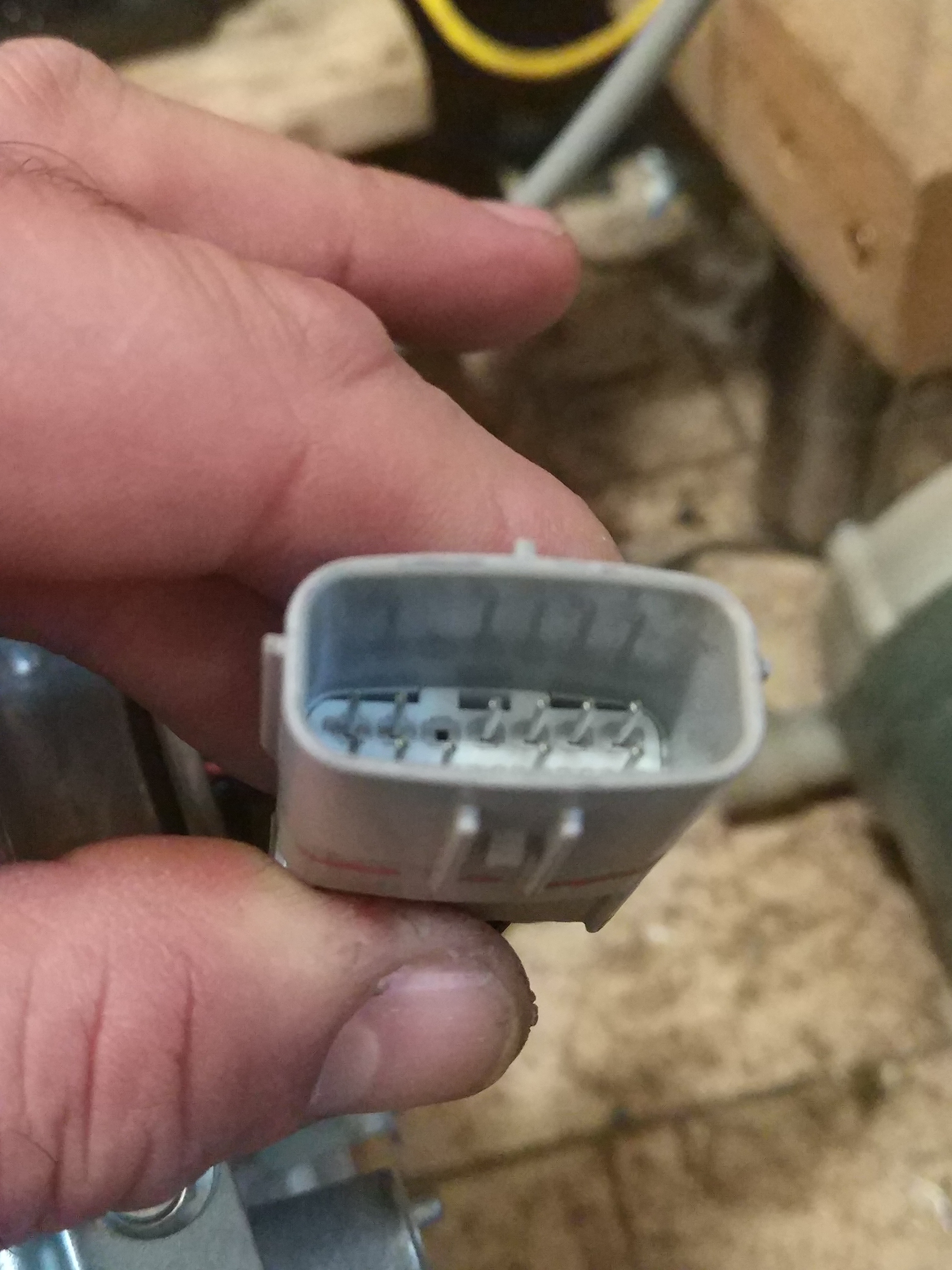

I found 13 pin connector Sumimoto 6189-1092 right in the UK.
https://www.ebay.co.uk/itm/Sumitomo-618 ... SwoaNeIKtf

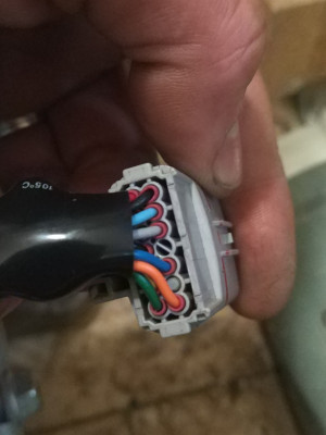

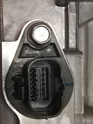

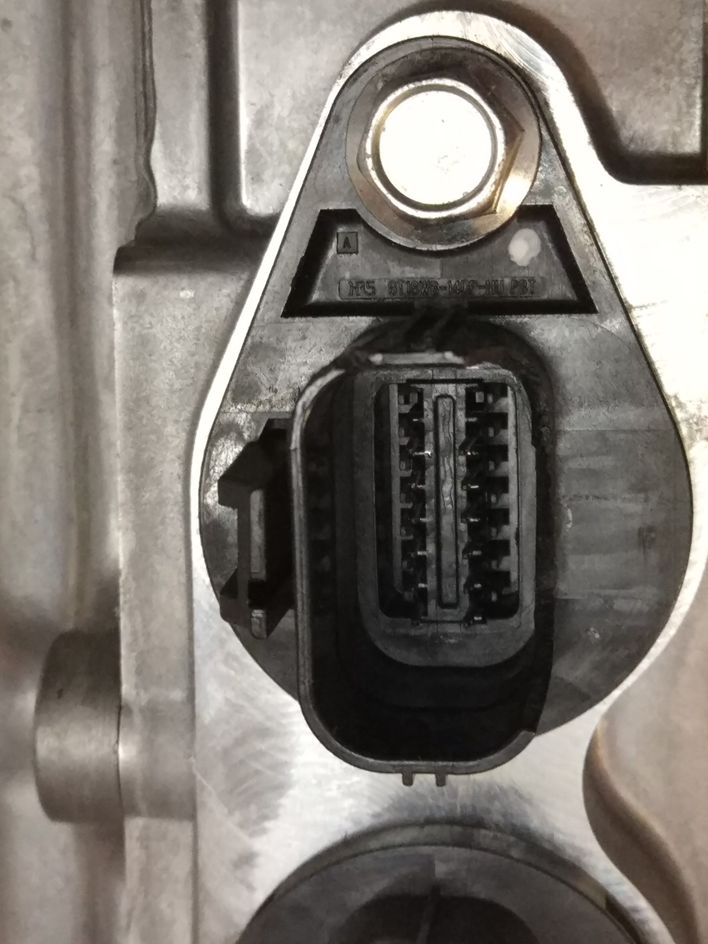

Does anyone know which P/N connector for LV signals does rear inverter use? I have the motor resolver connector - RH side one. But i dont have the LH one. Wiring says D-211. Does anyone have parts catalog?
Here are some pics...

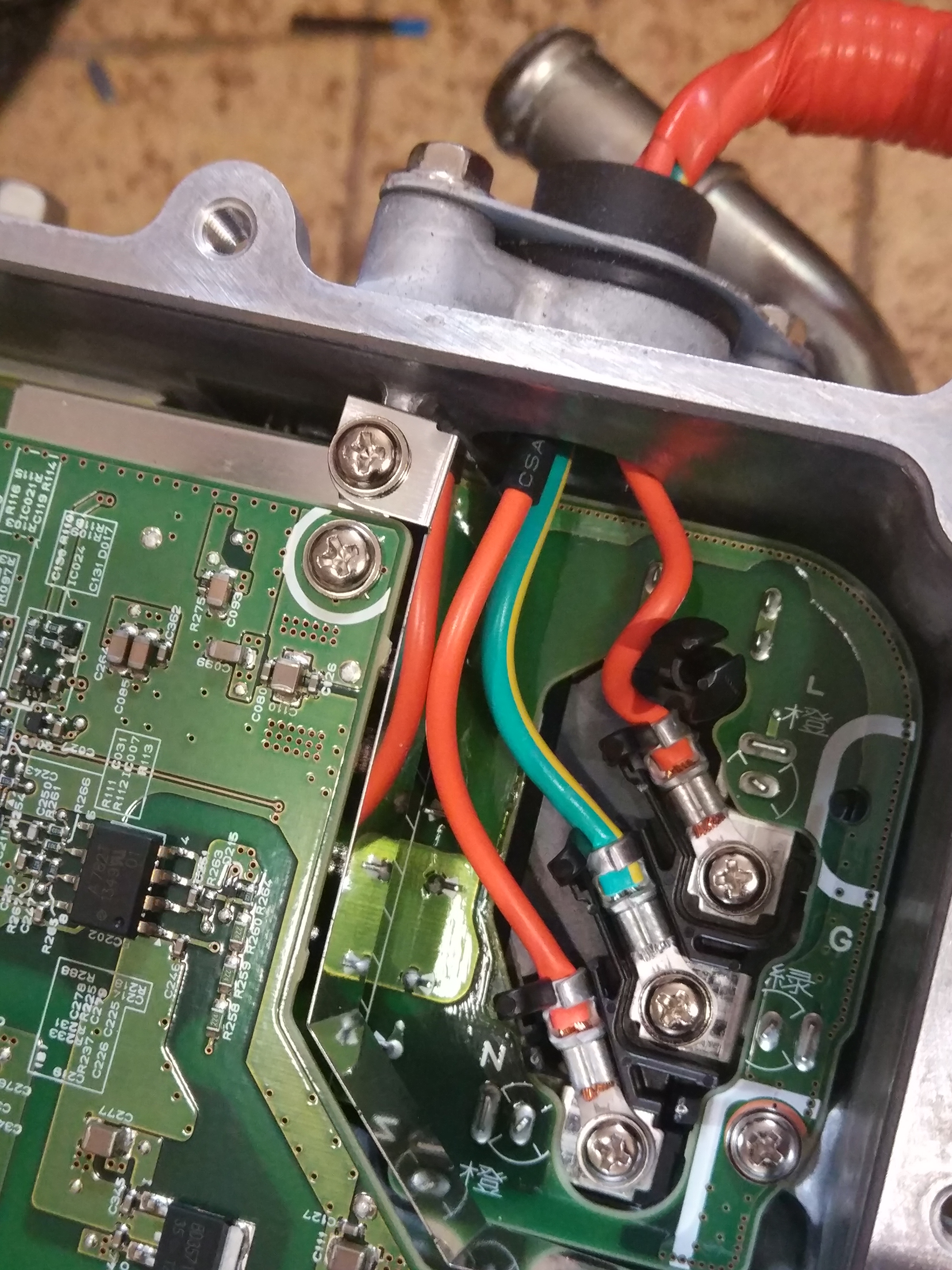

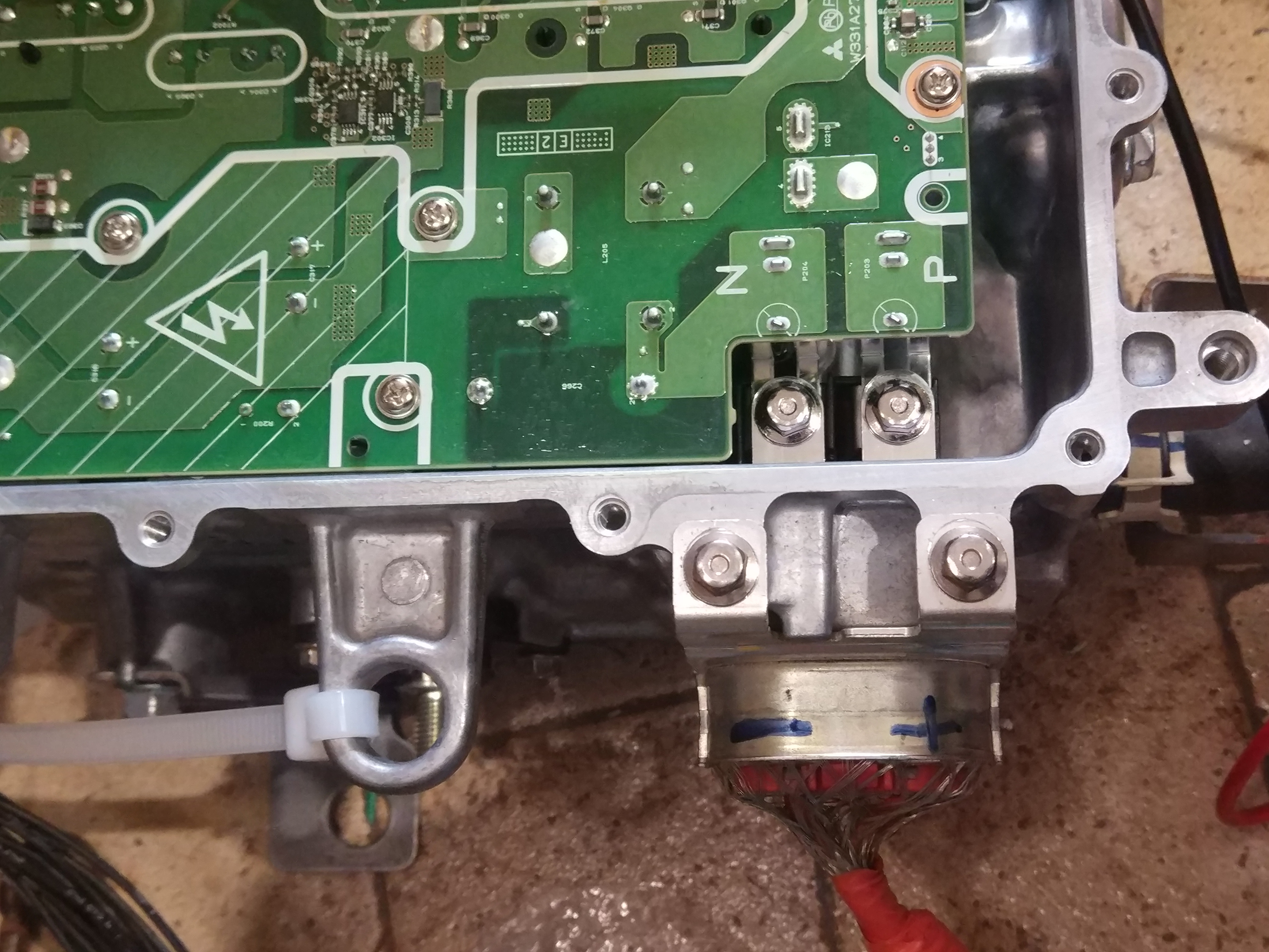

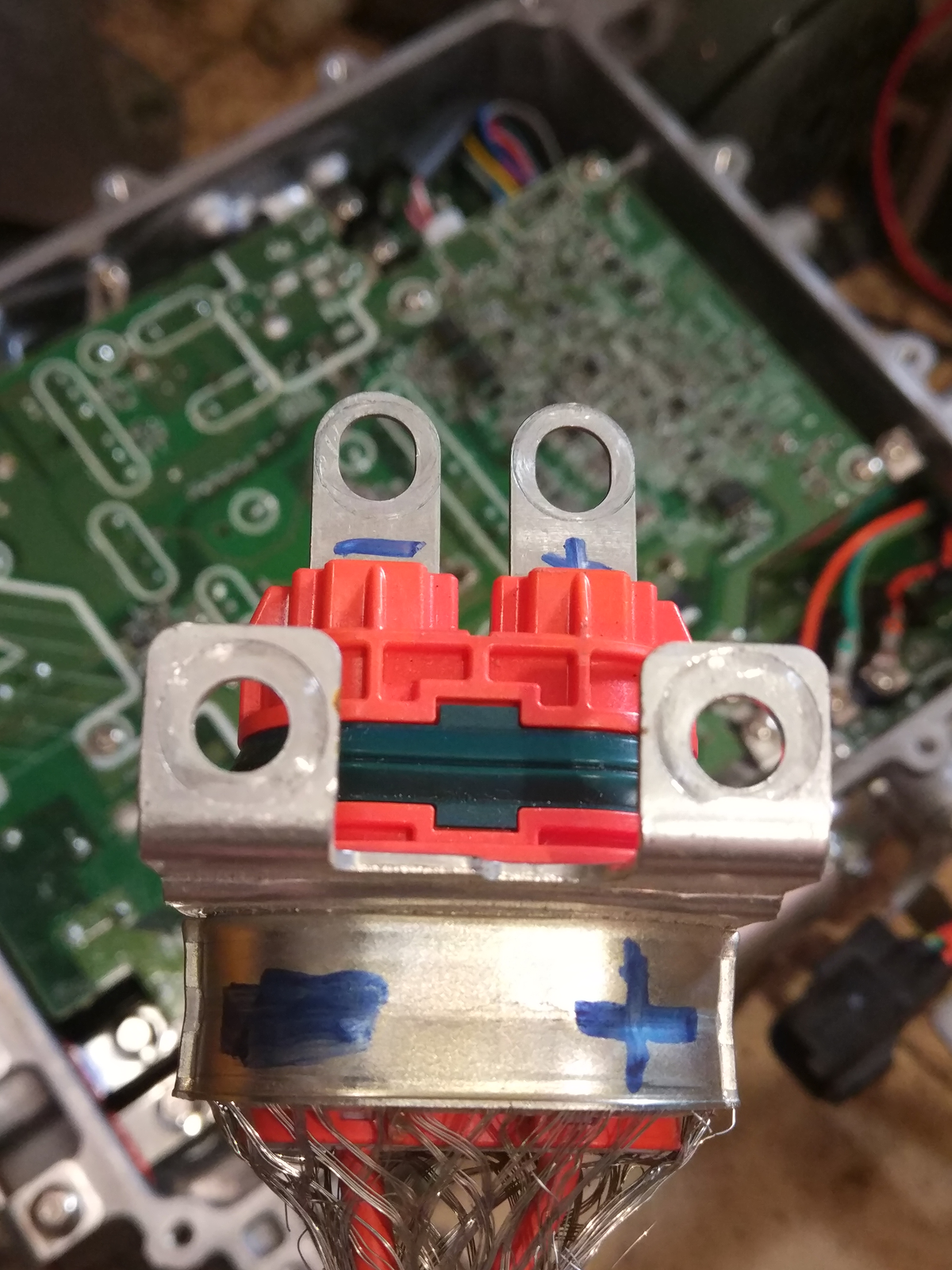

I managed to pry the unit open to determine which side connector is positive...pics.
Also one pic of the N/L/PE connections.
