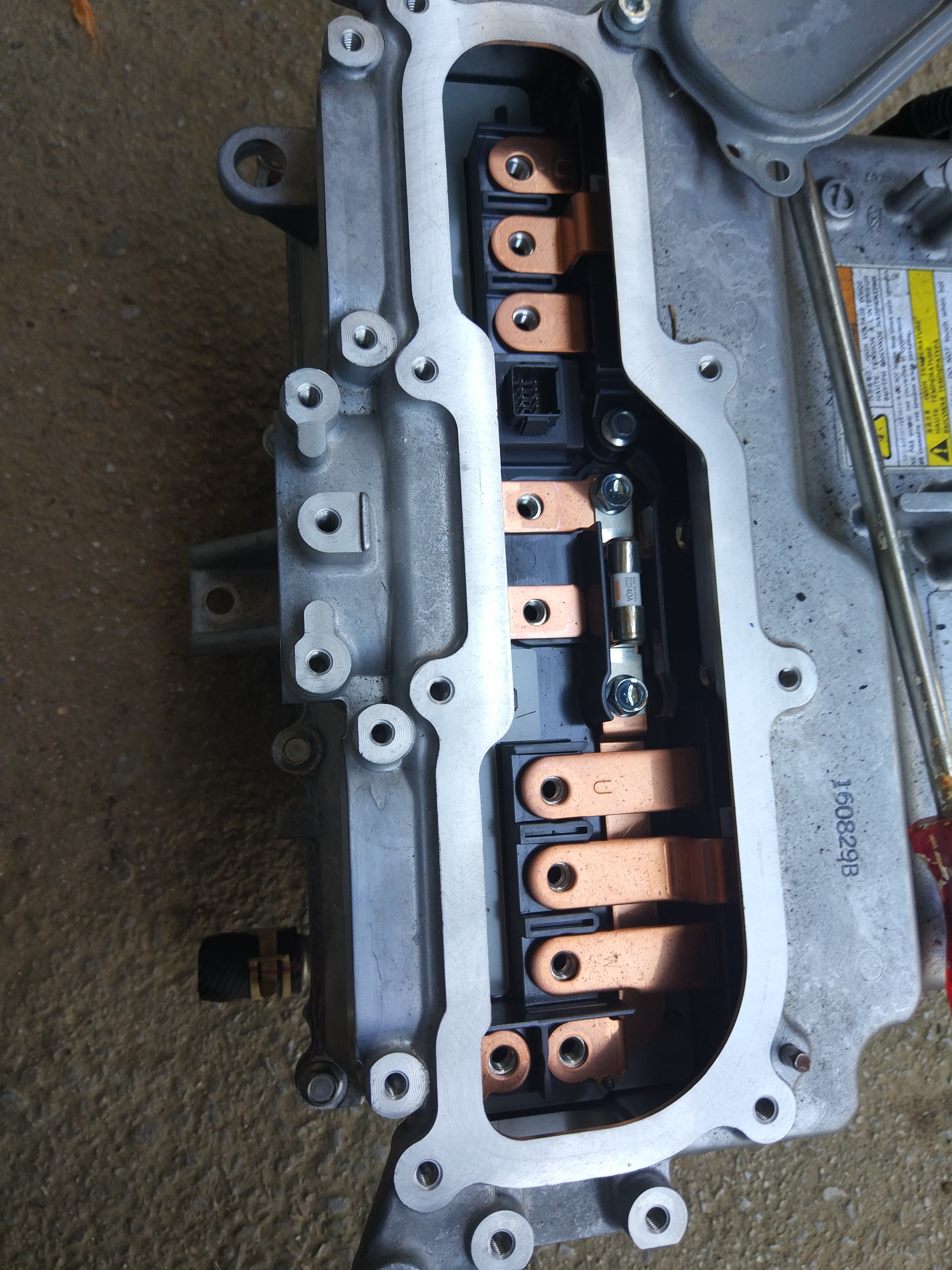

Now I have Outlander inverter in my workshop. I still need to figure out which one is it exactly, but i think it is rear one.
It has only 3 phase cables yes?
A
Posts: 2962
Has thanked: 328 times
Been thanked: 847 times
Re: Mitsubishi outlander charger and DC:DC
two round holes and one oval hole on the bottom.
2x 14pin LV connectors on flanges. Then it is a rear.

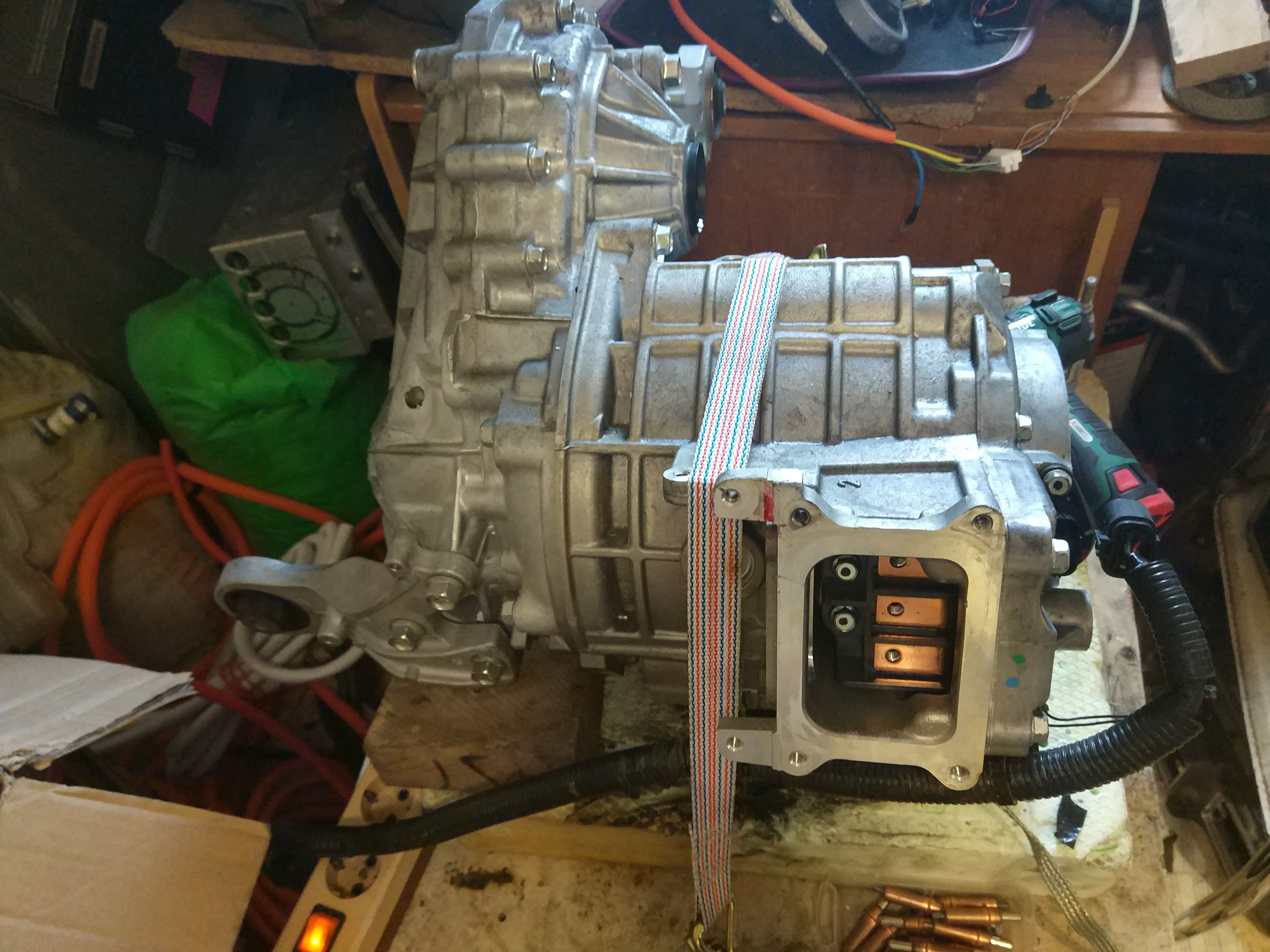

Post by pemtek »
Yes I got the inverters and charger working a few months ago, pretty simple set of can bus commands.
I am building an ep3 civic type r with an outlander rear motor mounted in the front using the outlander inverter, charger and batteries.
I know its a serious power downgrade but I had the car already with no engine and gearbox so it was an easy solution.
Phil

Posts: 3795
Been thanked: 411 times
tom91 wrote: Fri Apr 10, 2020 7:06 pm two round holes and one oval hole on the bottom.
Tnx Tom
I have this motor and controler at home now, damn it is a front inverter and rear motor!
Do you have a P/N for the rear one?
Also is driving a front one with CAN realisticaly possible?

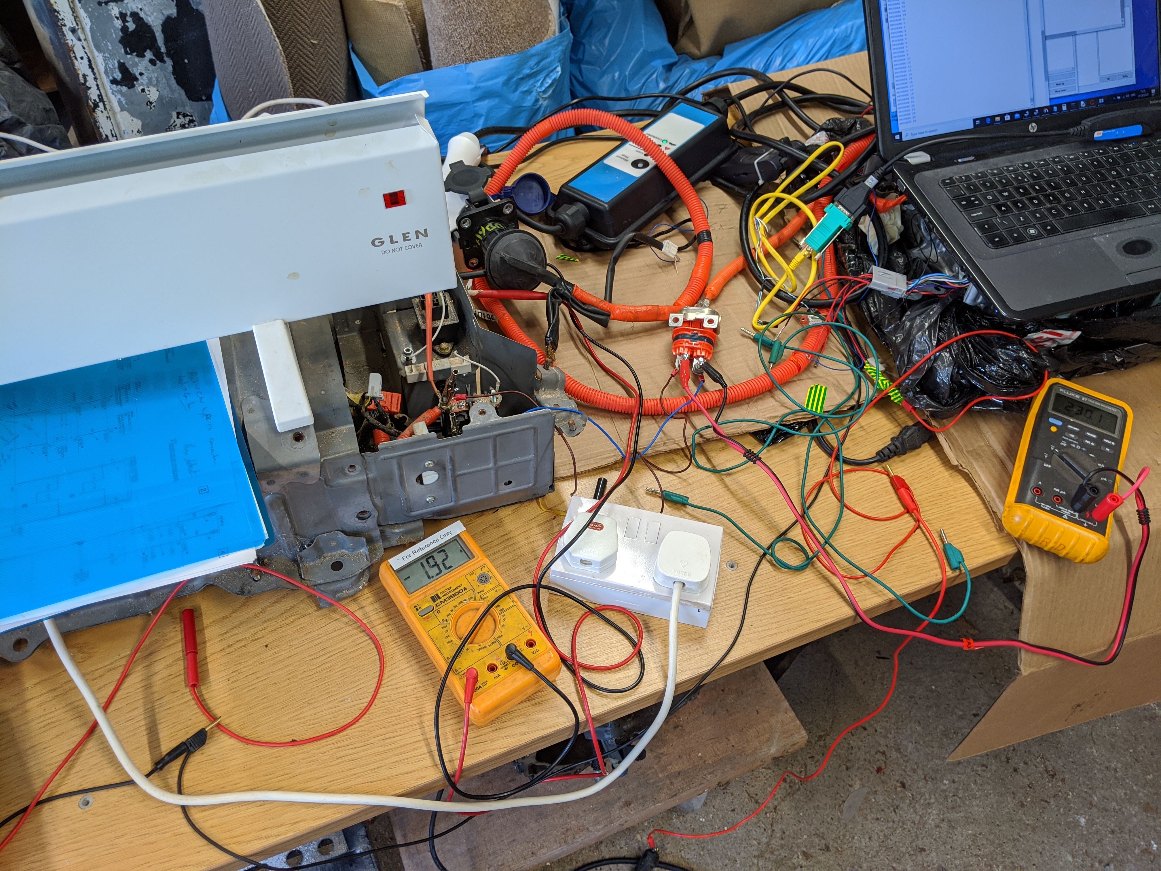

I got the charger connected to a Prius battery, sitting at 150v.
The system still only pulls on the evse for one second before dropping the evse, when I send the 285 message with b6.
Posts: 2962
Dilbert wrote: Sat Apr 11, 2020 12:21 pm I got the charger connected to a Prius battery, sitting at 150v.
Probally because you have too low a DC voltage. The inverters have a cut off of around 200V.

Post by Dilbert »
Ok I'll try charge the pack via a big resistor.
I can understand the charger not wanting to charge the pack, but I didn't think it would drop out the evse.
I currently have nothing connected to the proxy signal as that normally goes to the phev ecu. As far as I know the evse does not read the proximity signal, it is just a few resistors in the j1772 handle

Hi
Does anyone need Mitsubishi Outlander front inverter? It is PN 9410A095 with dual motor port as well as AC HV connector.
I am willing to part it for 120€. Interested?
I managed to negotiate another shipment, this time i will get correct rear inverter.

Post by Dilbert »
I've successfully got the Outlander charger to charge the prius battery :D
I needed to get the battery voltage up closer to 200V, before the charger would keep the EVSE contactor pulled in all of the time. I had to be a little creative to get some current into the battery and bring up the voltage so the charger would not fault out.
I could then command the charge current by using the 0x286 message. For anyone who is interested I've attached a python script which I used with the KVASER CAN tool to send the frames.
So overall, i'm quite happy, can now design something to detect when the handle is attached via the proximity signal and power up the charger. When the charger powers up if I can see the pilot duty I will be able to request that it starts charging.
I can't get the charger to start a second cycle without powering it on/off, so i'm not sure if its faulted out by how i'm stoping the cycle, or it's just part of the code that once it does the charge cycle it won't do it a second time. In my python script which is very much hacked together on the garage floor, i requested that the charger go back to 0 current before dropping the EVSE out, but didn't seem to allow me to start a second charge. I need to review the logs from the car again.
One other thing I learned by accident, i used my 2kw office heater as the pre-charge resistor, and i started a charge cycle with the heater in the circuit. I commanded 2Amps and when i looked down at the meter i had 2A in the battery and the charger output was up over 400V :o So it looks like this charger will possibly be able to charge higher voltage packs.
My plan is to use the above setup to test the DC:DC Converter next week. There doesn't seem to be any output control for the DC:DC, which is controlled via an enable pin.
Very happy with the above, these chargers are using in a range of PHEVs, so should give a cheap charging and DC solution. It will also easily fit where the spare wheel goes and the AC input cable is long enough that it will go as far as the petrol cap on any car.

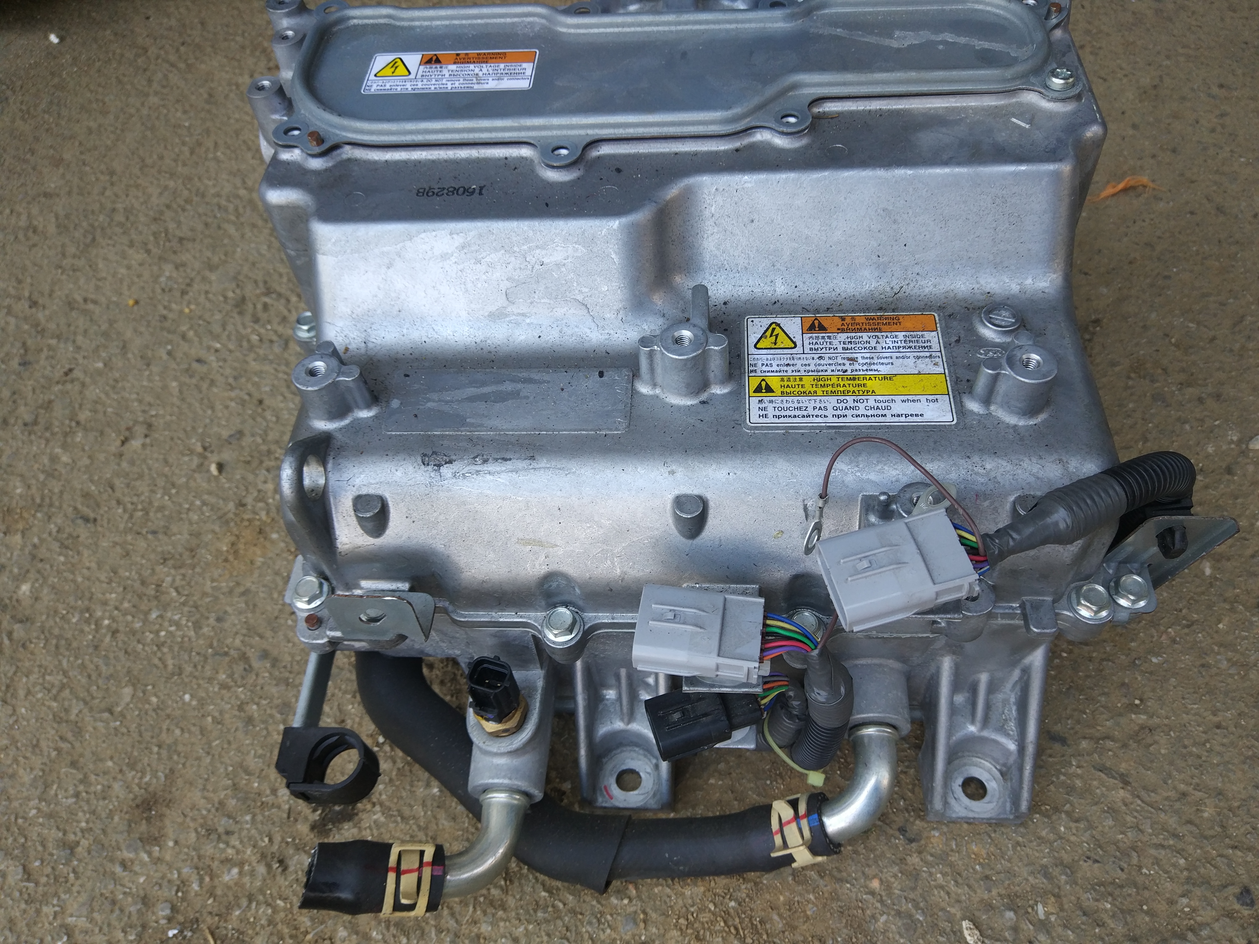

Dilbert
Posts: 410
Location: Dublin, Ireland
Post by Dilbert »
The lv connector is used on a couple of Japanese models, I'll try dig out the part number. If you zoom in on my picture you'll see I used lots of 2 way connectors pushed into the pins, they work fine. There's not too many wires.
Dilbert
Posts: 410
Post by Dilbert »
arber333 wrote: Sat Apr 11, 2020 9:52 pm
Dilbert wrote: Sat Apr 11, 2020 7:47 pm I actually didn't try that. I was dropping out the evse and trying to get it to pull in agsin. In this scenario it wants the power cycled on the charger.
Hm... do you happen to know which plug to buy to connect to charger LV connector? I hope it is not unobtanium...
tnx
I found what I believe to be to lv connector part number, the inverter connector is marked 12716.
The Toyota part number for the inverter side is 90980-12716.
The mating connector on the vehicle side, which we need to connect to the inverter is 90980-12326
I imagine a Toyota dealer can supply with pins.
Posts: 3795
Dilbert wrote: Sun Apr 12, 2020 5:25 pm The mating connector on the vehicle side, which we need to connect to the inverter is 90980-12326
I found 13 pin connector Sumimoto 6189-1092 right in the UK.
