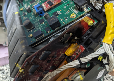

You say you only regenerate when the brake is applied. When it failed, you didn't brake, right. Could it be that the voltage in the inverter rises to a value that is sufficient to destroy the ITGBs because nothing is diverted into the battery?
I did a full throttle acceleration for a few ...

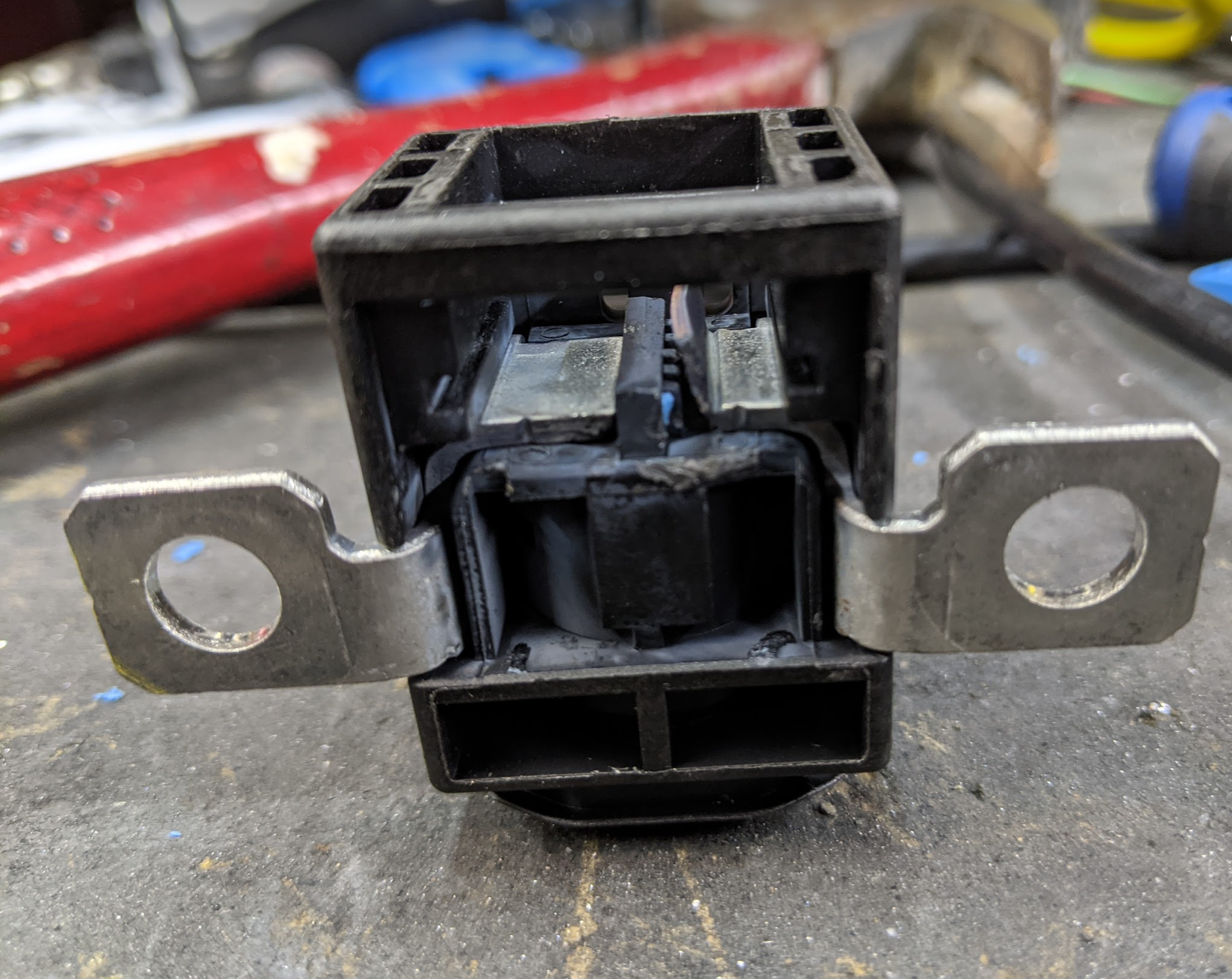

I think using a used Tesla pyro fuse was a bad idea. It blew at a strange time for not having any indication of a short.

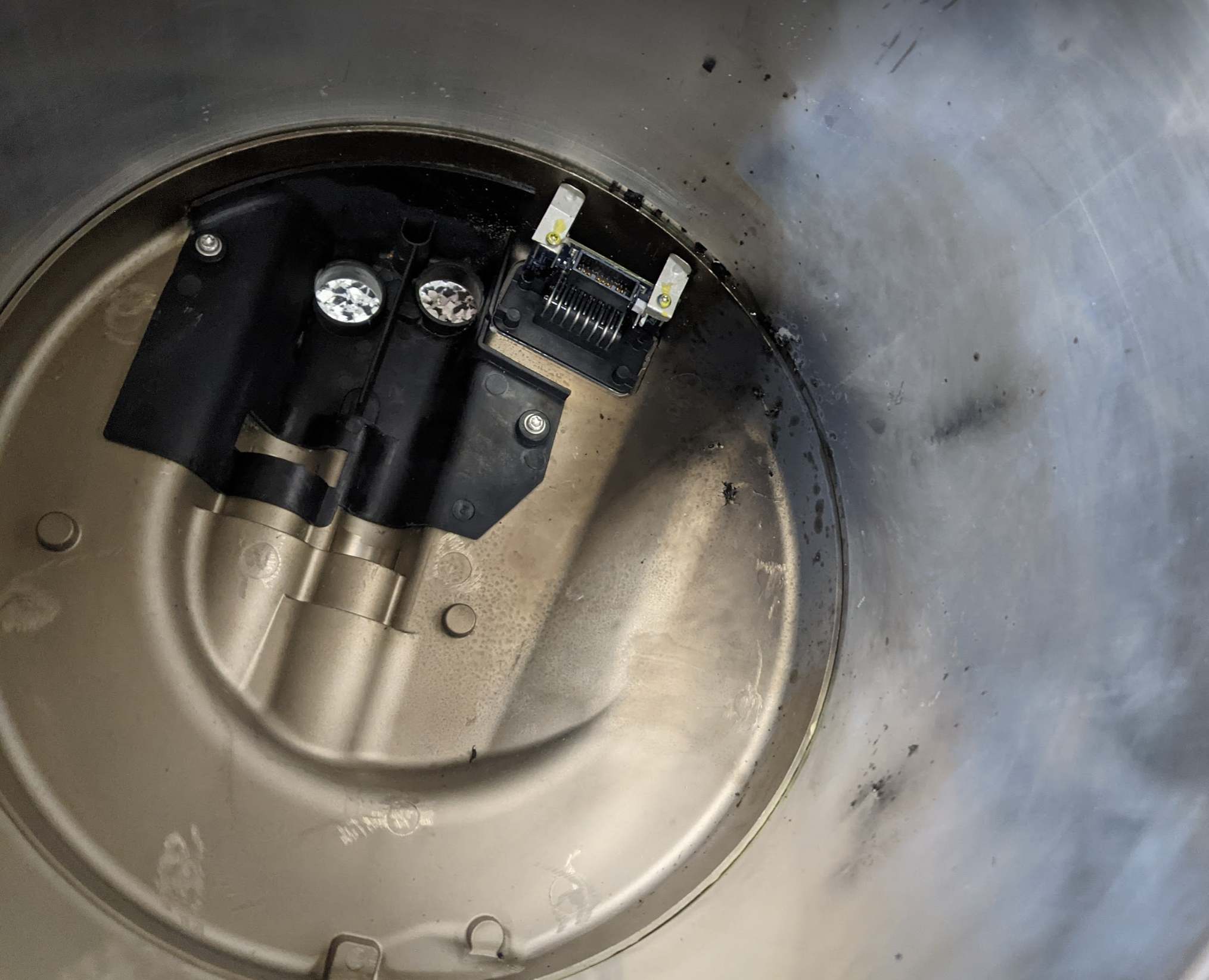

Found the smoke.
I have probably 1000 miles on the car with lots of hard acceleration. Not sure what would cause the Tesla pyro fuse to blow, it was power off regen at the time, battery cells were about 4.05 max.
Here is a picture of the inverter, the bottom phase took hit. Do you guys think this ...

Curious to hear what you find. I would doubt a blown igbt alone can pull enough current to blow the pyro fuse. I would think it requires a direct short somewhere.
I am curious as well, No indication of any short right now, all high voltage components run normal except when selecting fwd/rev ...
