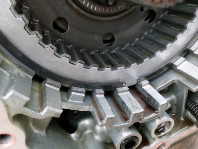

Fantastic work on locking ring.
How are you progressing on coupling MG1 and MG2 together. Are you planning to come up with something other than welding?
Thank you!
Helical gears are not so easy to measure, to create some sort of locking brackets. Also carrier case is welded, so to install ...

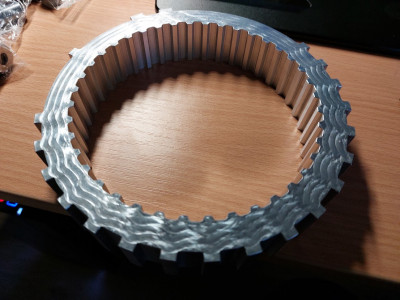

SWEET! I am certain this is superior to my (alternate) plan of just filling that space with J-B Weld :D
I just had an option of milling this part for free. It is less costly to cut those from 2mm stainless steel with laser and replace only metal clutch rings.
Atleast now I'm absolutely certain ...

I've fabricated that locking ring for high range, I've shared here before, from solid piece of aluminum.
It fits like a glove.

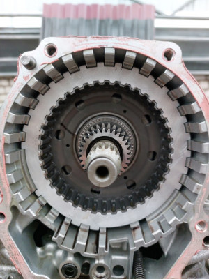

Test sample of the ring for permanently locking the high range was cut from PVC plastic. Laser wasn't really accurate(cheap model for advertisement production) and burned a little too much into the ring, but measurements seems to be taken correctly, so here dxf file for those who interested. You ...

Continuing torturing the transmission. :)
I disassmbled that two-step planetary thing with hard to pronounce name, and took measurements of clutch discs of high range. I will not place a dxf drawing here yet. First I need to make sure that measurements are taken correctly.
Clutch pack thickness is ...
