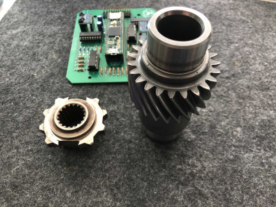

Tomorrow I start work on connecting the engine to the gearbox using elements taken from the outlander differential and the peugeot clutch plate.

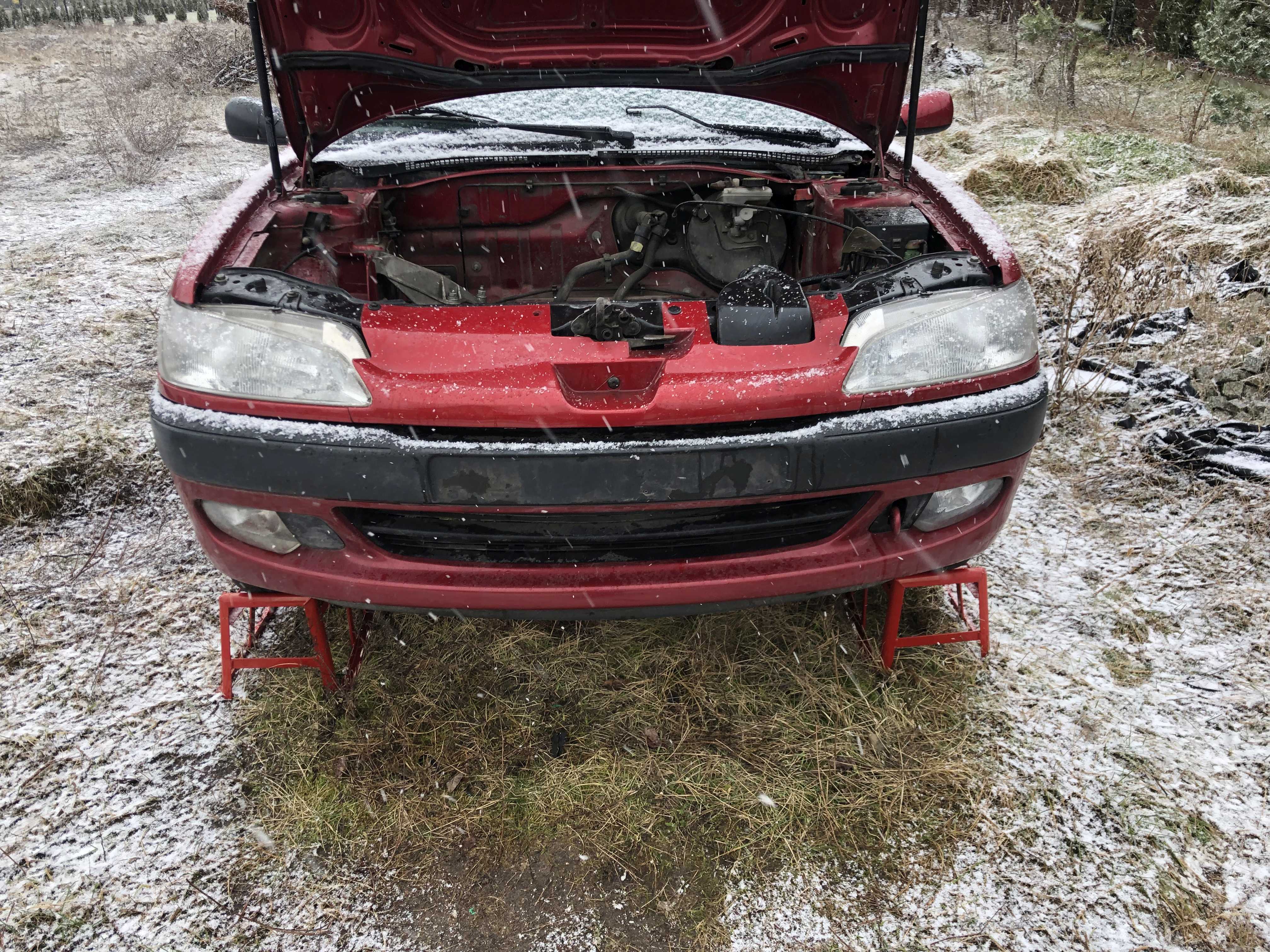

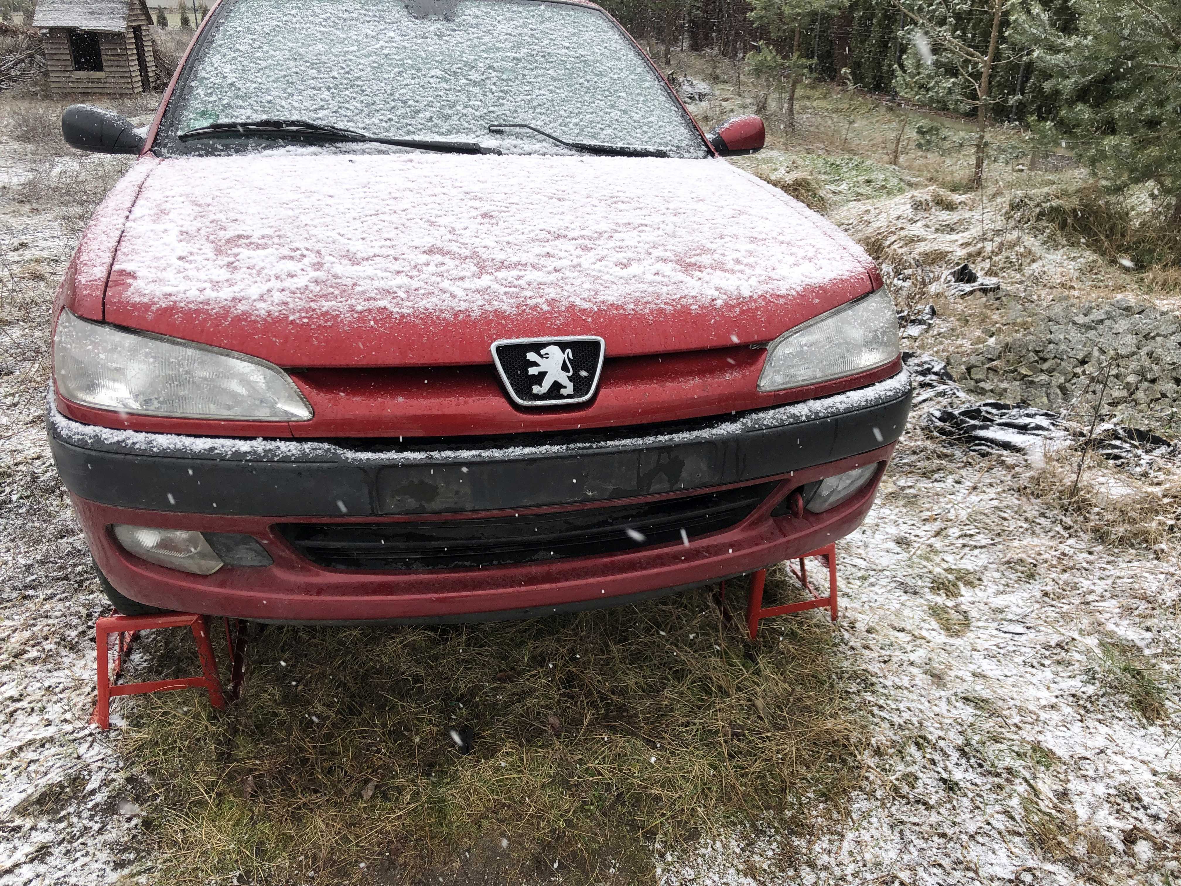

Due to the weather, the work is progressing very slowly, I try to do something, but only when I have free time or when it rains or snows. Let this spring come

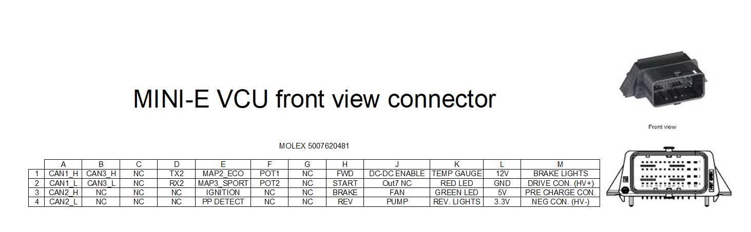

I prepared the pinout in the mini-e VCU board described here
viewtopic.php?t=2167
maybe it will be useful to someone, I'm just asking someone who has experience with this board to check if I made a mistake.

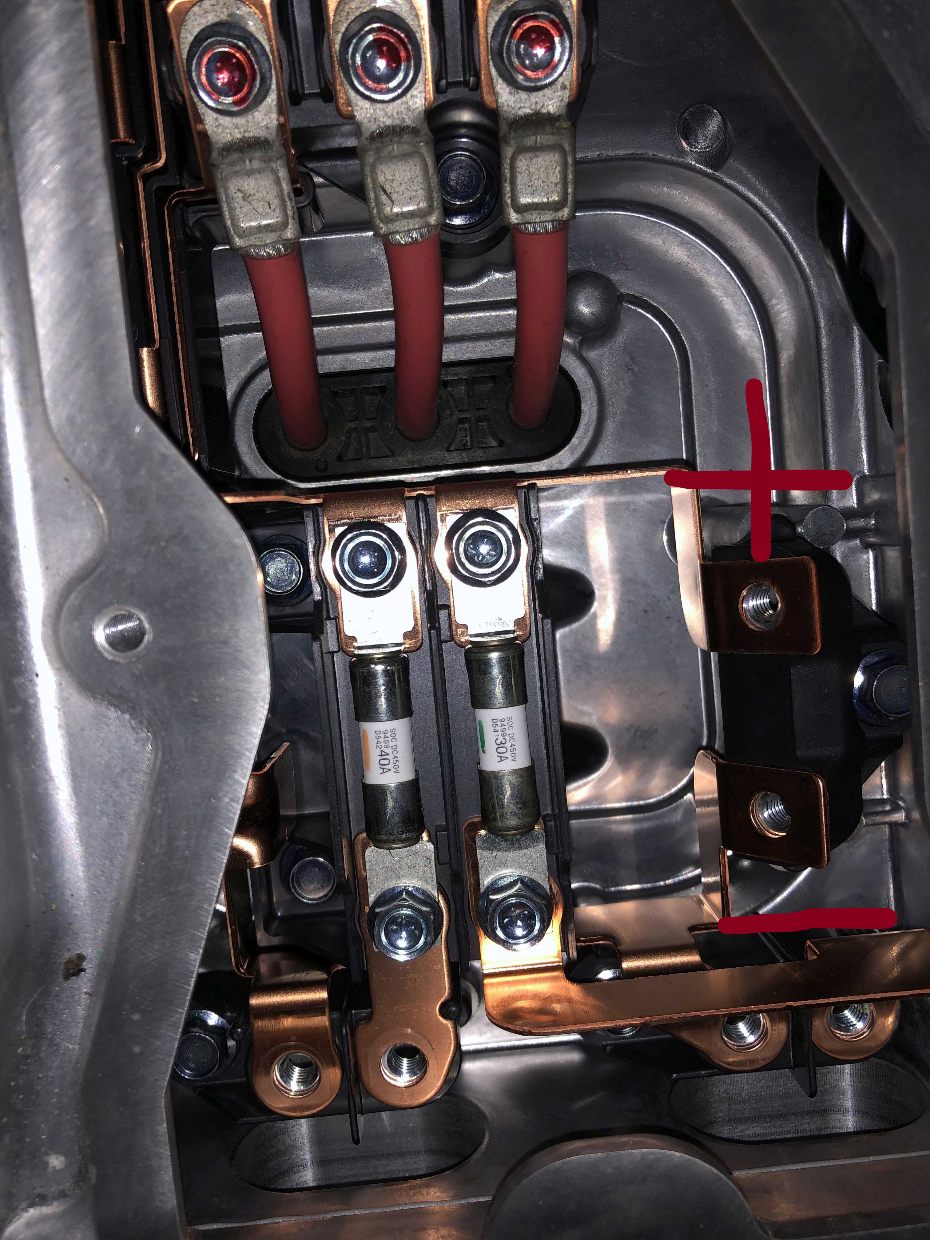

Thanks, just wanted to confirm that I'm thinking right
- Mon Feb 20, 2023 7:12 am
- Forum: Projects
- Topic: Peugeot 306 '98 conversion
- Replies: 34
Re: Peugeot 306 '98 conversion
I have a question, do I think correctly that this is how the poles of the battery wires should be connected? This is the rear inverter from the outlander

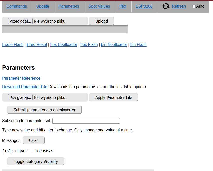

thank you very much for the hint. change "snshs": 1 i.e. "semicron" helped. I am very grateful for your help
- Wed Feb 15, 2023 6:20 am
- Forum: Toyota/Lexus
- Topic: Auris/Yaris inverter
- Replies: 22
Re: Auris/Yaris inverter

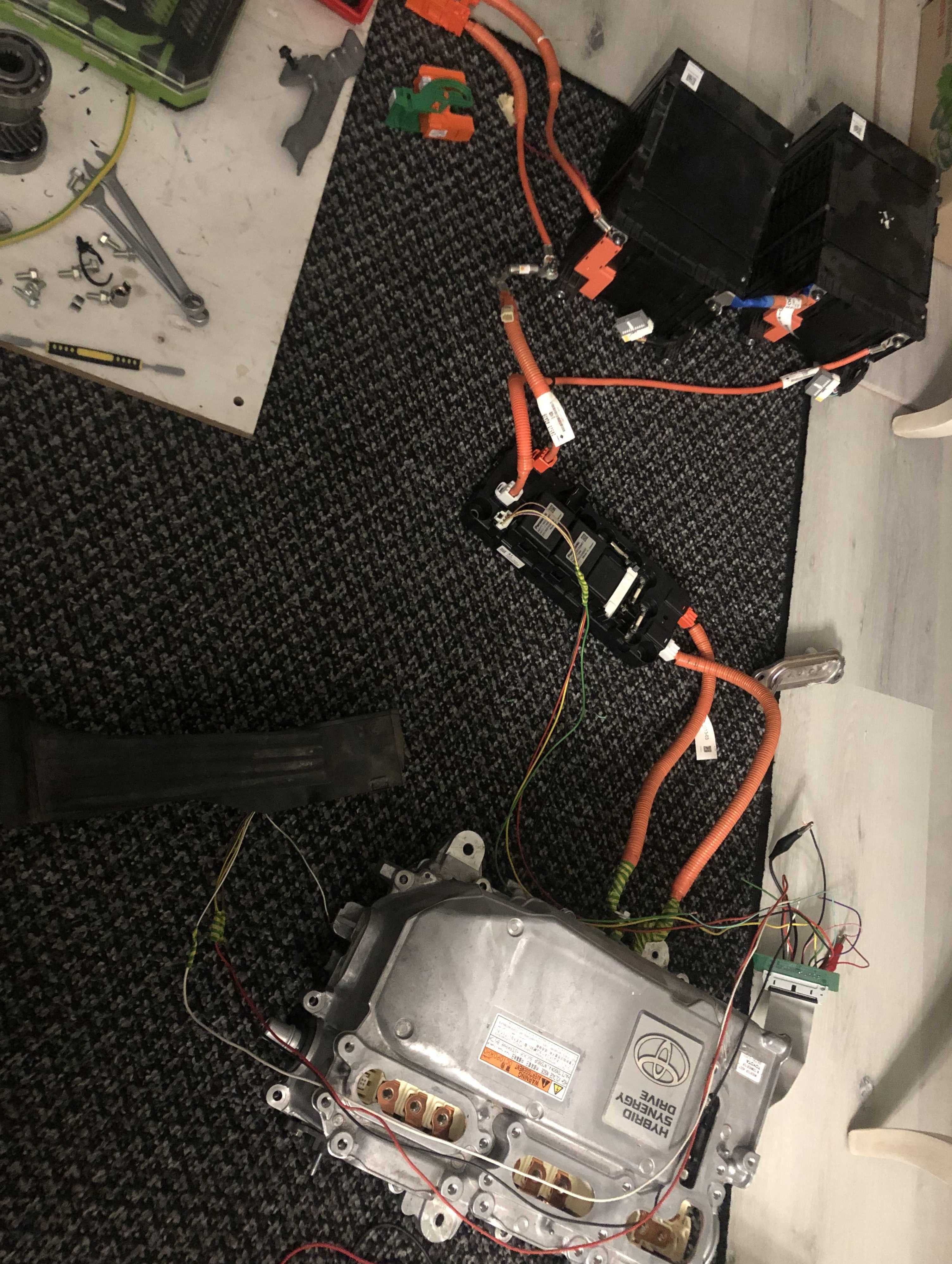

When I run it, I get the error [18] DERATE-TMPHSMAX. The small_dual_v1d board has the latest soft stm32_sin loaded, only the gas pedal from BMW is connected.

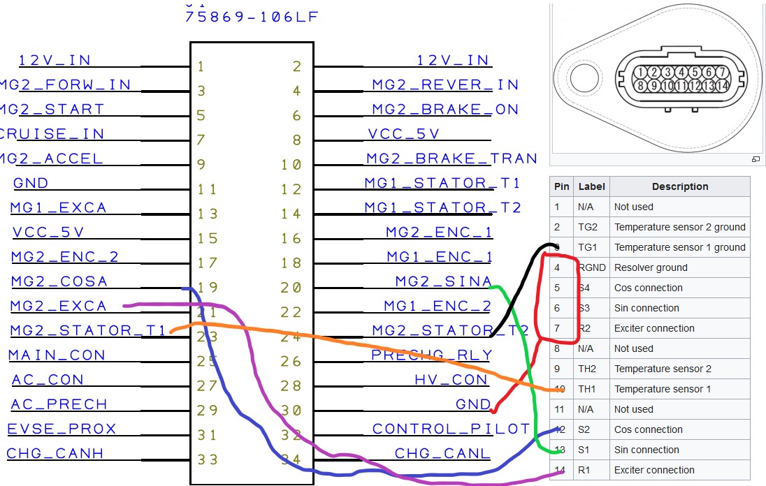

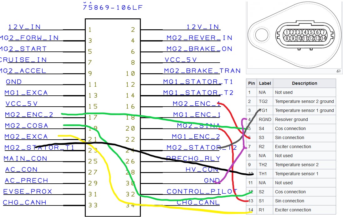

I have a question for people with more experience than me. Below I have compiled the connector from the dual_v1d board and the resolver from the outlander rear drive unit, is this connection correct?

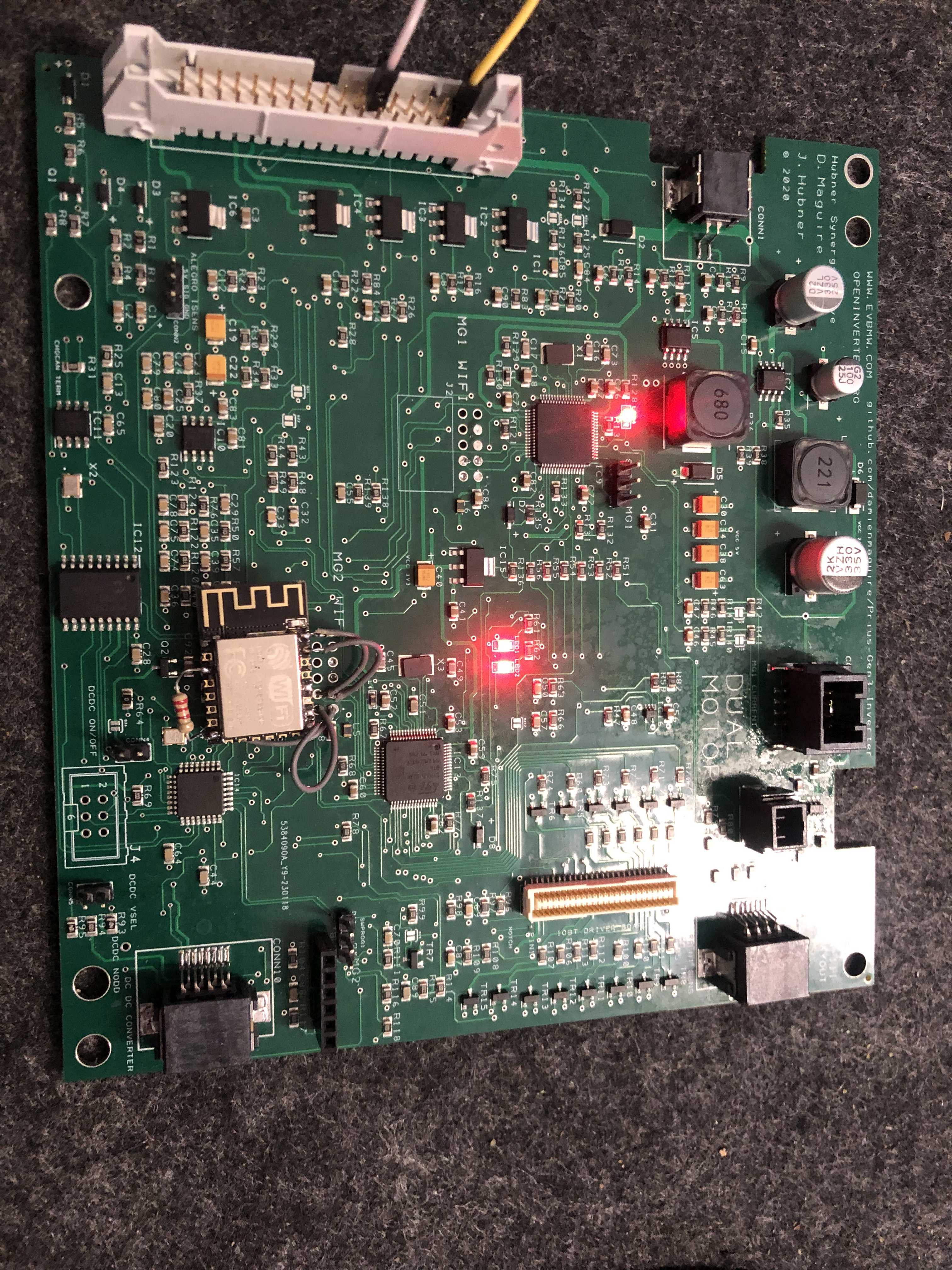

the board is already alive after programming
I did everything step by step like this friend on YT

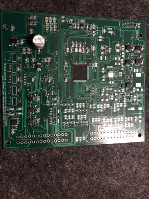

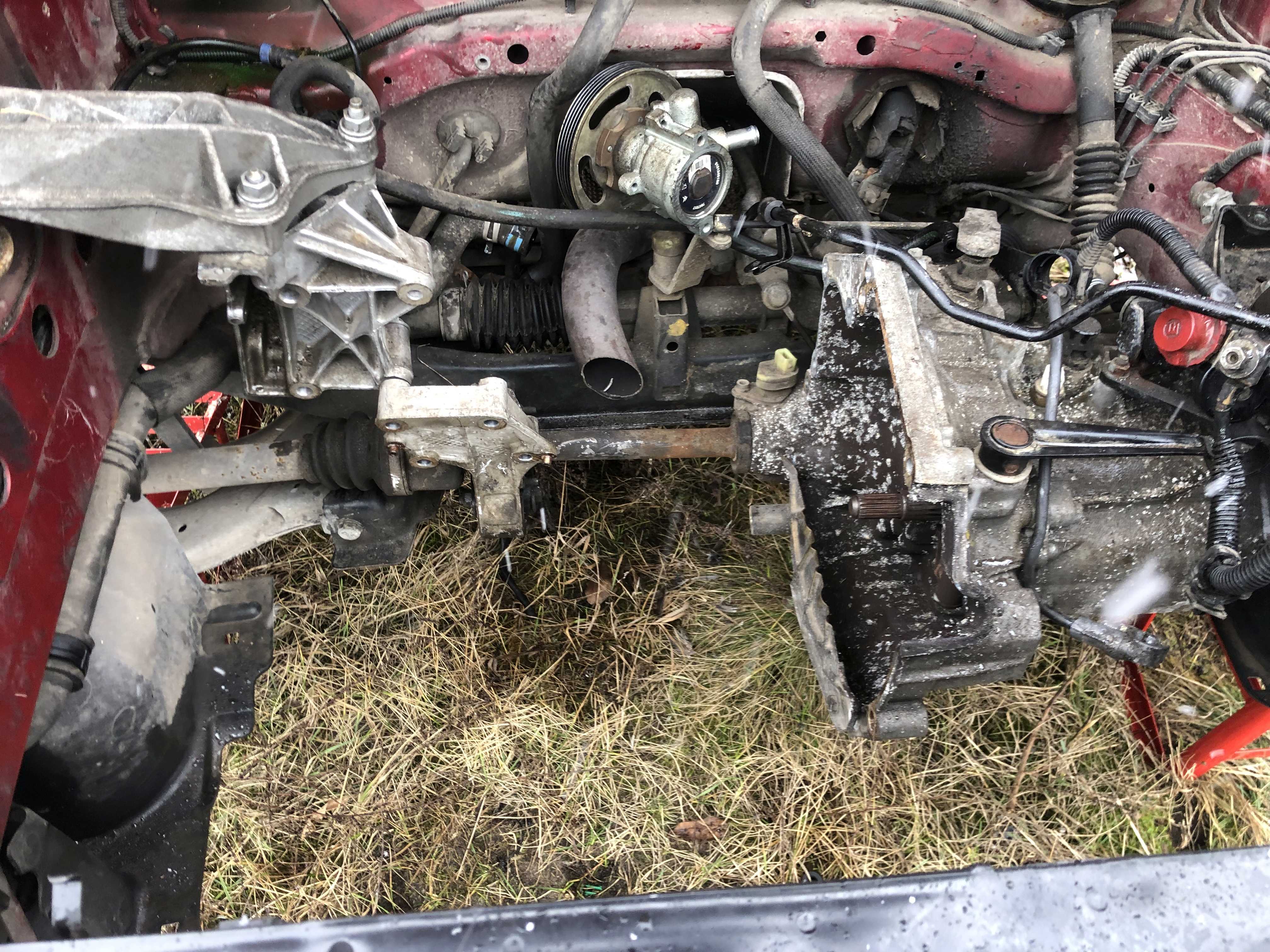

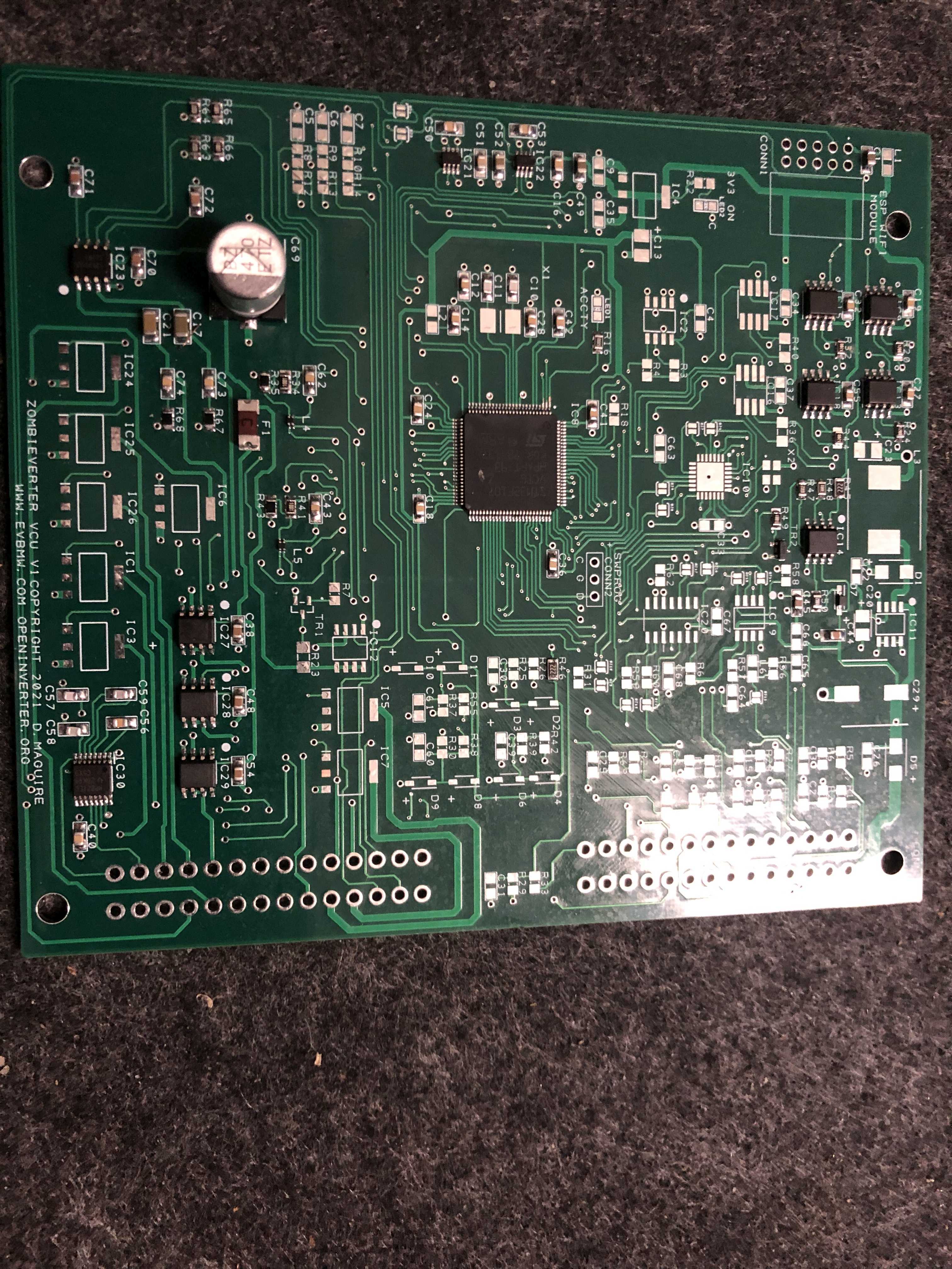

Work is progressing slowly, waiting for the outlander's engine, I'm disassembling the internal combustion engine. Due to the cold and snow, there is not much going on
Finally, the assembled boards have arrived from jlcpcb. I am starting to assemble the connectors removed from the ...
