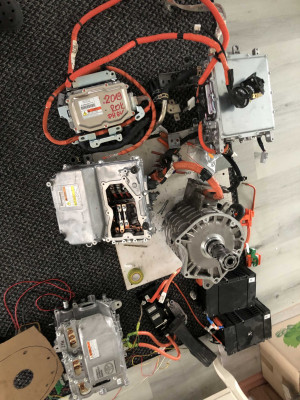

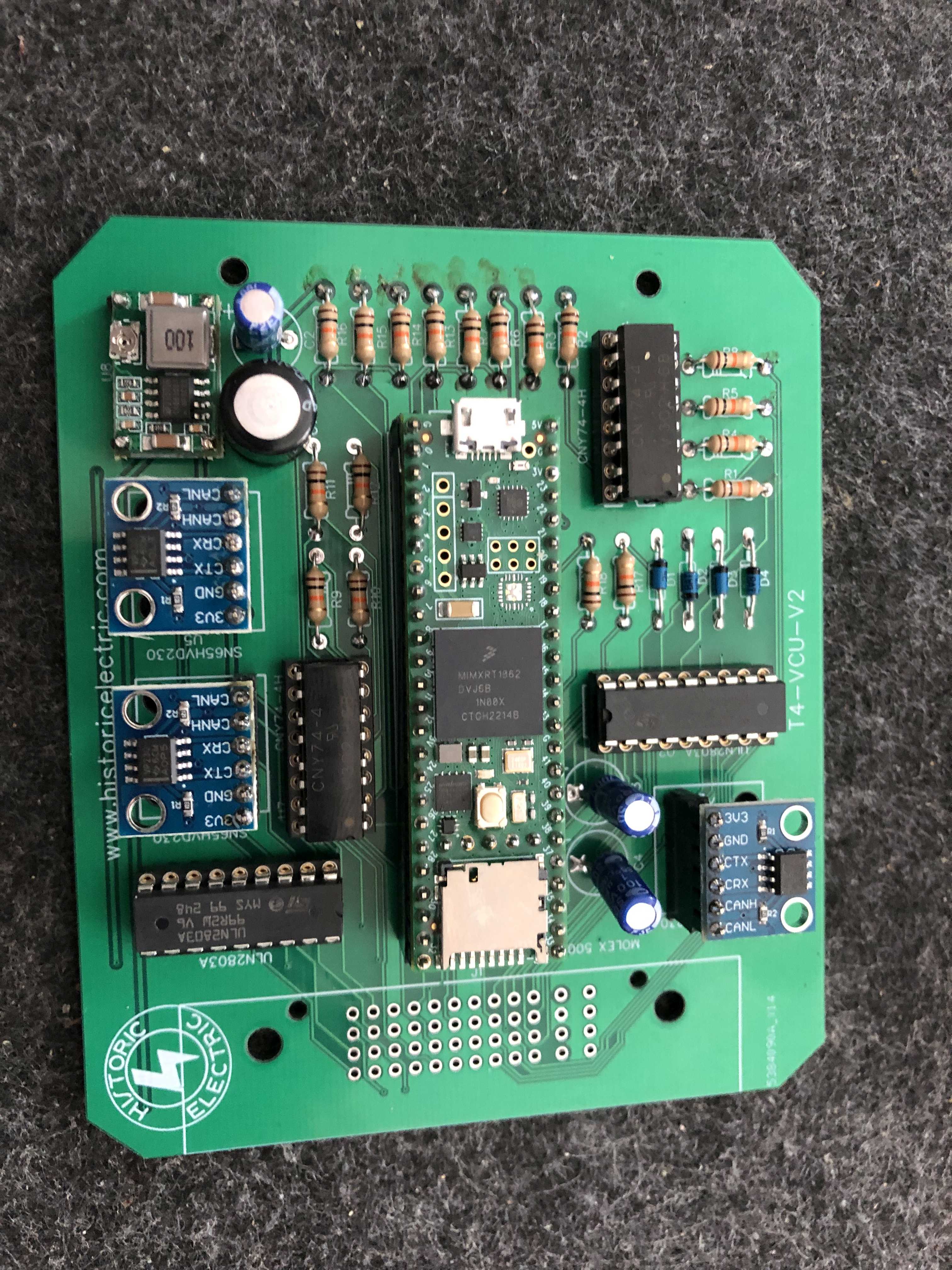

The plate arrived today https://oshwlab.com/aot93/mini-e-t4-vcu_copy. I assembled it so there is already a whole set for trials and tests in the workshop
I've already collected the rest of the Outlander stuff
Time to start testing. If everything fires up, I'm getting ready to install it in the car

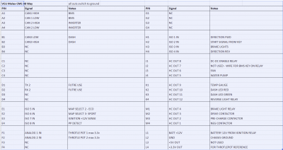

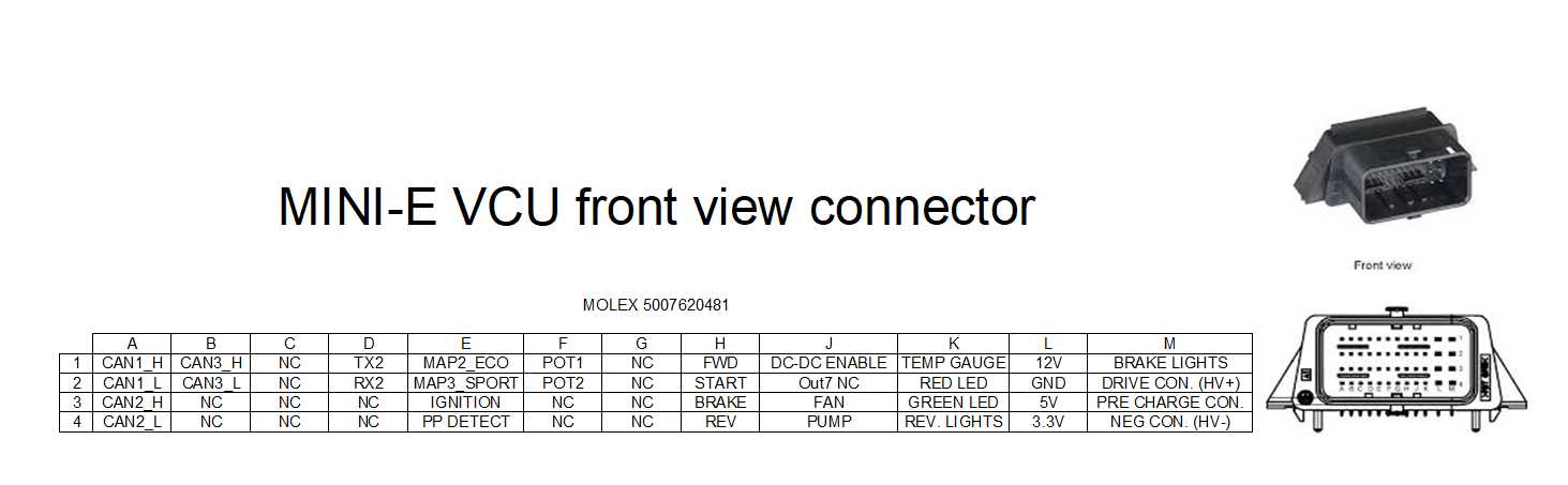

I prepared the pinout in the mini-e VCU board described here
viewtopic.php?t=2167
maybe it will be useful to someone, I'm just asking someone who has experience with this board to check if I made a mistake.

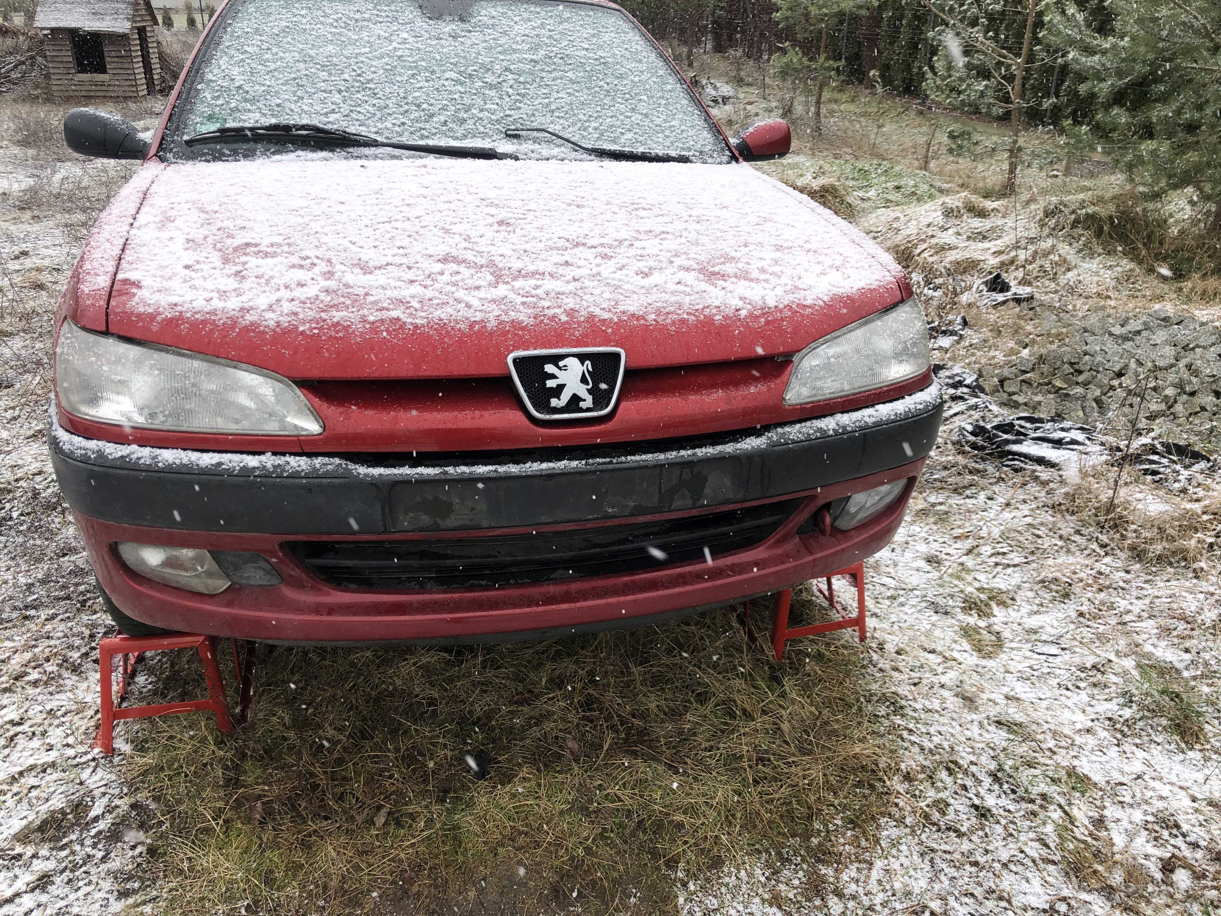

Due to the weather, the work is progressing very slowly, I try to do something, but only when I have free time or when it rains or snows. Let this spring come

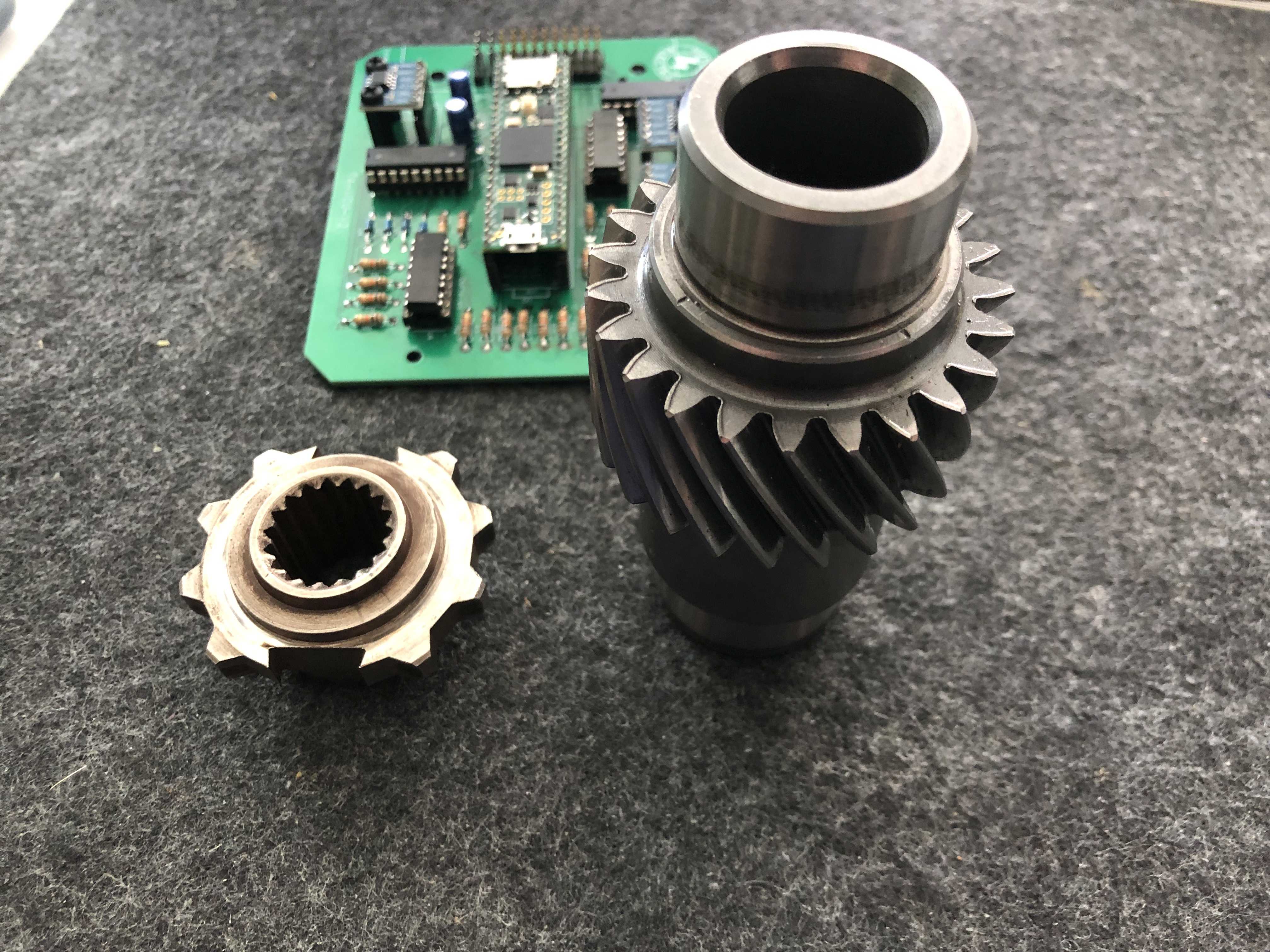

Tomorrow I start work on connecting the engine to the gearbox using elements taken from the outlander differential and the peugeot clutch plate.
