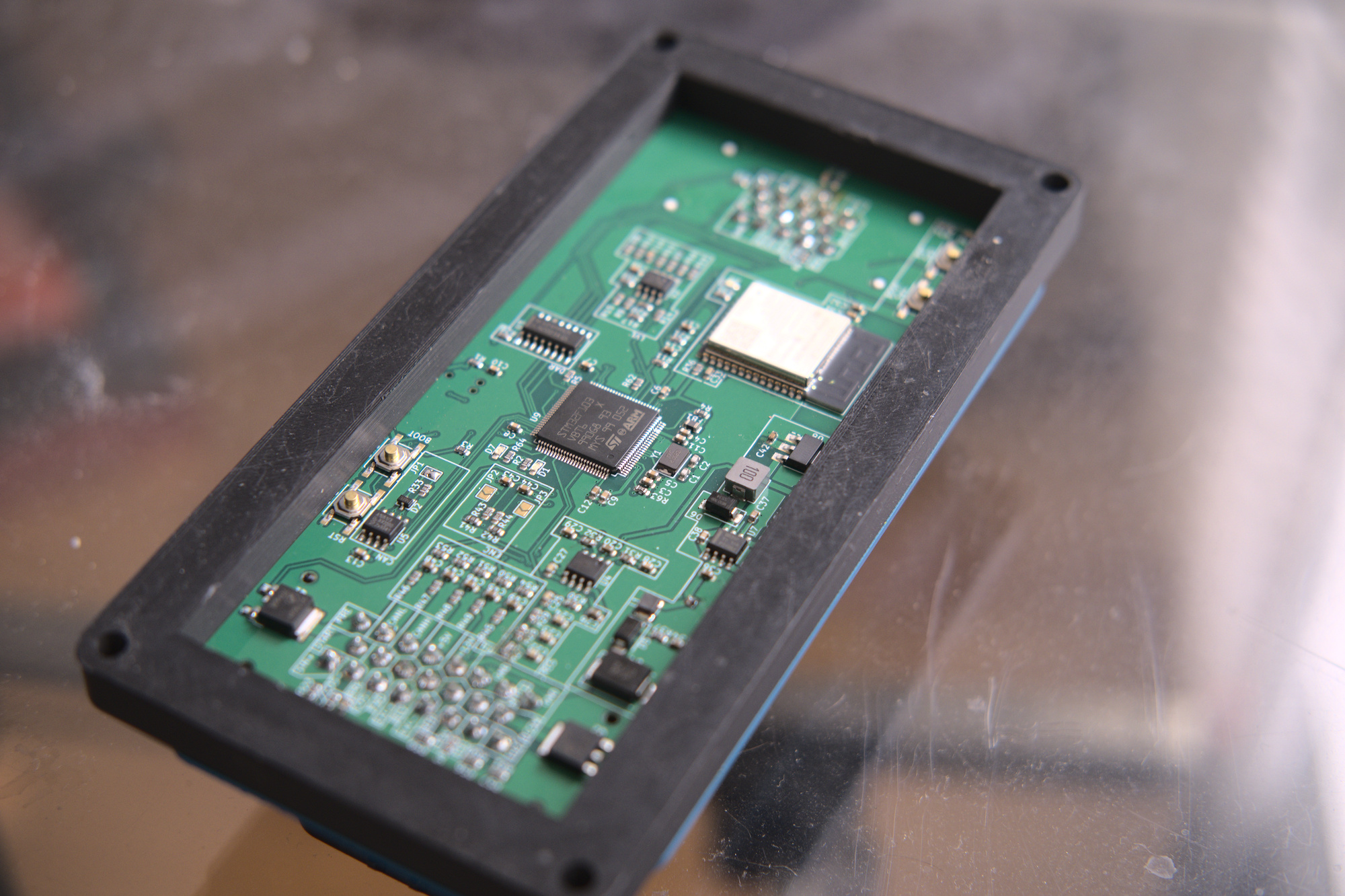

Re: prius gen2 remix
sounds good @johu, I can look into that. Do you have anything started with eagle already?
Took some pictures of the board today: (have a cutout on the lower case so I can debug/probe the board if necessary)

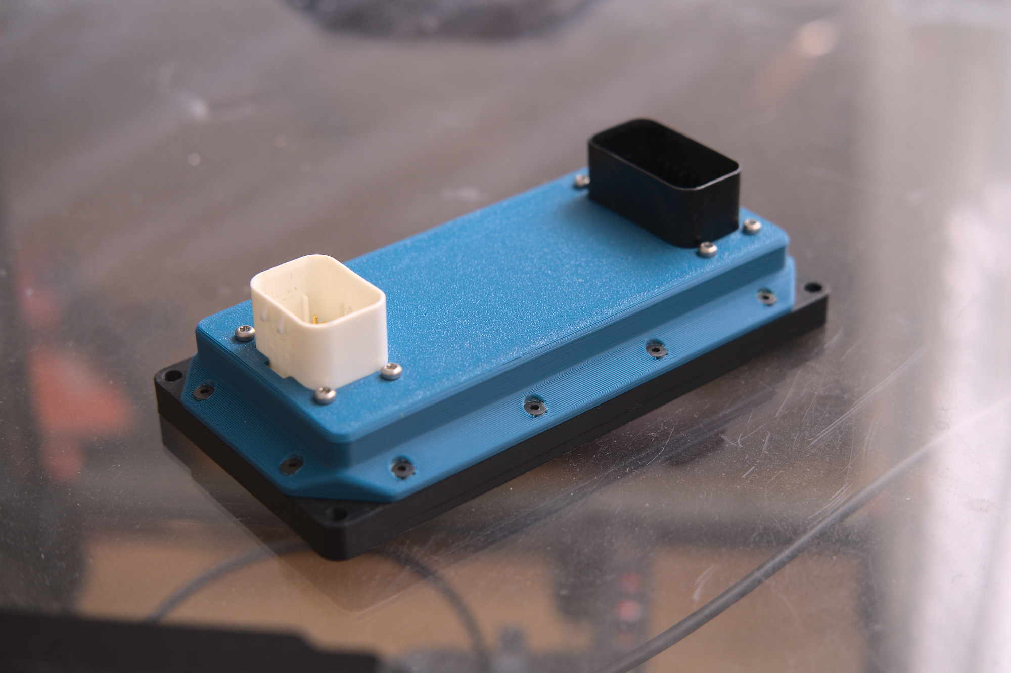

prius gen2 remix
I created a remix of the gen2 prius board:
https://github.com/ksmola/PriusG2
I built it around Ampseal connectors and made a 3D printed enclosure for it (I can upload some photos later).
It features the bigger 100pin F103VBT6, mostly because the 64 pin was already out of stock @jlc, however ...

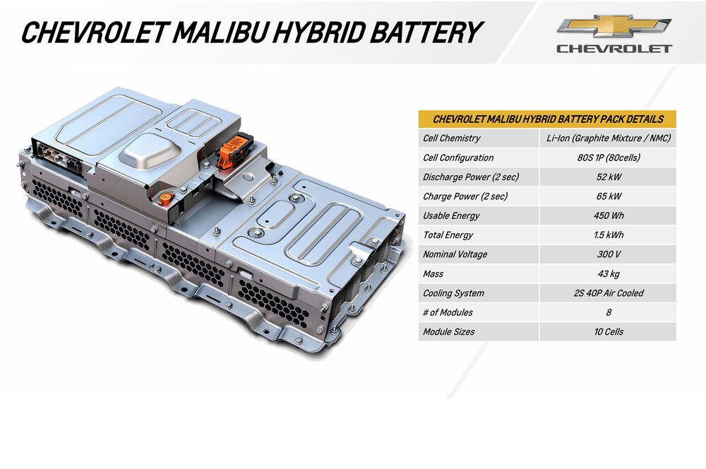

Thanks! Well since its a hybrid all the ice related gear is still needed and takes up space so that's an issue. I like the size and specs of the Malibu battery, but i doubt its the only option. Just looking for something 1-5kwh and >300V

I think even just 1kWh would be useful for this project. I doubt being able to reverse engineer the BMS CAN stream without a working donor car. Can you recommend a BMS for this battery?

The build is a hybrid, gen2 inverter and leaf motor so range is not a very big concern. I was wondering about the 450Wh usable? like what does that mean vs the 1.5kW? I've done some can message reverse engineering before but I don't have a working malibu to get a sniff from, so that will be difficult.

Chevy Malibu Hybrid battery
I found this battery and based on the specs it would be pretty ideal for my build:
Has anyone of you used it before? I assume I wouldn't need a BMS, and could I charge it with the prius gen2 inverter (off 240V AC) ?
