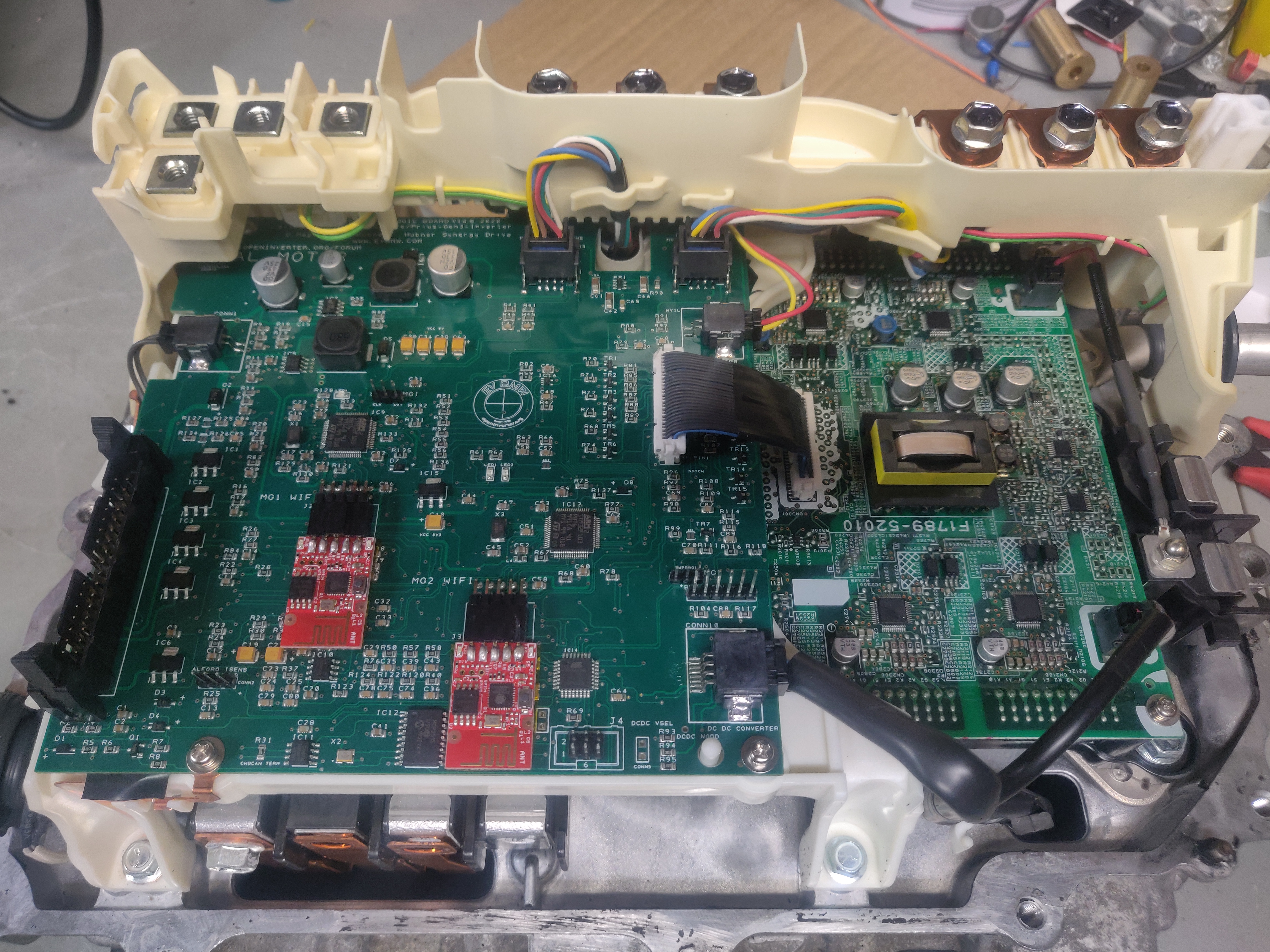

I have a fully assembled board prius gen 3 dual motor(Pri_G3_built_v1d)
I have a minimum of wires connected HV+-,invertor 12v -+,5+-one pedal Potentiometer,12+ start signal,12+forward direction signal,resolver 6 wires ...
my problem as you can see in the video below the motor ...

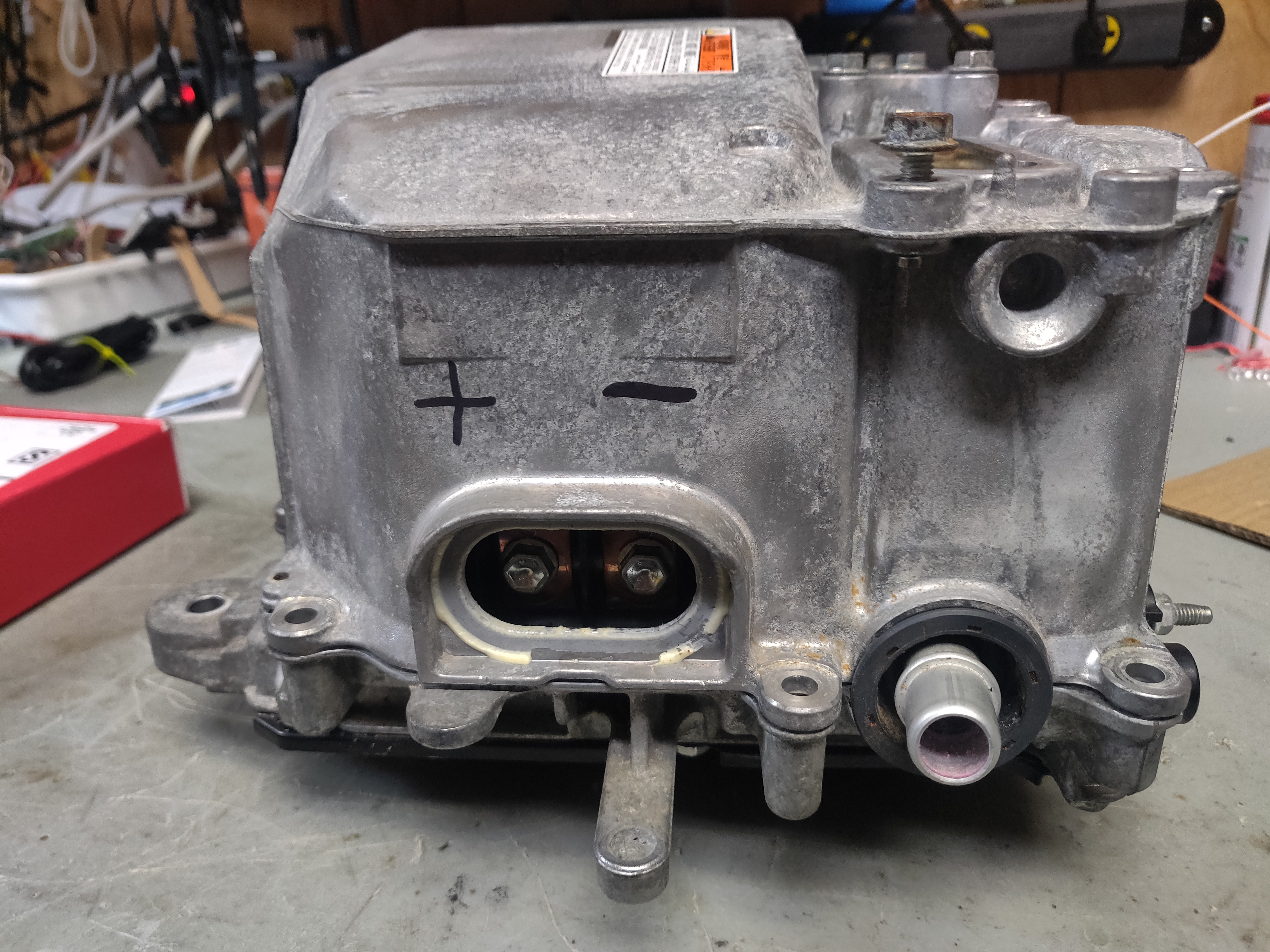

also i'm confused on which side to connect high voltage
somewhere in the photo and video on one side somewhere another side
which one is correct ???
pic #1 or pic #2
#1 #2
pic #1 or pic #2
#1 #2

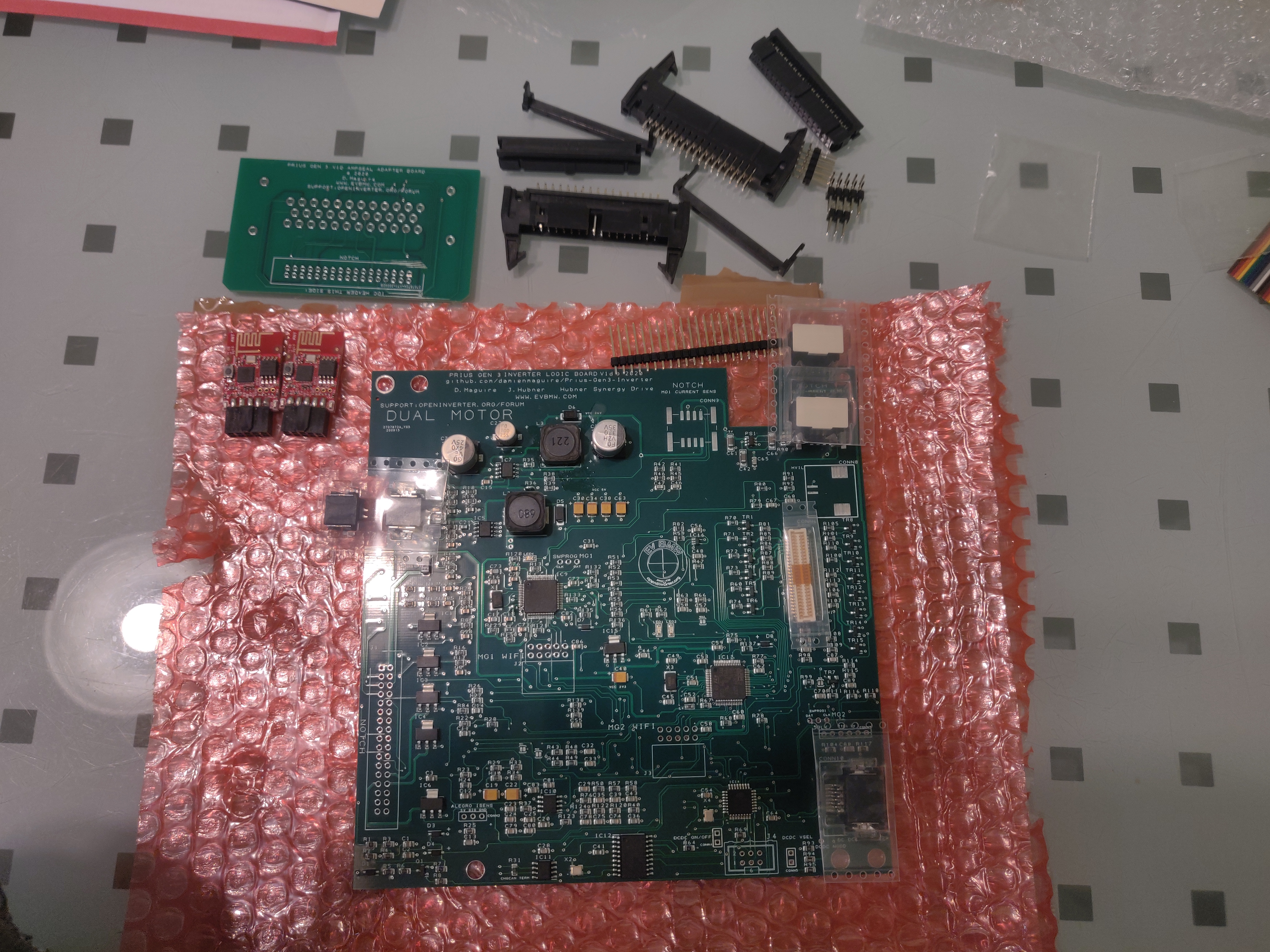

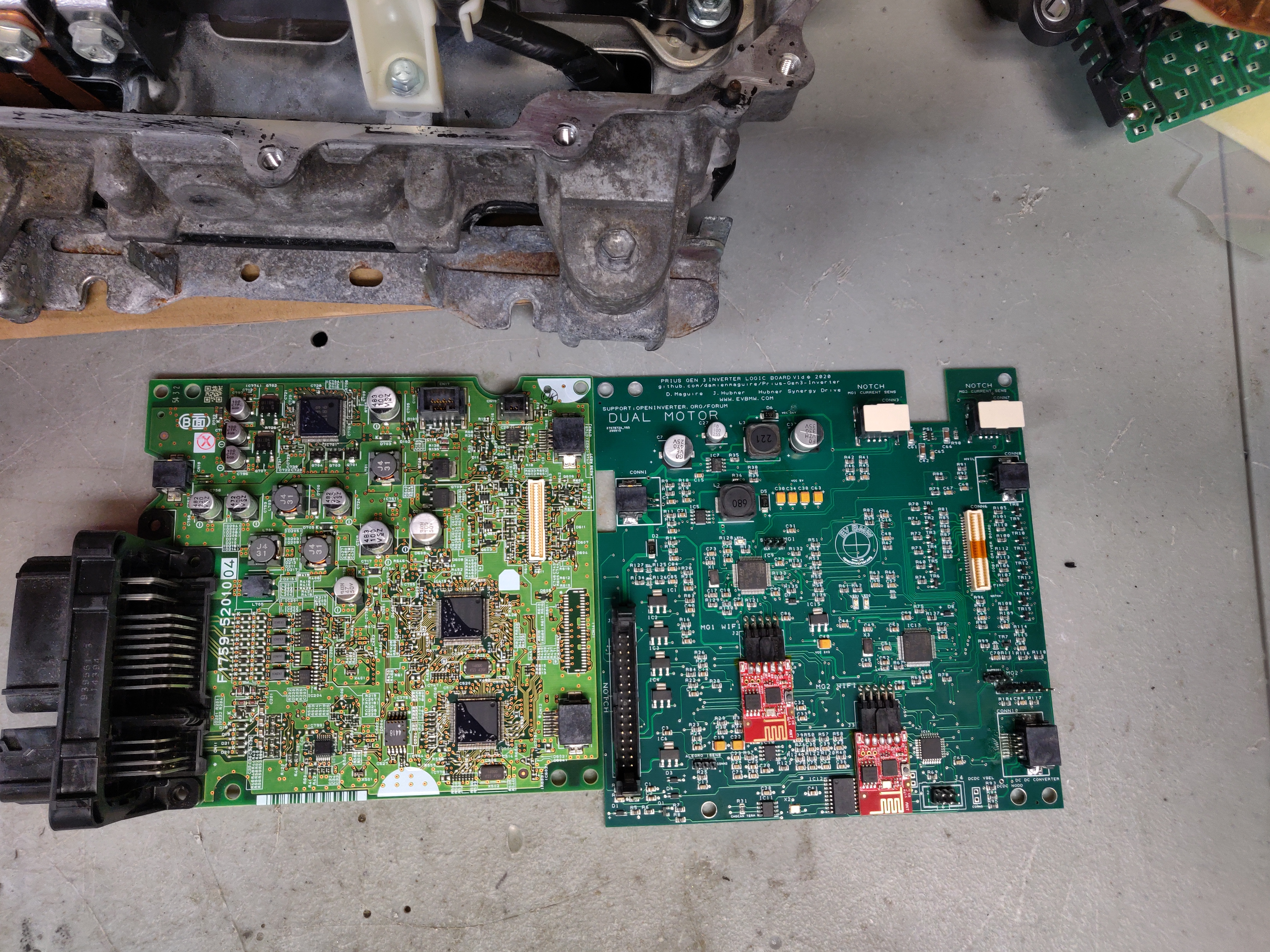

Re: Help! Prius C inverter Dual Motor Logic Board ...
i finished assembly brain board
and the size of the board is little big but that's not a problem

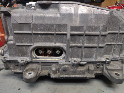

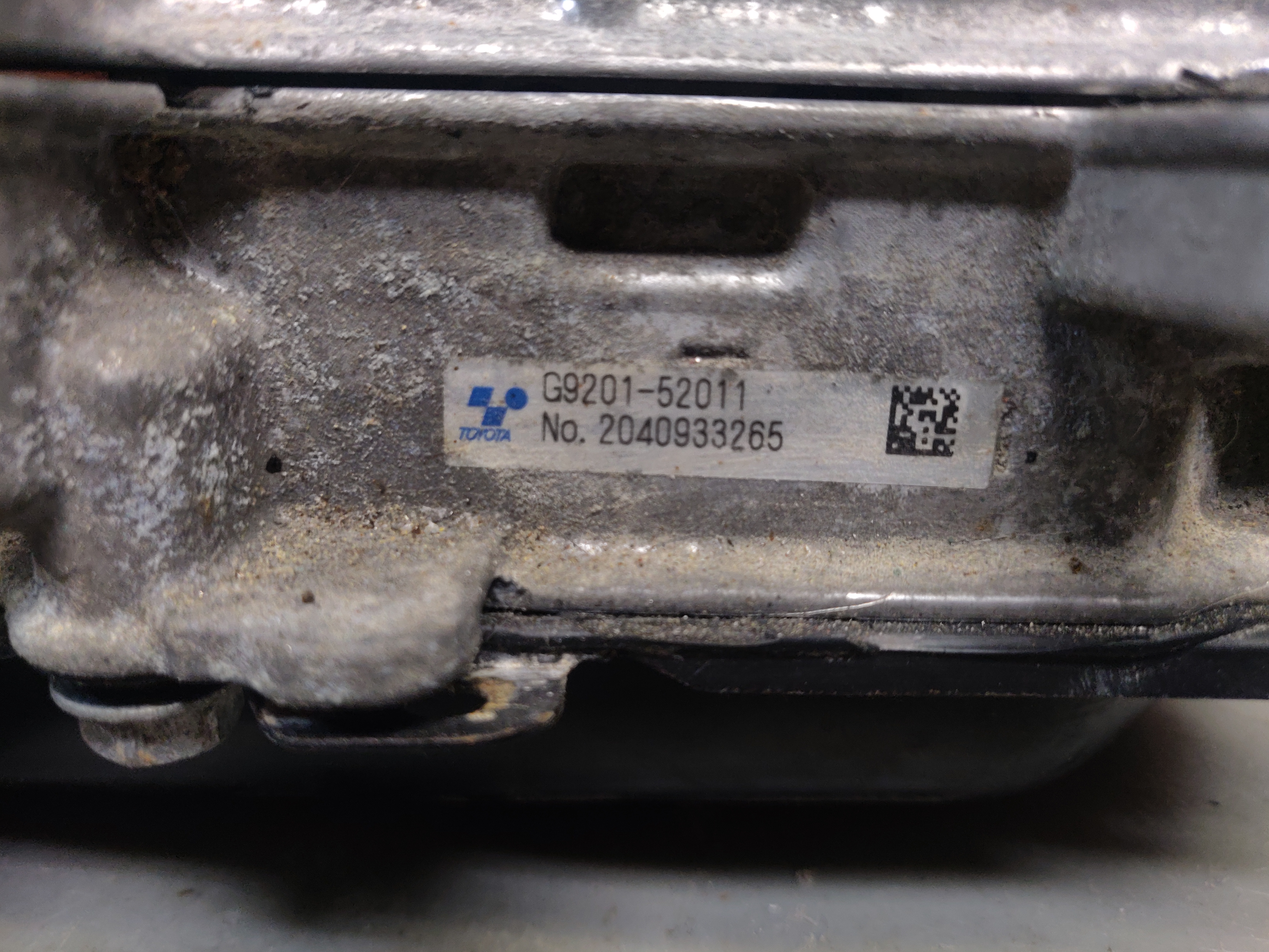

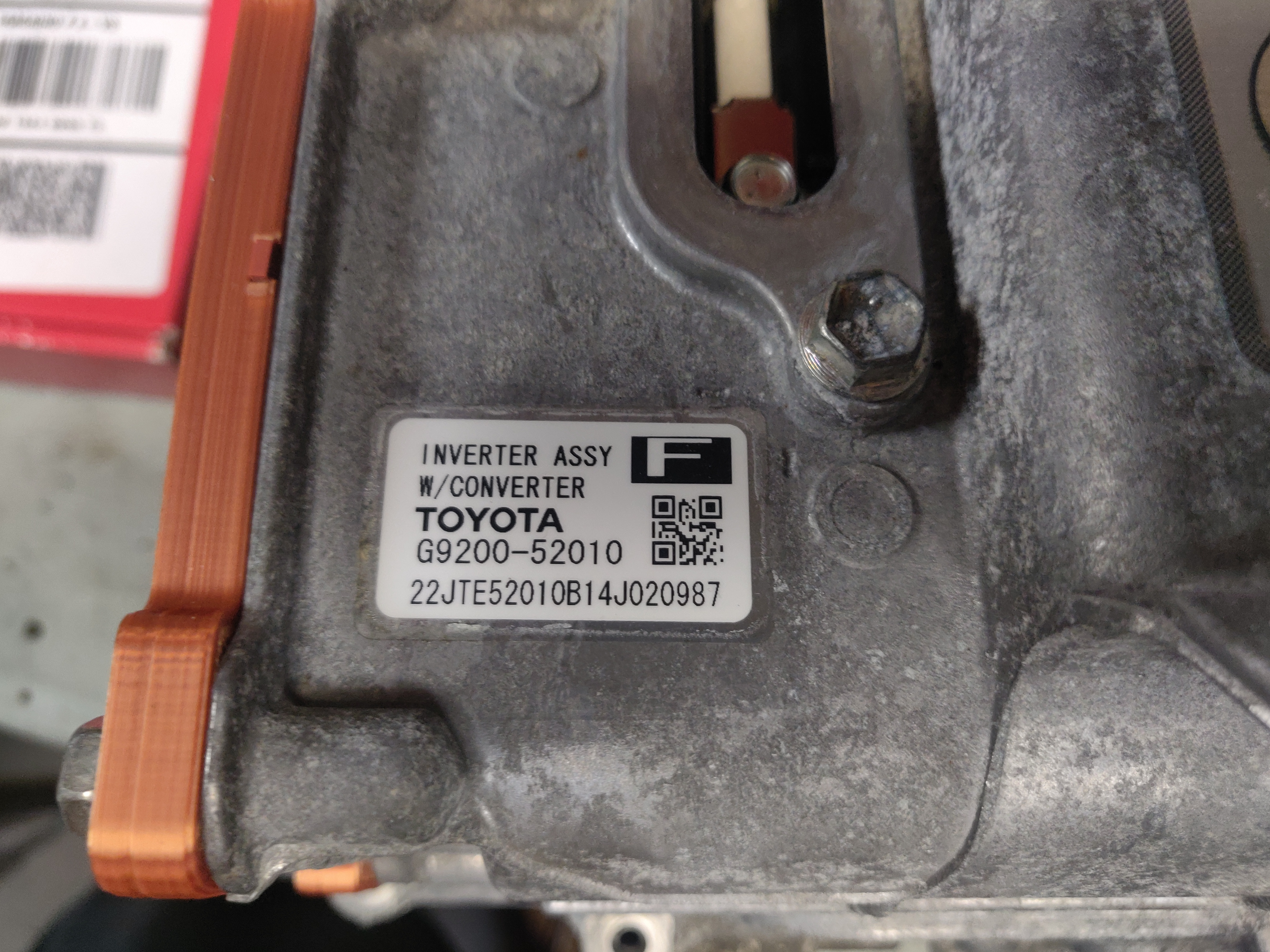

hi ...
i'm a little confused ...
I have 2015 toyota prius C invertor part number on pic can i use the control board ( Prius Gen 3 Inverter Logic Board Dual Motor Kiе Pri_G3_built_v1d ) with this inverter ???
