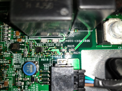

I have 2015 toyota prius C invertor part number on pic
can i use the control board ( Prius Gen 3 Inverter Logic Board Dual Motor Kiе Pri_G3_built_v1d ) with this inverter ???

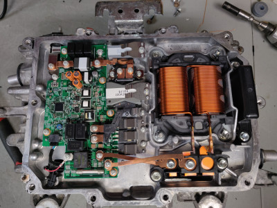

also i'm confused on which side to connect high voltage
somewhere in the photo and video on one side somewhere another side
which one is correct ???
pic #1 or pic #2
#1
#2

Pic 1 with the 2 connectors is DC and for the battery HV lines.
Pic 2 with the 3 connectors is AC and for the motor HV lines.
Wrong. Sorry

also I could not find the part number of the capacitor ???
which I need to install in order to be able to use Yaris inverter with an input of 400V DC
and as I understand it, I need to change 2 sets of 4 resistors: old 120kohm with new 210kohm (1%, 0.5W, 0805, Manufacturer part#: ERJP06F2103V Farnell #: 2326773 )
Top side: R629, R627, R625, R623
Bottom side: R630, R628, R626, R624
In USA found only Mfr. #:ERJ-P08F2103V this is a large package size but should fit...

sfk wrote: Tue Dec 15, 2020 3:33 am Pic 1 with the 2 connectors is DC and for the battery HV lines.
Well this is certainly wrong.
You can connect DC voltage to either of those, altough I think now it's recommended to use the ones in pic 2 because they are closer to where DC originally is connected to.
The motor connectors are at the top, not visible in these photos.
