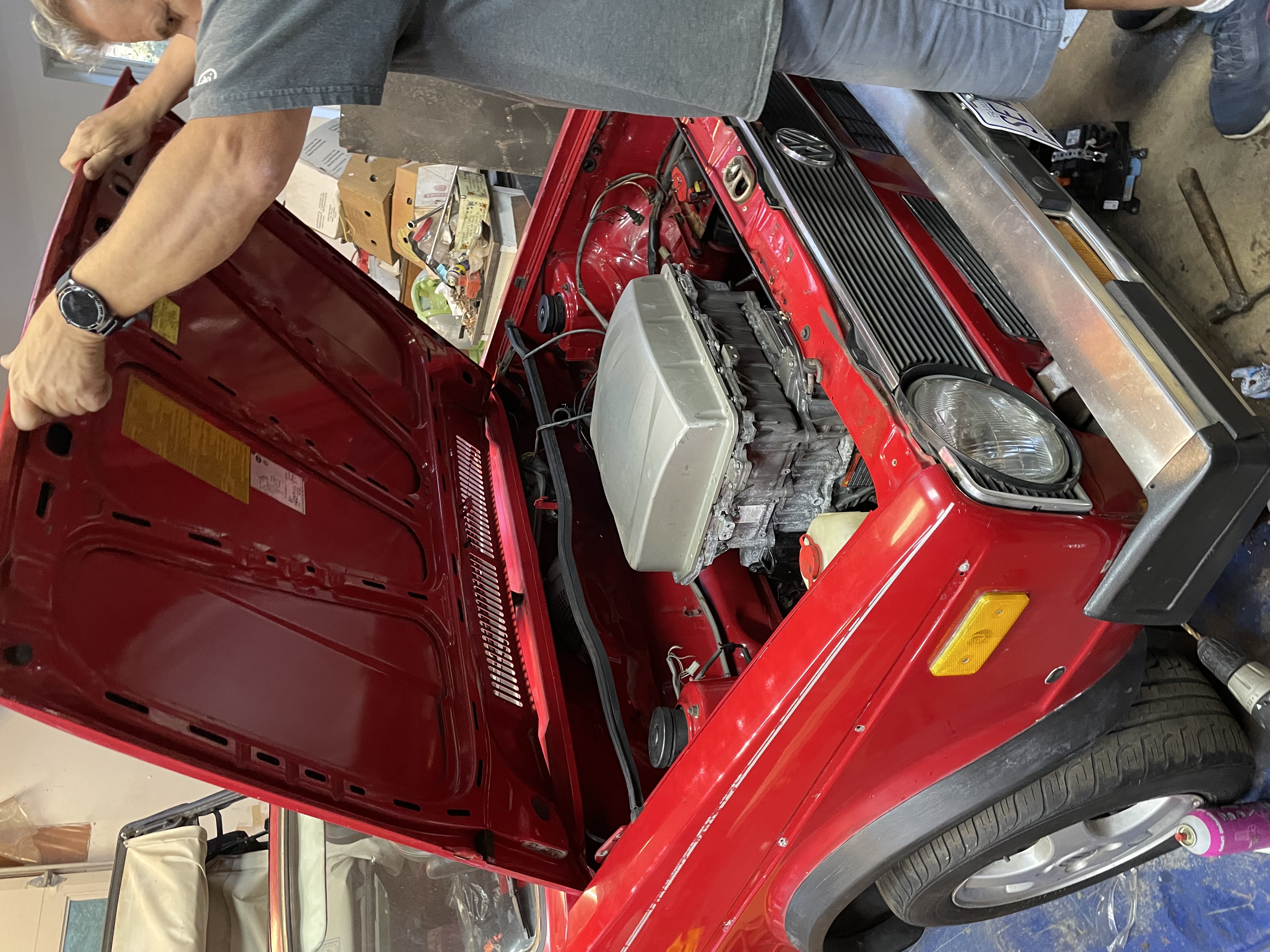

Might as well start a thread on another car I’m working on:
Mk1 VW cabriolet
here's the recipe:
building up the leaf stack to “drop right in”
-mount cable throttle sensor
-remove support bearing on leaf gearbox and change axle seals
-pop in the leaf-vw stub shaft adapters and type 2 conversion flanges
-mount & wire zombie VCU
-mount water pump
-fab HV line from battery to leaf stack with OEM connectors on each end
-fab motor mounts to stock vw locations
project goals:
  • make this a very quick turn around, a few days at max.
  • develop cast aluminum leaf motor mounts to early fwd VW's
  • prove the simplicity of the zombiverter and open inverter platform
  • show ev conversions can be done on the cheap! (budget is under 5000$ CAD)

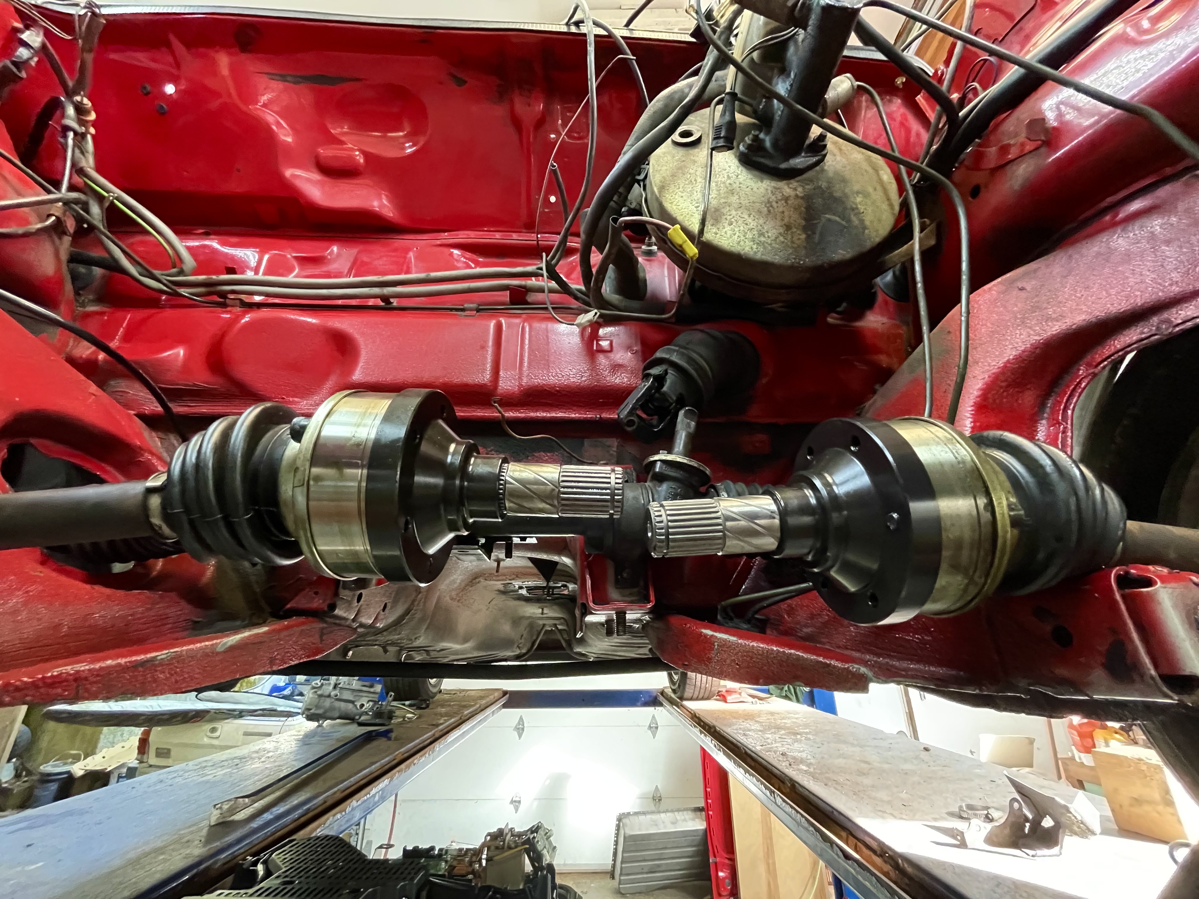

Re: (Wip)Leaf swapped vw golf cabriolet

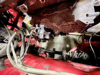

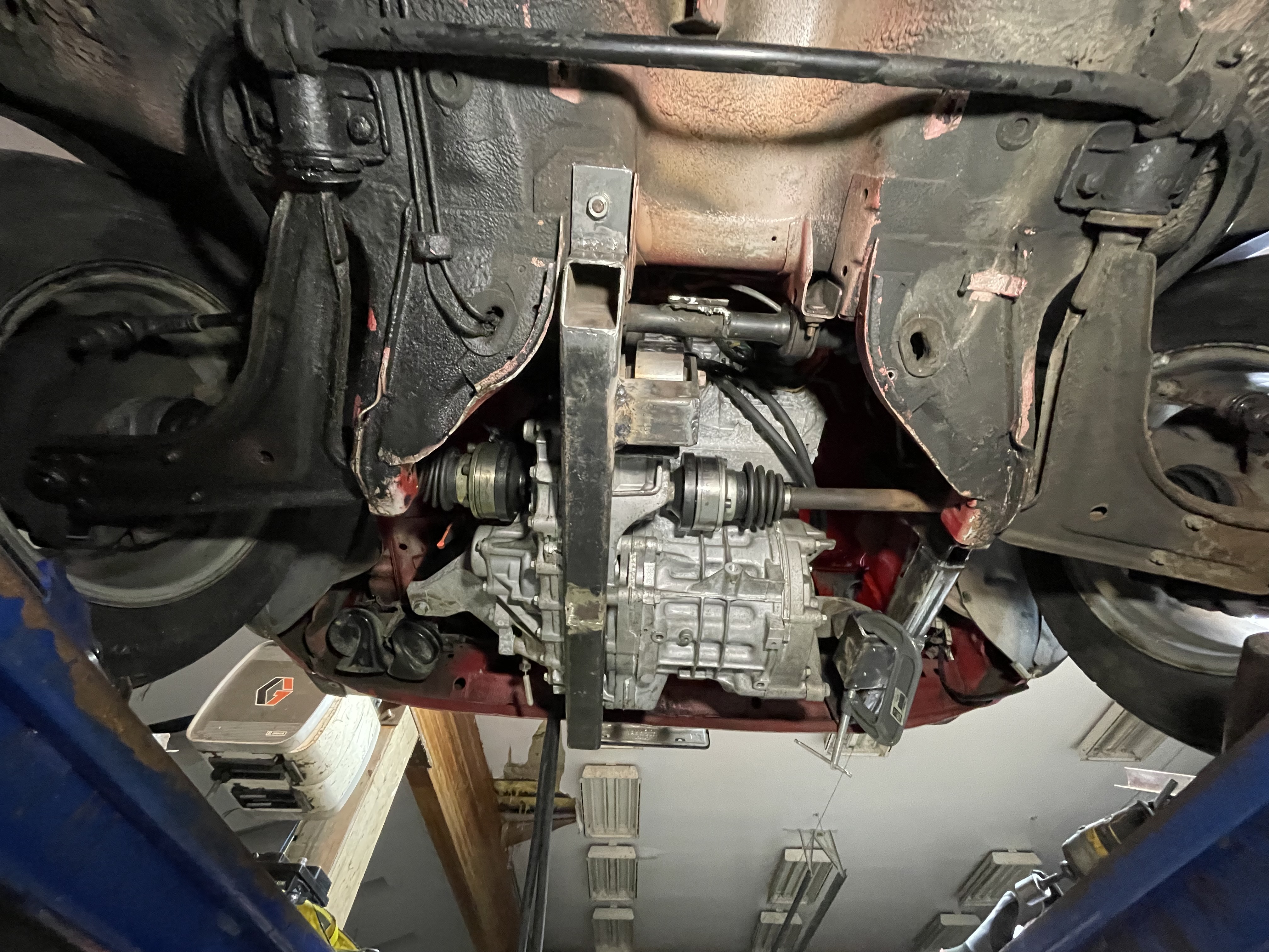

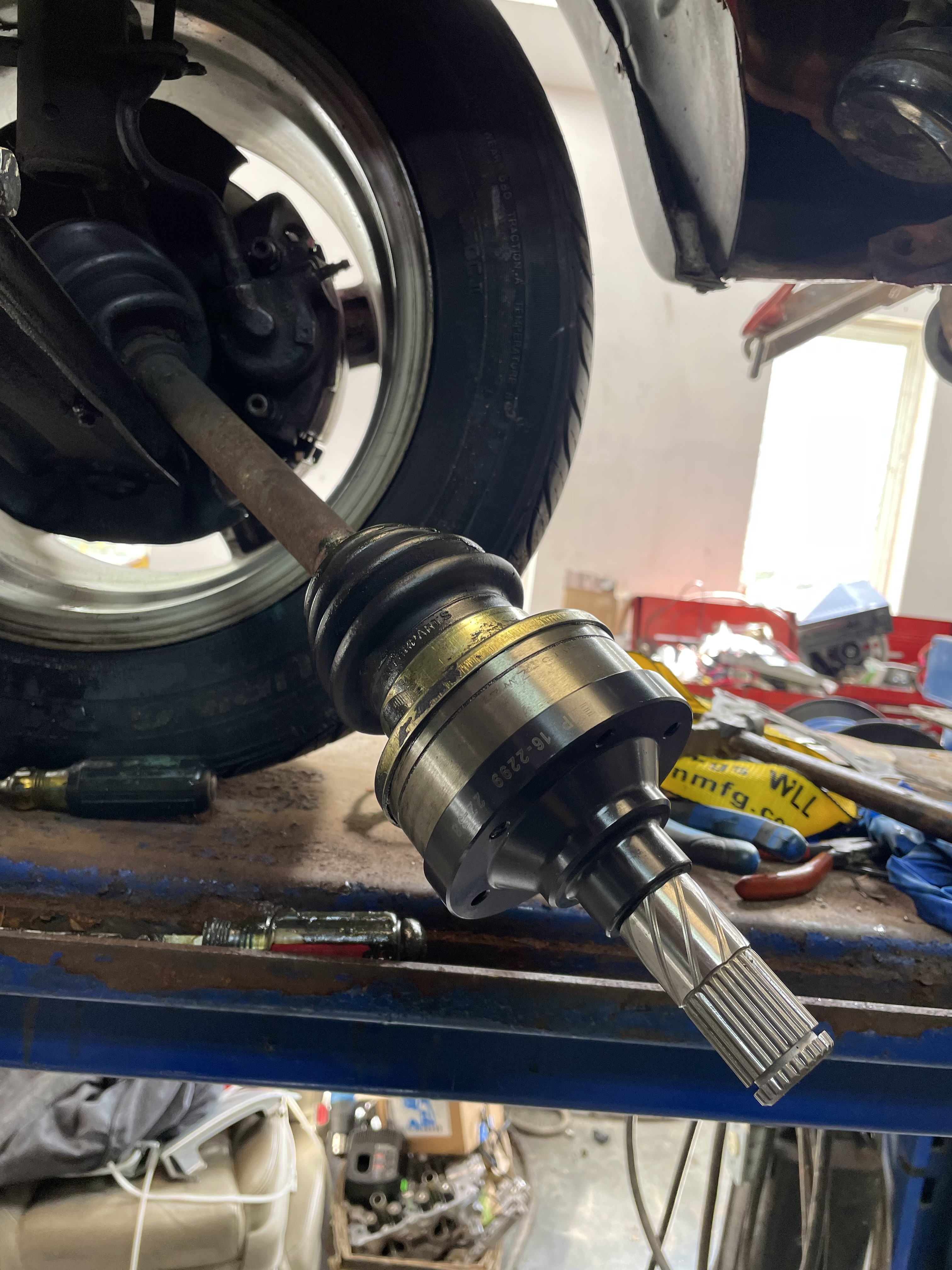

Got the 2 side motor mounts mocked up!
The leafs torsional mount is on the back of the gearbox, so I’m going to make a cradle that wraps underneath the gearbox. the cradle will mount to the front beam in the engine bay and the engine mount just below the firewall. the leaf mount will then float on that.
and it fits! axles connected and are at happy angles, Pdm clears the hood!

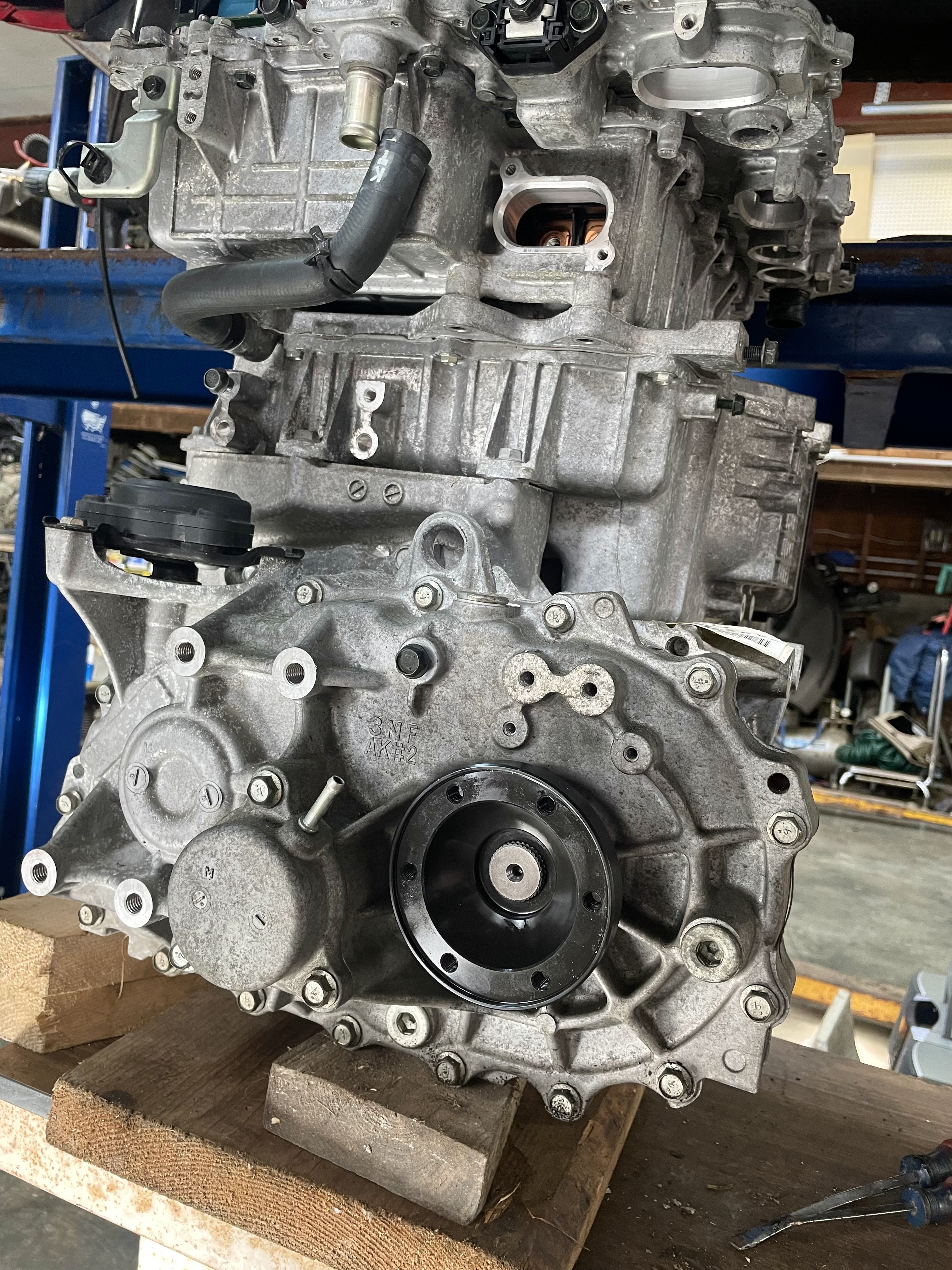

for the drive shafts, I removed the inner carrier barring from the leaf stack, pulled the seals and replaced them with 56x36x8 shaft seals. 56mm is the bore id on the leaf, 36 is the od of the vw flanges. after that popped the stub shafts in and slid on the flanges! Then the vw axles just bolt right up to the leaf gearbox!
also swapped the power steering rack for a manual one 💪🏽

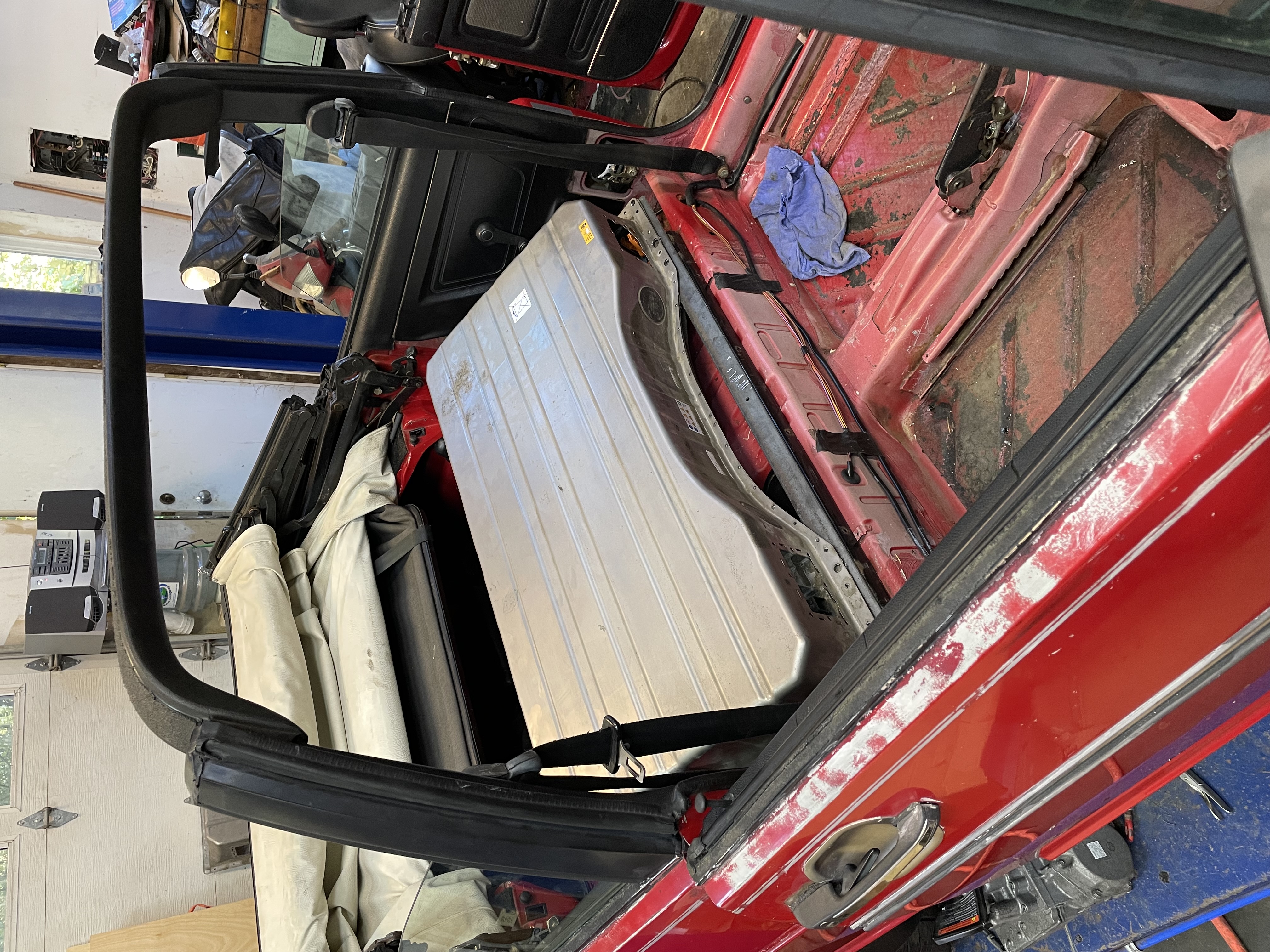

Re: (WIP)Leaf swapped vw golf cabriolet

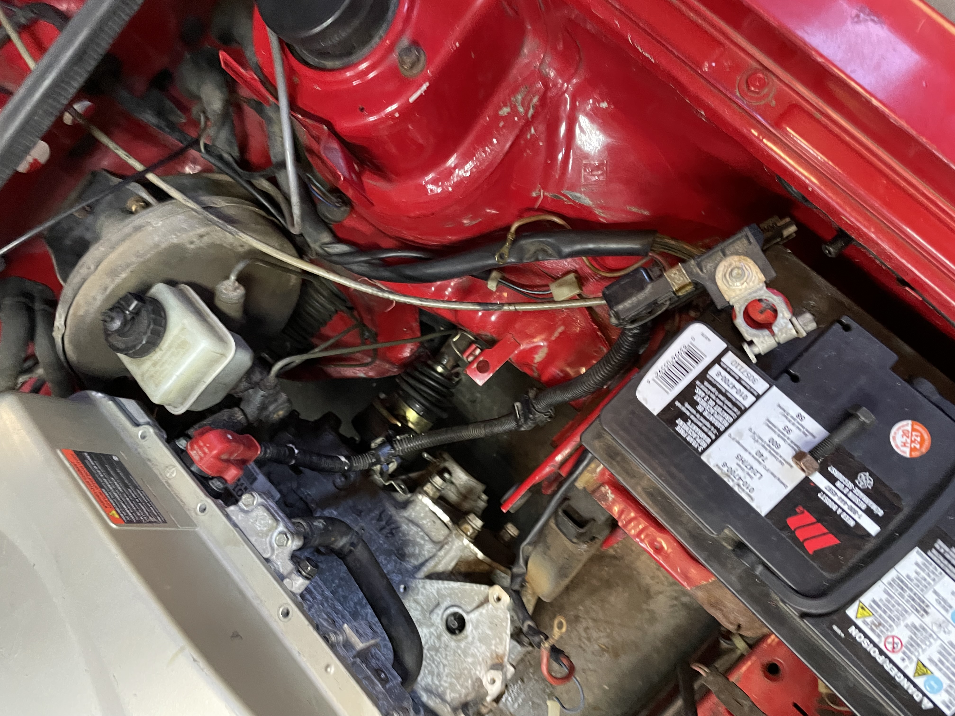

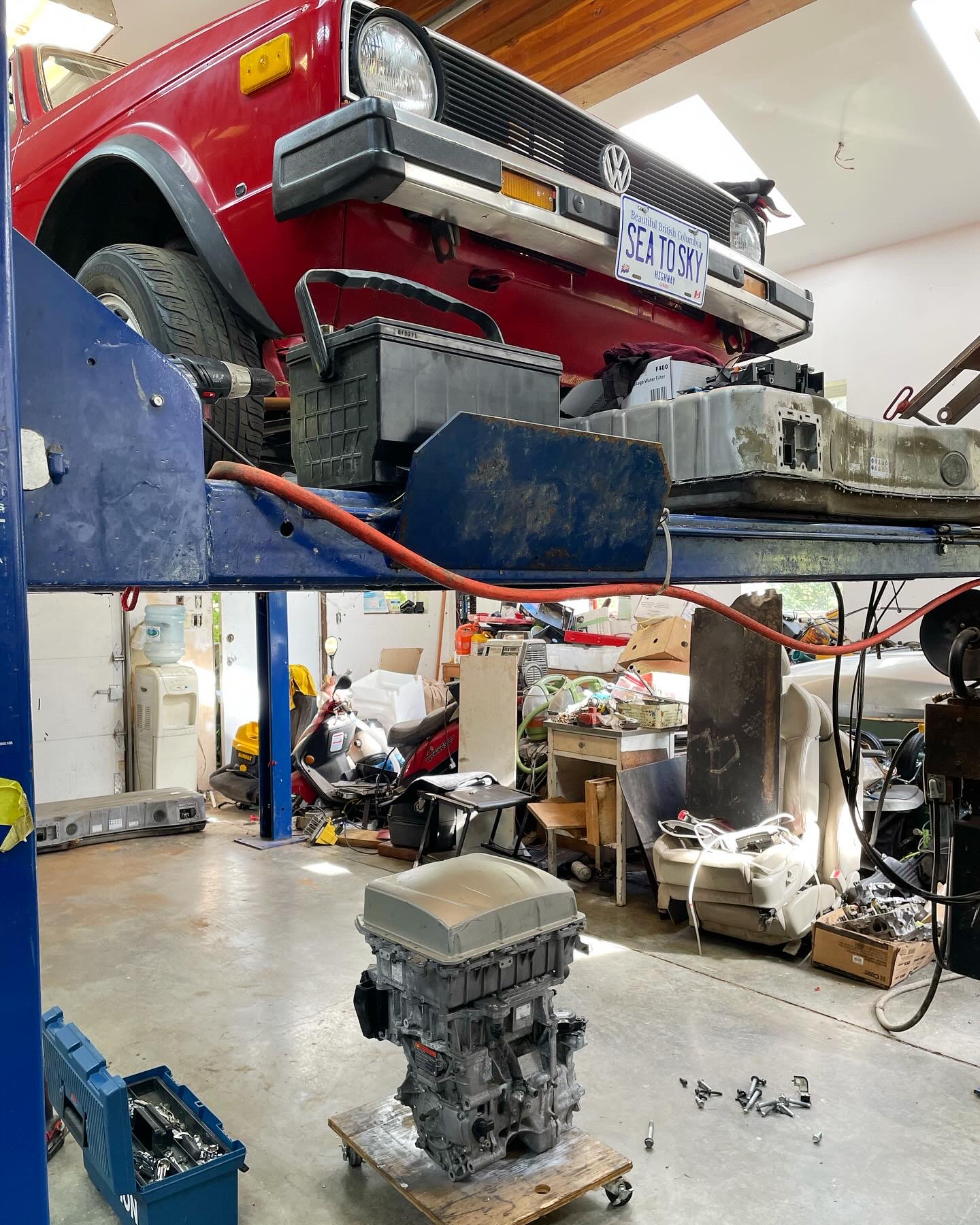

Smart two four battery mounted. Pretty simple frame!
Just some angle iron and a few tabs.
leaf 12v line/fuse terminal fits perfectly to the stock 12v battery location as well

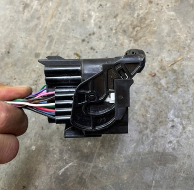

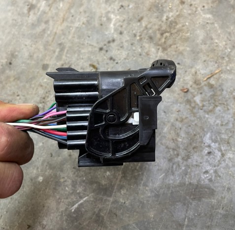

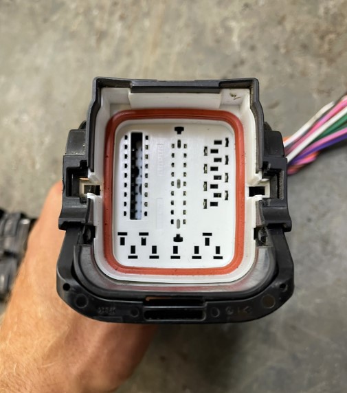

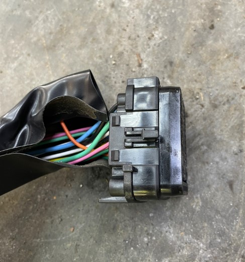

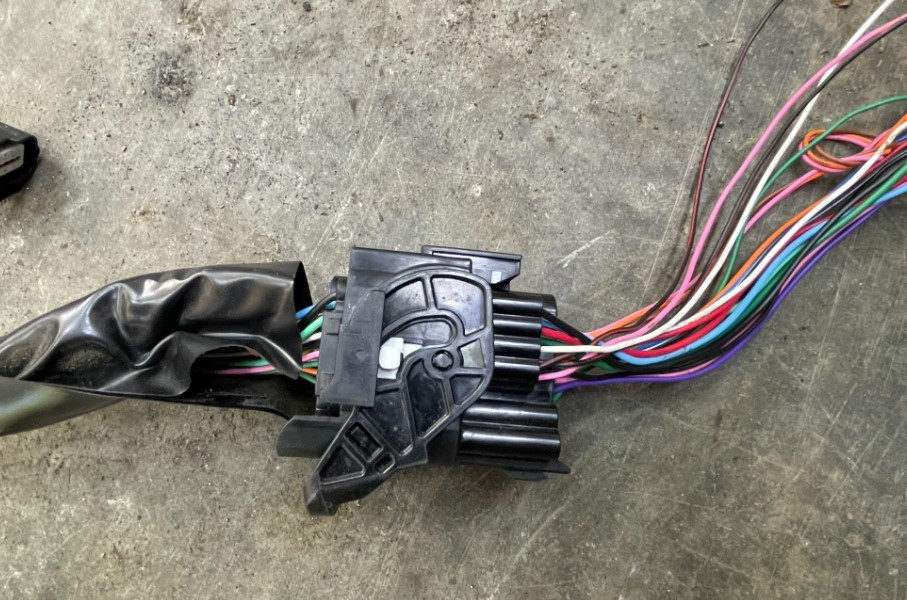

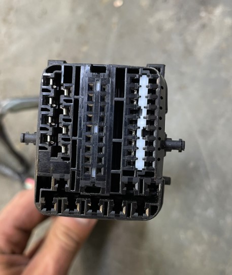

looking to hunt down the leaf stack harness connector
would enable using the stock stack harness, would make for a very clean install!
heres the side thats on the stack harness
fully mated

yes thats the plan is to make some cast aluminum ones, keep the weight down. and will be very clean install! for sure.
themoe wrote: Wed Oct 11, 2023 12:40 am Also, were you able to get axles to fit without cutting them? If so, that's amazing.
yes, my leaf gearbox stub adapters allow stock vw axles to bolt up un modified

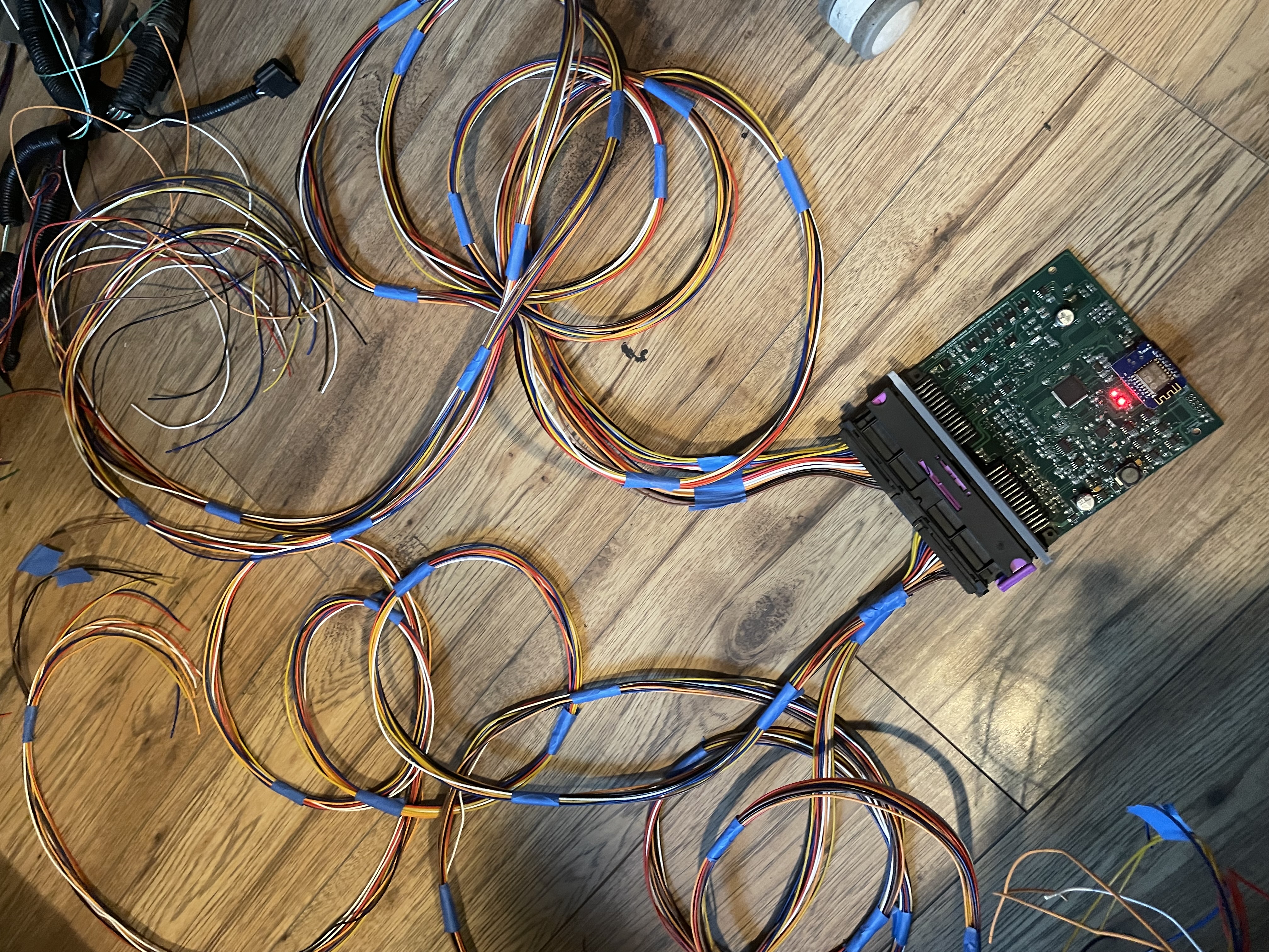

zombiverter and housing is in. all built and programed. i have to say, im not a fan of this aliexpress connector/header. its a bit cheap, and mine is missing gaskets. had to bend pins and what not to get it to seat properly.
i may make a revision with the molex header...
this is a lot of wire, I wont get the pre populated header again! id much rather crimp m own wires

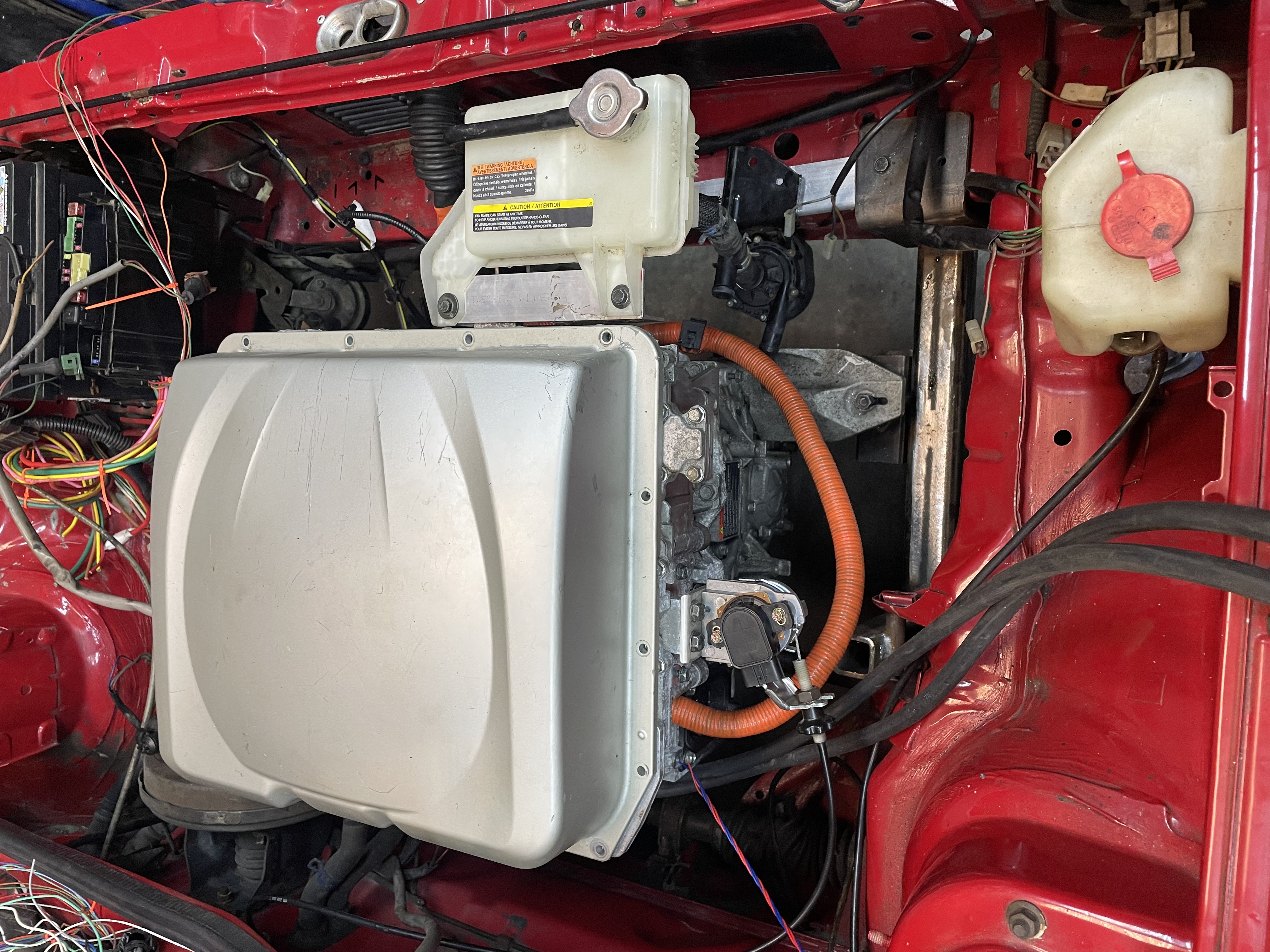

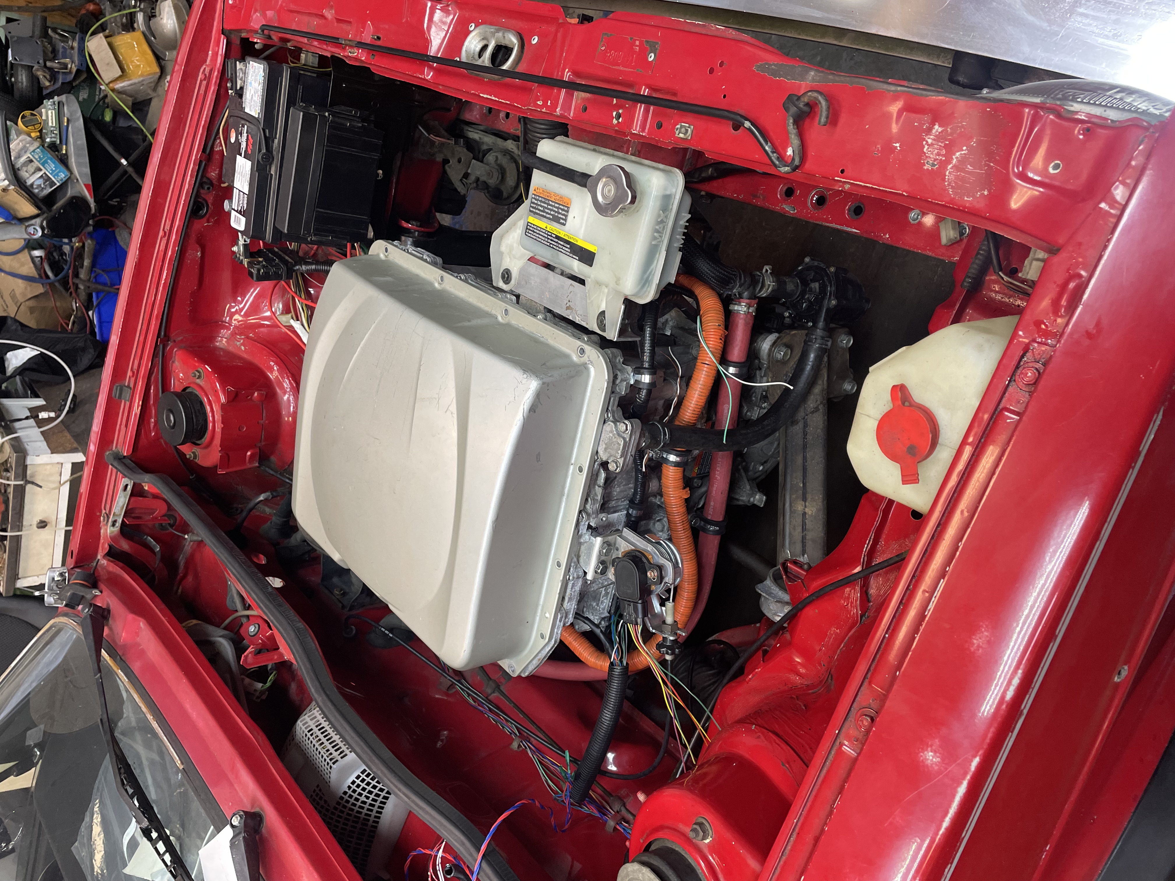

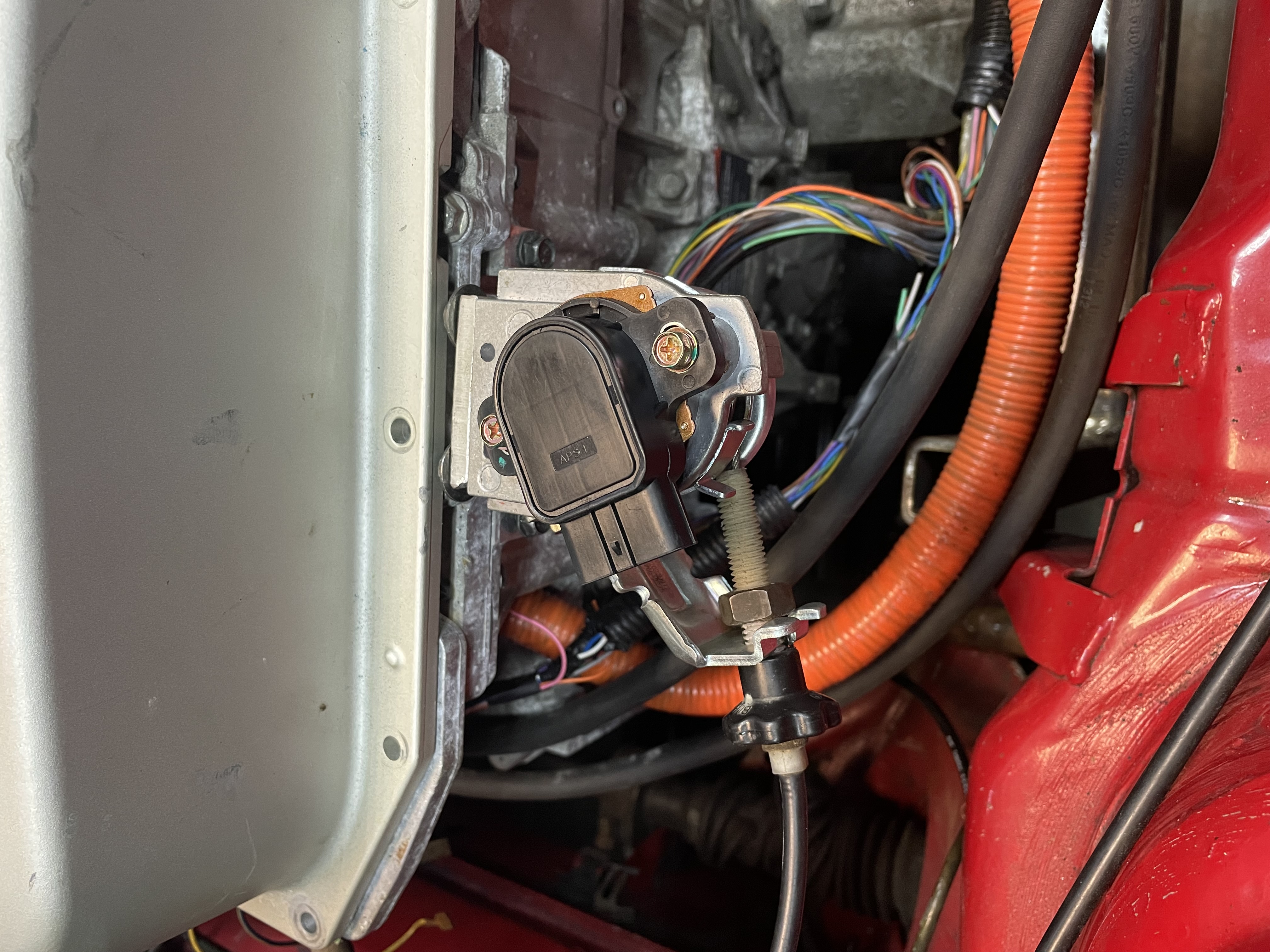

Honda throttle sensors mounted on the side of the leaf.
Melted off the plastic end on the stock vw throttle cable, will have to make a bigger crimp/end for a secure connection on the sensor cam.
for the 12v wiring, re used the leaf battery tray, relay box and 12v cables.
Stock leaf coolant tank mounted and water pump.
coolant series loop through the heater core with some 3/4 hose.
bottom cradle is mostly done.
Links from the body mount near the driver side lower controller arm bushing, to the beam spanning across the front.
Then the gearbox bushing bolts to the cradle.
It also acts as a skid plate for the gearbox, as it dose sit a little low.

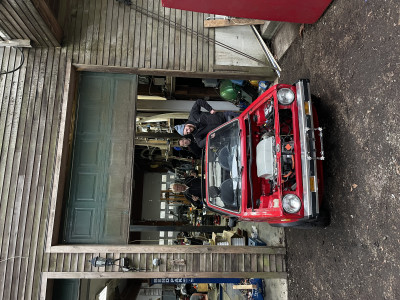

next up is mounting the zombie where the original ECU was under the kick panel on the passenger side. Then clean up lv wiring.
went for a quick test run, all the power in forward, almost no torque in reverse, could barely get it off the lift

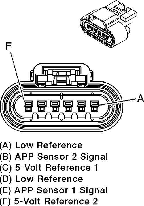

honda accelerator pedal position sensor matting connector looks to be a 6189 1083 sumitomo
a common connector across many different vehicles including subaru throttle pedals.
Posts: 1080
Has thanked: 222 times
Been thanked: 413 times
honda accelerator pedal position sensor connector is actually: sumitomo HX040 6pin
you can get them here for aiexpress https://www.aliexpress.com/item/1000036 ... 18028ugFu4
pinout for the sensor is

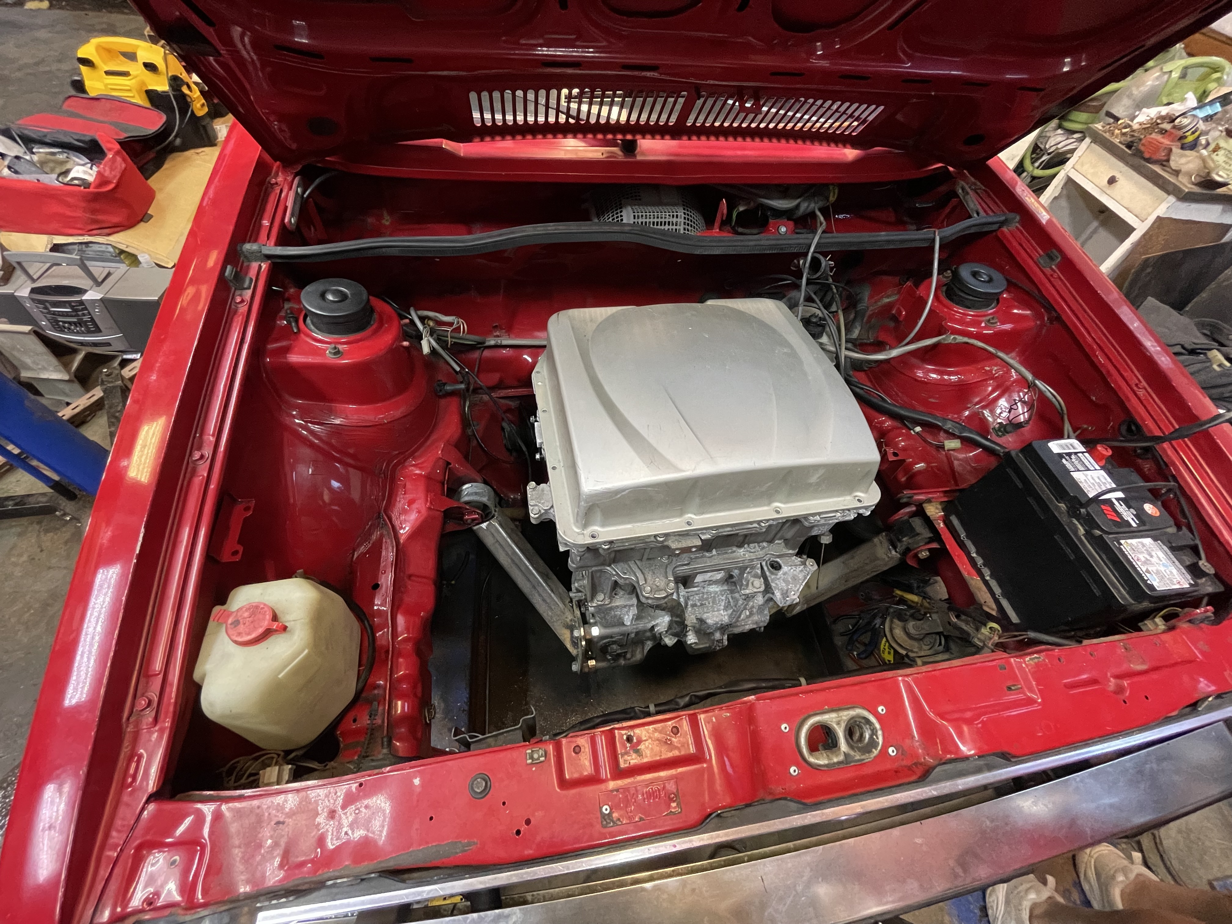

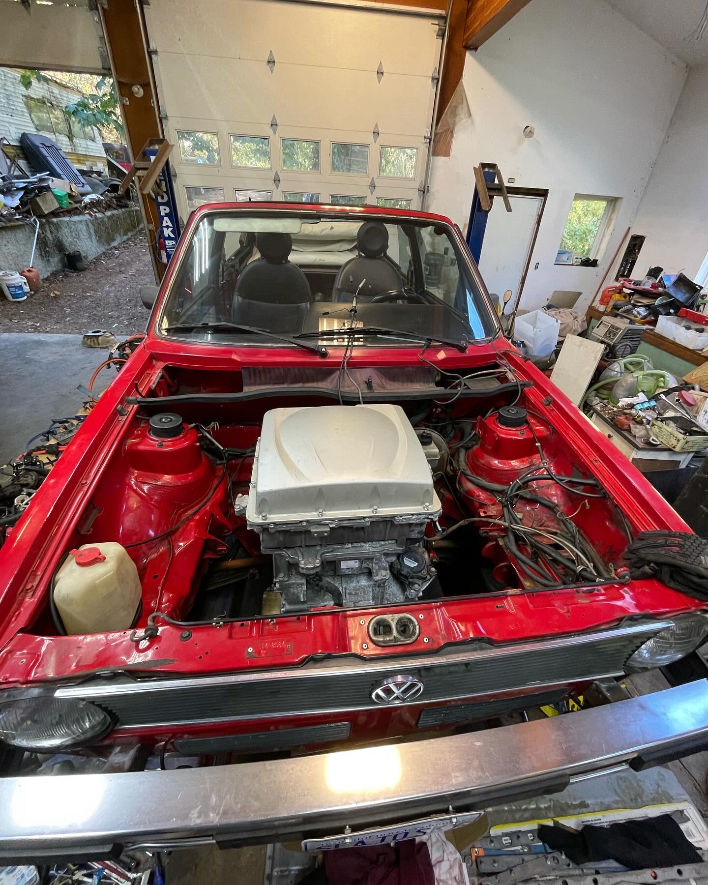

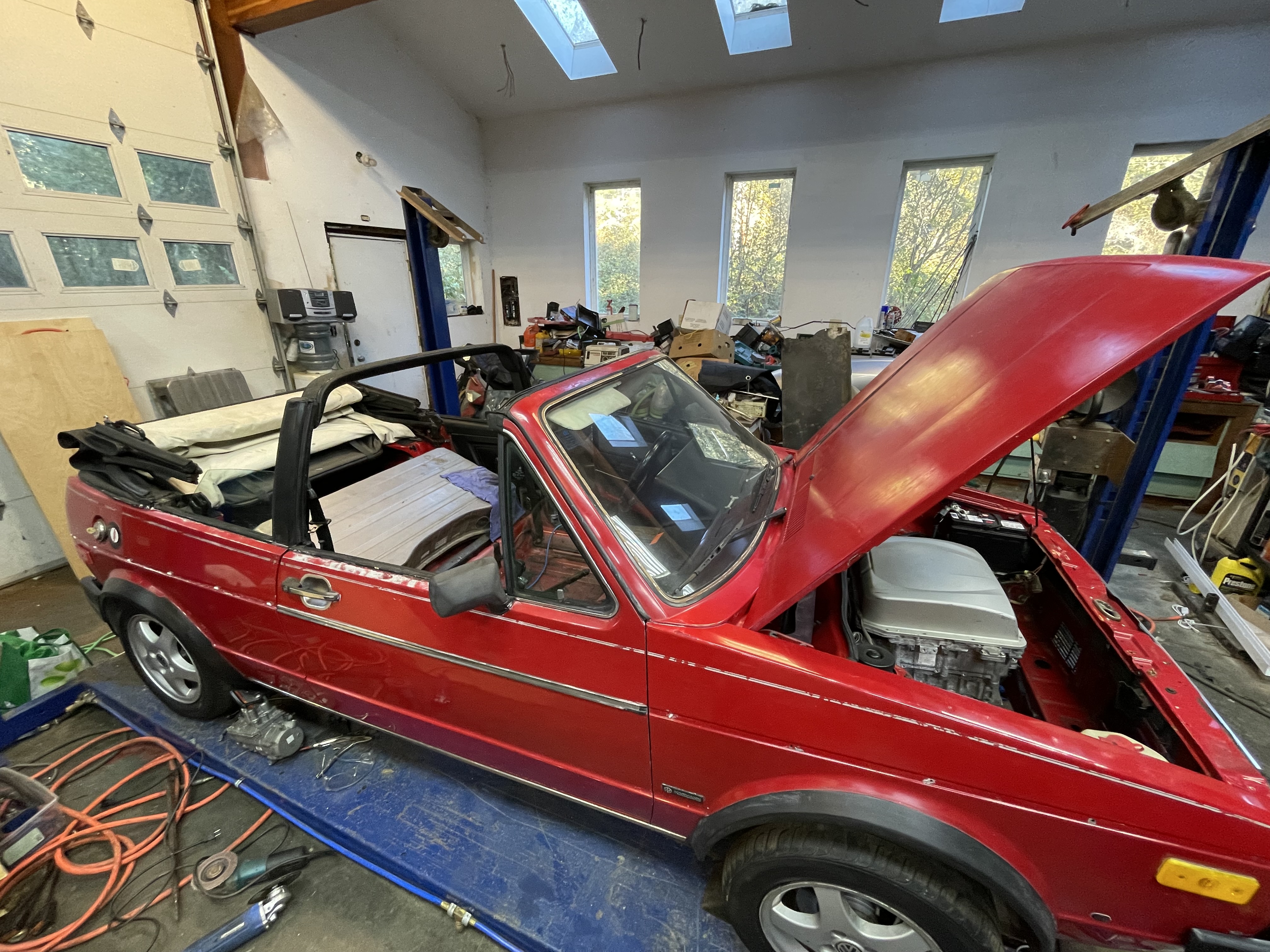

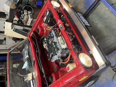

cleaning up wiring, coolant, etc. engine bay is 99% done
hv battery and interior wiring next and then off to the races

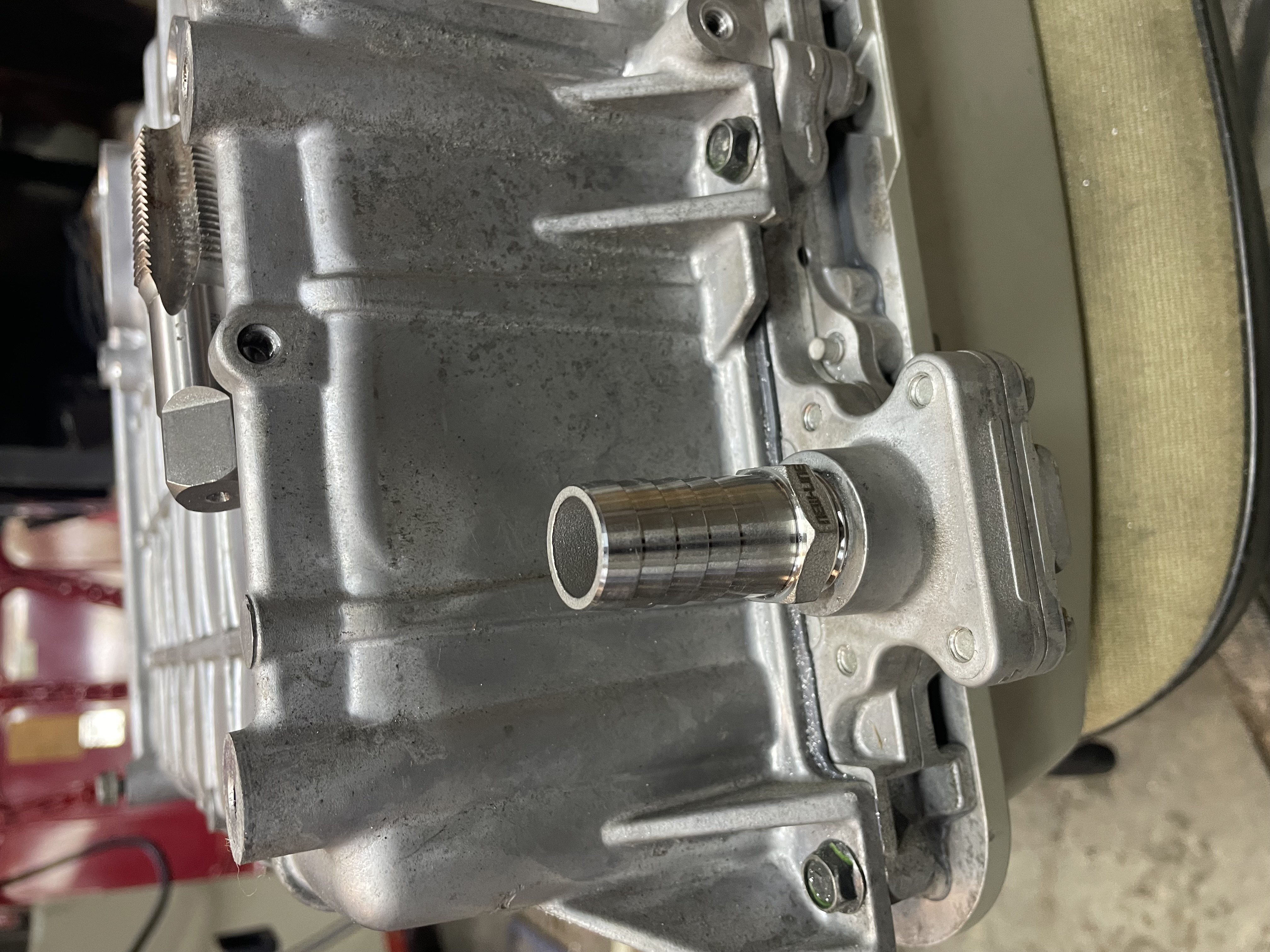

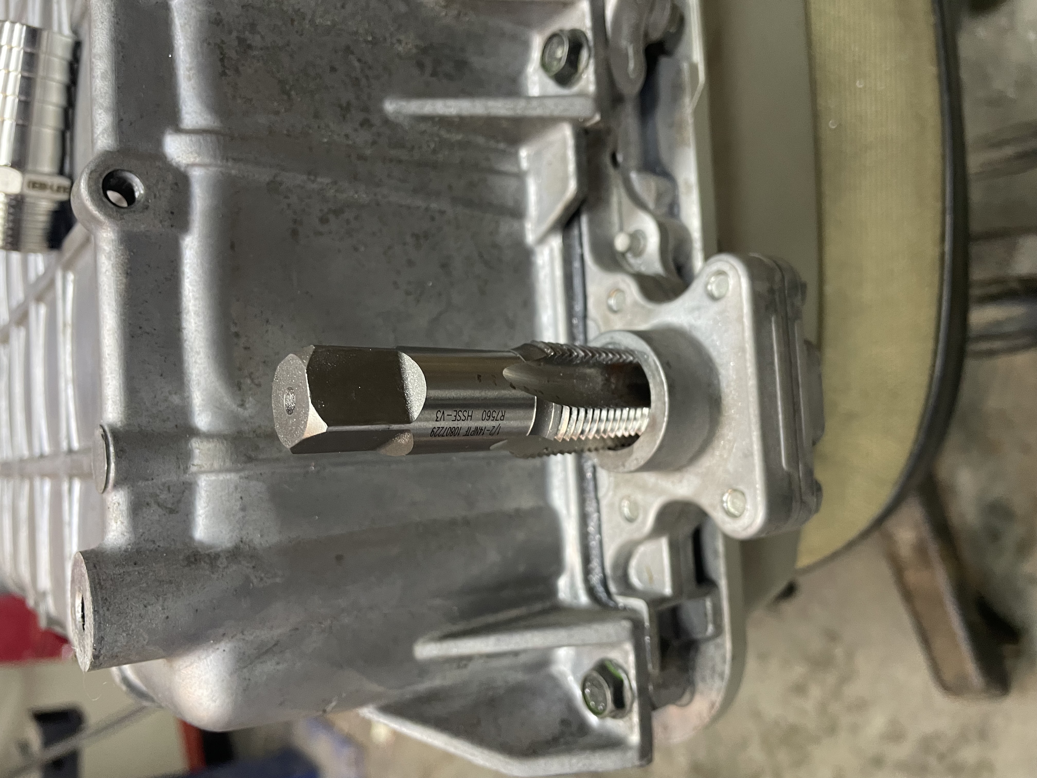

Tip on if your pdm is missing a coolant spigot, 1/2 npt tap fits perfectly !
