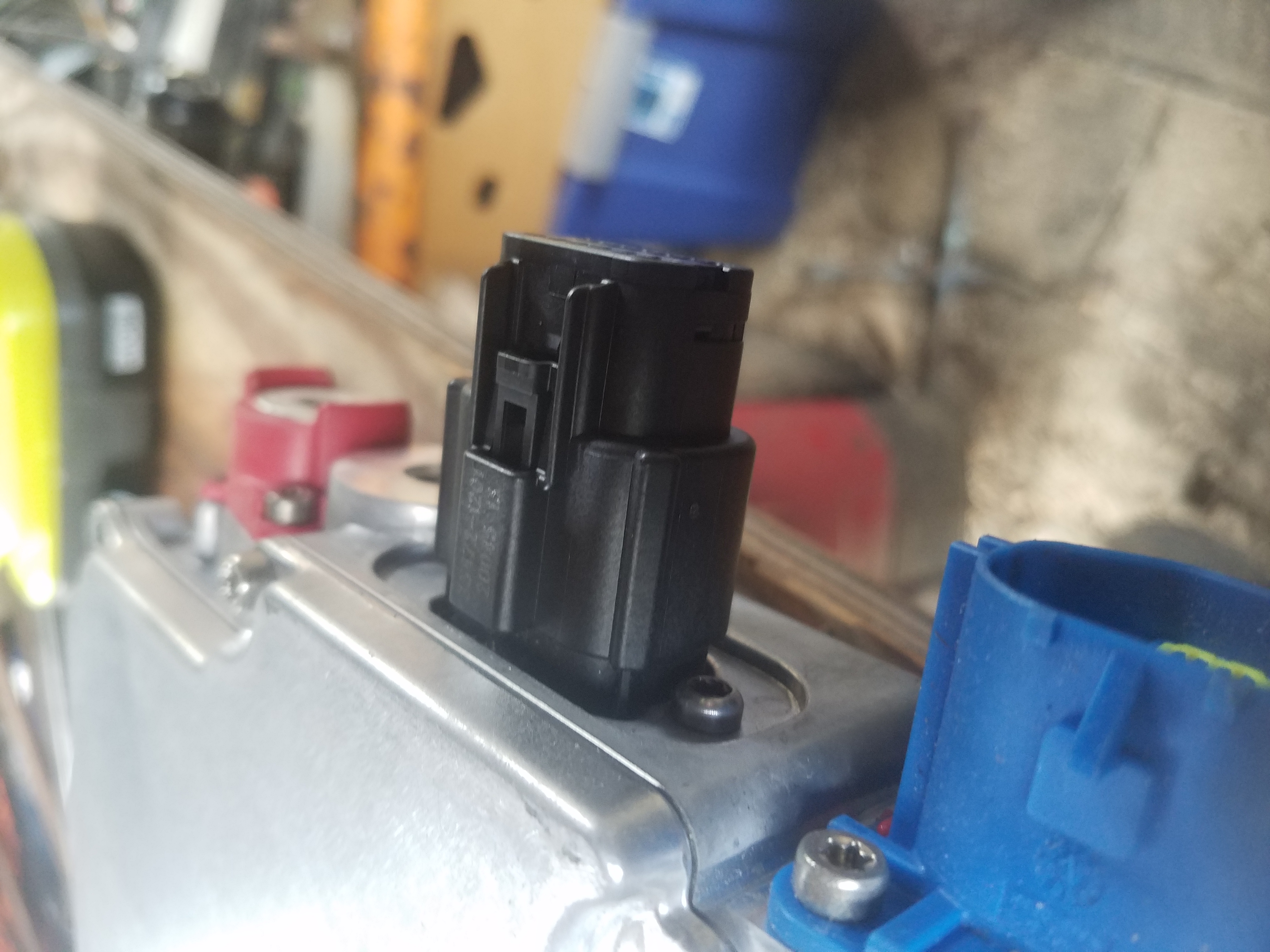

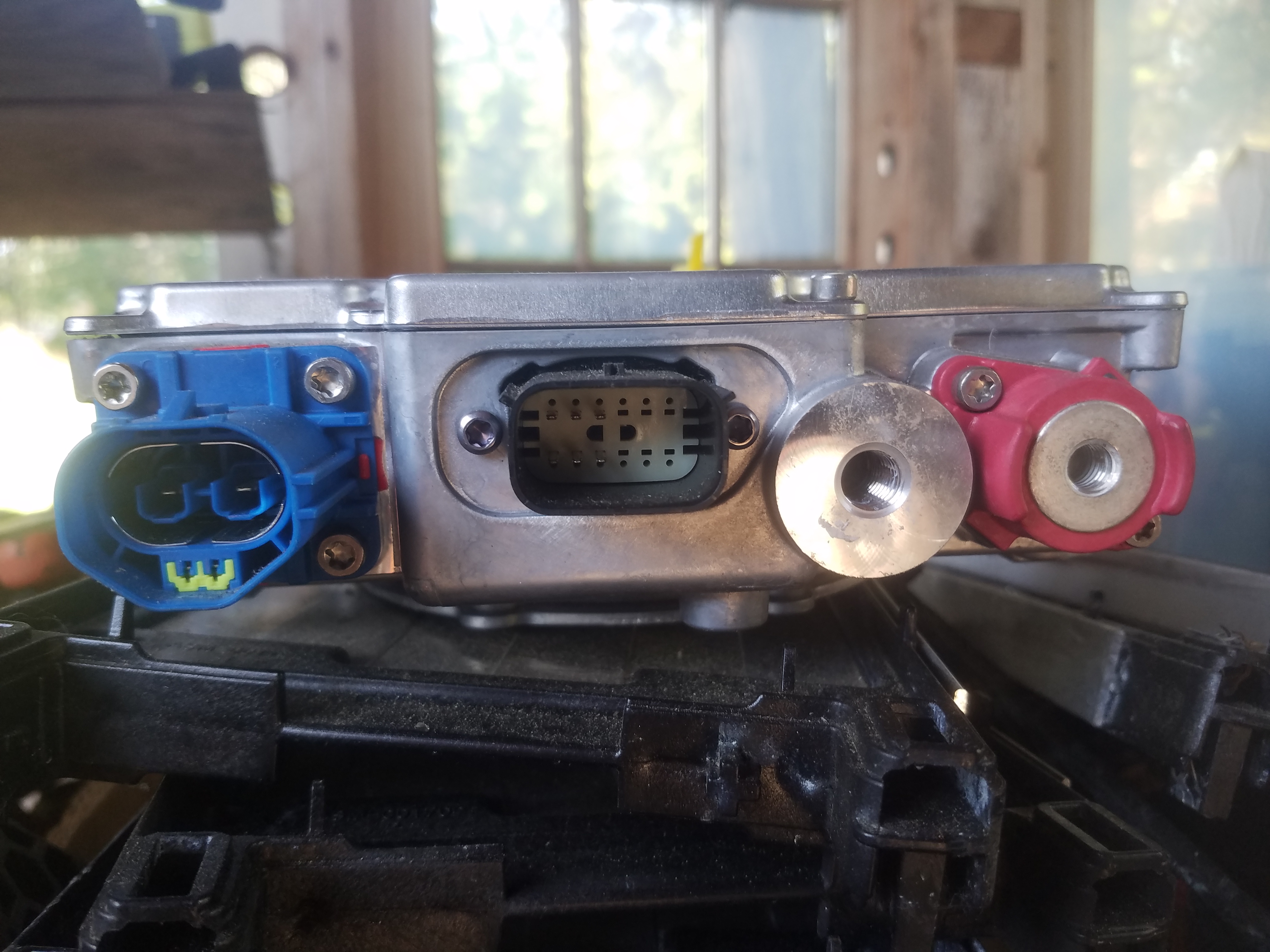

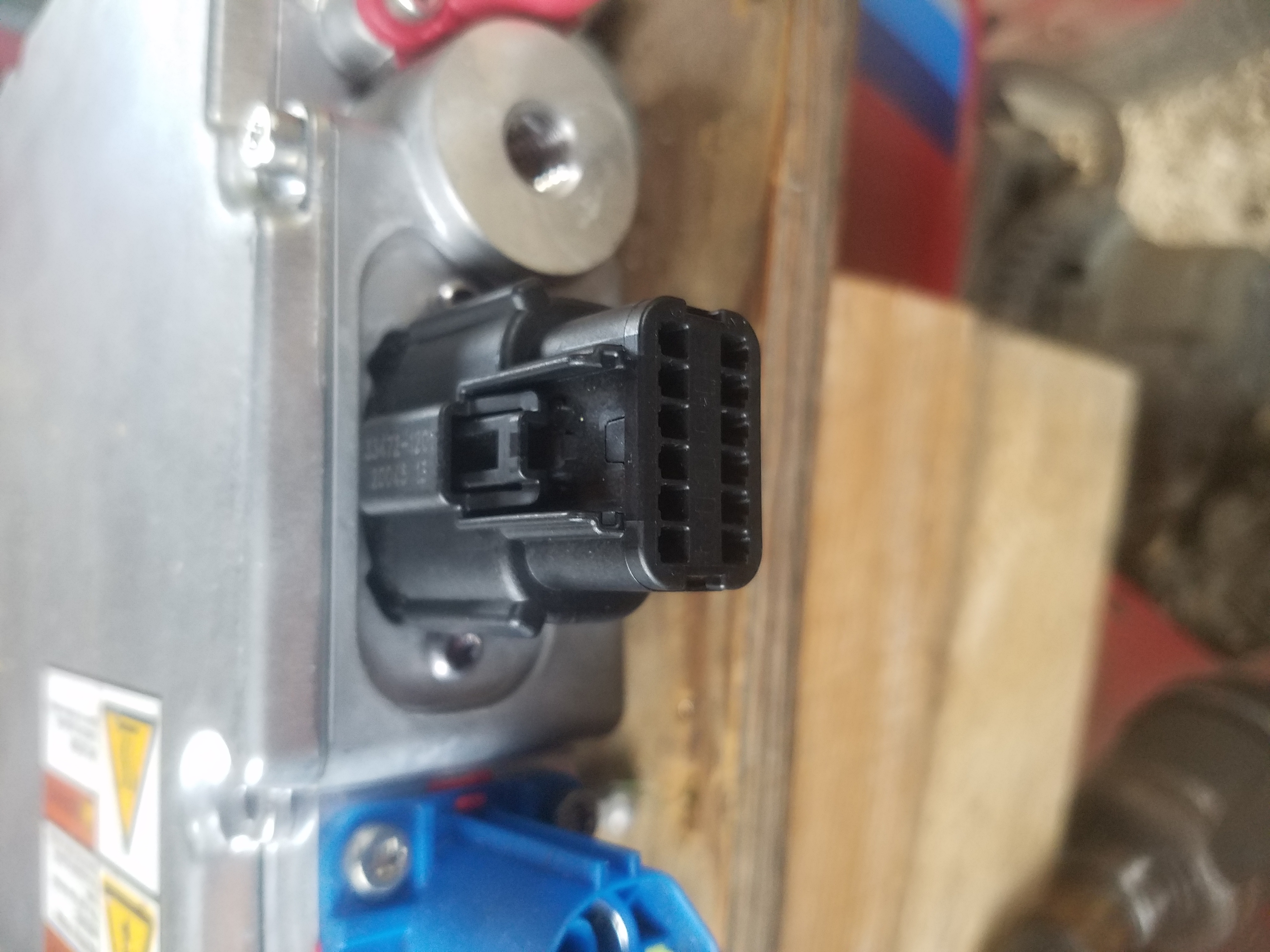

yeah anyone know anything about these connectors. Really wish I bought one already with the connectors but I didn't. can any one get me going with a part number or something?

I'm not familiar with the Tesla DC-DC converters, but it might fit with this Molex connector:

Works great. Now I got to find some pins. Bought some for my amp seal 23 pin ms3 connector that I do not plan on using. Maybe they will fit? Gotta go check. Thanks for all the help!

Re: Tesla DC to Dc Deushte connectors
Any Idea what size socket crimp connector pins I should buy? I think I found them on the molex website just not sure what awg to buy.evcar wrote: ↑Sun Aug 09, 2020 11:55 pm I'm not familiar with the Tesla DC-DC converters, but it might fit with this Molex connector:

I think I found them and I just ordered these. opened up the dc to dc converter and the wires had 22 awg written right on every wire.

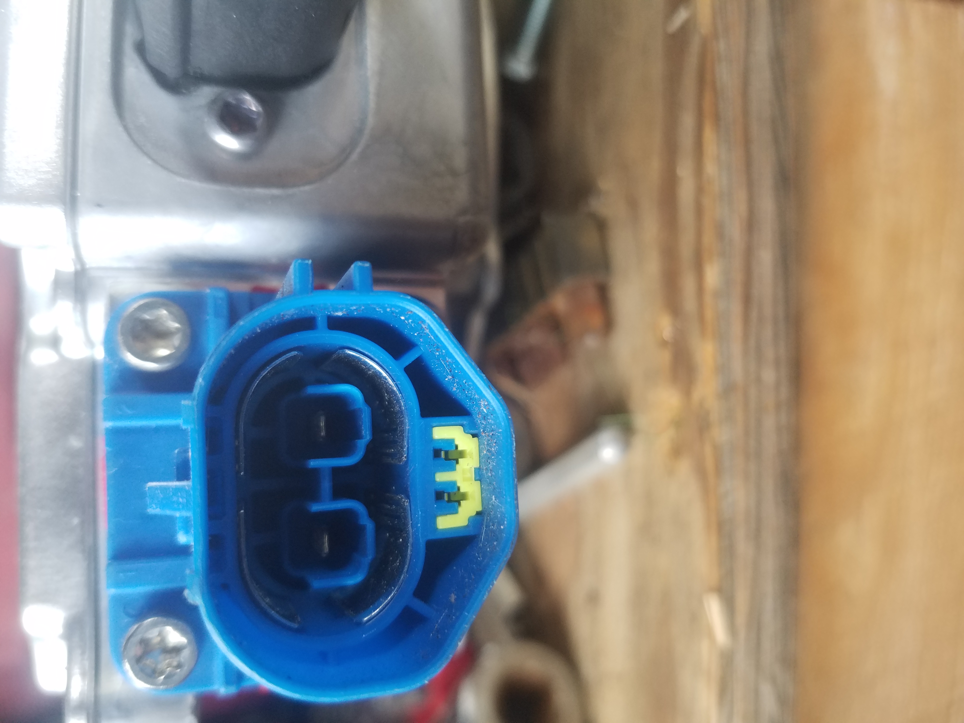

Ok so the part slid right into my dc to dc. That felt great! However, now I got a new problem. It will not plug into my HVFJB (High Voltage Front Junction Box). So now I am guessing that my model years of my componants are all from a newer model model s? Darn, so either got to start splicing wires or possibly buy a newer dc to dc. Really like the idea of keeping everything plug and play as much as possible. Last electric car I built caught on fire because I was a little too sloppy. Trying to do a lot better this time around.

Ok so I figured out why my new dc to dc converter hv connector wont fit my hvfjb. The company I purchased my second dc to dc converter (S/N 1028665-00-C) from accidentally sent me the same earlier model I already have. Totally just realized that it was not the same as the dc to dc converter photo that was on the Ebay listing. So I let them know and they were pretty cool about it. Gonna ship it back tomorrow and hopefully have the model I need soon(S/N 1026650-E). Haha I am glad I got it figured out.

Nice I got it to plug in Finally. Now onto other deushte connector problems to solve...

Just for completing information here:
I sourced the plug at digikey for like 3,5 USD per piece:
viewtopic.php?f=10&t=536&start=10
PART: WM13161-ND
MFG : Molex / 0334721301
DESC: CONN RCPT HSG 12POS 3.50MM
