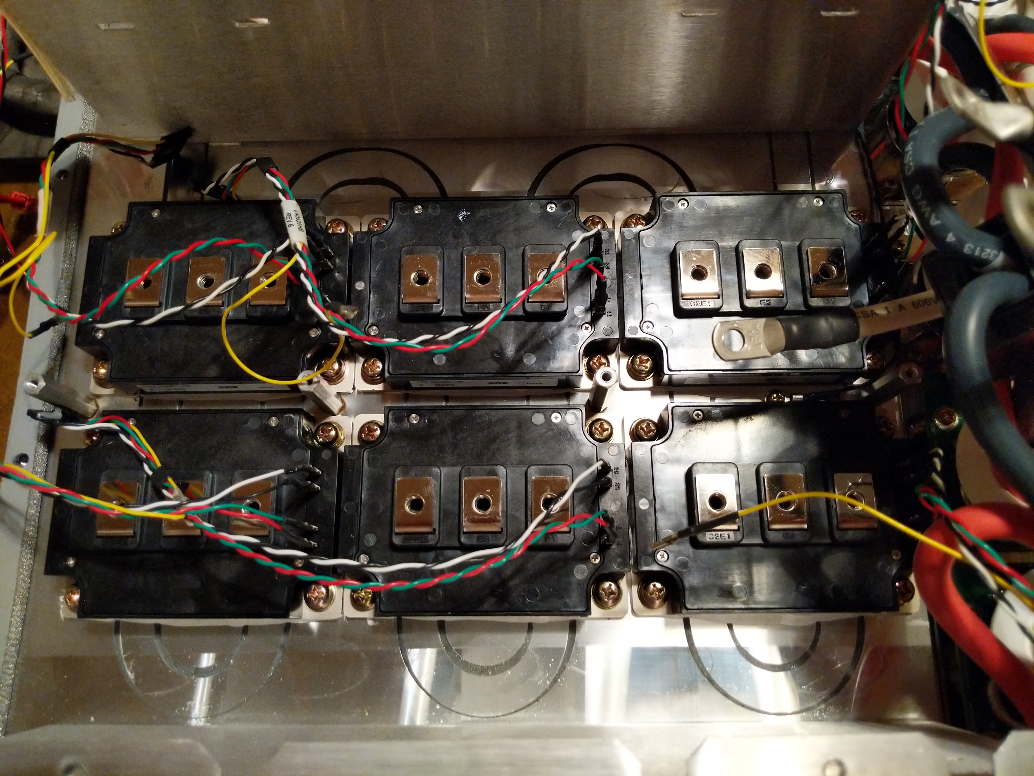

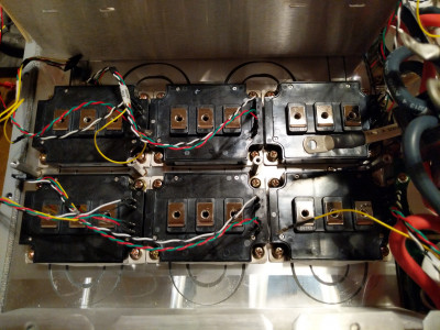

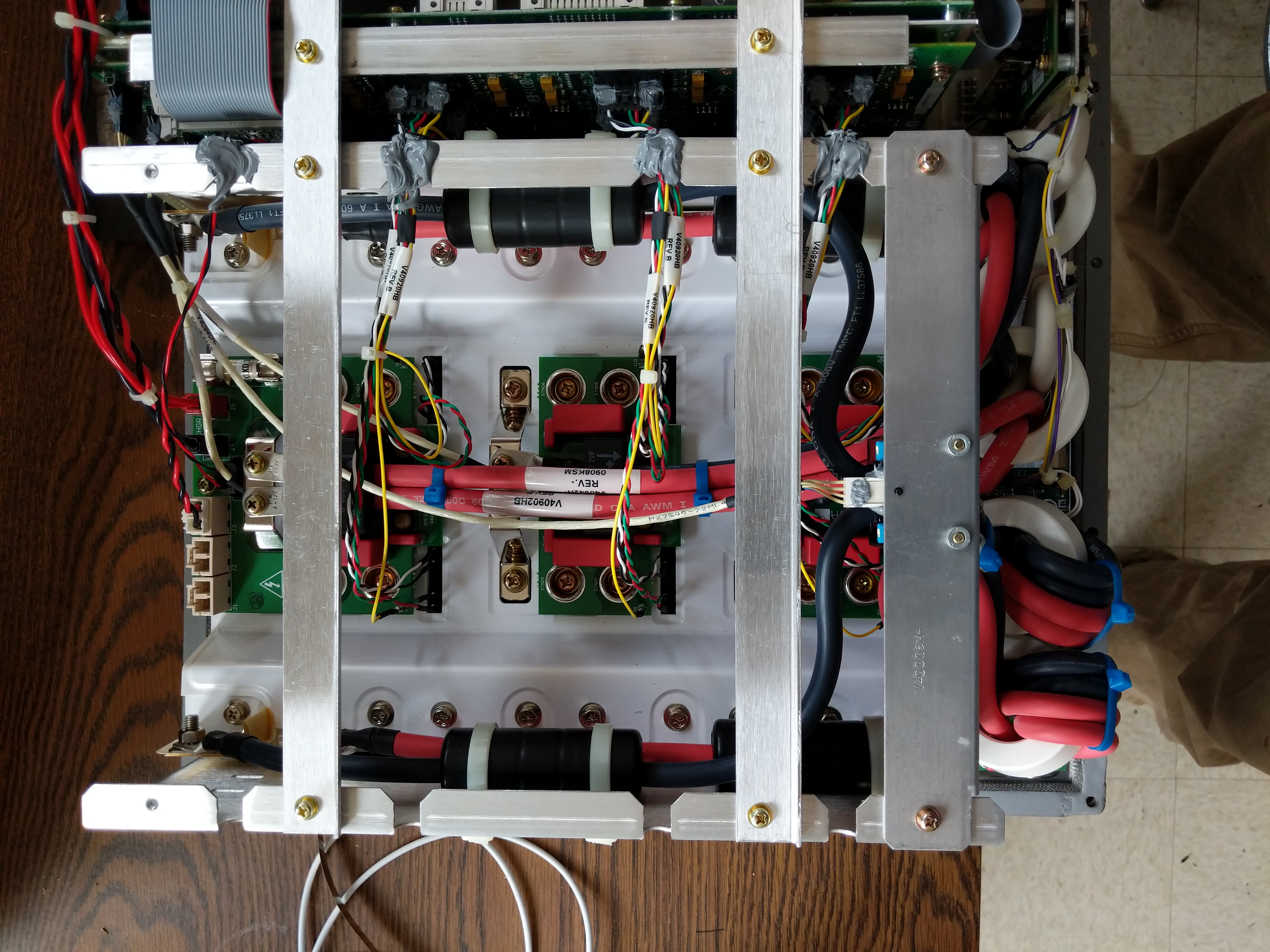

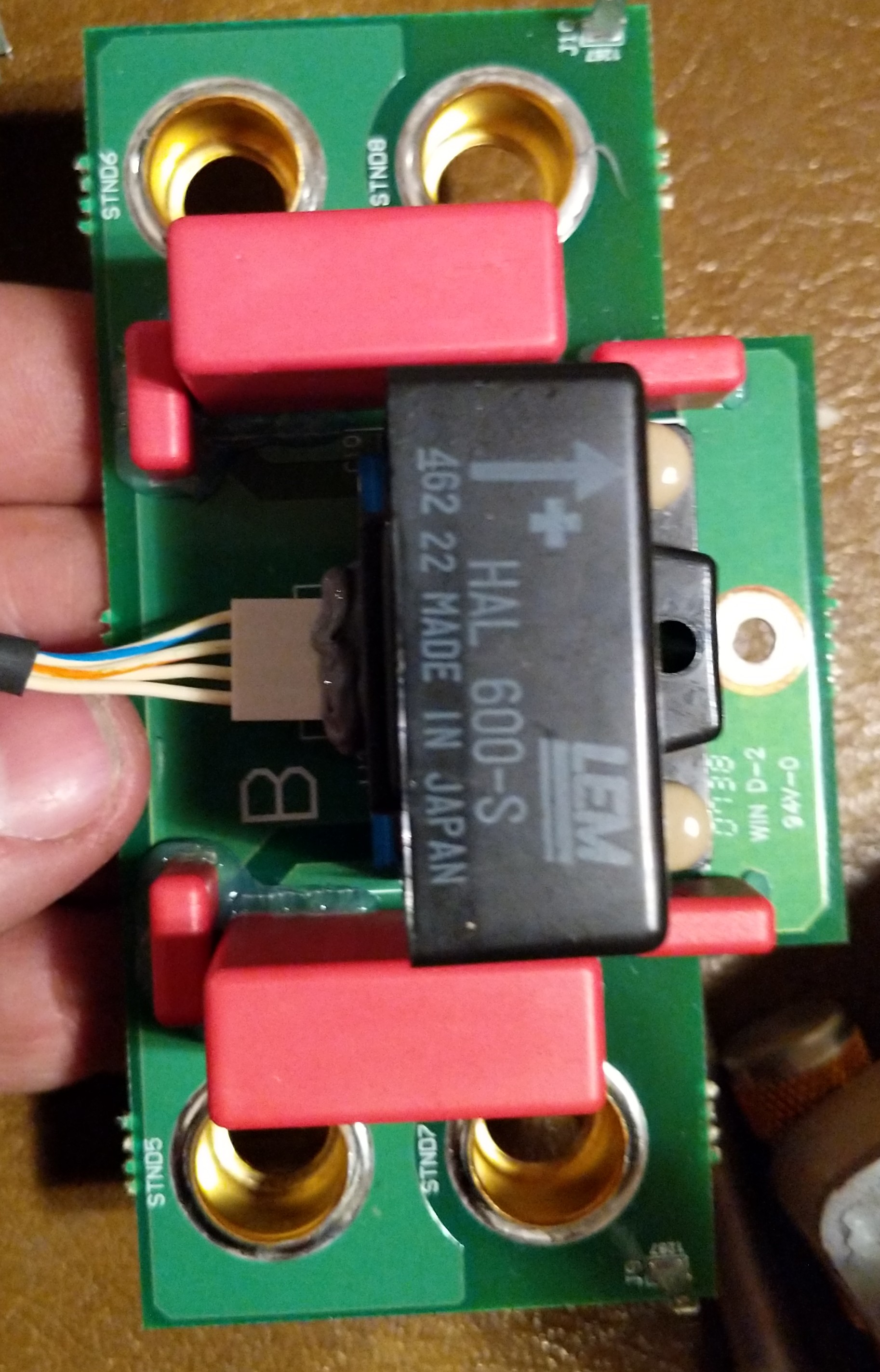

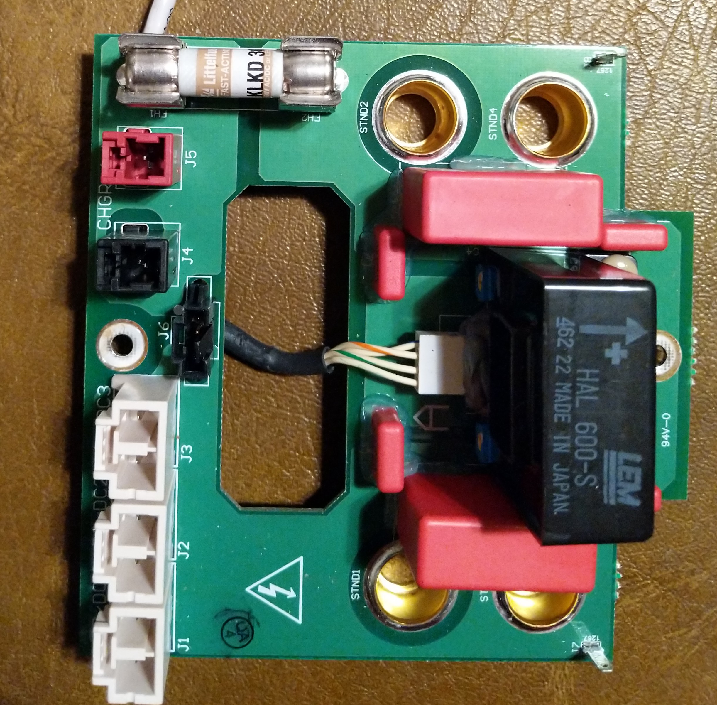

The "spoof enova commands" plan is currently stuck until I find a newer version of the enova interface software to interpret a fault the inverter is spitting out, in the meantime I decided to disassemble the power stage and learn what components were used in the construction.
At the core are 6 Mitsubishi CM600DY-12NF IGBTs, two per phase in parallel.

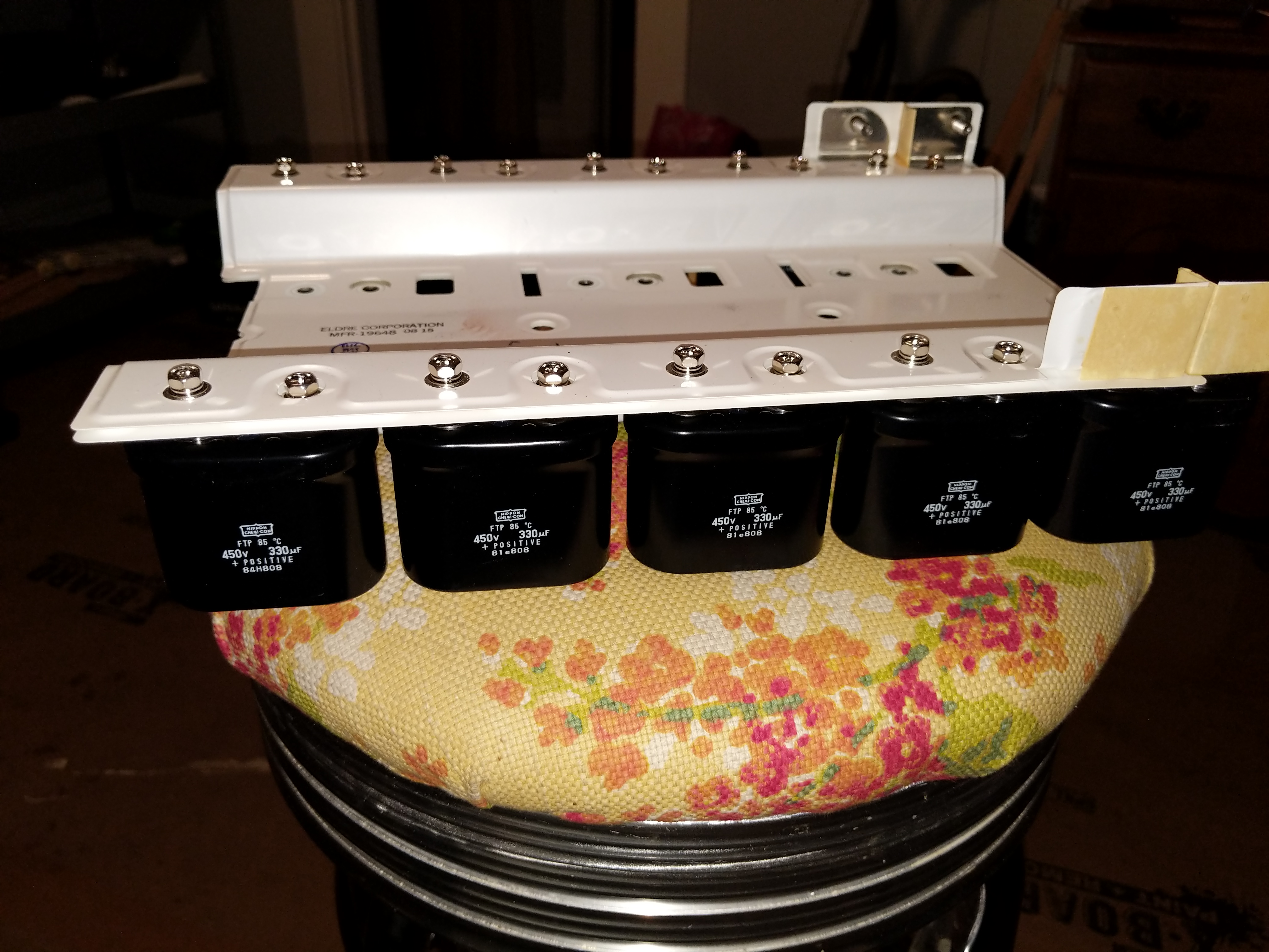

The IGBTs are powered by a pair of stacked plates (busbars?) with insulating plastic molded between them. The plates are mechanically connected by 10x 450v, 330 microfarad capacitors.

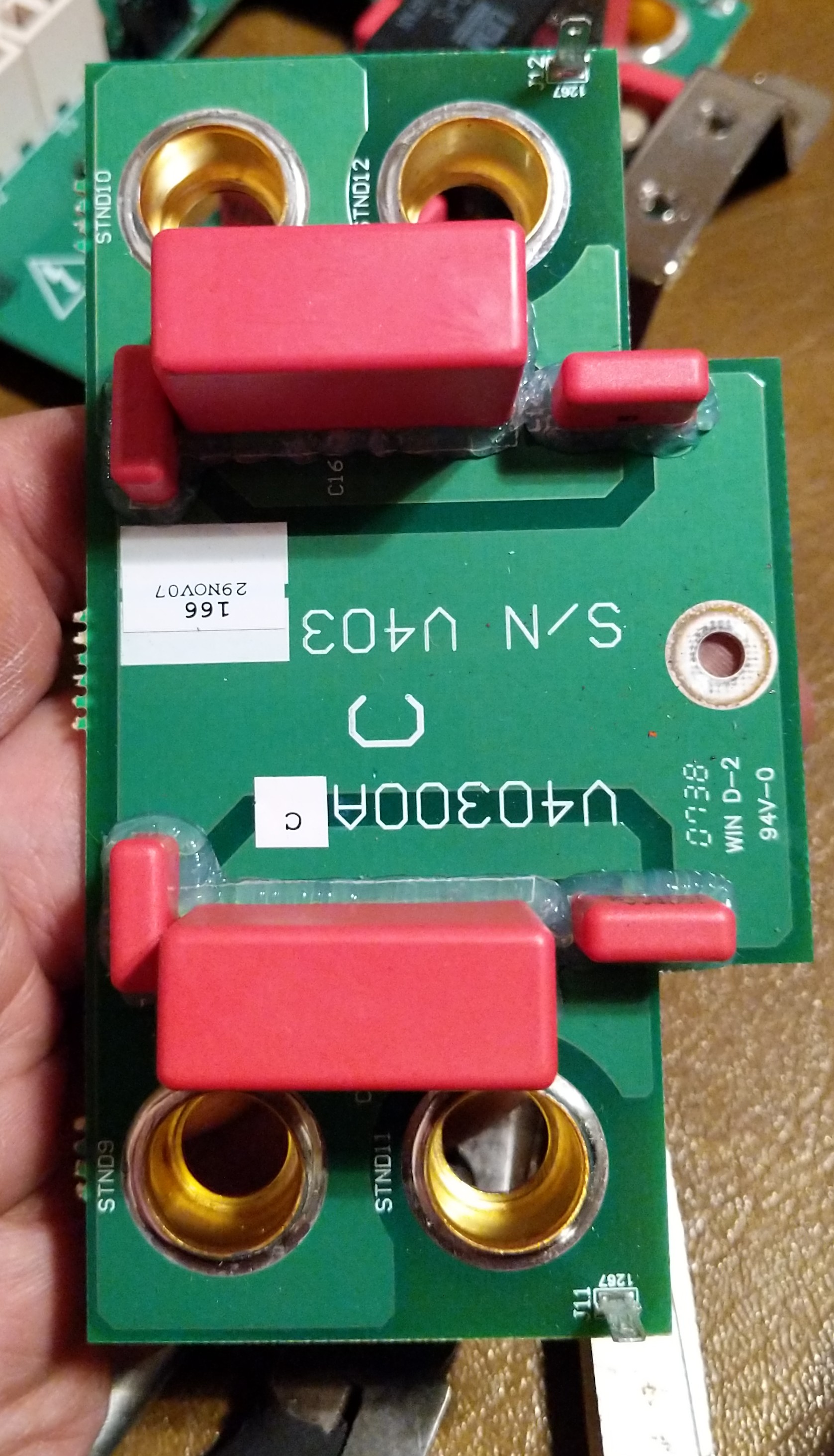

Each phase has a pcb that connects the IGBTs together, two of which carry LEM Hall 600-s current sensors. One also acts as a distribution board for HV to other smaller inverters in the assembly. A third Hall 600-s current sensor measures input current on the HV battery minus leg.

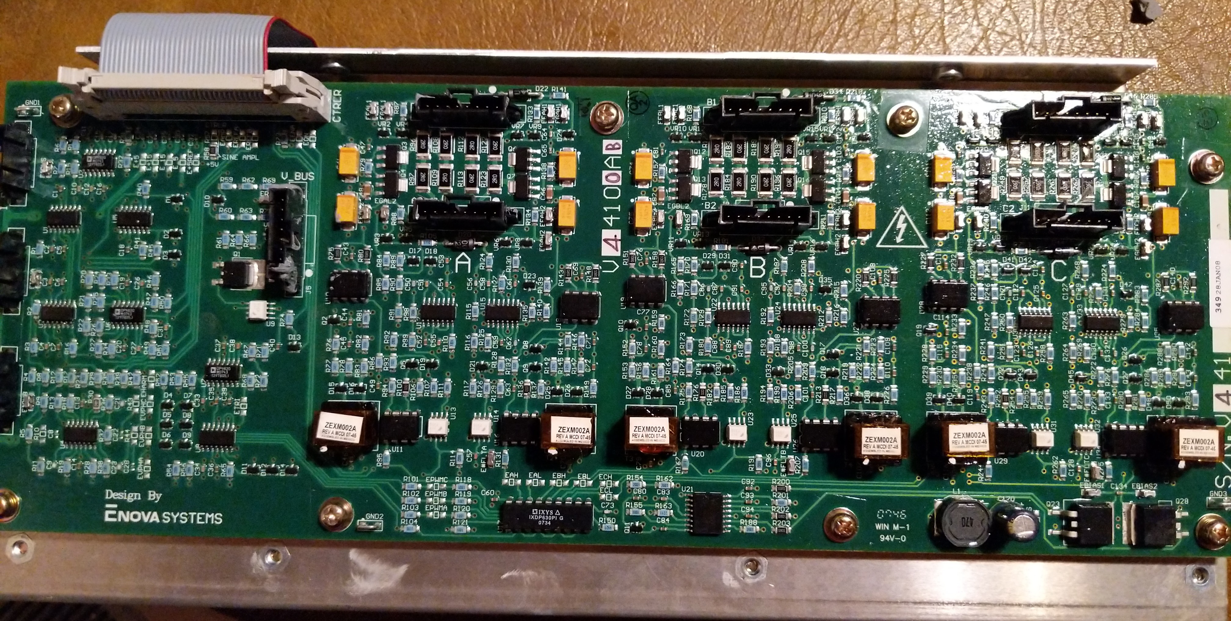

The IGBTs are driven by a gate driver board.
I'm going to do some component research tomorrow.

Re: Feasibility of using v3.0 hardware with 120kw enova inverter
The driver board looks identical to the 90kw as do the current sensors except they are 600amp instead of 400amp on the 90kw. This is the board you would need : http://www.evbmw.com/index.php/evbmw-we ... s/enova-v1
Sadly I cannot offer these populated as there is just not enough demand.
This board lets you retain the original gate drivers and current sensors but does require some electronics and soldering skills.
