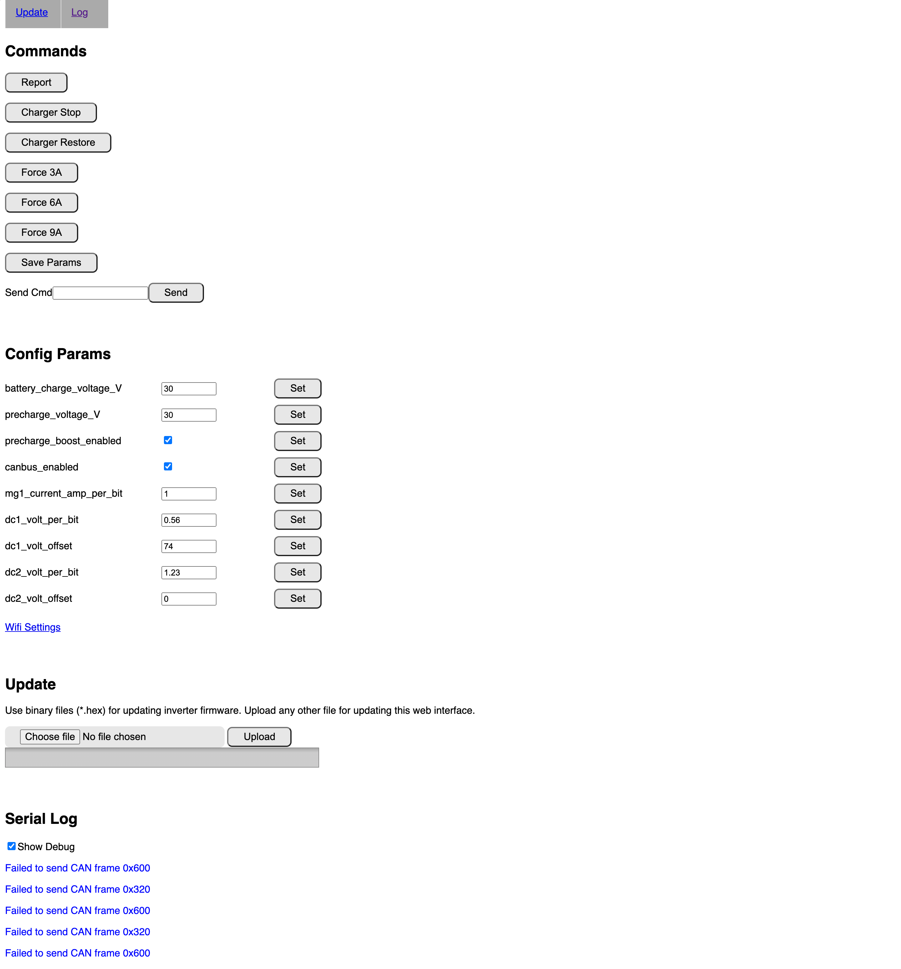

Features
- Wireless Updating of ATMEGA firmware
- Updatable params stored in EEPROM
- Filterable debug output
https://github.com/jamiejones85/prius3charger_buck
I can raise a pull request celeron55, if you want to review and merge the changes.

Re: Gen 3 inverter converter control software
Я немного поработал над веб-интерфейсом
Характеристики
Беспроводное обновление микропрограммного обеспечения ATMEGA
Обновляемые параметры, хранящиеся в EEPROM
Фильтруемый отладочный вывод
https://github.com/jamiejones85/PriusCh ... бинтерфейс
Fantastic job! I looked at the files and didn't quite understand how to install this interface . There is no file for arduino there is only an INI file...) could you please adjust the files for easy installation?thanks.
It's platformIO instead of arduino IDE. I would consider it experimental also.
PlatformIO!!!! Super... Cool thing !! I started studying it - I really liked working in it....
I much prefer it to arduino IDE.
I have some unpushed changes, I'll push them tomorrow when I'm on laptop. There's a bug preventing setting of the bool parameters.
