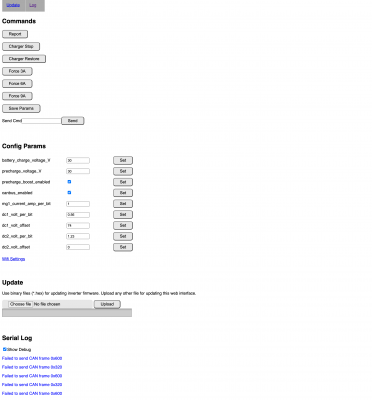

Features
- Wireless Updating of ATMEGA firmware
- Updatable params stored in EEPROM
- Filterable debug output
https://github.com/jamiejones85/prius3charger_buck
I can raise a pull request celeron55, if you want to review and merge the changes.

Re: Gen 3 inverter converter control software
Я немного поработал над веб-интерфейсом
Характеристики
Беспроводное обновление микропрограммного обеспечения ATMEGA
Обновляемые параметры, хранящиеся в EEPROM
Фильтруемый отладочный вывод
https://github.com/jamiejones85/PriusCh ... бинтерфейс
Fantastic job! I looked at the files and didn't quite understand how to install this interface . There is no file for arduino there is only an INI file...) could you please adjust the files for easy installation?thanks.
